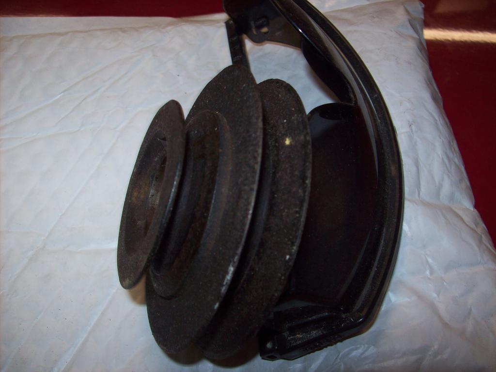

:text-coolphotos:            The engine pulley has a two "V" pulley as a unit, the inside one is 3/8" wide to drive the Hydro pump and the other is 1/2" wide to drive the transmission. The ID would be 1 1/8" and I will have to measure the ODs tomarow.

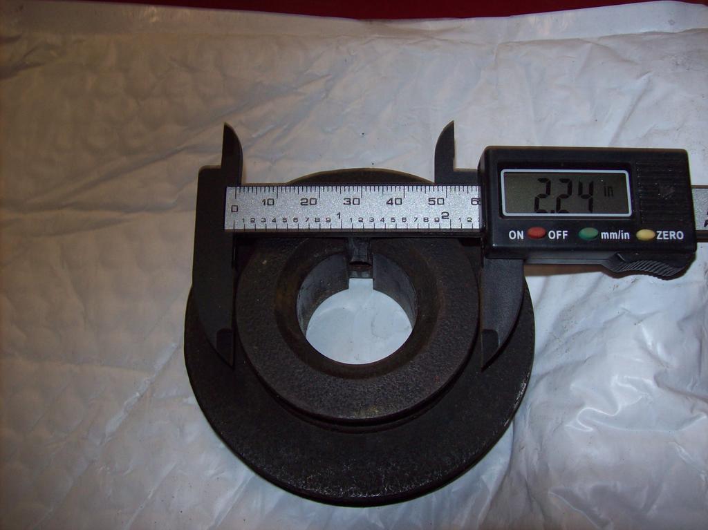

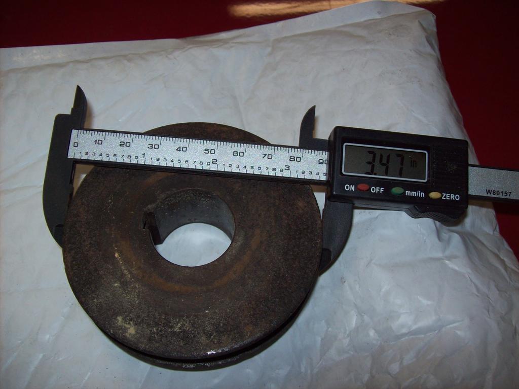

Got out to the barn this afternoon and did a little measuring. The OD of the drive pulley for the tractor is 3.5" and is am "A" belt (or 4L, same thing). The inner pulley is for the hydro pump and is a 3L belt pulley 2.25 OD. If you plan to use the PTO and hydraulic pump you need this pulley, there is no substitute. They come up on Ebay from time to time or you could post a wanted ad on this site.

953 nut if you can get me a measurement of the small step between the 2 and the recess on the inside of the small side i might be able to have some turned
