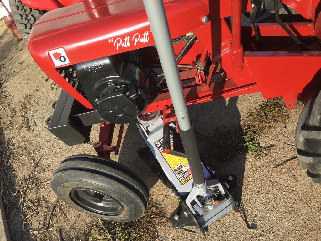

Pullstart 71,561 #80 Posted October 8, 2019 This afternoon I jacked Putt Putt up off the ground while I was watching paint dry on Hot Wheels and gave it a zero gravity grease job. I then realized that I borrowed a front wheel off him to mock up on Frank a while back... low and behold I mounted it backwards! I guess the bearings don’t care, right? 1 Share this post Link to post Share on other sites

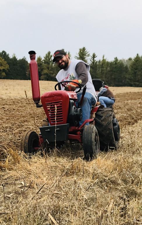

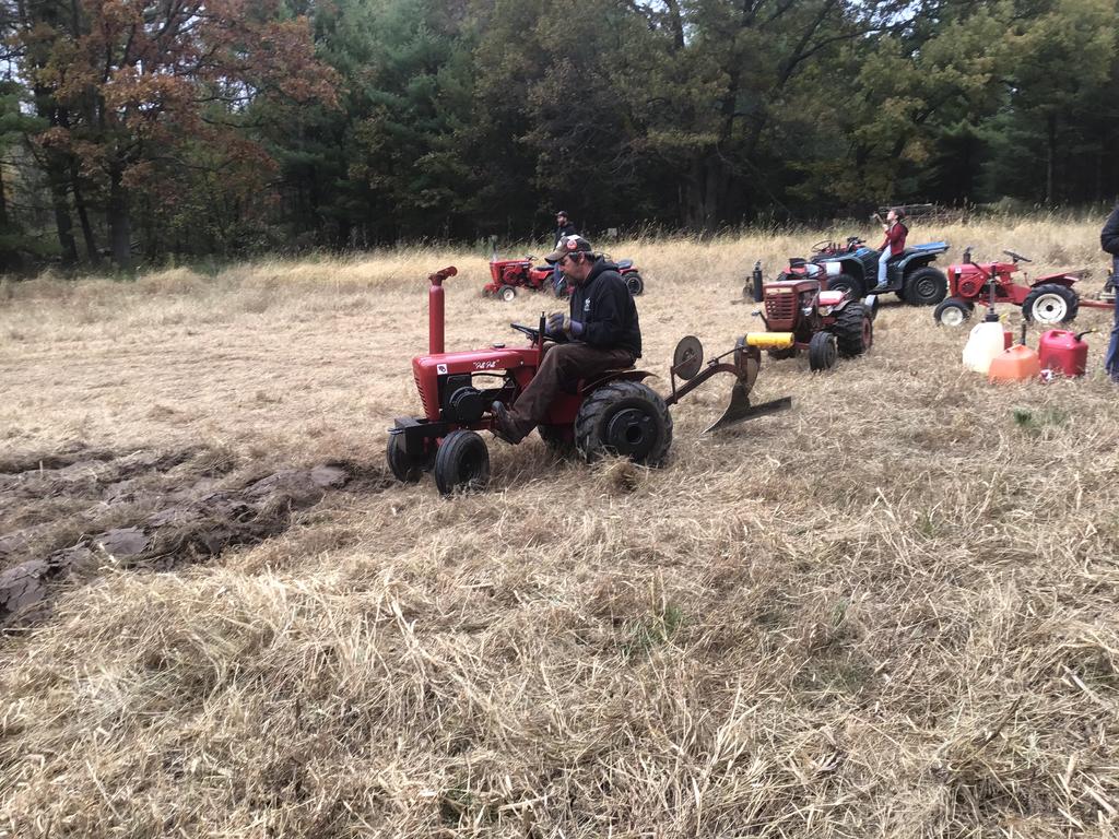

Pullstart 71,561 #81 Posted October 23, 2019 Putt Putt made the trip to WI this weekend, where I tried out a 10” plow behind him. Probably too much I know, but it’s what I had. The day started out not so pretty, with the plow digging to China and pulling hard to the left. @Shynon taught me a bit about adjusting the plow share(?) to push away from the fresh earth and that straightened me out. I kept adjusting the suck point until it dug right to where it would pull easily and roll the earth well. The little tractor did pretty well, but I could easily use even more than the weights on it! I see how traction on the land side is much more difficult to find than fresh plowed earth. I could probably make due taking one weight off the right and adding it to the left. I’d also like to fluid fill these tires, or get a skinny set mounted up and filled for plowing too. That tractor sure is filthy! It’s ready for a bath, along with Hot Wheels. 2 3 Share this post Link to post Share on other sites

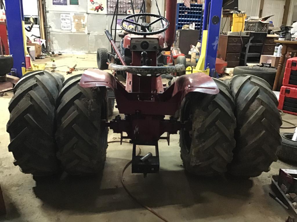

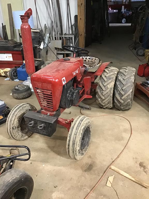

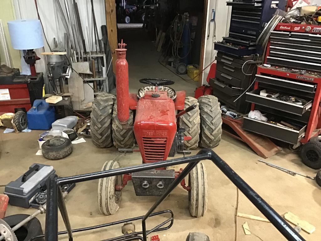

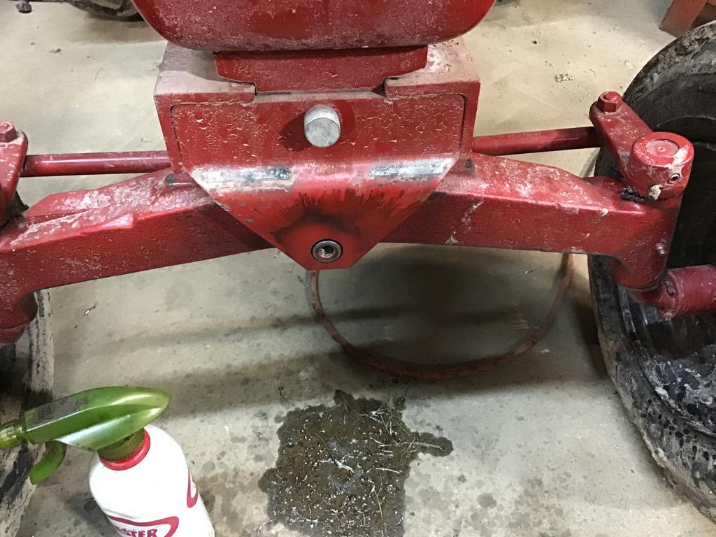

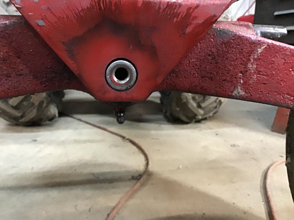

Pullstart 71,561 #89 Posted April 9, 2020 A little Putt Putt update. Last year’s plow day was the last weekend Putt Putt has been out of the barn. The bolt holding the front axle pin came out and the axle was flopping around by just the rear hole. Today I fired him up and pulled him into the front shop to play with the idea dual gas out back. I decided before pulling the pin and going to a c-clip style, I’d try drilling and tapping the end and sticking a 3/8” bolt with a captive washer and lock washer in the hole. @ebinmaine you were asking the other day the best way to drill the center of a piece of round stock. I’d say I am pretty close eyeballing it! I used a center punch, 3/16” pilot drill and finally the 5/16” drill for the 3/8”-16 tap. what do y’all think about the duals? Yay? Nay? 2 2 Share this post Link to post Share on other sites
ebinmaine 81,278 #90 Posted April 9, 2020 4 minutes ago, pullstart said: duals? Yay !!! Share this post Link to post Share on other sites
ebinmaine 81,278 #91 Posted April 9, 2020 Nice work on that pin man! 1 1 Share this post Link to post Share on other sites

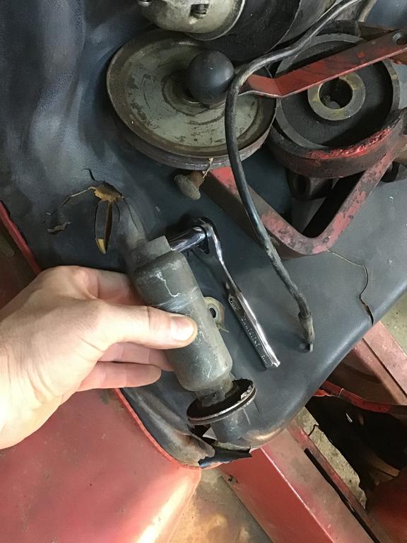

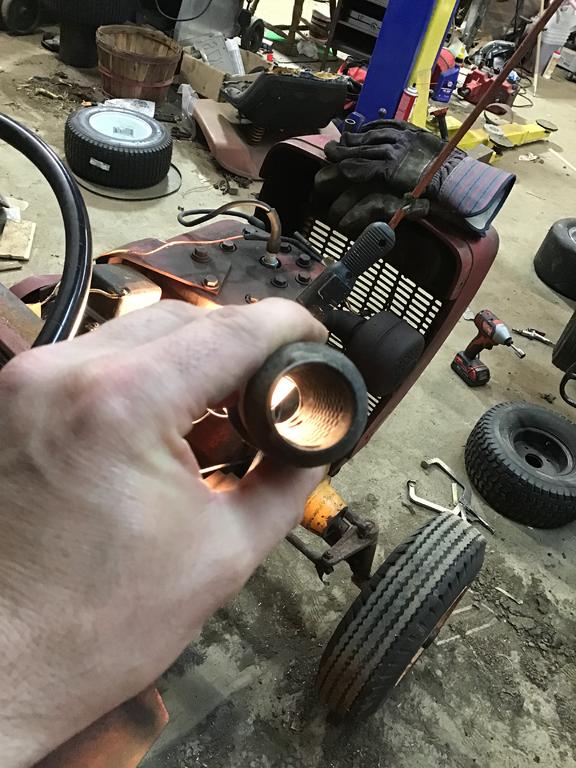

Pullstart 71,561 #92 Posted April 23, 2020 I found another baffle like the one in Putt Putt’s Cherry Bomb stack! It’s from the mufflers of my 2006 Honda Shadow Spirit 750. This one here has about 20 miles on the odometer! 1 Share this post Link to post Share on other sites
Pullstart 71,561 #93 Posted July 30, 2020 On 4/22/2020 at 8:26 PM, pullstart said: I found another baffle like the one in Putt Putt’s Cherry Bomb stack! It’s from the mufflers of my 2006 Honda Shadow Spirit 750. This one here has about 20 miles on the odometer! @Richcz28 here is the innards of Putt Putt’s stack 1 Share this post Link to post Share on other sites

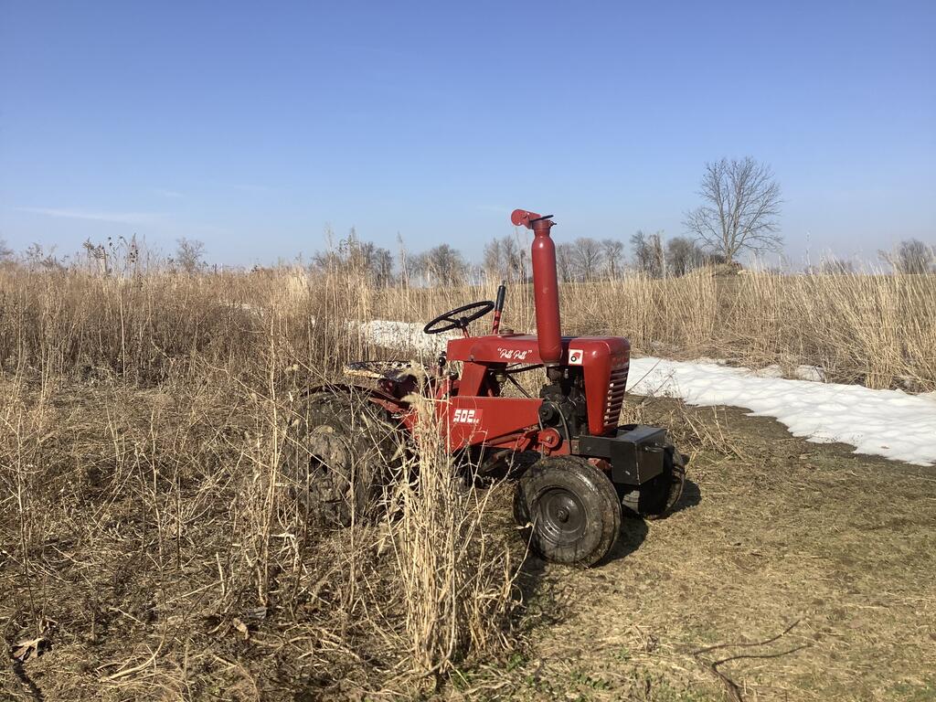

Pullstart 71,561 #99 Posted March 9, 2021 Putt Putt got a points cleaning today and some seat time. I sure have missed the rhythm of the ole K-181 and Cherry Bomb popping off! 5 1 Share this post Link to post Share on other sites
