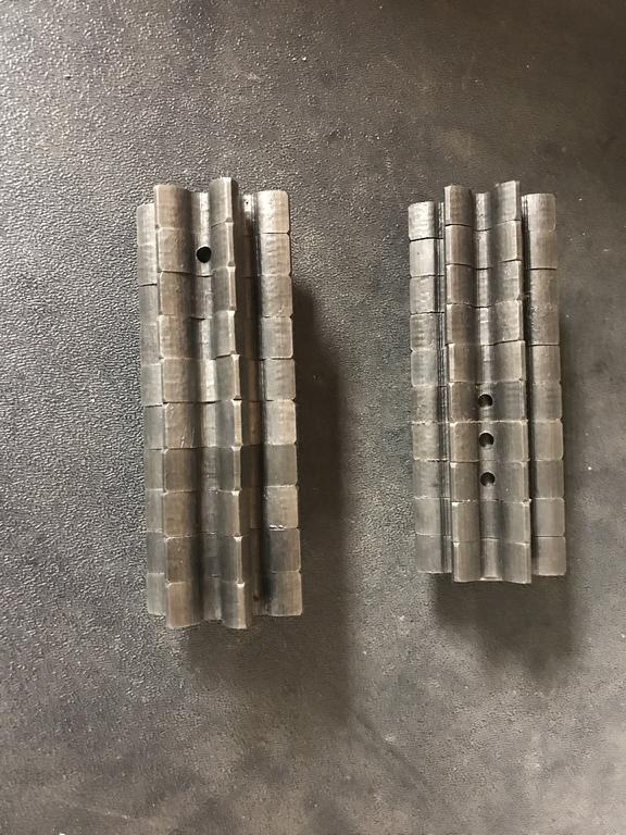

Shynon 7,634 #51 Posted February 18, 2018 17 hours ago, Achto said: I removed the cover for the pump gears and the drive gear had broke. Or in the words of Mick Jagger "She oopie, Shattered Shattered" That's not the first one I've seen broken or cracked, pretty bad design with a blind roll pin with no way to get it out. Maybe @wheelhorseman is making these? 3 Share this post Link to post Share on other sites
wheelhorseman 3,256 #52 Posted February 18, 2018 I already hooked Dan up! 2 8 Share this post Link to post Share on other sites
Sarge 3,473 #53 Posted February 18, 2018 Want to tackle the Sundstrand input shafts for the D's and save them from the iron pile ? LOL....figured you already had those done, but couldn't remember. Sarge 2 Share this post Link to post Share on other sites

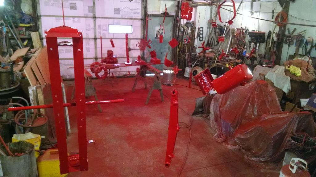

Achto 32,169 #54 Posted February 19, 2018 10 hours ago, Shynon said: Maybe @wheelhorseman is making these? Lowell was definitely a savior for me with my pump issue. I was quite sure that I had turned my hydro pump into a boat anchor. We finally had a day above 30 on a weekend day so I decided to put a fresh coat of red paint on the floor of the shop. I even managed to get a little paint on some of my parts. I have most of the ruff and small parts painted. These parts got 1 coat of self etching primer, 2 coats of VanSickle 171 red oxide primer, and 3 coats of VanSickle acrylic enamel paint with gloss hardener added. 4 8 Share this post Link to post Share on other sites
Sarge 3,473 #55 Posted February 19, 2018 How is the flash off on that VanSickle paint with the hardener in it , fast or slow ? I need to look into their paint more - everything else other than automotive grades is becoming less and less solids content. Took 3 heavy coats to get the color with the Rustoleum equipment paint on the trailer - that was no fun. Sarge 1 Share this post Link to post Share on other sites
Achto 32,169 #56 Posted February 19, 2018 (edited) 25 minutes ago, Sarge said: How is the flash off on that VanSickle paint with the hardener in it , fast or slow ? One advantage to using their 171 primer is the fact that you don't have to wait for it to dry & wet sand it before you paint. Spray the primer, wait 30 min then top coat. a big plus when painting multible small parts. The 30 min wait for the primer is about perfect too, as that is how long the induction period wait is after adding the hardener to the paint. With a temp of about 65 degrees in the shop today it was about 15 to 20 min between coats of paint, or in my case with multiple parts I could pretty much spray paint non stop until all 3 coats were applied. I check my tack time by touching a spot that won't be seen or touch masking tape that has had a full coat of paint on it. Tacky paint that does not transfer color to your finger is ready for another coat. Edited February 19, 2018 by Achto 2 2 Share this post Link to post Share on other sites
Achto 32,169 #57 Posted February 19, 2018 11 hours ago, Sarge said: Took 3 heavy coats to get the color with the Rustoleum equipment paint on the trailer - that was no fun It is common for reds to have poor hiding capabilities. The Vansickle IH red acrylic enamel achieves full hiding in two coats. 1 Share this post Link to post Share on other sites
Sarge 3,473 #58 Posted February 19, 2018 The now extinct Valspar Restoration series enamel was great - 2 decent coats got full color depth but the stuff they replaced it with takes 4-5 and seems to never properly harden, ugh. What I'm curious about with the VanSickle paint is how well it flows out - flash to "set" time to achieve it's gloss . A lot of this stuff requires different thinner when using hardener , otherwise it comes out very rough and dull but it can back fire on you and take forever to fully cure. The Magik branded stuff at TSC is notorious for that - 6 months later, even with hardener added you can scratch it off with a fingernail easily. In the last few years since the demise of the Valspar I've switched to using reducers from the auto parts stores - they have varying grades to slow down the flash off and allow the paint to flow out better to produce a much nicer gloss that doesn't need a lot of buffing work after drying. Some types are referenced by heat range, others by time grade, they work very well for paints that don't want to play nice. These reducers are also a big help when dealing with hotter temps during the summer when conditions are less than ideal . I've been able to lay paint in high heat and humidity with predictable results - prior to using the stuff it was really taking a chance. I need to pick up a quart of the VanSickle this summer and just try it on something - plenty of projects coming if I have the time and much of that stuff is attachment parts that can easily be blasted clean again if it doesn't work out. Sarge 2 Share this post Link to post Share on other sites
Achto 32,169 #59 Posted February 19, 2018 32 minutes ago, Sarge said: In the last few years since the demise of the Valspar I've switched to using reducers from the auto parts stores - they have varying grades to slow down the flash off and allow the paint to flow out better to produce a much nicer gloss that doesn't need a lot of buffing work after drying. Vansickle only offers 1 reducer for their acrylic enamel, 9090. This is the same reducer that is used in their 170 gray and 171 red oxide primers. The reduction on both paint & primer is 8:1. Yesterday with the shop at about 65 degrees the paint was dust free in about 30 min. I have sprayed in temps up to about 90 degrees and of course the dry times decrease but the gloss does not change. Only buffing required is to repair mistakes, ( dust, runs, etc). Unlike the strait enamels like the TSC Majik and some grades of the Valspar, acrylics enamels are not as weather sensitive. Vansickle does offer a strait enamel line that I have used in the past. This line of their paint is real similar to the Valspar enamel. 2 Share this post Link to post Share on other sites

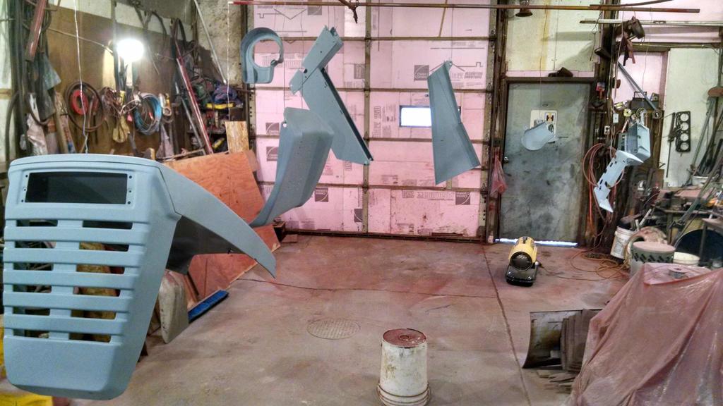

Achto 32,169 #68 Posted February 24, 2018 (edited) I had the day off today so I took the time to do the body work on my sheet metal and get it in primer. 1 coat of self etching primer, 3 coats of primer. Next steps will be to mist a guide coat on these, wet sand with 400 grit and get some paint on them. Edited February 24, 2018 by Achto 5 1 Share this post Link to post Share on other sites
953 nut 67,902 #69 Posted February 24, 2018 9 minutes ago, Achto said: Next steps will be to mist a guide coat on these, wet sand with 400 Have you ever used a red or flat black primer for the guide coat? I have had good luck alternating a couple of colors to make high/low spots stand out and use red primer as the final coat prior to finishing. 1 Share this post Link to post Share on other sites
Achto 32,169 #70 Posted February 24, 2018 11 minutes ago, 953 nut said: Have you ever used a red or flat black primer for the guide coat? I usually use a cheap spray can of primer as a guide coat. Dark over light / light over dark 1 Share this post Link to post Share on other sites
