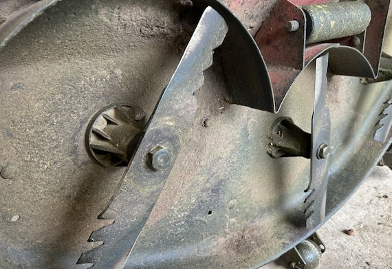

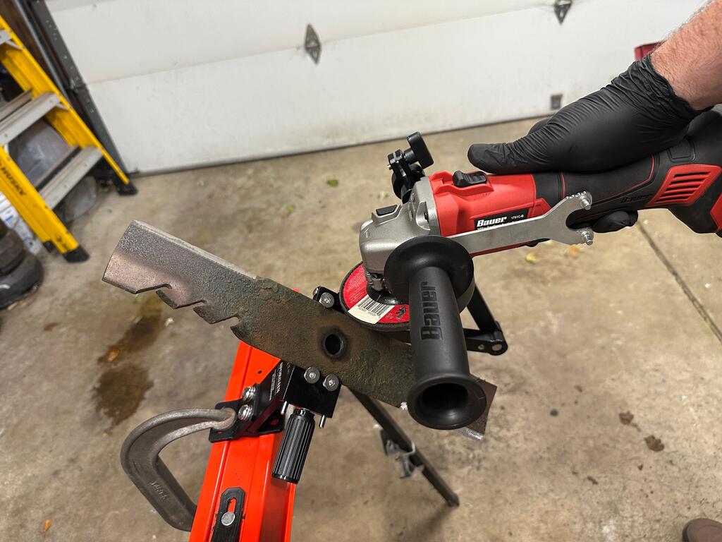

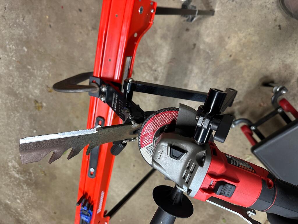

Andy N. 2,805 #24879 Posted November 9, 2025 Sharpened some mower deck blades before putting it away for winter! First time using this style blade fixture and it worked great. It's supposed to be bench mounted, but I just C clamped it to a saw horse and it worked great! Here's the link if anyone is interested: https://a.co/d/9IHreoA IMG_8403.mp4 7 2 Share this post Link to post Share on other sites

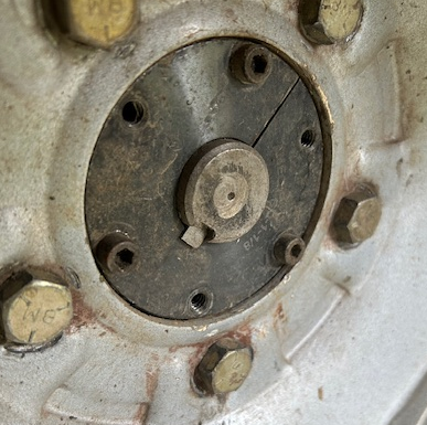

JoeM 10,134 #24882 Posted November 9, 2025 Worked on daughters 522xi, oil change service and installed the snow plow. The deck has about 150 hours on sealed bearings. Still nice and smooth! Surprising how clean the deck is after cutting up the leaves. One other thing I keep an eye on is the right rear hub. It has one of those A to Z tapers hubs. The axle was about ten thousands under and I first had issues keeping it tight. That 1.125 taper is good to 5 under. With nothing to loose. I drove the taper in as deep as it would go, tightening and tapping on the taper while the out hub was blocked. I gauge it by the axle stick out. Has ran 95 hours on loaded tire and chains. Hanging tough! 6 4 Share this post Link to post Share on other sites

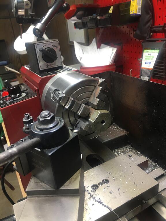

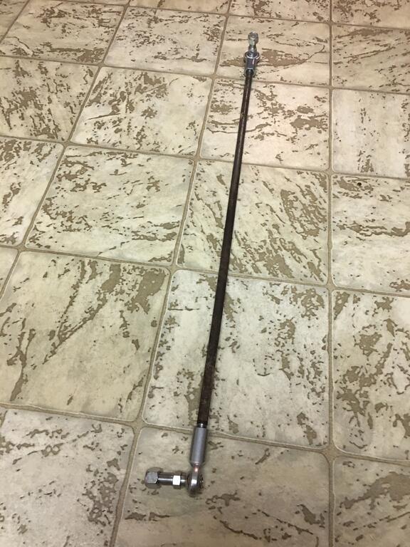

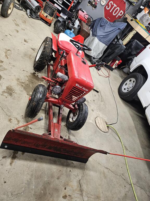

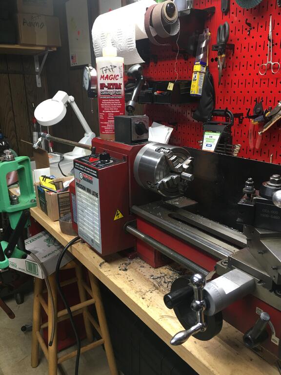

sqrlgtr 3,649 #24883 Posted November 10, 2025 Threaded and added heim joints to push pull rod for snow plow. 5 1 Share this post Link to post Share on other sites
Handy Don 17,226 #24884 Posted November 10, 2025 13 minutes ago, sqrlgtr said: Did you cut the threads with the lathe or with a die? 1 Share this post Link to post Share on other sites

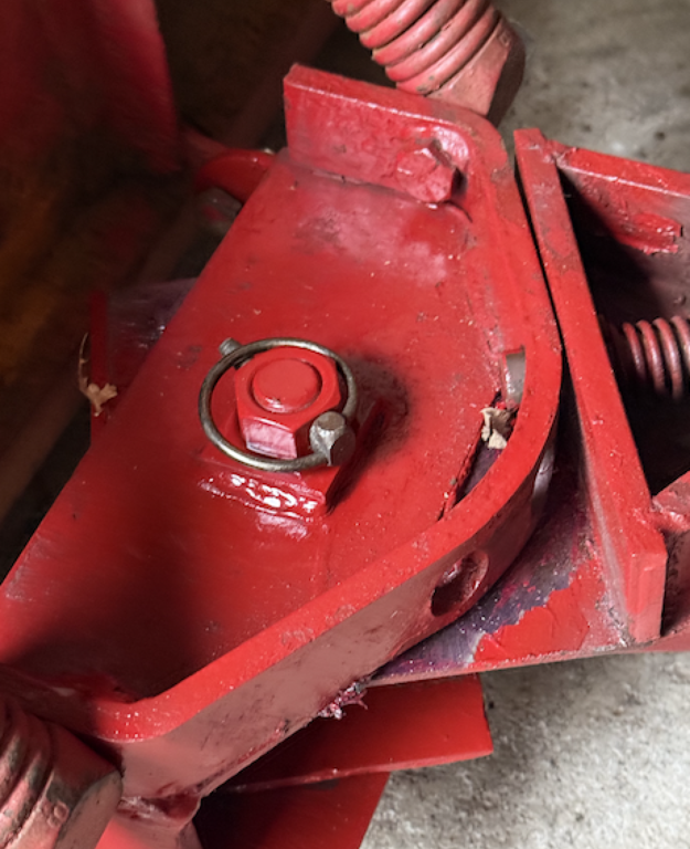

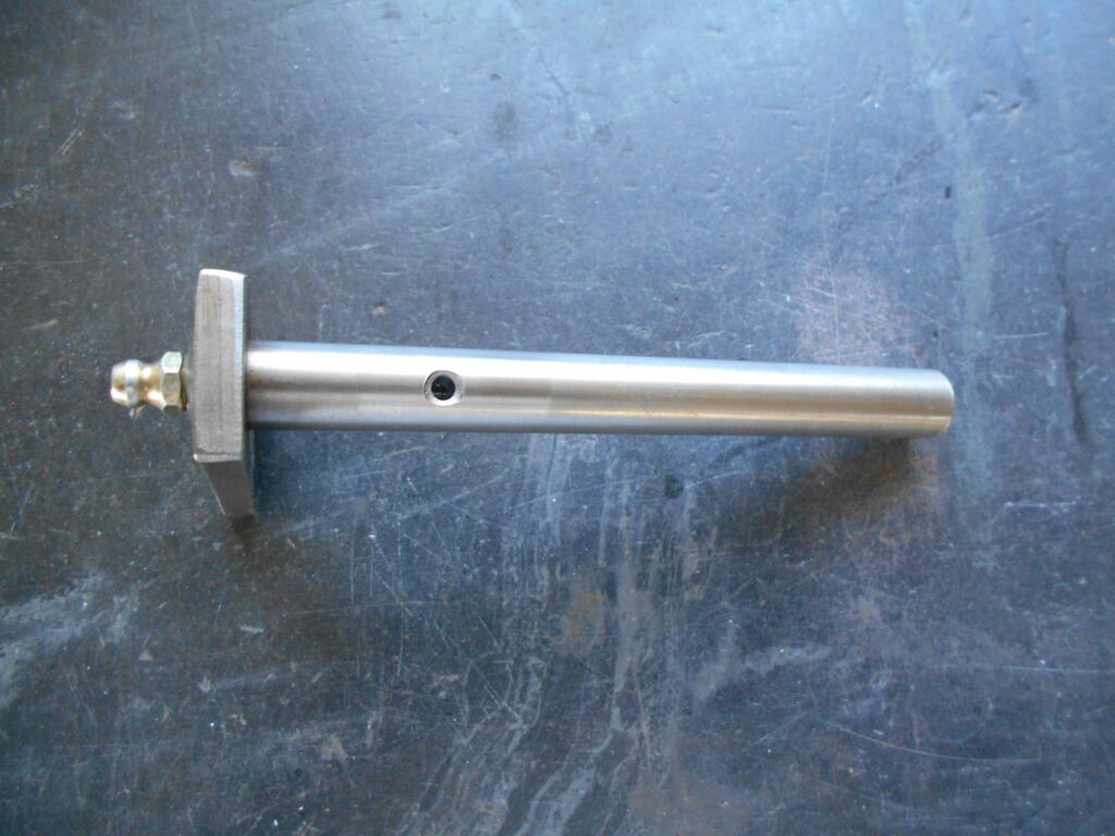

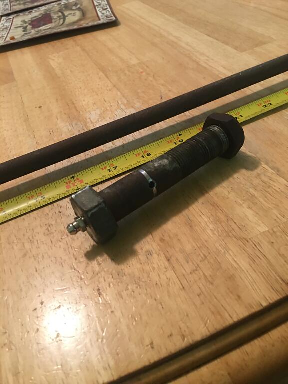

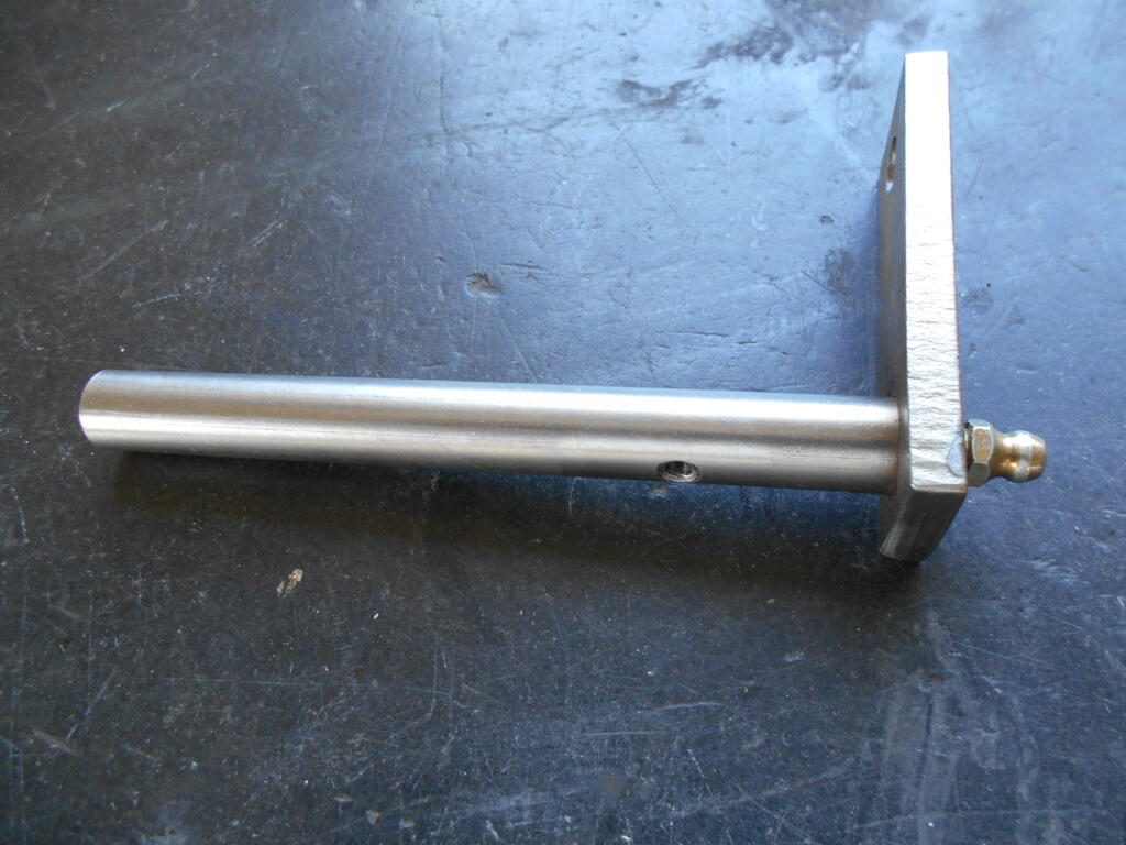

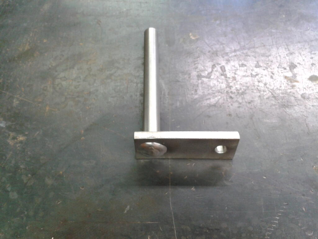

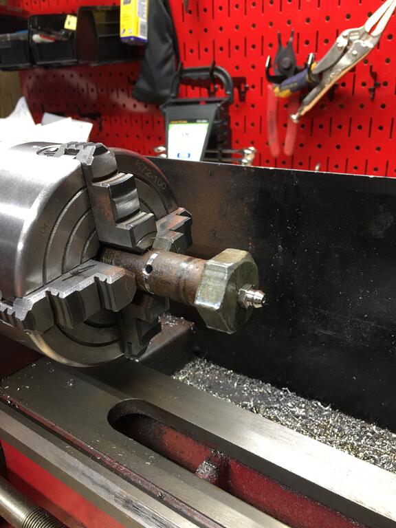

sqrlgtr 3,649 #24886 Posted November 10, 2025 Almost forgot fixed plow pivot pin to accept grease. I couldn't believe how dry that pin was. When I took it apart I greased it up and put it back together and you couldn’t believe what a difference that made. Got to thinking there should be an easier way to grease beside taking it apart and this is what I came up with. Got idea from front end loader on my farm Tractor 🚜 . @Handy Don I used both first one was with a die and last end cut with lathe (lot easier). I just had a little 1” dia 1/2-20 dia and broke my die stock handleand thats why I had to cut other end with lathe. 4 2 Share this post Link to post Share on other sites

Bar Nuthin 2,965 #24889 Posted November 10, 2025 23 hours ago, Andy N. said: First time using this style blade fixture and it worked great. You'll find you get much better results using a flap disc. I use 60 grit, then finish off burs with a file. I also have the balancer which fast and accurate. 2 Share this post Link to post Share on other sites
ebinmaine 80,148 #24890 Posted November 10, 2025 2 hours ago, sqrlgtr said: Threaded and added heim joints to push pull rod for snow plow. I might have a little bit of "machine envy" here. 3 4 Share this post Link to post Share on other sites

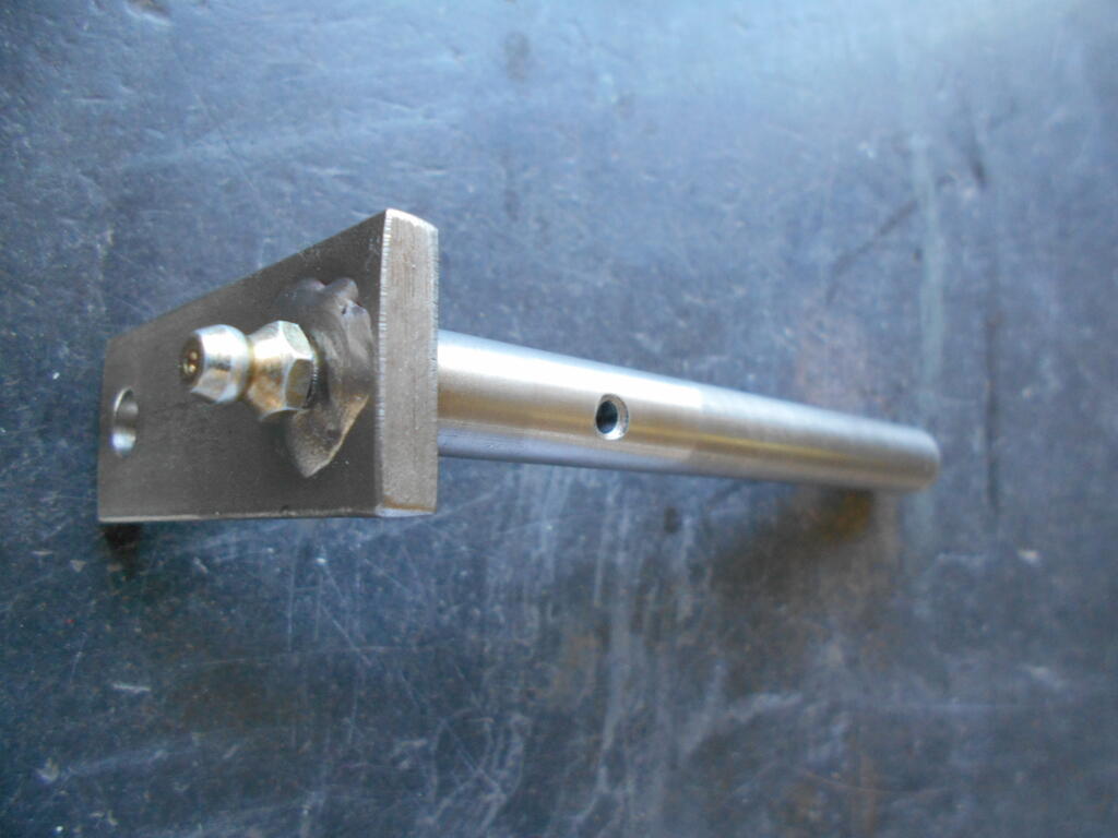

Handy Don 17,226 #24891 Posted November 10, 2025 1 hour ago, sqrlgtr said: @ri702bill made some lubricated transaxle hitch pins the same way. Many folks store their plows with the frame and blade separated so the pin gets attention every year. 3 Share this post Link to post Share on other sites

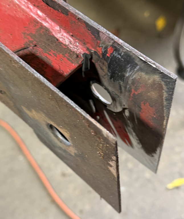

sqrlgtr 3,649 #24892 Posted November 10, 2025 4 minutes ago, Handy Don said: Many folks store their plows with the frame and blade separated so the pin gets attention every year. I am ashamed to say it but believe this is first time I ever had the blade off the frame on any of mine . I can see how they might be easier to store taken apart though. Only reason this one came off had to do a little welding on the "sector?" were the push/pull rod went through hole. I think I ran over it with farm tractor and broke a weld loose . 1 Share this post Link to post Share on other sites

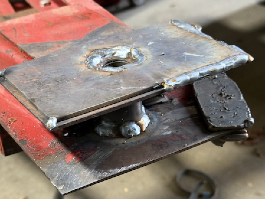

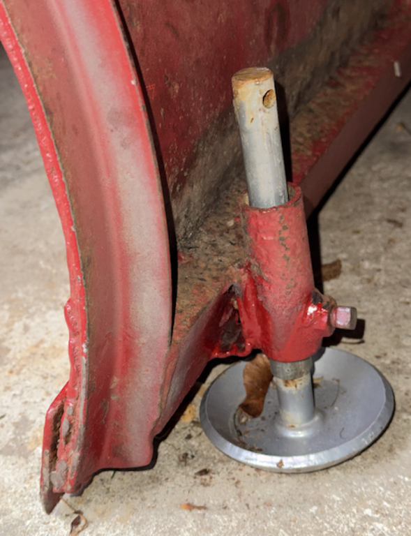

Handy Don 17,226 #24893 Posted November 10, 2025 Continuing the dozer blade theme... A year ago, @ebinmaine gifted me a parts-missing and extremely tired BD-4263 (1963). A PO had already repaired the bottom edge with a new plate. I wasn’t sure I even wanted a plow. Last fall I made a rotate control lever and linkage (with Heims), extended the frame rearward to work with a latch-in instead of the original (and not present) bolt-in mounts, installed plow shoes, and made a plow centering bracket for the front hitch. Well, I’ve come to appreciate plowing over blowing for the sort of snow we are getting here and I decided to finish the refurb and keep this thing. So, I... - Cut and re-welded the plow shoe brackets to keep the shoes flat to the ground - Cut out the seriously wallowed pivot sleeve in the frame and a friend installed a new one (DOM ¾ ID, 1-¼ OD, ¼ wall) -- a bit heavier than the original - Added an extra layer of sheet metal to the bottom of the frame’s blade junction to lessen the flop there - New Grade 8 shoulder bolt and nut for the pivot and drilled the nut for a Lynch pin I’m surely invested in this blade for more dough than one in better shape to start with would’ve cost, but I’m content. 1 5 Share this post Link to post Share on other sites

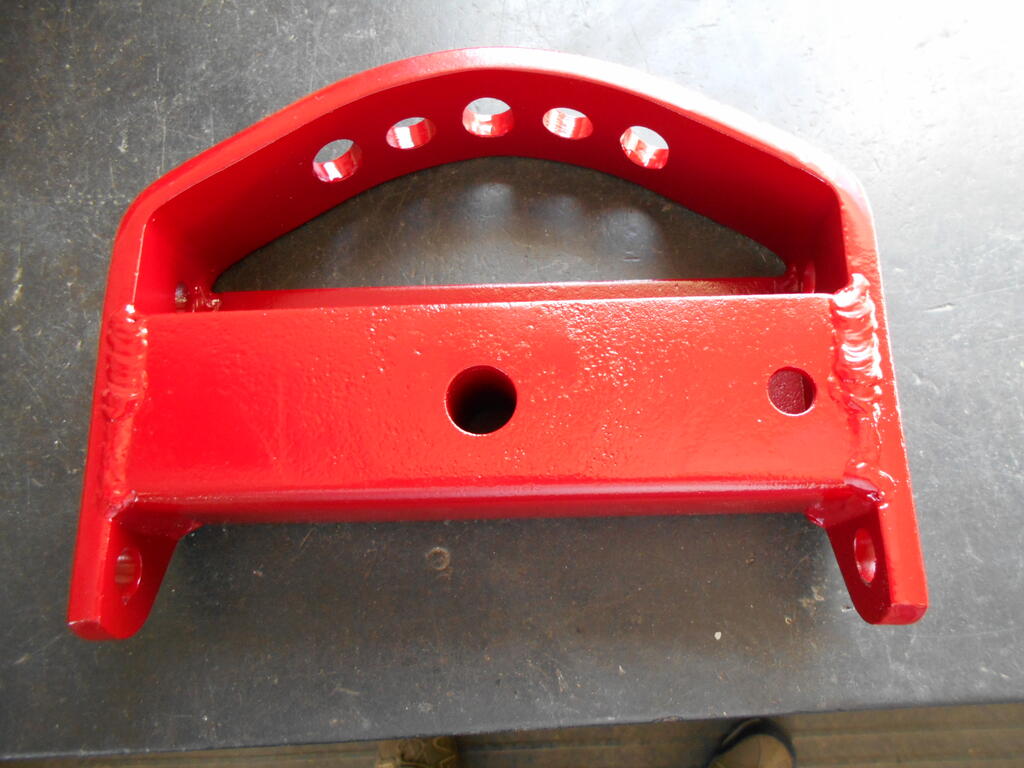

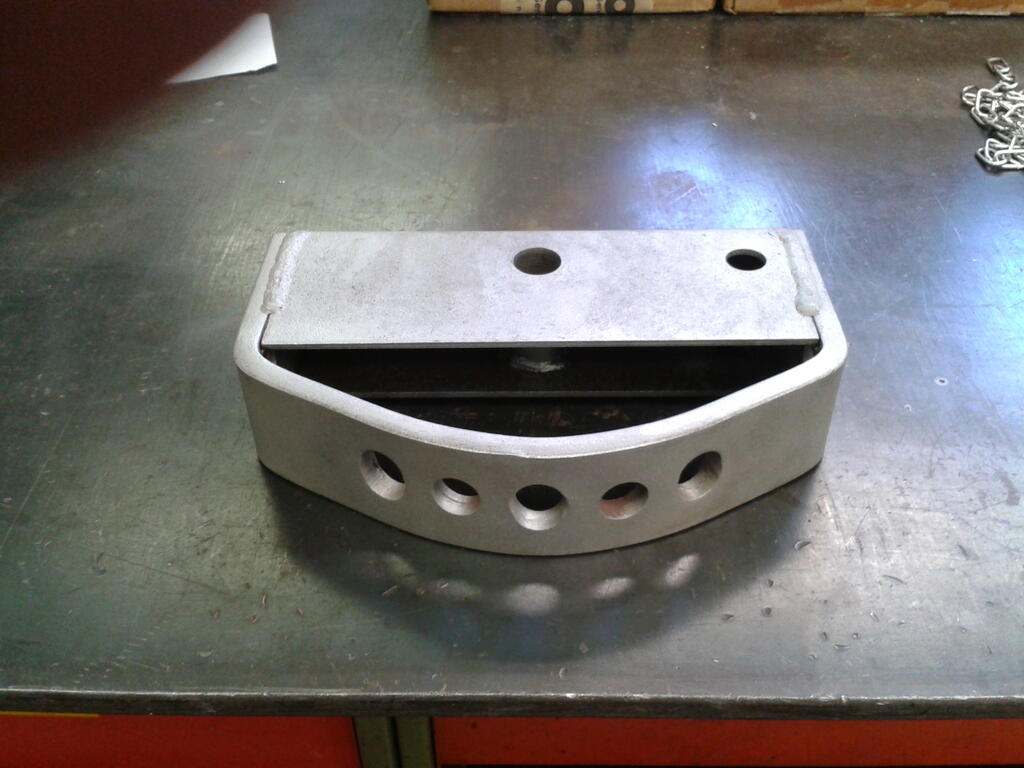

ri702bill 12,730 #24894 Posted November 10, 2025 5 minutes ago, Handy Don said: I’m surely invested in this blade for more dough than one in better shape to start with would’ve cost, but I’m content. That is an earlier quadrant with 3 holes - my 42" was like that. I added the 2 mid positions between them. That is the setting I plow with the most. (also did the intersecting holes & grease fitting on the pivot bolt two years ago)... 2 Share this post Link to post Share on other sites
ebinmaine 80,148 #24895 Posted November 10, 2025 @Handy Don very nice work! @ri702bill how did you drill that? Is that nasty steal to get through? I've been considering doing that for several years. Share this post Link to post Share on other sites
Handy Don 17,226 #24896 Posted November 10, 2025 3 minutes ago, ri702bill said: That is an earlier quadrant with 3 holes - my 42" was like that. I added the 2 mid positions between them. I looked at that, and I think I’d surely use those intermediate positions, but I wasn’t sure there would be enough metal left around the holds for adequate strength. Can you post a picture of yours, please? Share this post Link to post Share on other sites
cleat 9,140 #24897 Posted November 10, 2025 9 minutes ago, ri702bill said: That is an earlier quadrant with 3 holes - my 42" was like that. I added the 2 mid positions between them. That is the setting I plow with the most. (also did the intersecting holes & grease fitting on the pivot bolt two years ago)... Mine was a three hole to begin with too. I drilled the two extra holes. It works great and as ri702bill said, I plow in the mid position a lot. 3 7 Share this post Link to post Share on other sites
Handy Don 17,226 #24898 Posted November 10, 2025 (edited) 17 minutes ago, cleat said: I drilled the two extra holes. If you compare the two quadrants, two things jump out to my eye... One, there is a LOT more space between the center and outer holes on @cleat’s than on mine because, Two, the radius from the pivot to the holes is longer so that the length of the arc can be longer. It’s obvious when you see the different gaps between the bottom plates on the quadrant and the guide holes bar. @cleat's and @ri702bill's quadrants had a LOT of metal to work with. Mine doesn’t. Edited November 10, 2025 by Handy Don 1 Share this post Link to post Share on other sites
sqrlgtr 3,649 #24899 Posted November 10, 2025 The one I've been working on is a 48" and already had the 5 holes and agree the first hole from middle gets used a lot. 2 Share this post Link to post Share on other sites

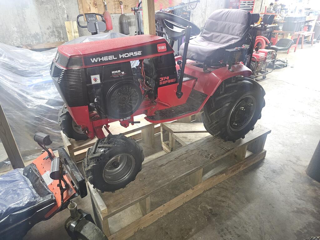

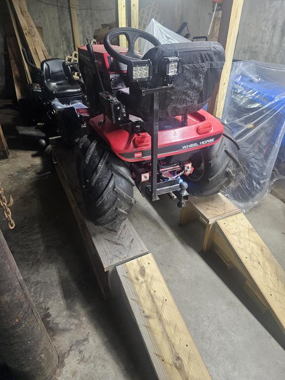

OldWorkHorse 3,156 #24900 Posted November 10, 2025 Not exactly to my wheel horse but for it to do things to it. Made a set of back savers for the horses. Gets them up a bit higher so im not bent over working on them all the time. Made them out of just scrap wood had laying around I needed to use. ramps can be removed and tucked out of the way and when I get width where I need it for what im driving up on it I use 2 2x4 to lock them from sliding apart. 2 9 Share this post Link to post Share on other sites
