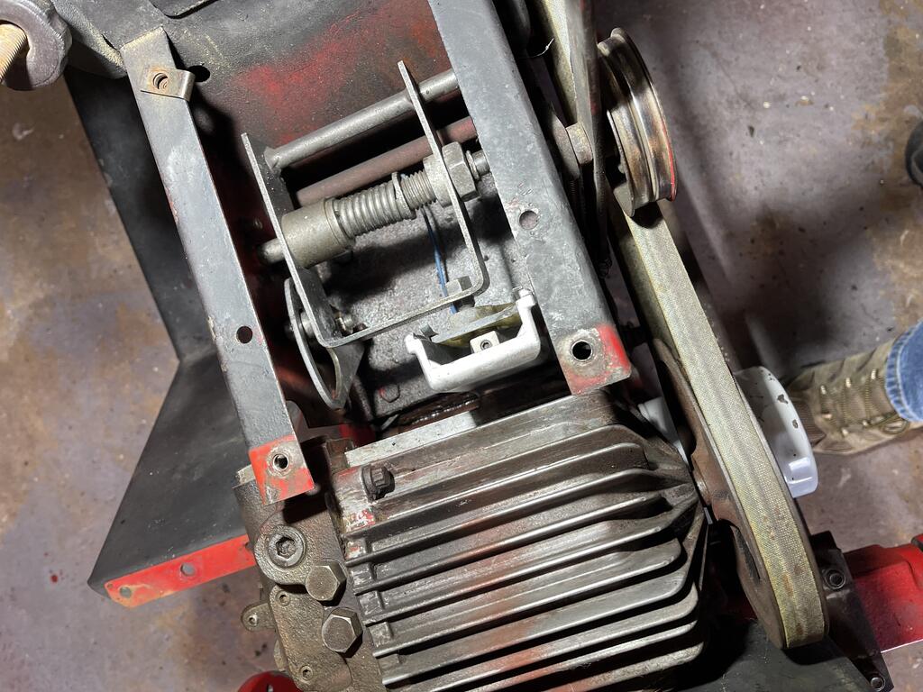

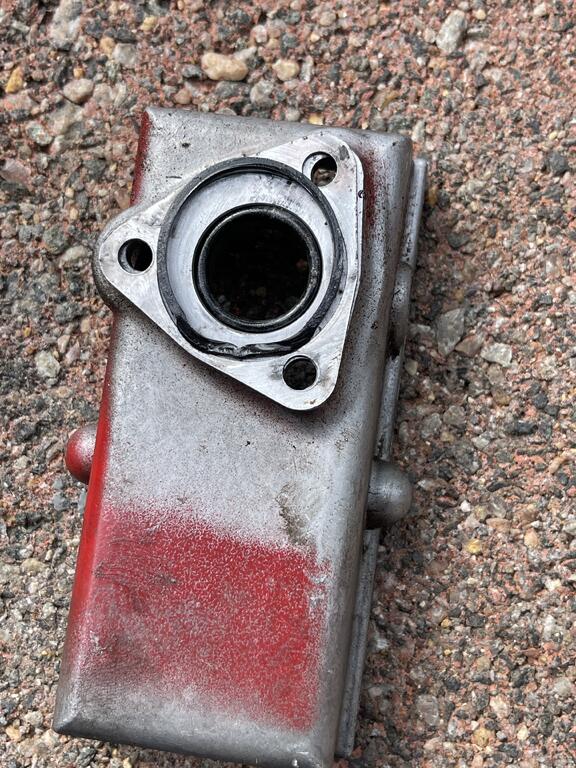

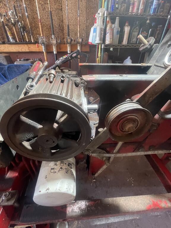

Wheelhorse#1 1,998 #24755 Posted October 23, 2025 Finally got to replace the O-rings in the pump for the Hydro motion control on my 1973 12 auto. Thanks to @pfrederi he was kind to send them to me . I decided to have a go without separating the trans. It’s doable thanks to the cut out on the right side ,was able to remove the motion control out of the way enough to replace the o-rings. hard part was putting it all back together. Some how one seal was smashed as if someone had this apart at some point and didn’t line it up correctly. I also replaced the axle seals wile I was it. Already for winter,hope fully we get some snow this yr 3 10 Share this post Link to post Share on other sites

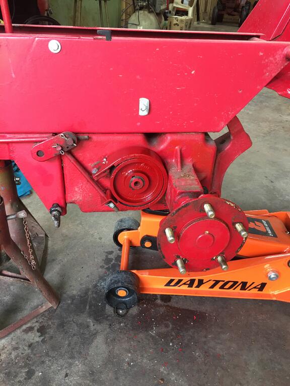

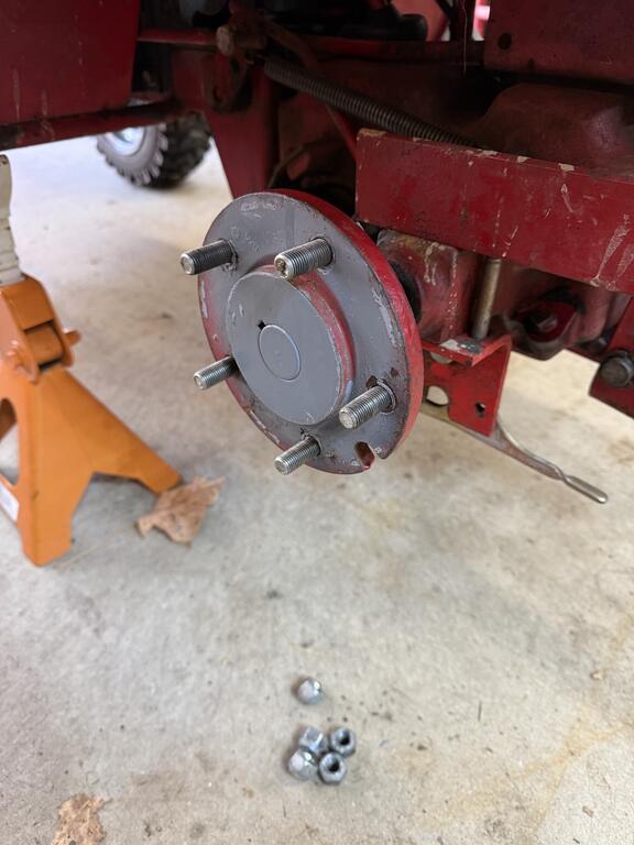

sqrlgtr 4,155 #24756 Posted October 23, 2025 Finished spraying wheels and installing new bearings for the C-160. Put mew brake lining that came from @rmaynard and went ahead and replaced brake shaft seal while I was into it and replaced lug bolts with studs. Sure makes mounting them loaded tires and wheels easier. 5 5 Share this post Link to post Share on other sites

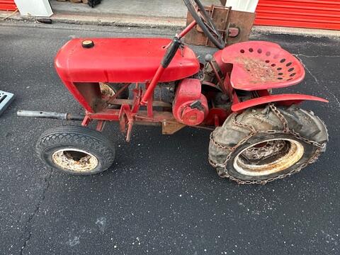

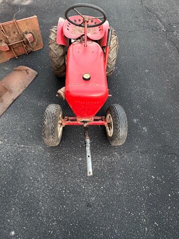

Lane Ranger 12,159 #24757 Posted October 23, 2025 On 10/20/2025 at 7:21 PM, Andy N. said: Glad I got those parts tractors to @WHX??'s plow day so I could make room for this RJ. Saw it on Marketplace when I got home yesterday and picked it up on my way home from work. Not running but has compression and shifts into all gears. Sheet metal is in great shape and looks to be all there. Came with mower deck and plow blade. Andy: was that the RJ for sale on Marketplace that was in Downers Grove, Illinois? It was bargain basement priced but you got a good one! 3 5 Share this post Link to post Share on other sites
ebinmaine 81,046 #24758 Posted October 23, 2025 3 hours ago, sqrlgtr said: replaced lug bolts with studs. EXCELLENT upgrade. We do this to every tractor. 5 Share this post Link to post Share on other sites
sqrlgtr 4,155 #24759 Posted October 23, 2025 Agree especially if you have loaded tires and like to swap wheels and tires around. 1 Share this post Link to post Share on other sites
ebinmaine 81,046 #24760 Posted October 23, 2025 12 minutes ago, sqrlgtr said: Agree especially if you have loaded tires and like to swap wheels and tires around. We do. Yes. Or just swap from one rig to another for whatever reason. 2 Share this post Link to post Share on other sites
Andy N. 2,881 #24761 Posted October 24, 2025 16 hours ago, Lane Ranger said: Andy: was that the RJ for sale on Marketplace that was in Downers Grove, Illinois? It was bargain basement priced but you got a good one! Yes sir it was! That's about 10 miles from me. PO wasn't sure when it ran last, but the sheet metal is all there and in decent shape. Engine seems to have good compression when I pulled it through. It will take some work to get going. Gas tank is rusty inside. It needs to be cleaned and sealed. I already found the correct hitch on eBay. 2 2 Share this post Link to post Share on other sites

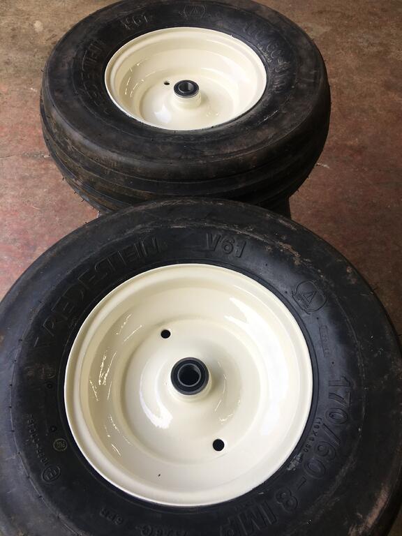

702854boy 1,191 #24771 Posted October 25, 2025 Last Monday I painted some wide rims for the back of a lawn ranger ivory white and then last night we mounted some 18 9.50 8 field master ag tires that we got for free back in June because our township was doing a tire clean up day and someone got rid of four of those tires so we snagged them up. 2 8 Share this post Link to post Share on other sites

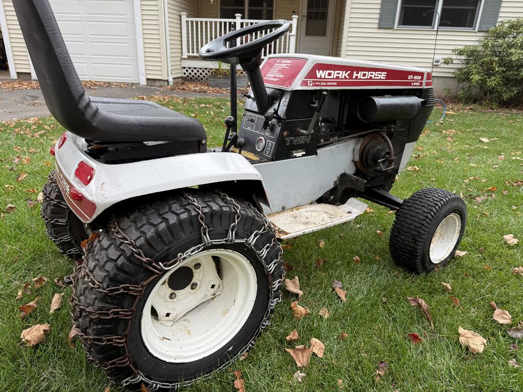

Sparky-(Admin) 26,621 #24772 Posted October 25, 2025 I’ve plowed with the GT-1600 (Kohler 14 Magnum swapped) for many many years. Thinking I might try my 520-8 with the swept axle (also a Kohler Magnum swapped rig). Started moving tires and weights and lug stud kit setups from one to the other. I swapped those rears without removing the 75 pounds of cast weight per wheel!! That was a chore!! Still have to decide which 48” plow this new plow rig will receive. I have a couple 5 sectors, it’ll definitely be one of those. The GT-1600 looks funny back in its regular tires/wheels. Not sure what will happen with the GT-1600 now, backup plow rig? Maybe sell? Maybe??? 6 2 Share this post Link to post Share on other sites
