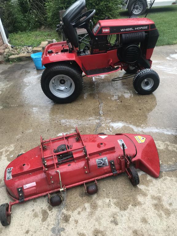

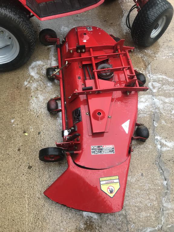

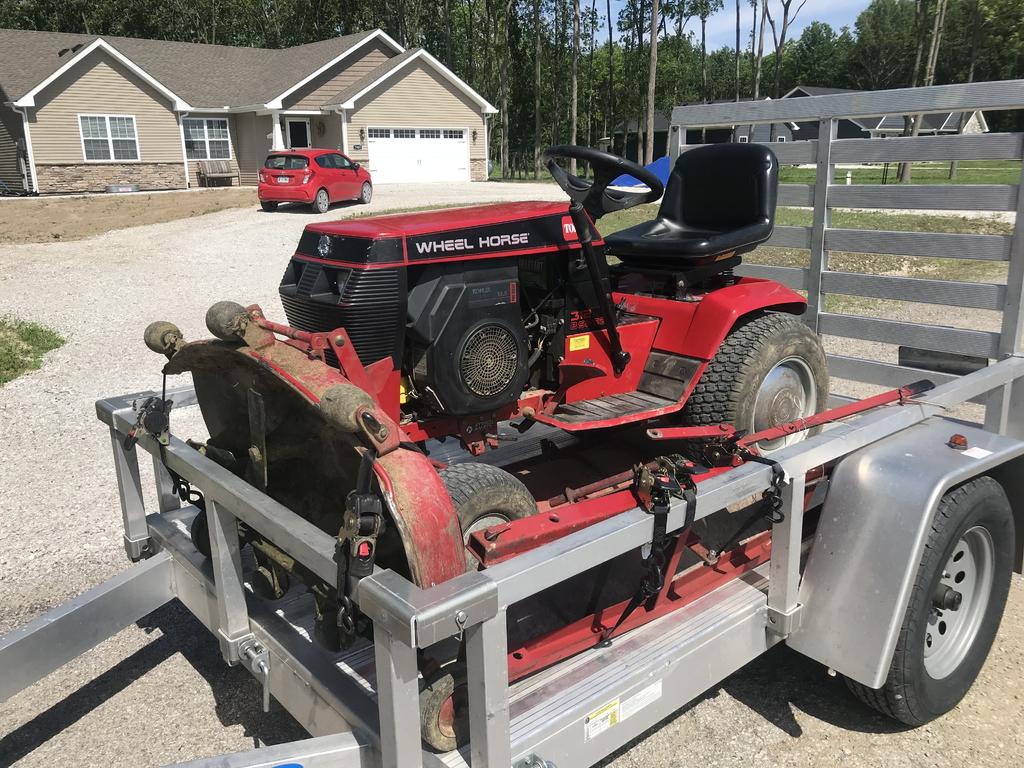

Lane Ranger 12,133 #2453 Posted June 9, 2019 Cleaned up my”new” 42 inch mower deck and 1999 Wheel Horse 312-8 today! 6 2 Share this post Link to post Share on other sites

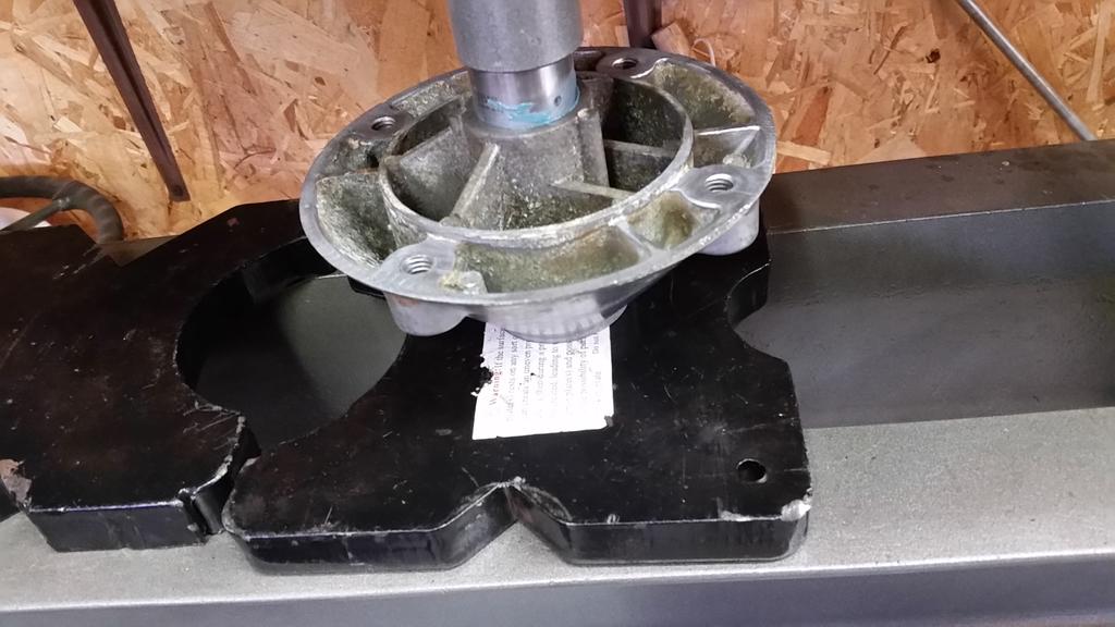

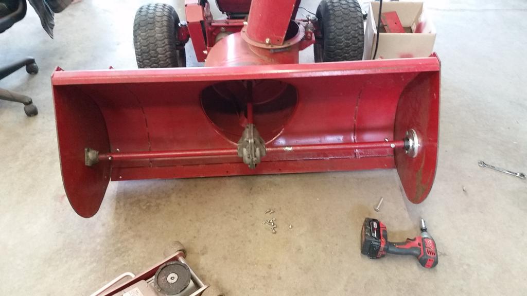

WHX?? 58,302 #2463 Posted June 10, 2019 (edited) I gotta rig up a front ball one of these day Horse Fan Put the 857 back together just to move it out the shop.Then cleaned up the shop abit and got the bike out of winter storage.. Axle bearings are going to have to wait on the 857 for another day. Worked on the'83 A-81 deck spindles.... all new bearings. Turns out they are the same very common B-1616 bearings and seals used in the 3 speed trannies. Plan is to make a high speed grass eatin beaver out of her! Z turns ain't gonna have nothin on her! FINALLY went to work on this deuce that @WVHillbilly520H was supposed to come over and finnish but he got no time! Got the upgrade bearing spacers made. Figured I best git at it since snow equipment is this years fearure at the BS....I know I know ... making a career out of this project but if @pullstart can make a project last a lifetime so can I 'Sides who wants to think snow in the summer! Was figuring @Achtowould get tired of seeing it in my garage and help out but nnnooooo ..he's too busy with new to hims! Just can't find good help these days! Edited June 10, 2019 by WHX24 2 4 Share this post Link to post Share on other sites

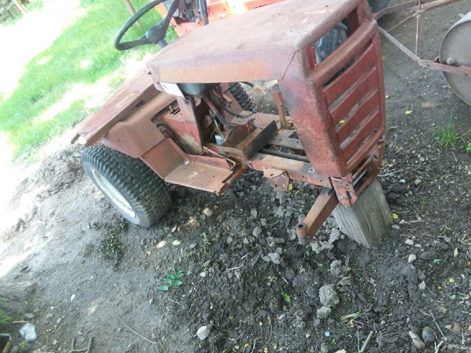

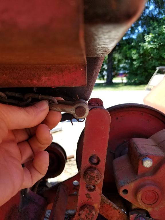

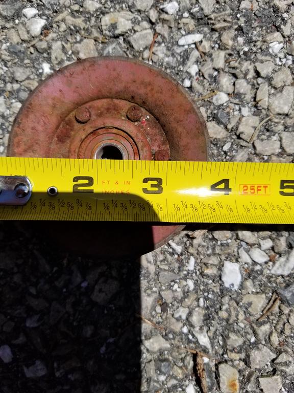

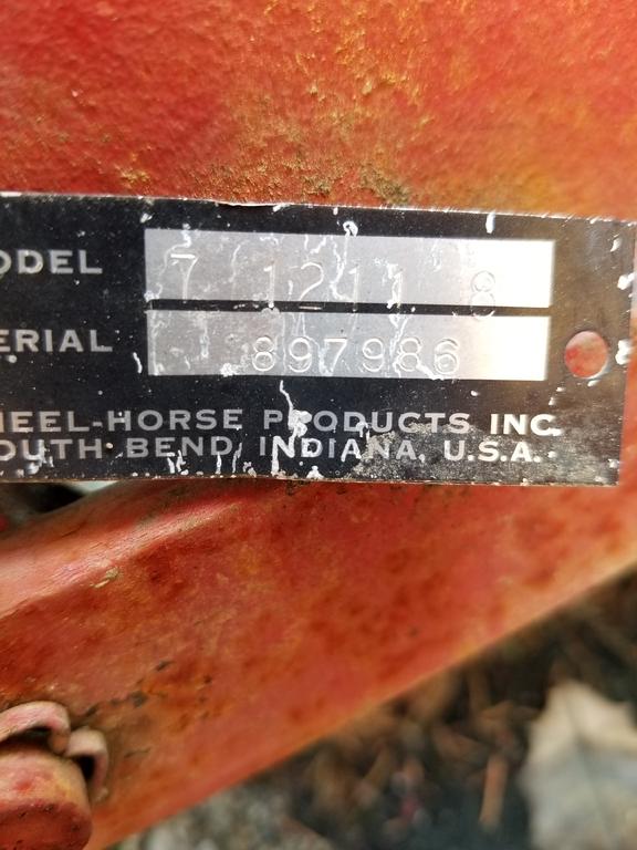

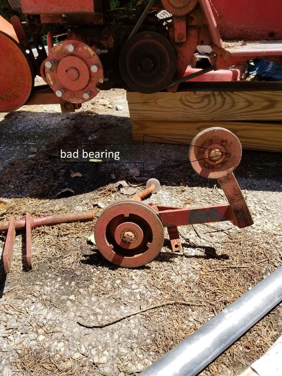

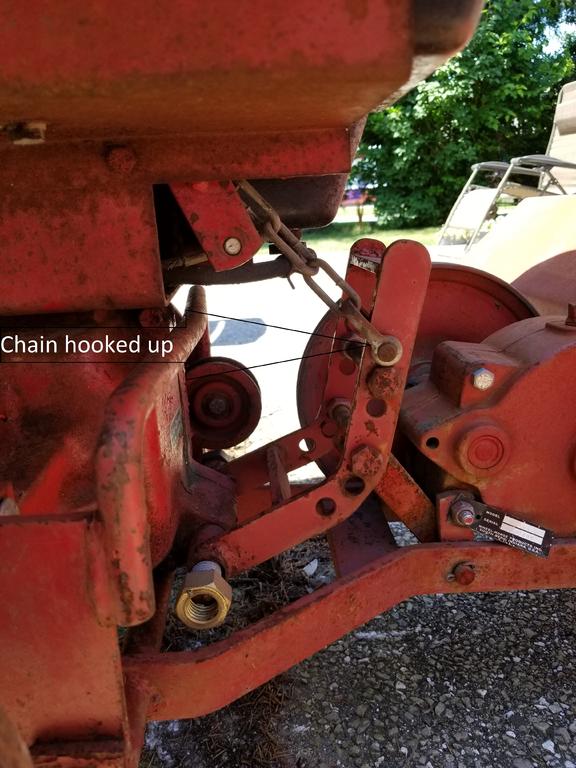

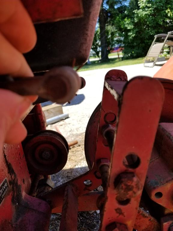

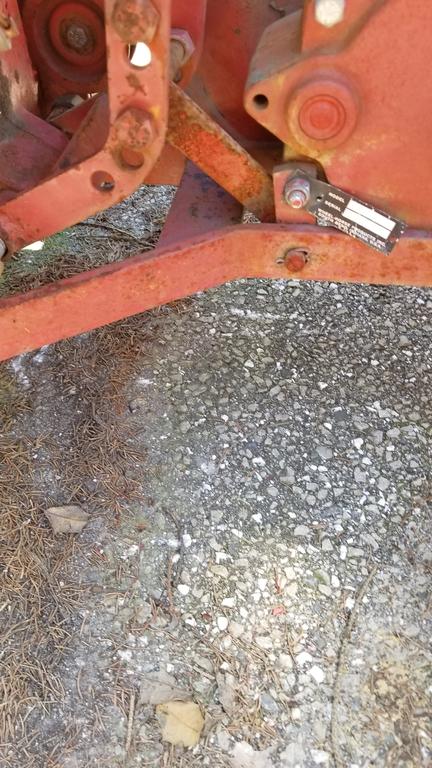

cafoose 3,878 #2465 Posted June 10, 2019 On 6/4/2019 at 8:55 PM, cafoose said: Trying to hook my 7-1211 tiller to my C161 and I don't know how to hook up the lift cable. I'm thinking if I hook it to the top of the bar near where I'm stretching it to it will work shown in the eighth image. However, I would have to drill a hole in the top of the bar to attach the chain. It also will be very close to the gas tank when lifted as shown in the seventh image and I'm concerned whether it will damage the gas tank. Maybe I can cut off a section of the bracket where it comes near the tank? I'm also looking for a replacement idler pulley because the bearing is rusted tight. I found this advertised for $50 and I'm thinking of getting it to put together for my tiller tractor I would need a few parts. I'm glad the Big Show is coming soon! 2 Share this post Link to post Share on other sites
953 nut 69,793 #2466 Posted June 10, 2019 6 hours ago, cafoose said: I would need a few parts. 5 Share this post Link to post Share on other sites
ebinmaine 80,909 #2467 Posted June 10, 2019 25 minutes ago, 953 nut said: Richard I don't know what you're aiming at but I'm only seeing three things he's missing. Engine. Wheels. Seat. What else could there be..... We're talkin like a 15 or 20 minute job here. 5 Share this post Link to post Share on other sites
WHX?? 58,302 #2468 Posted June 10, 2019 1 hour ago, ebinmaine said: 15 or 20 minute job here. I'd help or volunteer Pullstart here 'Foose but you might have it done in say...five years! 3 Share this post Link to post Share on other sites

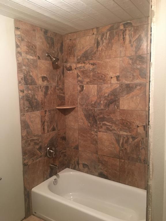

19richie66 17,937 #2472 Posted June 10, 2019 (edited) Let’s see....... “What have you done to your Wheel Horse today?” Well nothing. But I did finish my tile work. Couple pieces of trim and I’m moving on to the next project..... Edited June 10, 2019 by 19richie66 Forgot “the proof” 4 1 2 Share this post Link to post Share on other sites

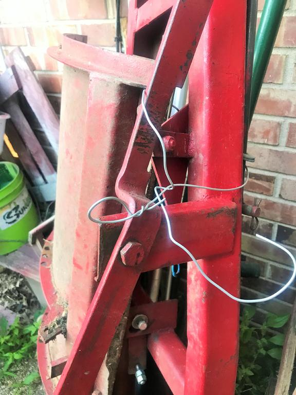

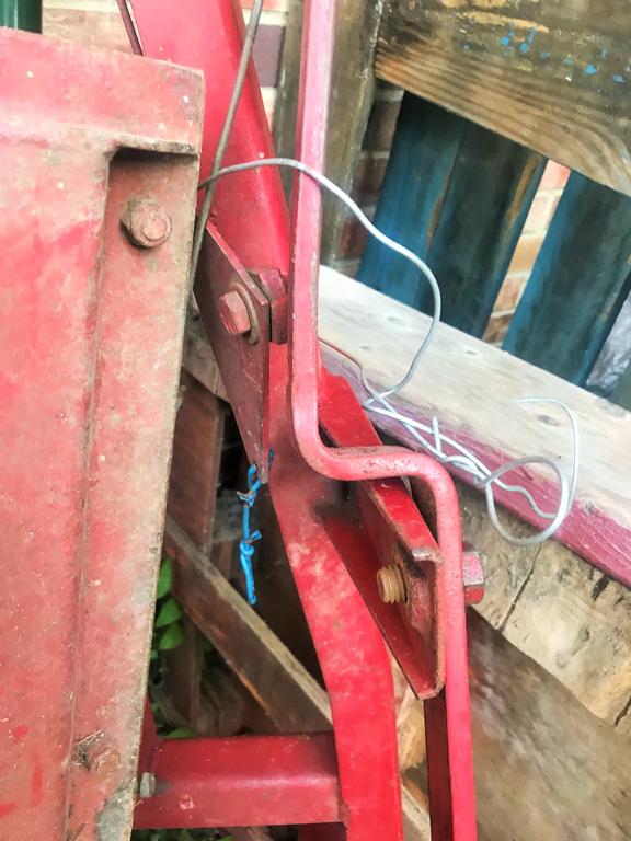

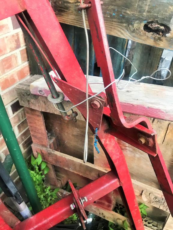

Tractor boy 239 #2473 Posted June 10, 2019 On 6/9/2019 at 12:31 PM, Lane Ranger said: Cleaned up my”new” 42 inch mower deck and 1999 Wheel Horse 312-8 today! @Lane Ranger if you get a chance could you take a picture of how that angle handle is mounted to the plow frame? Thinking i need to modify mine but wanted to cross check it Share this post Link to post Share on other sites
Lane Ranger 12,133 #2474 Posted June 11, 2019 49 minutes ago, Tractor boy said: @Lane Ranger if you get a chance could you take a picture of how that angle handle is mounted to the plow frame? Thinking i need to modify mine but wanted to cross check it Tractor boy: Here are some pics of the handle for angling the front dozer blade. You know this handle can be tunred around to clear your foot rest if need be on certain models. Share this post Link to post Share on other sites

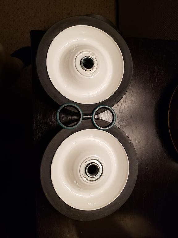

71_Bronco 1,073 #2475 Posted June 11, 2019 Got a new pair of deck wheels and axle seals for my Commando 8. Going to be installing them along with a wheels stud kit this weekend. 1 Share this post Link to post Share on other sites
