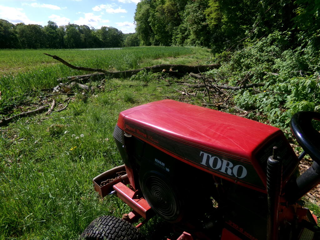

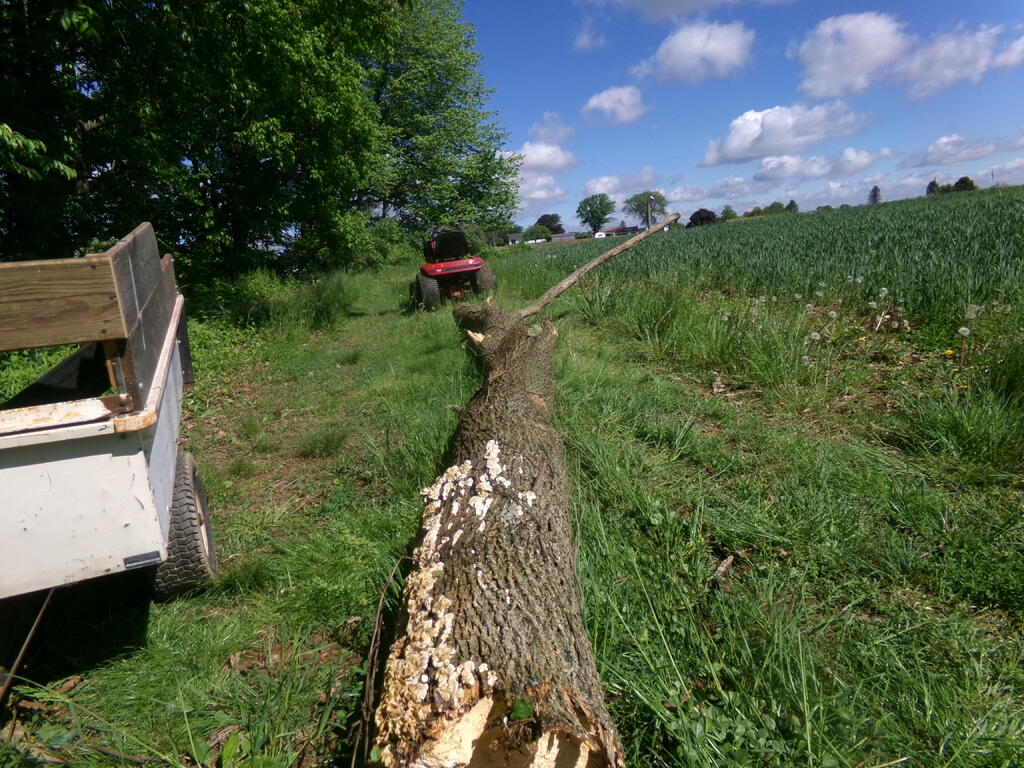

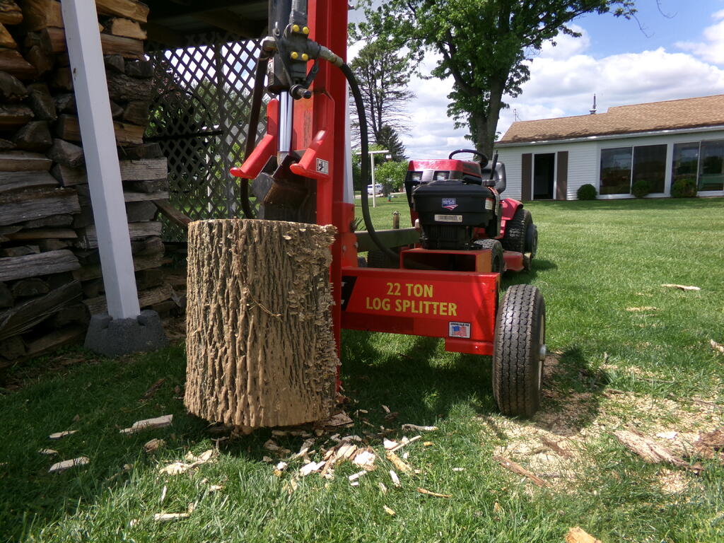

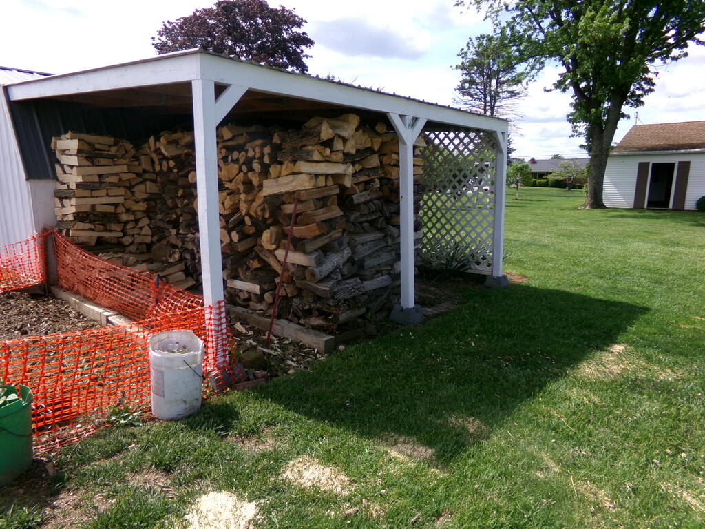

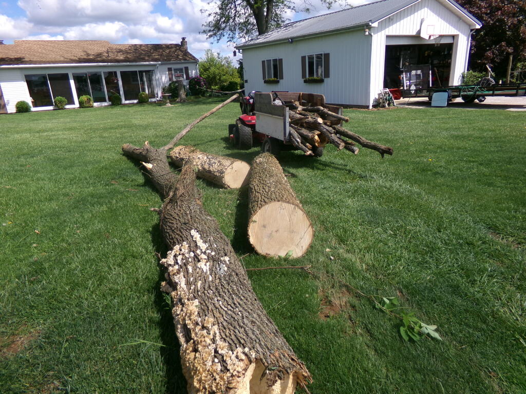

Ed Kennell 47,754 #23502 Posted May 7, 2025 (edited) Gave the 310-8 a workout. Nuther tree blew down in the field. The new Carlisle Turfs nuver spun a wheel. Cut, split, and stacked. Now for some cervical maintenance. Edited May 7, 2025 by Ed Kennell 9 14 Share this post Link to post Share on other sites

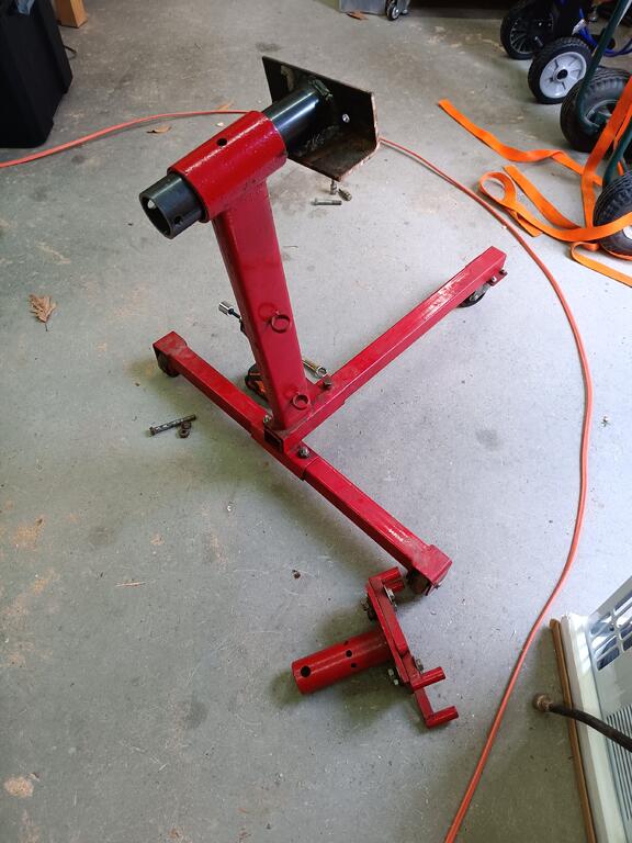

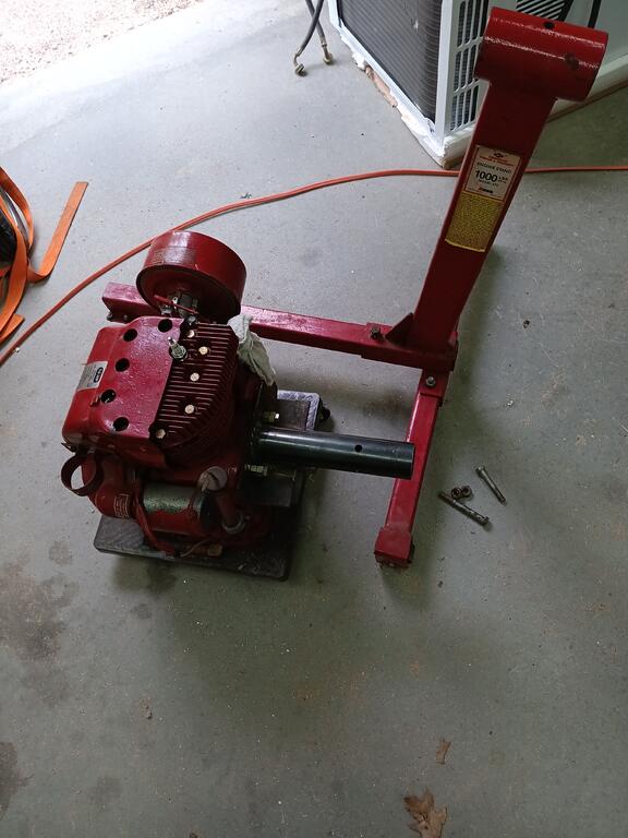

ebinmaine 81,050 #23503 Posted May 9, 2025 Back in January (??) I met @Handy Don and @Bill D for a pile of parts. I got this engine stand and "Bill built" Kohler holder. Also got this engine... It'll be coming apart for an inspection and balance gear removal and eventually be put into my 1974 C160-8 Cinnamon Horse. 6 4 Share this post Link to post Share on other sites

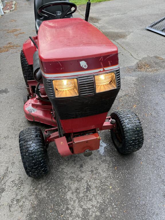

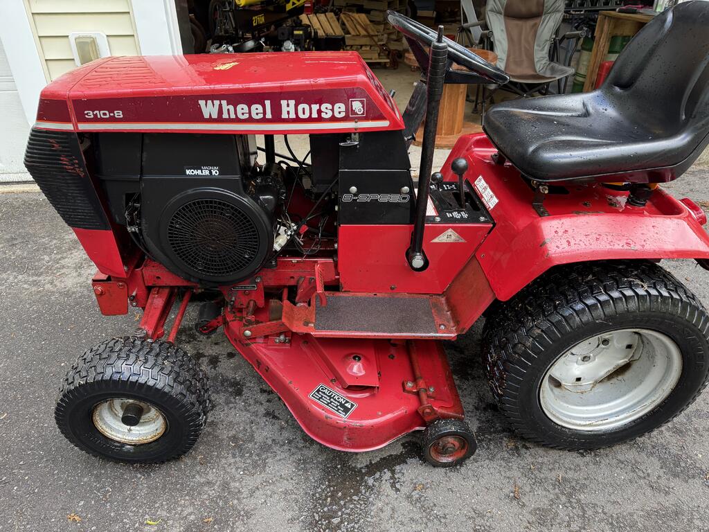

Sparky-(Admin) 26,621 #23504 Posted May 9, 2025 Selling a 310 for someone, brought it home, gave it a scrubbing, got it running, mowed a couple strips and assessed what it needs. Positive battery connection…passed with flying colors 9 3 Share this post Link to post Share on other sites
953 nut 70,076 #23505 Posted May 9, 2025 11 hours ago, ebinmaine said: I got this engine stand and "Bill built" Kohler holder. My Kohler Holder mounts to the two starter mounting holes. That way you can remove and install the crank shaft. I also made up a Hydro Holder for the engine stand that allows an Eaton to be rotated while being worked on. 1 5 Share this post Link to post Share on other sites
ebinmaine 81,050 #23506 Posted May 9, 2025 38 minutes ago, 953 nut said: My Kohler Holder mounts to the two starter mounting holes. That way you can remove and install the crank shaft. I also made up a Hydro Holder for the engine stand that allows an Eaton to be rotated while being worked on. Both excellent ideas. Now that you mentioned it this one may very well line up with those bolts. In this particular case I don't need to remove the crankshaft so I'll leave it where it is but for future reference, that's good to know. 1 Share this post Link to post Share on other sites

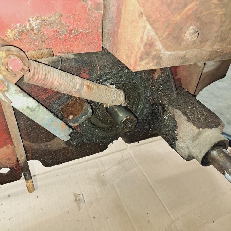

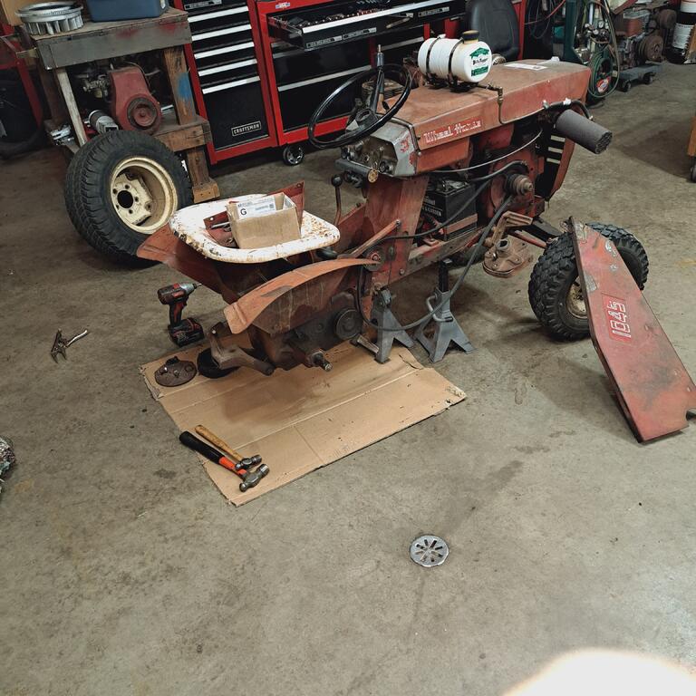

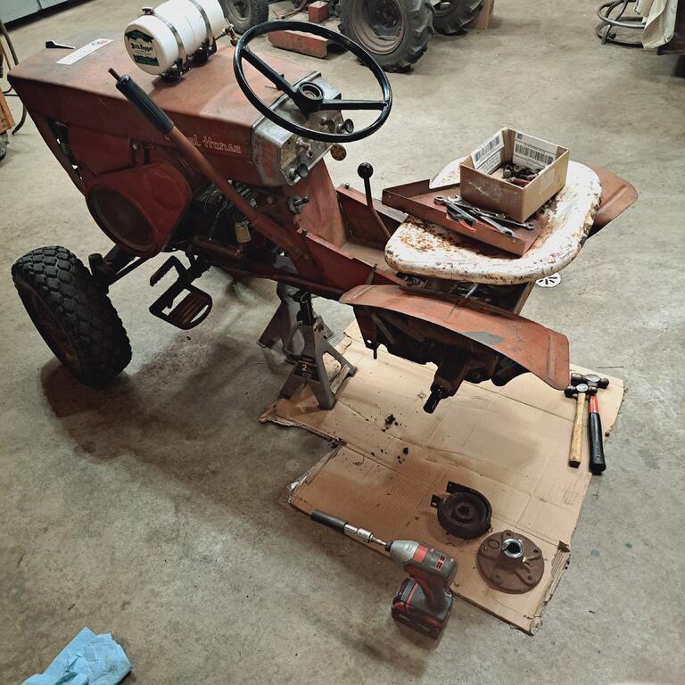

WHX?? 58,330 #23507 Posted May 9, 2025 On 5/7/2025 at 10:45 AM, Ed Kennell said: Carlisle Turfs nuver spun a wheel. Pretty good sized timber ther too! Brought the 1045 in for planned maintenance. Brake shaft seal leaking so no brakes. As these horses have it the left axle bearing is questionable. Not leaking yet but as long as it's this far apart some new bearings might be in order? Passenger side bearing is good so that reinforces my suspicion that the driver side sees more wear from left turning while mowing. I could be full of horse doo doo on that but this is the umpteenth one I had like this. When I got this one the hub ways were roached so I broached them. Set screws were wicked loose and hubs slid right off so I need to follow my own advice and check tightness more often, Hitch pin will be Richard's rite of passage. 6 1 Share this post Link to post Share on other sites
Ed Kennell 47,754 #23508 Posted May 9, 2025 7 minutes ago, WHX?? said: Pretty good sized timber ther too! About a 40' Elm. Nuther victim of the Ophiostoma Fungus. She broke off half way up. 2 Share this post Link to post Share on other sites

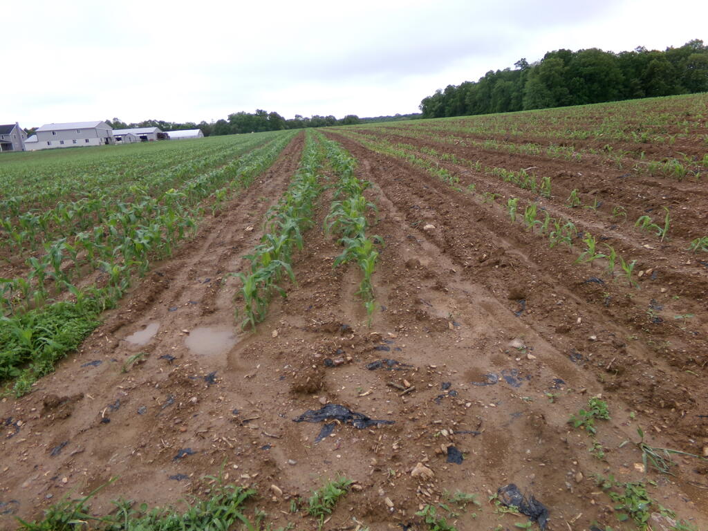

WHX?? 58,330 #23509 Posted May 9, 2025 2 minutes ago, Ed Kennell said: About a 40' Elm. What's planted in that field Ed Dog?? Looks pretty good already for this early. Share this post Link to post Share on other sites
squonk 48,288 #23510 Posted May 9, 2025 On 5/7/2025 at 11:45 AM, Ed Kennell said: Gave the 310-8 a workout. Nuther tree blew down in the field. The new Carlisle Turfs nuver spun a wheel. Cut, split, and stacked. Now for some cervical maintenance. What's that blue stuff in the sky? 4 Share this post Link to post Share on other sites
Ed Kennell 47,754 #23511 Posted May 9, 2025 (edited) 37 minutes ago, WHX?? said: What's planted in that field Ed Dog?? Looks pretty good already for this early. That's just a winter wheat cover crop. He'll pasture the horses in it, then plow it under for the nitrogen. As soon as he finishes planting the sweet corn, this field will get planted in cantaloupe. This is the sweet corn field. It was all planted under plastic that he just removed last week. He plants about 10 rows every week so he has corn ready all summer starting from early July. Two rows are planted under each sheet of plastic with a space between each pair of rows wide enough for a horse to pull a produce box down the row for picking. 30 minutes ago, squonk said: What's that blue stuff in the sky? A one day break from the monsoon. Edited May 9, 2025 by Ed Kennell added box 9 Share this post Link to post Share on other sites

kpinnc 19,036 #23513 Posted May 9, 2025 (edited) 1 hour ago, WHX?? said: As these horses have it the left axle bearing is questionable. Not leaking yet but as long as it's this far apart some new bearings might be in order? You can probably just push the original bearing in without splitting the case and add the new one behind it. It will not affect anything at all. I would not do this with a hydro, but 3/4/6/8 speeds are ok. ...Assuming the old bearing is intact and together of course. Same for the axle itself. Edited May 9, 2025 by kpinnc 1 1 Share this post Link to post Share on other sites

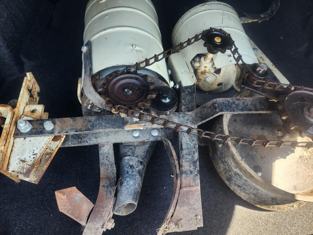

Goldnboy 1,155 #23514 Posted May 9, 2025 Came in late to work...to pick up this nice planter an hour from home..even scored the row marker. Any leads to chisel points? Should be the same as brinly... 9 Share this post Link to post Share on other sites

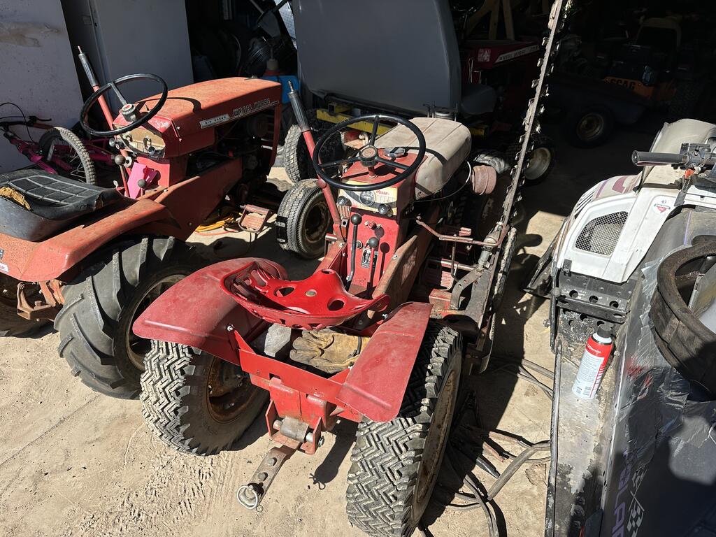

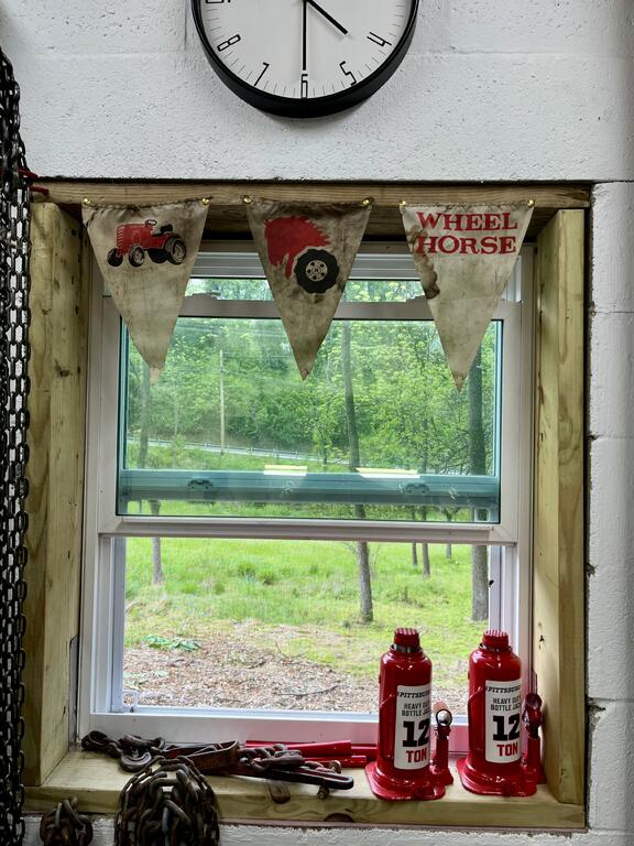

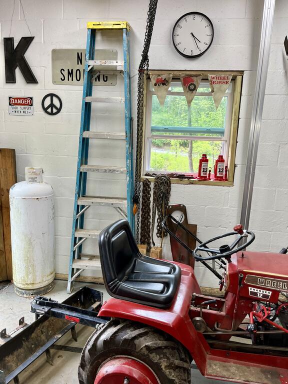

BrianKoch 370 #23515 Posted May 9, 2025 (edited) Prepping the ‘68 Charger 12 for grading work this weekend. Also hung up these WH pendants in the shop window. Edited May 10, 2025 by BrianKoch 7 3 Share this post Link to post Share on other sites
WHX?? 58,330 #23516 Posted May 9, 2025 1 hour ago, kpinnc said: You can probably just push the original bearing in I didn't think you could KP? I thought there was a boss there that the bearing set against or the cases were only machined so deep. Now you got me thinking and that can be more dangerous than Pullstart with a 3/8 drill... Every one I did the cases were split so really don't know. 1 2 Share this post Link to post Share on other sites
squonk 48,288 #23517 Posted May 9, 2025 If the bearing is bad, chances are the axle has some imperfections that will ruin a new bearing prematurely. Take it apart and inspect it. 2 Share this post Link to post Share on other sites
kpinnc 19,036 #23518 Posted May 9, 2025 2 hours ago, WHX?? said: I didn't think you could KP? I thought there was a boss there that the bearing set against or the cases were only machined so deep. Now you got me thinking and that can be more dangerous than Pullstart with a 3/8 drill... You can push one further in with no issues. There is no boss or flange on the outer axle bearings. But @squonk is correct that you have to be sure the axle isn't damaged. 3 Share this post Link to post Share on other sites

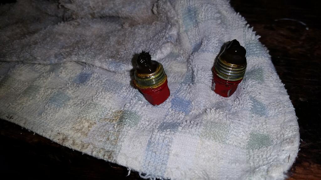

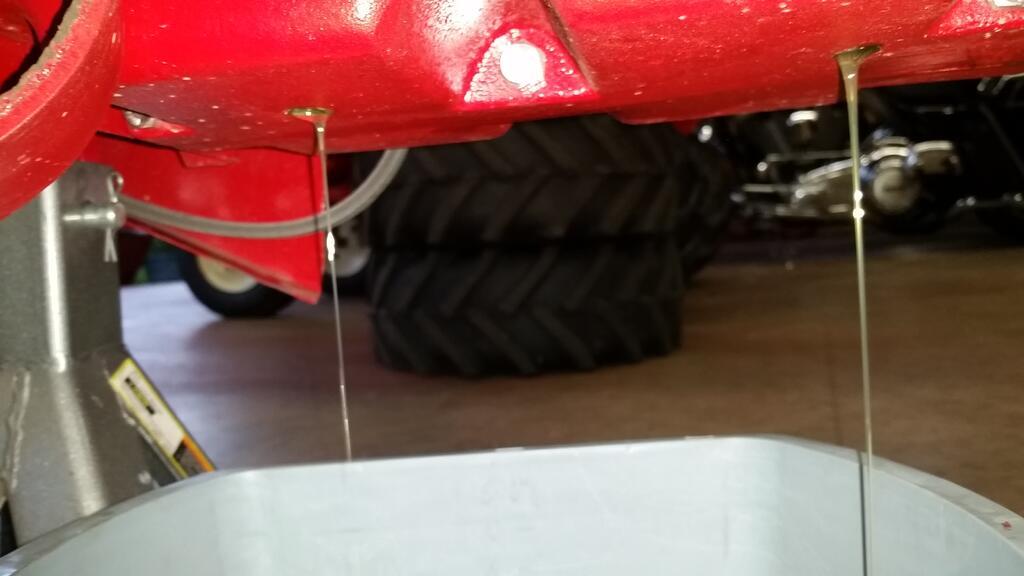

WHX?? 58,330 #23519 Posted May 9, 2025 (edited) 23 minutes ago, kpinnc said: no boss or flange on the outer axle bearings You are correct sir ... I just check a three speed case on the shelf. It could be pushed in. On the other hand Squonkys got a point. A guy could inspect the axle after it's been pushed in BUT with a big but ... read these type of bearings should be pressed in and that would be tough. Have to block it up on the press apron some how. Now I have hammered them in before I knew any better but would probably need a custom hollow driver with the axle in. I think I will just split it just to inspect 3rd gear and clean her up & check the rest of the gizzards. Add a second drain plug over the hump ... Since you guys like pictures ... Edited May 9, 2025 by WHX?? 5 5 Share this post Link to post Share on other sites
kpinnc 19,036 #23520 Posted May 9, 2025 6 minutes ago, WHX?? said: Add a second drain plug over the hump ... That's a very good idea. 2 Share this post Link to post Share on other sites

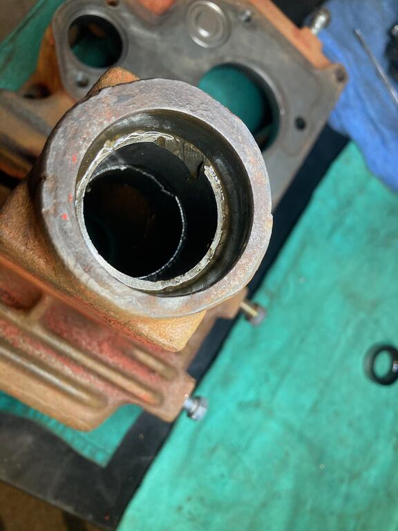

ineedanother 2,885 #23521 Posted May 9, 2025 35 minutes ago, kpinnc said: You can push one further in with no issues. There is no boss or flange on the outer axle bearings. But @squonk is correct that you have to be sure the axle isn't damaged. Really interesting that you guys are talking about this. I have a hydro on my bench right now. I knocked the bearing out from the inside a couple days ago. Looking in the case tonight, this is what I see 2 2 Share this post Link to post Share on other sites
WHX?? 58,330 #23522 Posted May 9, 2025 3 minutes ago, ineedanother said: hydro on my bench right now That's what I thought gear jammers had. ! 1/8 axles Ineed? 1 Share this post Link to post Share on other sites
ineedanother 2,885 #23523 Posted May 9, 2025 (edited) 3 minutes ago, WHX?? said: That's what I thought gear jammers had. ! 1/8 axles Ineed? Isn't that something? Apparently someone went in there with a chisel and got most of the bearing out and then just pressed the new one in. The one I pressed out was in tact but getting replaced since the case is separated. I never would have even looked if it wasn't for this thread. Timely. Yes, 1 1/8" Edited May 9, 2025 by ineedanother 2 1 Share this post Link to post Share on other sites

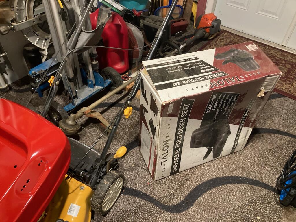

ineedanother 2,885 #23524 Posted May 10, 2025 Wrestled a seat down from the overhead storage this evening. I think I'll put lipstick on a pig this weekend 4 4 Share this post Link to post Share on other sites

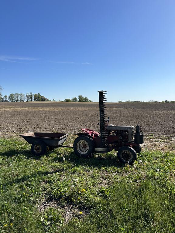

Pullstart 71,483 #23525 Posted May 10, 2025 Some may recall the smoking deal on this sickle machine I got from @pfrederi. I tossed a hitch on, so I can drag stuff around. I love it! 8 5 Share this post Link to post Share on other sites
