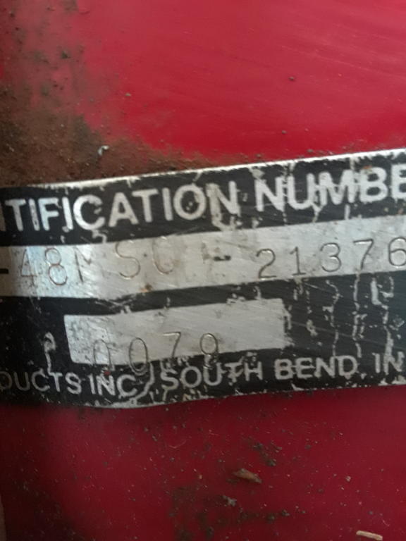

ericj 1,580 #2326 Posted May 22, 2019 10 hours ago, Goldann520 said: @PeacemakerJack ya they're quite desirable down Charlotte way here. Have had a few people asking to find these. I like it cause its only 2 years made, hydraulic lift (i dont do lift handles anymore), 16 hp, kohler, old style hood and dash, it was complete, whats not to like. The tricks gonna be doing all this work on the cheap. 😀 it needs a lot. So far ive had parts in stock. Got the intake valve, had the starter solenoid it needed. And came with a solid 42 deck. are you sure that's a 42", the one's with the plate over the spindles and the height adjuster on the left are usually 48" decks. good luck eric j Share this post Link to post Share on other sites
Goldann520 242 #2327 Posted May 22, 2019 @PeacemakerJack ya they're quite desirable down Charlotte way here. Have had a few people asking to find these. I like it cause its only 2 years made, hydraulic lift (i dont do lift handles anymore), 16 hp, kohler, old style hood and dash, it was complete, whats not to like. The tricks gonna be doing all this work on the cheap. 😀 it needs a lot. So far ive had parts in stock. Got the intake valve, had the starter solenoid it needed. And came with a solid 42 deck. 1 Share this post Link to post Share on other sites
Goldann520 242 #2328 Posted May 22, 2019 (edited) 48 even better, Thanks i will measure again, or run the tag. @ericj Edited May 22, 2019 by Goldann520 Share this post Link to post Share on other sites
Goldann520 242 #2329 Posted May 22, 2019 @ericj good call! It is a 48". Man am i getting old and slipping. Share this post Link to post Share on other sites

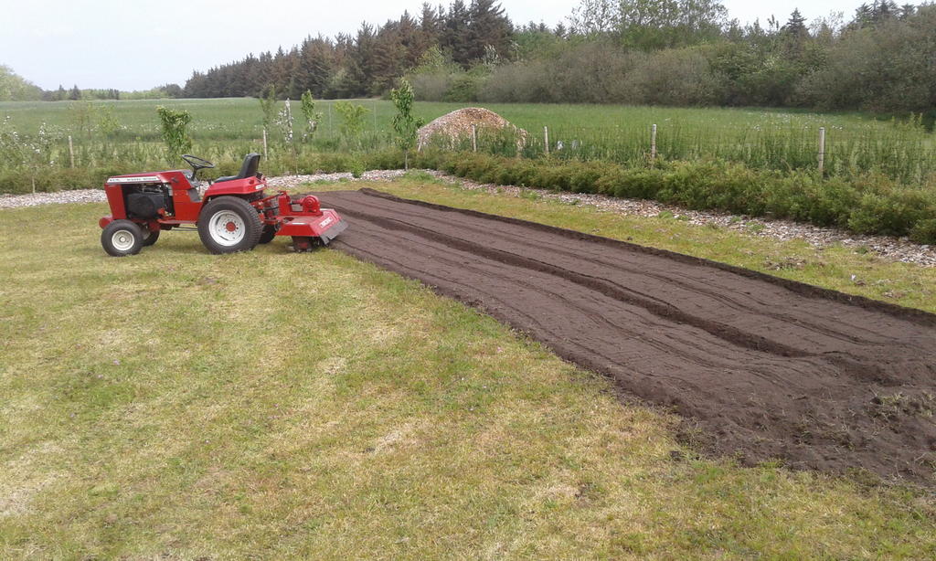

Skipper 1,792 #2330 Posted May 22, 2019 Tilled a little patch for the kids to grow some peas and stuff in. Still amazed how fine a job that 50" tiller does. 4 7 1 Share this post Link to post Share on other sites
pfrederi 21,217 #2331 Posted May 22, 2019 47 minutes ago, Skipper said: Tilled a little patch for the kids to grow some peas and stuff in. Still amazed how fine a job that 50" tiller does. Where are the rocks??? After 18 years i have a small garden area...very small that might look like that. When i use my tiller on raw land here it is absolutely painful as it hops up and down banging off the rocks. 4 2 1 Share this post Link to post Share on other sites

Skipper 1,792 #2334 Posted May 23, 2019 Yeah I had rocks all over the place too. borrowed a big loader from a friend and dug 2 feet of the whole graden lot, and replaced with fresh top soil from a close by area that was digging some large put and take ponds. 4 1 Share this post Link to post Share on other sites

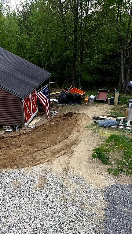

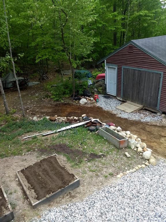

ebinmaine 80,910 #2335 Posted May 23, 2019 1 hour ago, pfrederi said: rocks Do you have stone walls out there or is that reserved for the Northeast? I saw small piles of rocks in the Dakotas when we were there a few years back. Blew my mind that they had so few.... Trina and I live about halfway up a small mountain ridge and over the eons it had crumbled to what it is today. Our land surface is well more than half consisting of stones rocks and boulders. Tilling for a garden here would be absolutely futile. Raised beds are the way. 1 Share this post Link to post Share on other sites

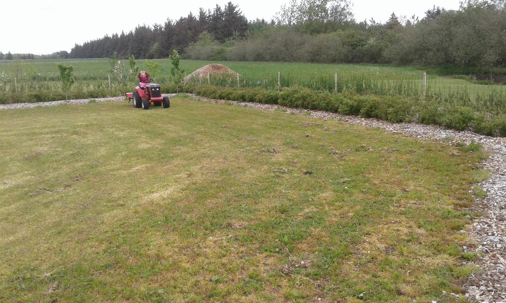

ZXT 2,402 #2347 Posted May 25, 2019 Well, today (and last night) I slapped together the K321 for my (used to be) Tecumseh powered C120. I assembled it on the tailgate of one of my trucks. No shop or nice clean space for me! Hopefully I was able to keep small particulate out of it. Got it on the tractor around dark. Found a random coil and installed it temporarily, and it fired right up and sounds good! Hopefully it'll stay together for a while, considering I'd never been inside one before and the crank was used. Now I just need to find the correct bracket so that I can engage my PTO and wire the ignition and stator properly. I'm still getting over being sick, and was sick when assembling the engine and forgot to take any pictures of the process. Here's a video of the finished product. I had painted up a shroud that was on my pile and it was for a starter that had the mounting ears on the top side of the starter rather than the bottom.. Not quite sure what application would use that, but I'm cleaning up the correct shroud to put on it. IMG_6607.MOV 3 2 Share this post Link to post Share on other sites

ebinmaine 80,910 #2349 Posted May 25, 2019 @LengerichKA88 @Mows4three @sebringwh Well today was quite a productive day for Trina and her mom and I. Tomorrow is going to be a logging day for us so we were preparing the saws and tractors and splitter for duty. Yeesss I'm sure there'll be pictures... The garden was put in by Trina's mom. They spent more time working on the chicken run. On the Cinnamon Horse I retorqued the head bolts and let it run for a few minutes and upon returning to it I noticed fuel all over the top of the tank and running down the tractor as far as the step. I changed out the cap and the problem did not go away but was better. I put a straight edge across the top of the tank and noticed a couple of low spots so I adjusted that with a hammer. Gently of course. That seems to have eliminated about 99% of the problem so we'll try it out and see how it goes. Trina took a couple of staged pictures with the flag for @fast88pu Kyle's thread. The last 90 minutes or so at the end of the day we spent some time "harvesting rocks" and grading the contour in front of the shed. She removed at least 5 or 6 inches from the top on the left side. Filled in the valley bottom a bit. Also scraped more from the hill across the front of the stone wall. The gravel that is removed from there will be used around the corner inside the chicken run or just flattening out the land beside the shed. There's at least enough in the pile to fill one of those 10 cube trailers. 4 1 Share this post Link to post Share on other sites

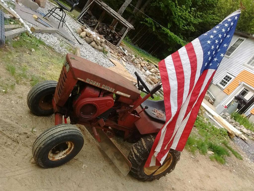

adsm08 5,194 #2350 Posted May 25, 2019 I drug my mom's 65 Mustang around today with my 65 Wheelie Horse. They are both red. I needed the Mustang out of the garage so I can do some work on the engine and trans of my Ranger. I wanted it parked away from the second door, so it had to go down the hill and back up the hill at the end of the garage. Last time I pushed it up that hill I think I almost had a heart attack, so I towed it this time. I was impressed with how easily it pulled that heavy car up the hill. She didn't even think twice about it. 3 2 Share this post Link to post Share on other sites
