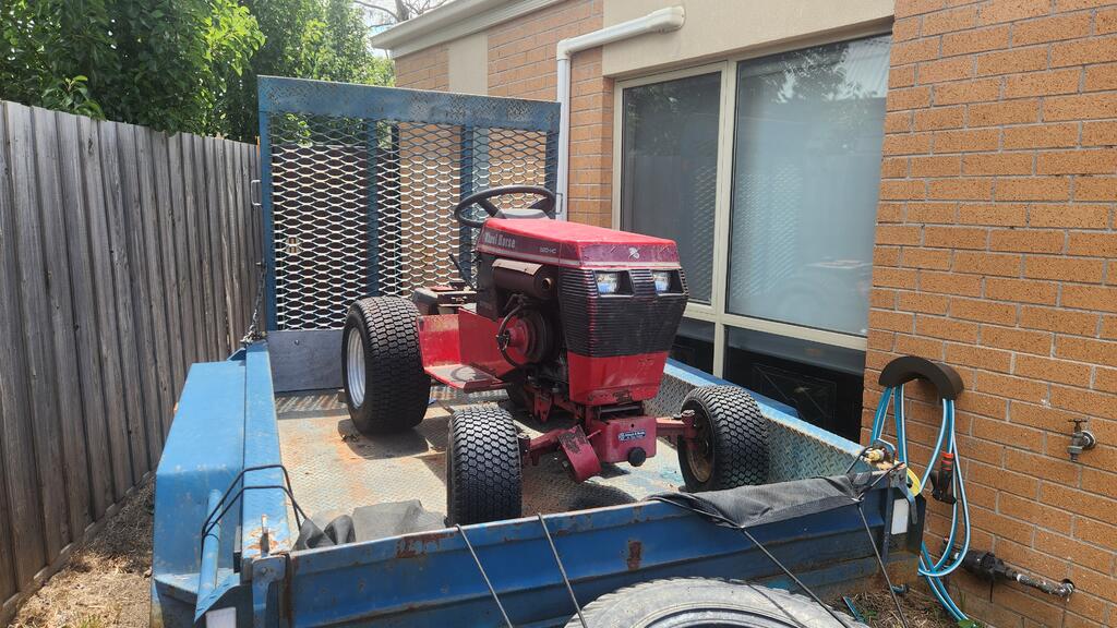

rjg854 13,311 #22727 Posted January 14, 2025 @Red Stallion I wonder how they drove that tractor across the ocean Just how many hours are on that rig 1 3 Share this post Link to post Share on other sites
kpinnc 18,886 #22728 Posted January 14, 2025 1 hour ago, rjg854 said: wonder how they drove that tractor across the ocean 4 1 Share this post Link to post Share on other sites
ebinmaine 80,311 #22729 Posted January 14, 2025 3 minutes ago, kpinnc said: Me 🐻 was gonna go with big flotation tires but I like your answer much much better 1 Share this post Link to post Share on other sites

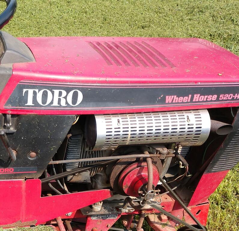

Lee1977 7,750 #22738 Posted January 15, 2025 I cut my belt guard in two, you don't need it on a hydro like you do on an 8 speed. 5 Share this post Link to post Share on other sites

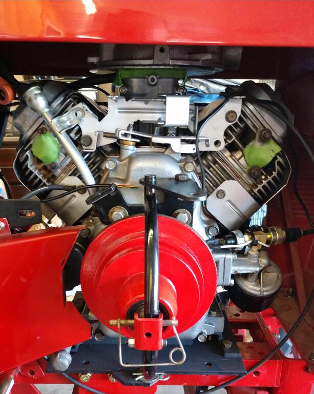

kpinnc 18,886 #22739 Posted January 15, 2025 (edited) V twins don't have this issue... Edited January 15, 2025 by kpinnc 3 4 Share this post Link to post Share on other sites

8ntruck 9,219 #22741 Posted January 15, 2025 @kpinnc - what kind of V twinning is that? I'm thinking ahead for a replacement of the KT19 in my C-195. I've not got a good feeling about it - hopefully I'm wrong, though. Share this post Link to post Share on other sites
JCM 11,396 #22742 Posted January 15, 2025 9 hours ago, Lee1977 said: I cut my belt guard in two, you don't need it on a hydro like you do on an 8 speed. Very nice first Gen 520-H @Lee1977 Share this post Link to post Share on other sites

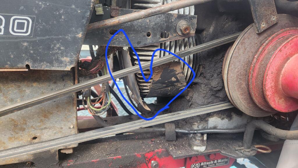

Red Stallion 231 #22743 Posted January 15, 2025 On 1/14/2025 at 3:21 PM, Handy Don said: Just to avoid any misunderstanding, @Ed Kennell’s word “tins” is referring to the metal shrouds on the engine, not the metalwork of the tractor body. It is no picnic removing and then remounting them on the Onans (enjoy the, but DON’T drop, the one bolt underneath the ignition coil, or the two bolts that are reached up through holes in the engine mounting plate on the flywheel side, and also disconnecting/reconnecting the fuel pump pulse feed hose 😄) but it is an absolute must for a new-to-you tractor to check for obstructions and oil filter seal leakage. Do you mean these two bits that look like heat shields? Should I remove them completely, plus cut some speed holes in the belt guard? Share this post Link to post Share on other sites
lynnmor 9,013 #22744 Posted January 15, 2025 1 hour ago, Red Stallion said: Do you mean these two bits that look like heat shields? Should I remove them completely, plus cut some speed holes in the belt guard? The one on the left is easy, it is a separate piece. The one on the right is part of the shroud on the opposite side. To remove the shroud, there are two bolts on the bottom that are accessed thru holes in the mounting plate, another bolt is in the ignition coil area, the rest are easy and not a problem. Yes, it isn't an easy job but it rarely needs done IF you stop all oil leaks. Share this post Link to post Share on other sites

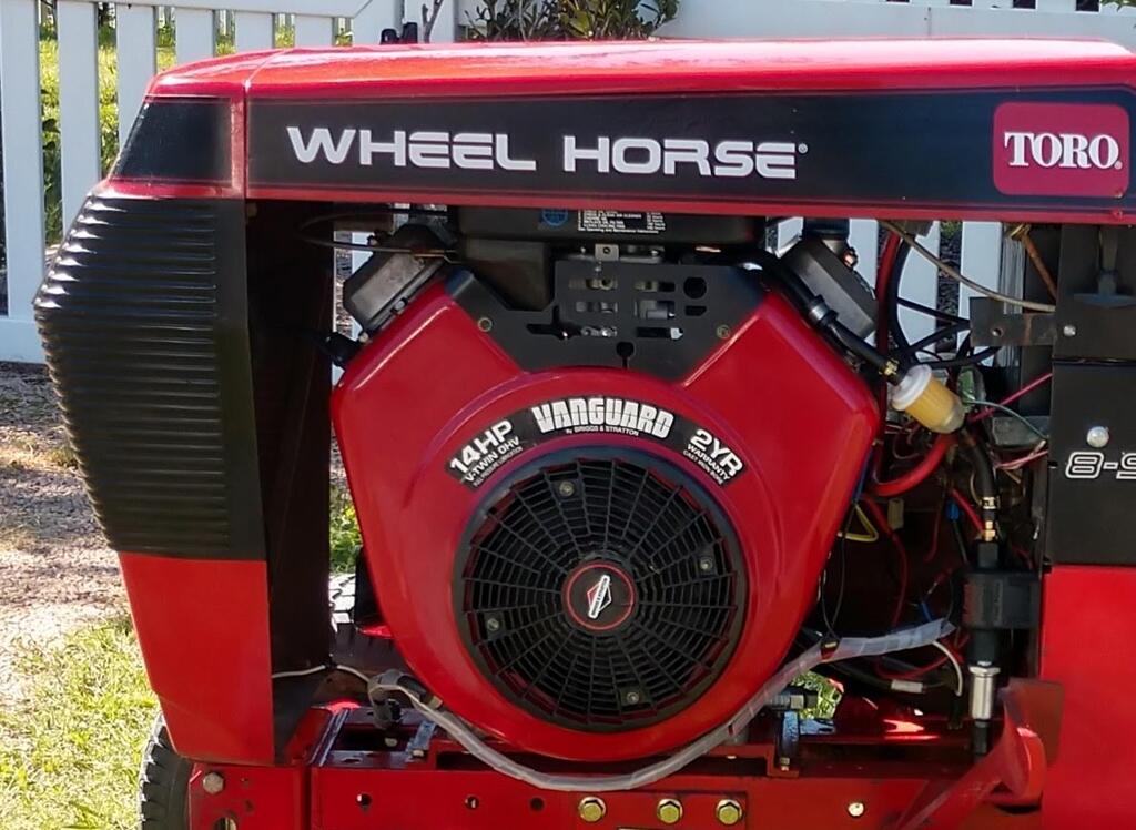

kpinnc 18,886 #22745 Posted January 15, 2025 8 hours ago, 8ntruck said: @kpinnc - what kind of V twinning is that? I'm thinking ahead for a replacement of the KT19 in my C-195. I've not got a good feeling about it - hopefully I'm wrong, though. Vanguard 23hp. I also have a repower machine with a 14hp. 1 1 Share this post Link to post Share on other sites
Ed Kennell 46,996 #22746 Posted January 15, 2025 11 minutes ago, lynnmor said: The one on the left is easy, it is a separate piece. Yes these thin metal engine shrouds are the "tins" that should removed to effectively clean the cooling fins and to inspect and repair any oil leaks. The fins on the left although dirty, do look dry. There does appear to be a leak on the right. As we all know, removing and installing all the engine tins is not easy, but it is necessary to properly maintain the engine. This is also the time to remove the heads and decarbon the combustion chamber and adjust the valves. Again, I also stress this is the time be sure there is no oil seeping from the oil filter base plate. This is in a critical location where any leaking oil is blown across the rear cooling fins causing the sticky mess that attracts the grass clippings that clog the fins. Share this post Link to post Share on other sites

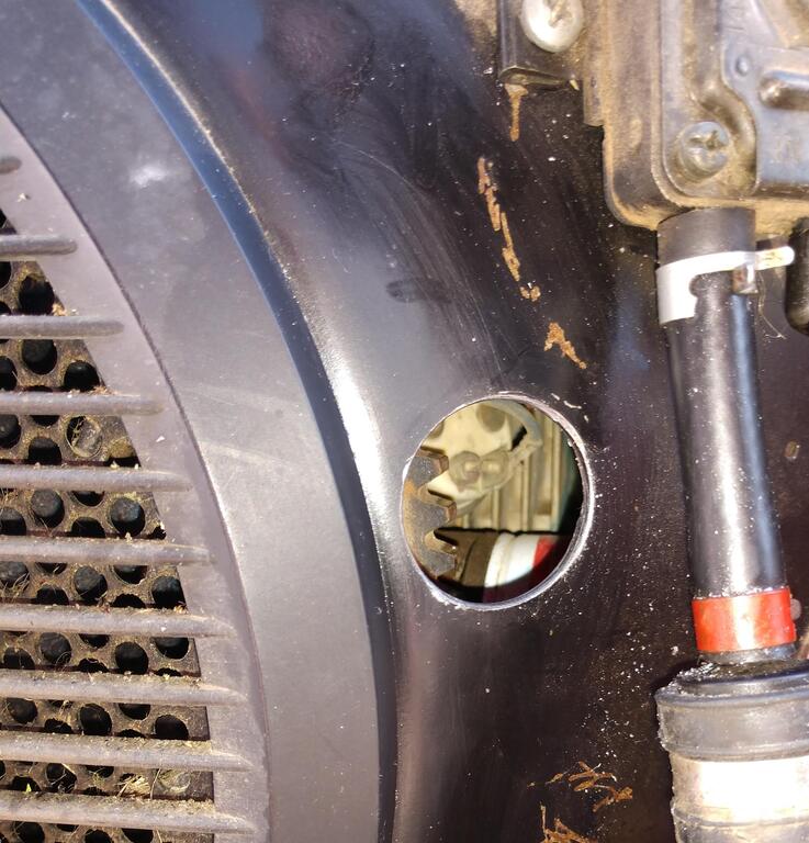

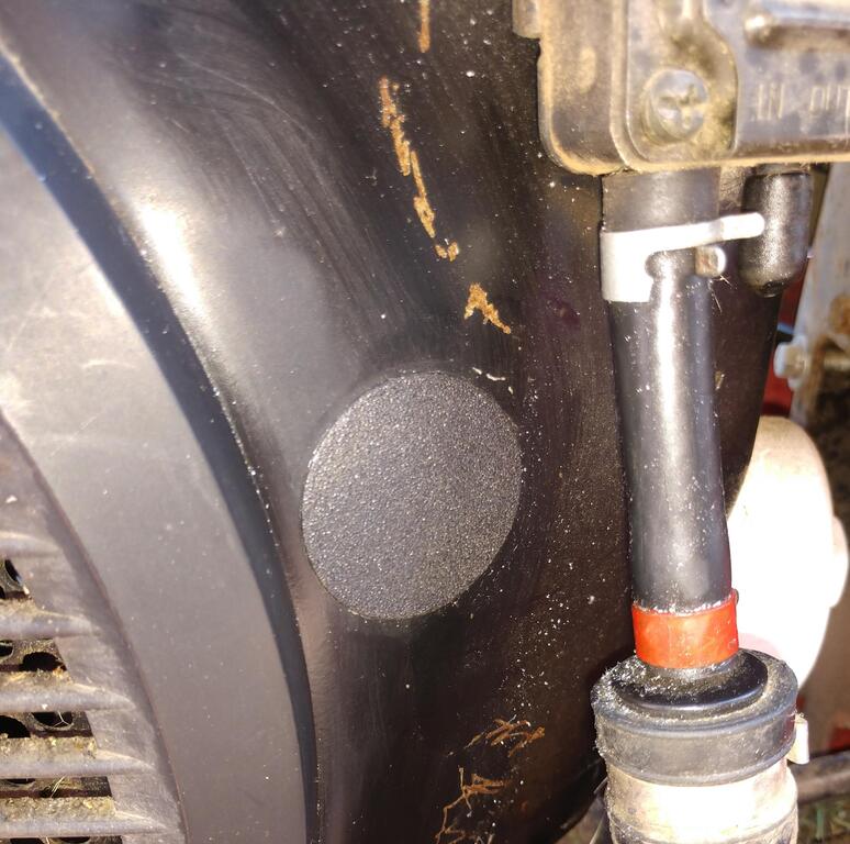

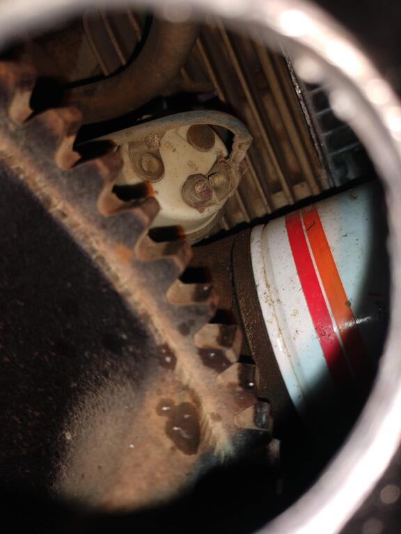

kpinnc 18,886 #22747 Posted January 15, 2025 (edited) 1 hour ago, Ed Kennell said: As we all know, removing and installing all the engine tins is not easy, but it is necessary to properly maintain the engine. I added a "peep hole" on my Onan just to make sure I could inspect the fins without removing all the tins. I just added snap-in plastic plugs to ensure airflow wasn't lost. Worked very well just to inspect between disassembly and cleaning. The hole is large enough to allow a compressed air nozzle to pass if debris needs removal in a pinch. @Red Stallion All of this may seem a bit like overkill, but a good running Onan is worth the trouble. This is especially true if the machine will be mowing in hot weather. The Onan has massive air flow near the nose of the cutting deck and left wheel, and tends to ingest blown clippings regularly. But you can see the theme here: protect the cooling of the rear cylinder as much as possible. We'll never have confirmed test results, but every little bit helps to ensure you get more life from that engine. My 520-H carried a 60 inch deck in the hot humid summers I live in for several years without issue, and this engine was around 1,000 hours on the clock as well. Edited January 15, 2025 by kpinnc 4 4 1 Share this post Link to post Share on other sites
Ed Kennell 46,996 #22748 Posted January 15, 2025 53 minutes ago, kpinnc said: I added a "peep hole" on my Onan What a great idea. If my engine tins ever need to come off, several peep/cleanout holes will be punched. 1 1 Share this post Link to post Share on other sites
kpinnc 18,886 #22749 Posted January 15, 2025 29 minutes ago, Ed Kennell said: What a great idea. Thank you! Just wanted to have a way to lower my anxiety levels in July/August. You can purchase any number of plastic snap plug sizes on the Jungle site. 1 Share this post Link to post Share on other sites
Handy Don 17,316 #22750 Posted January 15, 2025 2 hours ago, kpinnc said: I added a "peep hole" on my Onan just to make sure I could inspect the fins without removing all the tins. I just added snap-in plastic plugs to ensure airflow wasn't lost. Worked very well just to inspect between disassembly and cleaning. The hole is large enough to allow a compressed air nozzle to pass if debris needs removal in a pinch. 1 hour ago, Ed Kennell said: What a great idea. If my engine tins ever need to come off, several peep/cleanout holes will be punched. One of the reasons I wanted a good endoscope was to be able to get a good look in there without disassembly. I’d envisioned going in from the PTO side but adding the peepholes is brilliant both for inspection and cleaning. Maybe I should bring it to the Big Show and hand out an “Onan Fin Inspection” shingle! 1 Share this post Link to post Share on other sites
