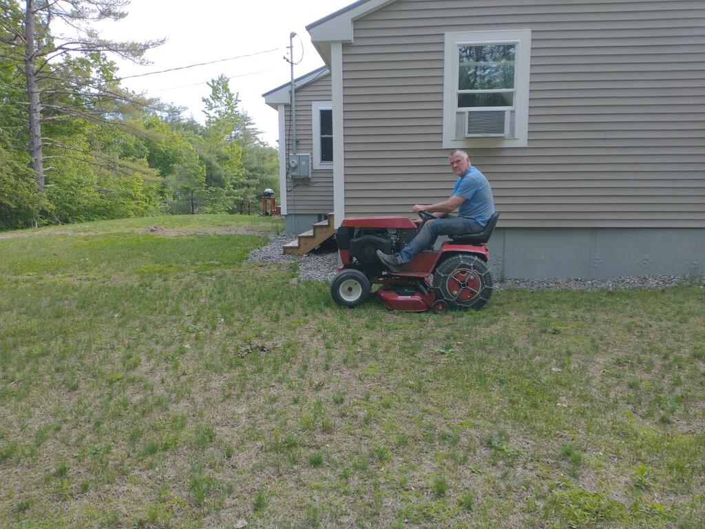

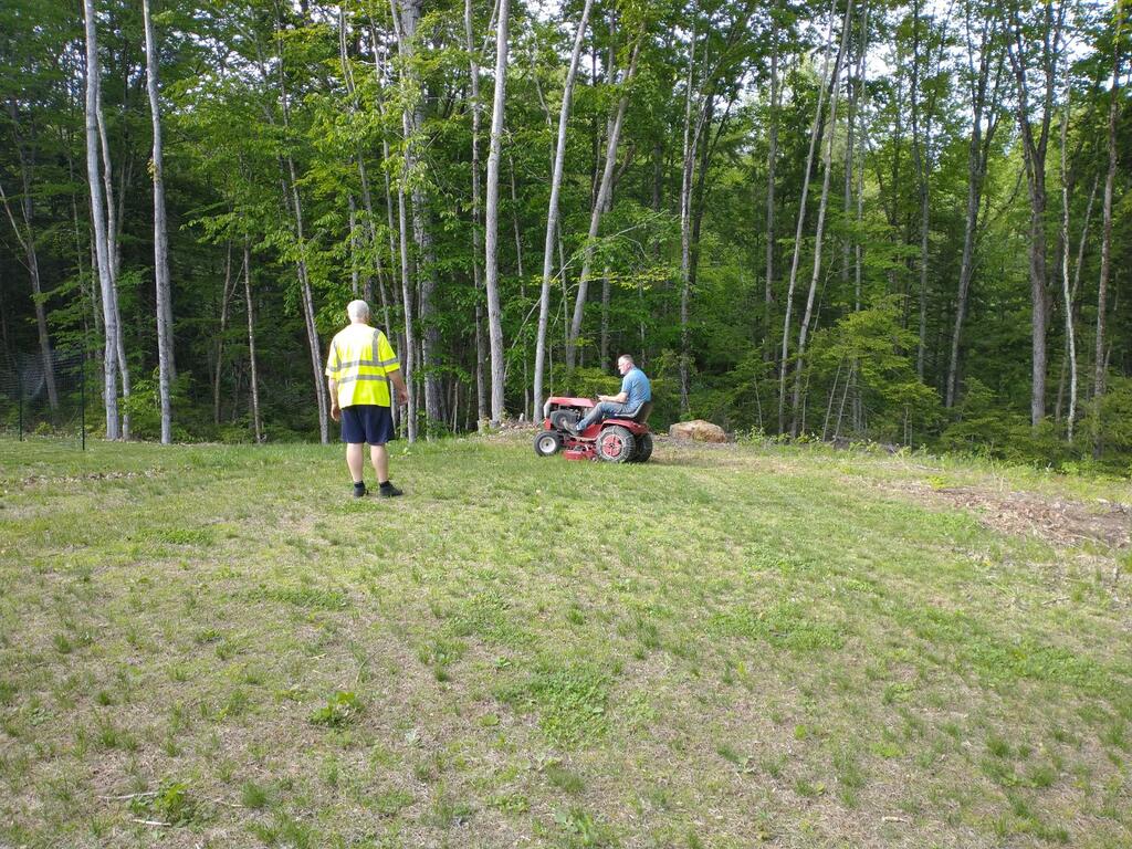

ebinmaine 79,447 #21452 Posted May 31, 2024 Over the past couple weeks BBT and I have made a few trips over to our friend's place to get the Workhorse set up with its mowing deck. Took us 4 or 5 attempts because we have very little familiarity with this model and even less with any mowing deck other than the one we recently put on @Qball 's tractor. (My parent's). At least two of those trips were to find broken or worn out parts. Standard fare for an older ride but a work stoppage for the day none the less. Well yesterday was the magic day!! Here's Tom driving his new mower while I observe. We'll need to make some adjustments to height and replace a bushing at some point. Otherwise it's going good. 8 5 Share this post Link to post Share on other sites
lynnmor 8,871 #21453 Posted May 31, 2024 2 hours ago, ebinmaine said: We'll need to make some adjustments to height and replace a bushing at some point. Otherwise it's going good. I looks like the deck is low in front. 2 Share this post Link to post Share on other sites
ebinmaine 79,447 #21454 Posted May 31, 2024 44 minutes ago, lynnmor said: I looks like the deck is low in front. Agreed. This deck was restored back around 2012 or so with my own '75 C160 Automatic. Part of the challenge with us making multiple trips was that the carriage was assembled wrong by the PO. It would be zero surprise if the front wheel set was also wrong. We'll try adjustment to the angle of the deck as a whole but that front roller may have to be moved. (????) 2 Share this post Link to post Share on other sites
87 416-8 horse 430 #21455 Posted May 31, 2024 @ebinmaine are you expecting another snow fall while you mow up there? He still has his chains on 1 4 Share this post Link to post Share on other sites
ebinmaine 79,447 #21456 Posted May 31, 2024 7 minutes ago, 87 416-8 horse said: @ebinmaine are you expecting another snow fall while you mow up there? He still has his chains on Expecting? No. I sure as heck hope not. But we can get Frost all the way to the end of june. This is pretty tilted country. His yard and surrounding woods has a lot of roll and tumble to it so he's leaving them on all year. Trina does the same. Regular plain old turf tires are pretty useless in a lot of places. 3 Share this post Link to post Share on other sites
lynnmor 8,871 #21457 Posted May 31, 2024 5 hours ago, ebinmaine said: Agreed. This deck was restored back around 2012 or so with my own '75 C160 Automatic. Part of the challenge with us making multiple trips was that the carriage was assembled wrong by the PO. It would be zero surprise if the front wheel set was also wrong. We'll try adjustment to the angle of the deck as a whole but that front roller may have to be moved. (????) Only the rear mower wheels are in contact with the ground except when irregularities are encountered. The rollers at the front is to prevent scalping. The deck height is adjusted by the rear wheels and the deck level is adjusted using the J bolt at the center rear of the deck. Looking at that sparse crop of grass, I would make the deck perfectly level, the only reason that a lower front is specified is to prevent re-cutting the same grass. Be sure to have the tires properly inflated and you are doing the leveling on a flat surface. Measure from the flat surface to the blade tips front and rear. This tool can help, before I had one I used a deep socket of the proper length for my gauge. 3 5 Share this post Link to post Share on other sites

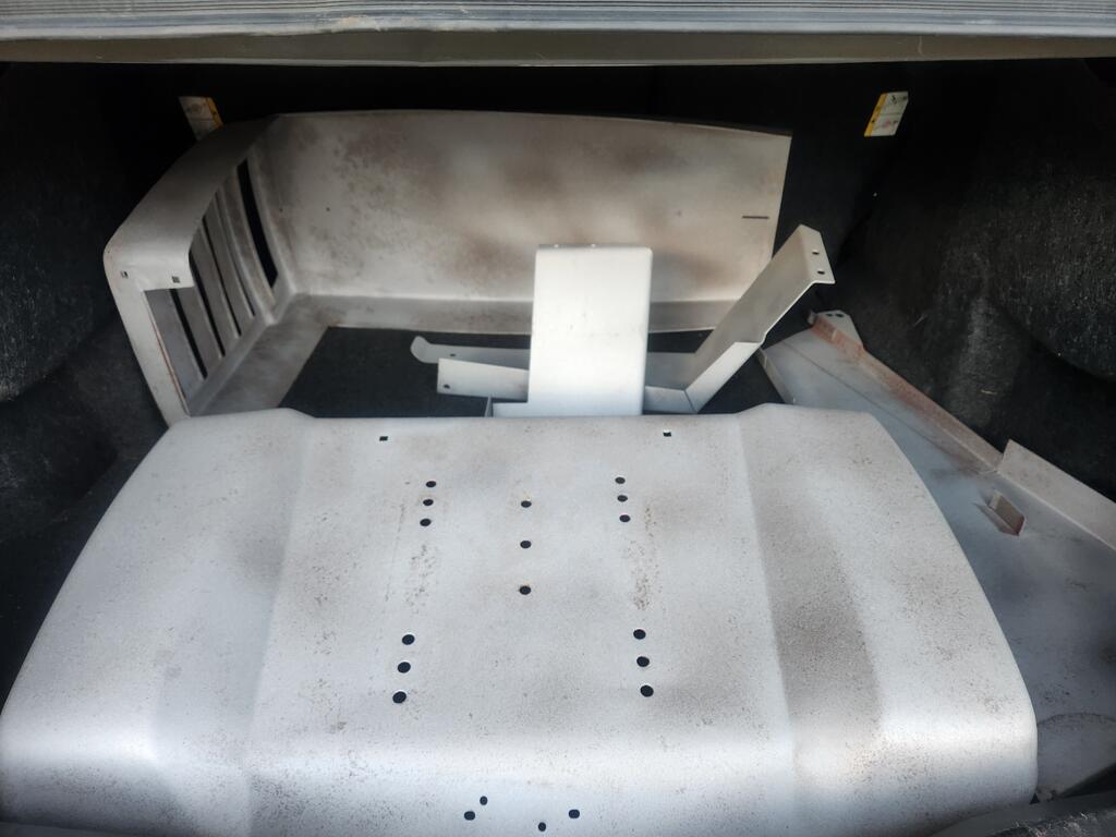

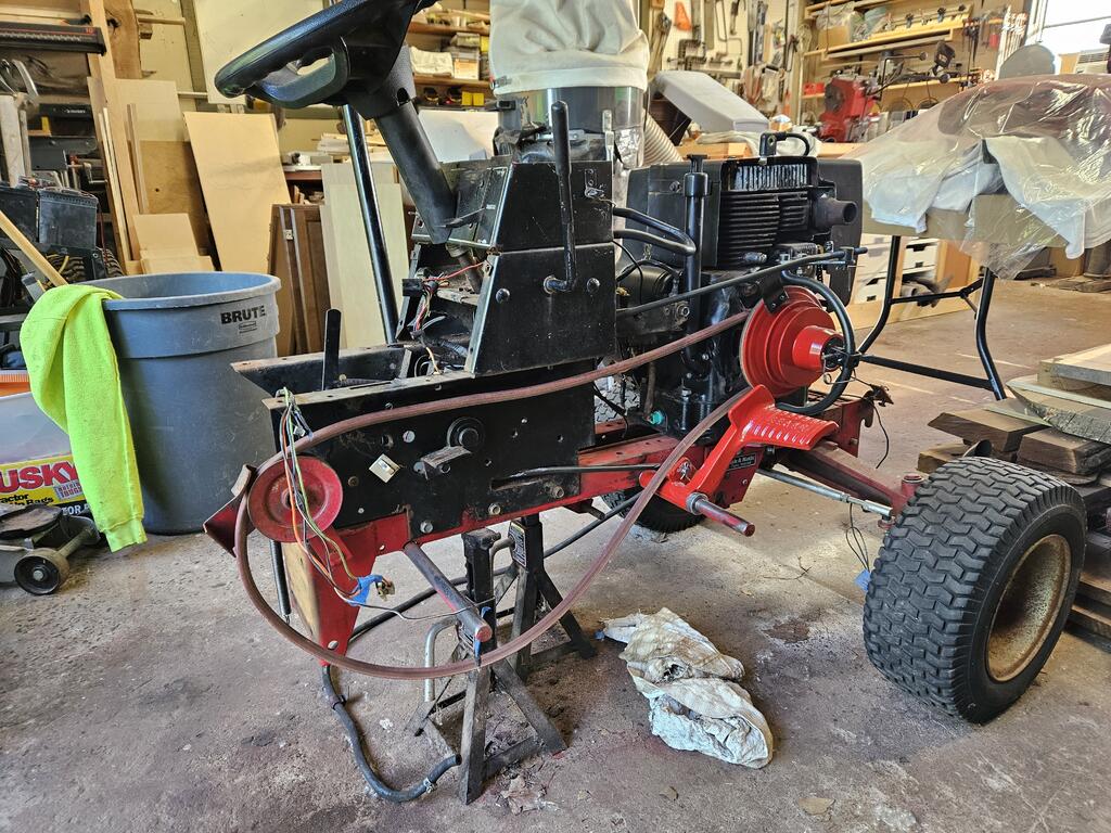

KW88 39 #21458 Posted May 31, 2024 Little update on the 312-8 rebuild. Had some electrical issues to start when I bought it couple months ago and some transaxle leaks. So, not a complete tear down, but getting there. Thanks to this site and members help, I got through the transaxle rebuild which found out wasn't original to the 88 model. As far as the electrical goes, I've cleaned and replaced almost everything, but found the wires to the ignition module were completely bare as it passed through near the engine. Most likely my starting problem, but to be determined. I have thoroughly enjoyed taking my time to pay attention to every part as it comes off, clean, repaint or wire wheel it so someday when she's up and running it'll be an eye catcher. If all goes well, should be ready to plow this winter! 1 11 Share this post Link to post Share on other sites
cleat 8,994 #21459 Posted May 31, 2024 What I do is pull the harness totally out of the tractor and lay it out on the work bench. Then I can totally go through it and fix up any bad wires, connectors etc then rewrap it and it is as good or better than new. Never have an electrical issue after that. 9 1 Share this post Link to post Share on other sites
kpinnc 18,708 #21460 Posted June 1, 2024 3 hours ago, cleat said: What I do is pull the harness totally out of the tractor and lay it out on the work bench. Then I can totally go through it and fix up any bad wires, connectors etc then rewrap it and it is as good or better than new. Never have an electrical issue after that. But take pictures before! 4 Share this post Link to post Share on other sites

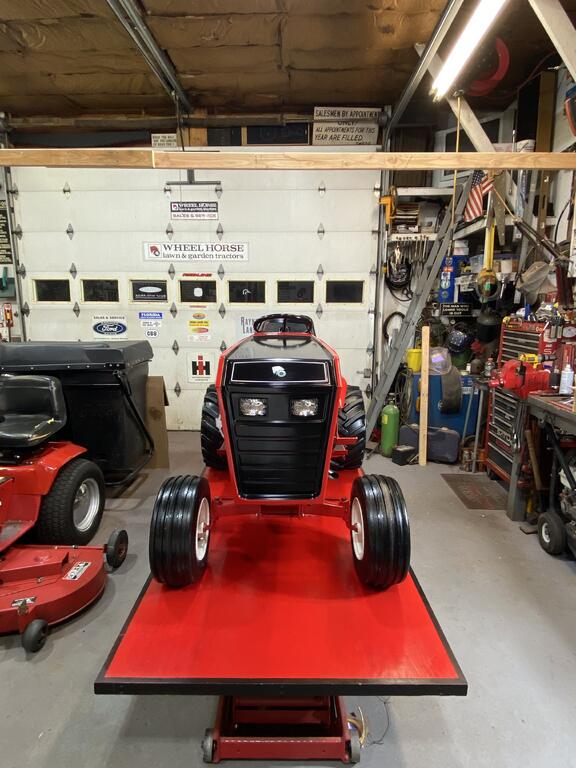

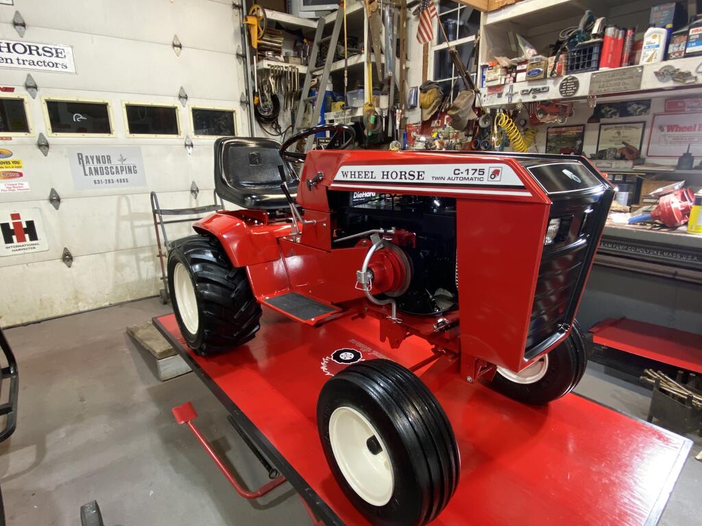

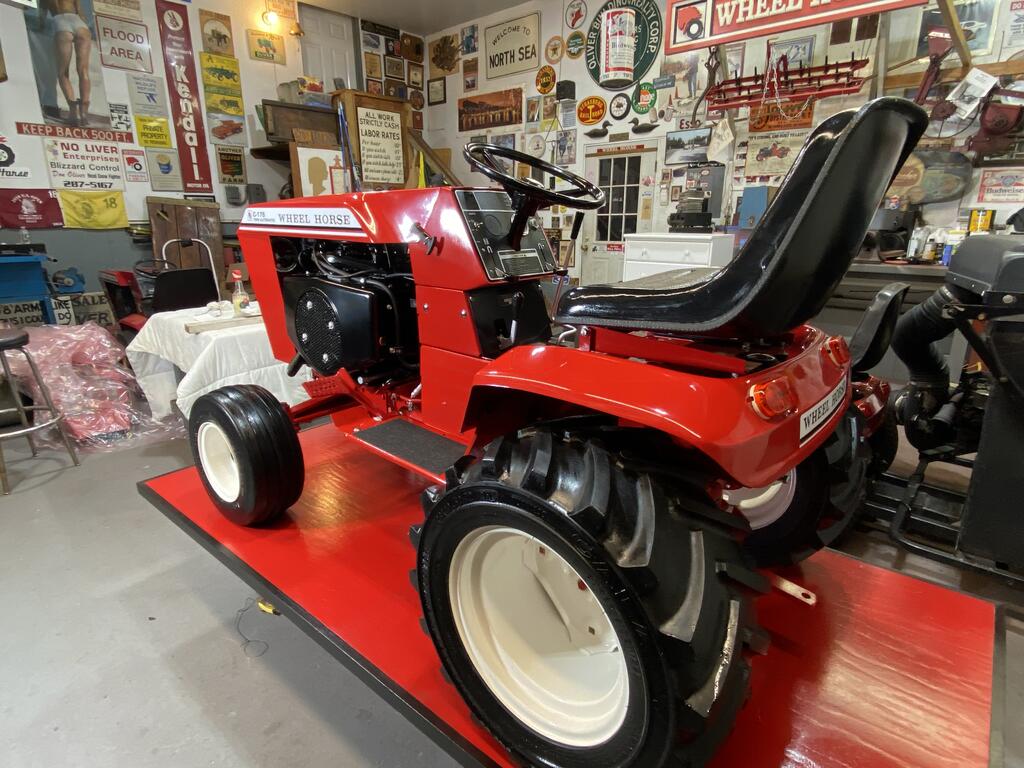

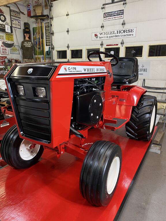

c-series don 12,027 #21463 Posted June 6, 2024 (edited) Finally completed my C-175 restoration tonight, when it’s light out I’ll take it outside for some better pictures. I’m super happy with the way it turned out and really have to thank my brother for all his help! I will be bringing it to the show as it is this year’s featured tractor. Edited June 6, 2024 by c-series don 2 18 5 Share this post Link to post Share on other sites
Brockport Bill 2,402 #21464 Posted June 6, 2024 Spectacular!!! Great job Don ! 3 1 Share this post Link to post Share on other sites
ebinmaine 79,447 #21465 Posted June 6, 2024 6 hours ago, c-series don said: C-175 restoration Absolutely fantastic work!! 1 Share this post Link to post Share on other sites
SylvanLakeWH 31,658 #21466 Posted June 6, 2024 @c-series don Love the Black Hoods!!! Beautiful job!!! 2 1 Share this post Link to post Share on other sites
Tractorhead 9,217 #21467 Posted June 6, 2024 @c-series don another candidate for a a showroom. Ya made a beauty !👍 2 1 Share this post Link to post Share on other sites
Sodaking27 1,263 #21468 Posted June 6, 2024 (edited) @c-series don Excellent looking. Can’t wait to see it at the show.👀 Edited June 6, 2024 by Sodaking27 1 1 Share this post Link to post Share on other sites
JCM 11,241 #21469 Posted June 6, 2024 Looks to me like you already have a page on the 2025 RS calendar. 3 1 Share this post Link to post Share on other sites
WHX?? 57,253 #21470 Posted June 6, 2024 Love those shoes Don... 1 1 1 Share this post Link to post Share on other sites
cleat 8,994 #21471 Posted June 6, 2024 I doubt it looked that good when on the showroom floor. Great job. 1 1 Share this post Link to post Share on other sites
dclarke 4,270 #21472 Posted June 6, 2024 Outstanding work, Don! 2 1 Share this post Link to post Share on other sites
Pullstart 70,338 #21473 Posted June 6, 2024 On 5/31/2024 at 4:46 AM, ebinmaine said: I understand that sometimes our look of focus is not photo worthy. But if this were a “caption this” I’d think that he’s concerned if his photo gets published he’ll go back to the pen! 5 Share this post Link to post Share on other sites

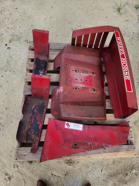

Goldnboy 1,126 #21474 Posted June 6, 2024 Ahh ..nothing like getting that 50 years of patina gone..... 2 3 1 Share this post Link to post Share on other sites
ebinmaine 79,447 #21475 Posted June 6, 2024 2 minutes ago, Pullstart said: I understand that sometimes our look of focus is not photo worthy. But if this were a “caption this” I’d think that he’s concerned if his photo gets published he’ll go back to the pen! BBT claims I have the same look when I'm concentrating. 1 3 Share this post Link to post Share on other sites
