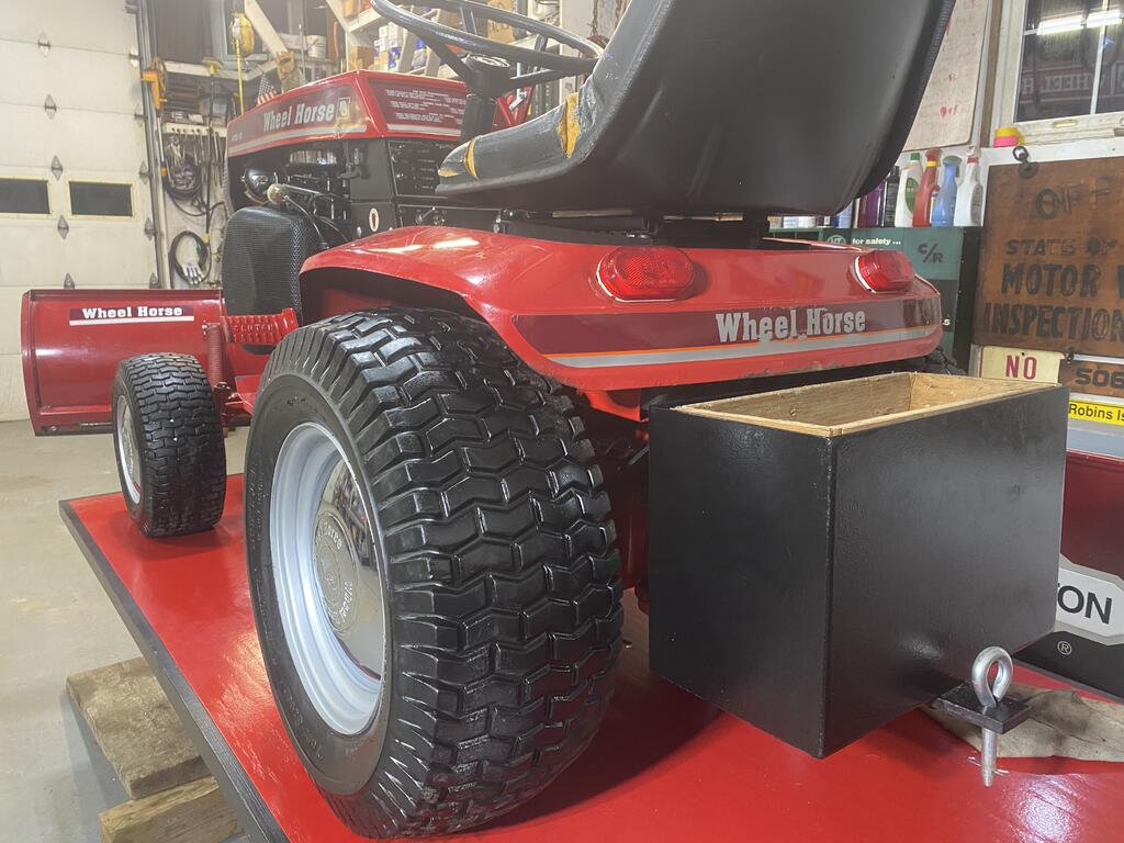

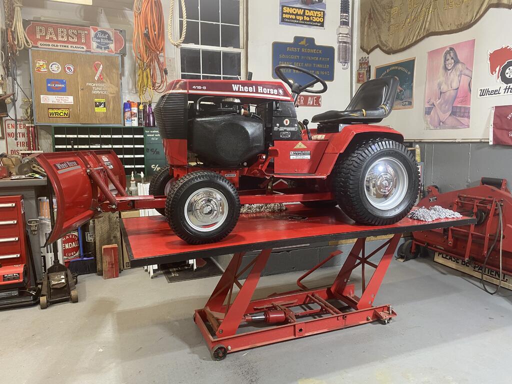

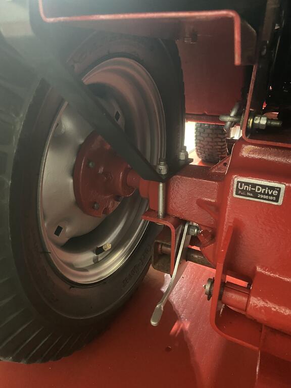

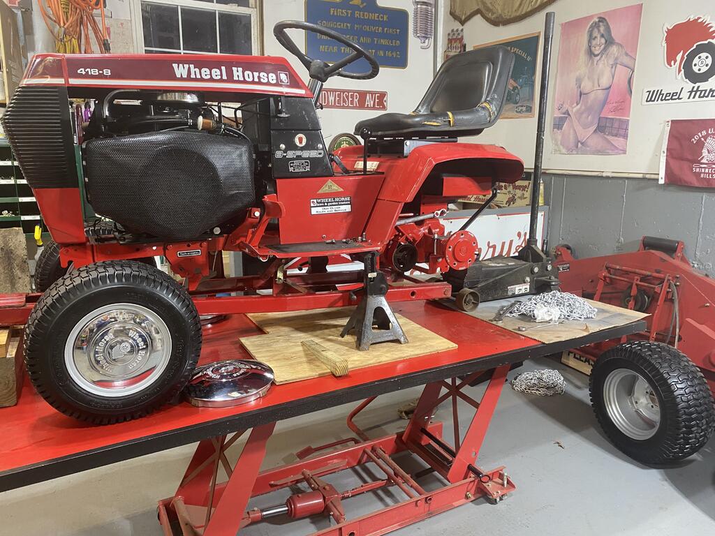

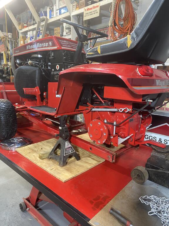

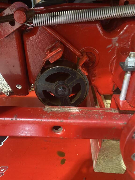

c-series don 12,600 #20653 Posted January 22, 2024 Today I mounted the weight box on my 418-8, and built a wooden insert so I can fill it with concrete. Then bent some 3/4” round stock to sink into the concrete for a handle to lift it out. Next I jacked up the rear tires to install tire chains, that’s when I noticed that the hubs were loose. So off came the wheels and that’s when I realized that now was probably the time to also address the slightly leaking brake drum seal! When I bought this tractor I remember tightening the set screws on the hub. Now since they are loose again I guess I’ll replace them. Good news is that I think I have the seal in stock! I ran out of gas for the day, tomorrow is another day!! Here’s a few pics. 3 18 Share this post Link to post Share on other sites

ebinmaine 81,032 #20655 Posted January 22, 2024 7 hours ago, c-series don said: When I bought this tractor I remember tightening the set screws on the hub. Now since they are loose again I guess I’ll replace them. Replace the set screws? Or the whole hub? I've gotten in the habit the last few years of not reusing ANY set screws unless it's one we put on. Too many people think they're a permanent piece and/or flatten the bottom cup. 3 Share this post Link to post Share on other sites
paulyv56 152 #20656 Posted January 22, 2024 Beautiful tractor! Is that a harbor freight lift? Great set up. 3 Share this post Link to post Share on other sites
c-series don 12,600 #20657 Posted January 22, 2024 2 hours ago, ebinmaine said: Replace the set screws? Or the whole hub? I've gotten in the habit the last few years of not reusing ANY set screws unless it's one we put on. Too many people think they're a permanent piece and/or flatten the bottom cup. 47 minutes ago, paulyv56 said: Beautiful tractor! Is that a harbor freight lift? Great set up. @ebinmaine I never thought of just replacing the set screws? I might give that a try, it’s certainly cheaper than replacing the hubs! @paulyv56 Yes it’s a Harbor freight lift that I made a wider top for. I have to say that it’s one of the best tools I’ve ever bought. Having a bad back, it’s a real game changer. Being able to stand up and work and not bent over or on my knees or back is a huge help. I got it on sale for around $600 bucks. 6 2 1 Share this post Link to post Share on other sites

Lee1977 7,807 #20659 Posted January 22, 2024 5 hours ago, ebinmaine said: Replace the set screws? Or the whole hub? I've gotten in the habit the last few years of not reusing ANY set screws unless it's one we put on. Too many people think they're a permanent piece and/or flatten the bottom cup. If you have loose hubs you need to replace the keys too. If the hub is moving around the key is worn. 8 Share this post Link to post Share on other sites

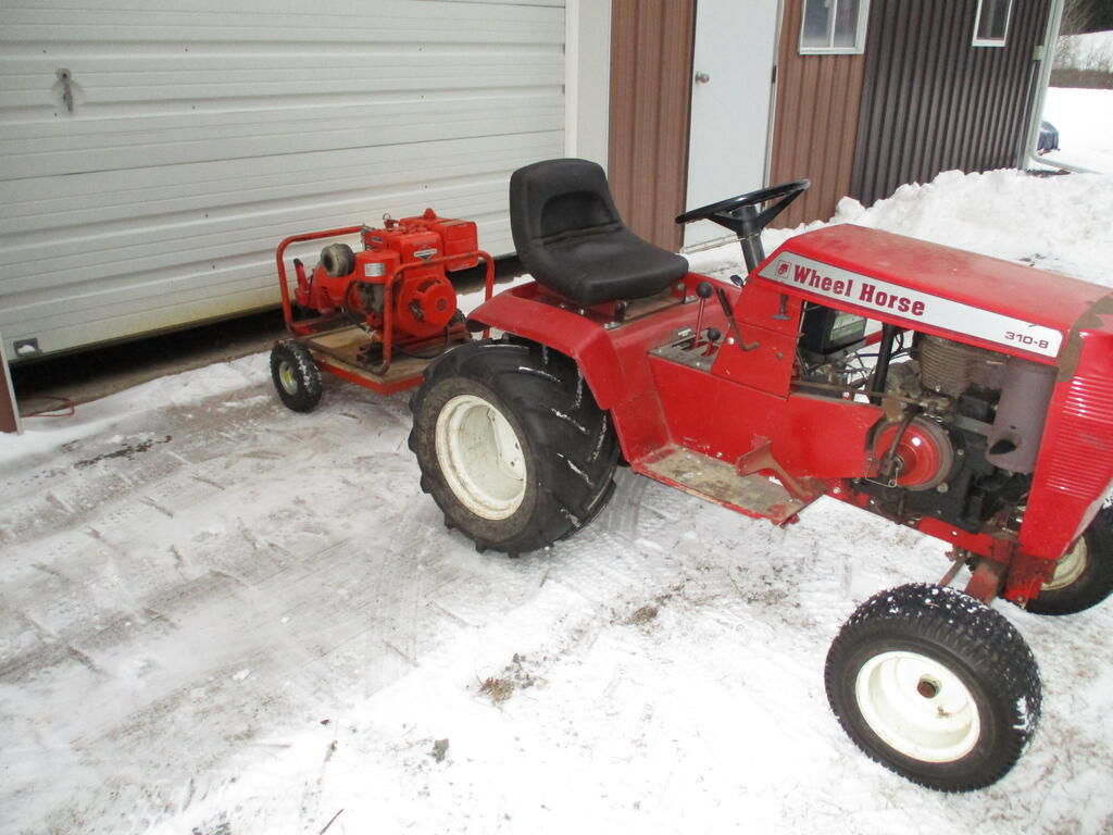

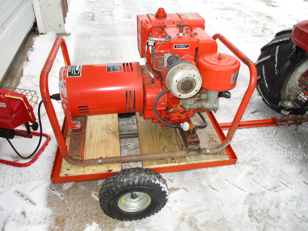

pfrederi 21,268 #20660 Posted January 22, 2024 Have power will travel Made a little trailer out of scrap for my $60 generator. 310-8 will have mobility resonsibility. 6 20 Share this post Link to post Share on other sites
ebinmaine 81,032 #20661 Posted January 22, 2024 1 hour ago, pfrederi said: Have power will travel Made a little trailer out of scrap for my $60 generator. 310-8 will have mobility resonsibility. Nicely done there Paul. 1 Share this post Link to post Share on other sites
JCM 11,420 #20662 Posted January 22, 2024 Replacing the set screws should work. Have done that before. @c-series don That cheerleader on the wall will help you git her done. 1 1 3 Share this post Link to post Share on other sites

PWL216 1,309 #20664 Posted January 23, 2024 @c-series don nice weight box. How does it attach to the tractor? 1 Share this post Link to post Share on other sites
c-series don 12,600 #20665 Posted January 23, 2024 @PWL216 There’s two brackets that go from the top of the box to the rear axle hitch and then a 1/2” bolt that goes through the drawbar hitch. I’ve seen similar but not the same one. 2 3 Share this post Link to post Share on other sites

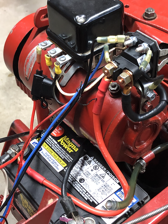

Handy Don 17,623 #20666 Posted January 23, 2024 Finished converting the 854 to use a solenoid for starting. As others have done, I used a bracket added to the S/G to hold it. Makes for some very short cable runs. I added a fuse to the charging side as many members have recommended, but later realized that since my ammeter is mounted on a wood dash there is no chance of a failure with a short to ground! Took the opportunity to clean and dielectric grease all the wiring endpoints and replaced some that I deemed sketchy. Also replaced the fuel line. The white-backed instrument is a marine digital voltmeter fed from the A terminal on the new ignition switch (Stens 430-512 for Toro 103990). Upon completing the wiring, I hit the key and got only a weak “huh?” from the S/G. Momentary panic but after going through the checklist realized the battery was end-of-life. Whew! Got a good battery and it started just fine so I went for a spin in the snowy yard! 6 7 Share this post Link to post Share on other sites

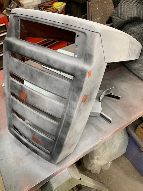

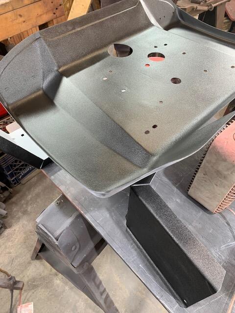

JoeM 10,317 #20669 Posted January 23, 2024 Continued on the C141 refresh. I hate painting and body work, I have no idea why I start these projects, but I do. Used bed liner paint on the bottom of the seat pan and running boards. 10 5 Share this post Link to post Share on other sites
WHX?? 58,310 #20670 Posted January 23, 2024 (edited) On 1/22/2024 at 6:10 AM, c-series don said: never thought of just replacing the set screws? I might give that a try, McMaster Carr on the set screws @c-series don. When I broach hubs for guys I aways send new ones & jam nuts so I buy in bulk. Edited January 23, 2024 by WHX?? 5 5 Share this post Link to post Share on other sites
