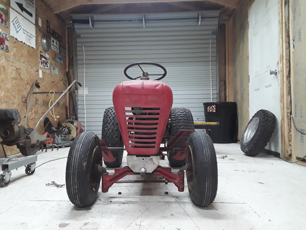

ebinmaine 80,996 #1901 Posted February 18, 2019 54 minutes ago, Shed said: That's awesome looking. How did you flip the spindles and hook the steering up. @Professor1990 Will they be able to hold the weight ok? Share this post Link to post Share on other sites
ClassicTractorProfessor 5,455 #1902 Posted February 18, 2019 @Shed @ebinmaine I will get some up close pics of the setup when I get back over to the shop...maybe tonight...theres not a whole lot of weight on the front of this tractor...that little briggs is a feather compared to our Kohlers, i can pick up the front and set it on jackstands with one hand, so weight shouldnt be a problem 1 Share this post Link to post Share on other sites
ebinmaine 80,996 #1903 Posted February 18, 2019 42 minutes ago, Professor1990 said: @Shed @ebinmaine I will get some up close pics of the setup when I get back over to the shop...maybe tonight...theres not a whole lot of weight on the front of this tractor...that little briggs is a feather compared to our Kohlers, i can pick up the front and set it on jackstands with one hand, so weight shouldnt be a problem Thanks Bryce. I know what you mean. The late 70s 8 horse Briggs that is in Trina's 657 temporarily is so light I can pick it up and walk it around with one hand. All aluminum block and head. 1 Share this post Link to post Share on other sites
Lee1977 7,805 #1904 Posted February 18, 2019 The question is, does the little Briggs have enough power to lift the front end. I would say it does if revived up high enough. If it does it's going come down hard. Will the front axle and wheels stay together? Share this post Link to post Share on other sites
Shed 377 #1905 Posted February 18, 2019 Maybe it won't hold up to wheelies but you'll sure look cool doing it Share this post Link to post Share on other sites

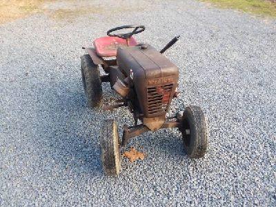

giddyap 1,574 #1910 Posted February 19, 2019 Professor1990 "Flipped the front spindles to lower the front end" I cannot flip the spindles on my 704 (stock photo) So I had to find out why? Your 701 axle is like a 551 Suburban and mine is not. Lucky me for I have one laying around. Thanks for posting because I may have never known the difference. 1 Share this post Link to post Share on other sites
giddyap 1,574 #1911 Posted February 19, 2019 17 hours ago, Shed said: That's awesome looking. How did you flip the spindles and hook the steering up. Shed is referring to Professor1990. And I had to find out why I could not do the same with my 704. Most axles, the spindles rest in holes that are slanted. Compare Professor1990's axle, it is like a 551, which the spindle holes are straight verticle. Share this post Link to post Share on other sites

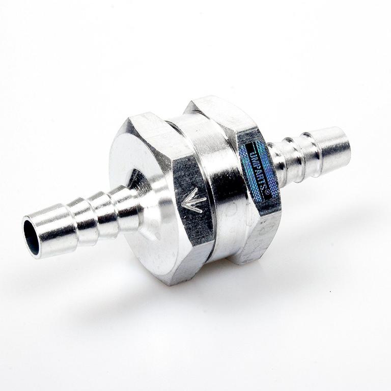

Shynon 7,723 #1915 Posted February 25, 2019 Put one of these on the 520's the other day, starts right up without the choke. Pretty happy, will have to see how the loader responds after sitting for weeks. 5 2 Share this post Link to post Share on other sites
LengerichKA88 1,885 #1916 Posted February 25, 2019 I’ve gotten reinterested in one of my other hobby’s recently and the tractors have taken a back seat.This past weekend though I bought em out right. So they’re mine all mine now. I also took the plow off the Charger (to make sure it snows again of course). Removed the old decals on the hood, and upgraded the shower head muffler that I don’t care for. 3 1 Share this post Link to post Share on other sites
WHX?? 58,307 #1917 Posted February 25, 2019 11 hours ago, Shynon said: starts right up They do make a difference Tom. I put them on just below the fuel pump and now they always fire right off. One 520 if it sat for a week you almost had to hand feed it before it would start. Now always fires right off with some choke if it's real cold. Very low restriction on them too. 3 1 Share this post Link to post Share on other sites
Ed Kennell 47,643 #1918 Posted February 25, 2019 On 2/18/2019 at 3:22 AM, Shed said: That's awesome looking. How did you flip the spindles and hook the steering up. The method I used to lower my low rider. 2 1 Share this post Link to post Share on other sites
edpm3 19 #1919 Posted February 25, 2019 13 hours ago, Shynon said: Put one of these on the 520's the other day, starts right up without the choke. Pretty happy, will have to see how the loader responds after sitting for weeks. Pardon my ignorance, but what exactly is that? 1 1 Share this post Link to post Share on other sites
pfrederi 21,240 #1920 Posted February 25, 2019 3 minutes ago, edpm3 said: Pardon my ignorance, but what exactly is that? 3 Share this post Link to post Share on other sites
WHX?? 58,307 #1921 Posted February 25, 2019 Just a simple check valve... one for the shelf too! https://www.ebay.com/itm/2pcs-6MM-Non-Return-One-Way-1-4-Inch-Air-Fuel-Oil-Check-Valve-Diesel-Gas-P4I4/322854742849?epid=1284351436&hash=item4b2ba46b41:g:c9kAAOSwAHtZ9tOK:rk:3:pf:0 Share this post Link to post Share on other sites

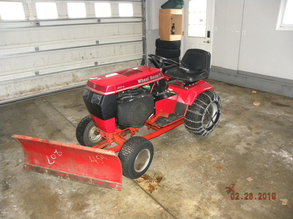

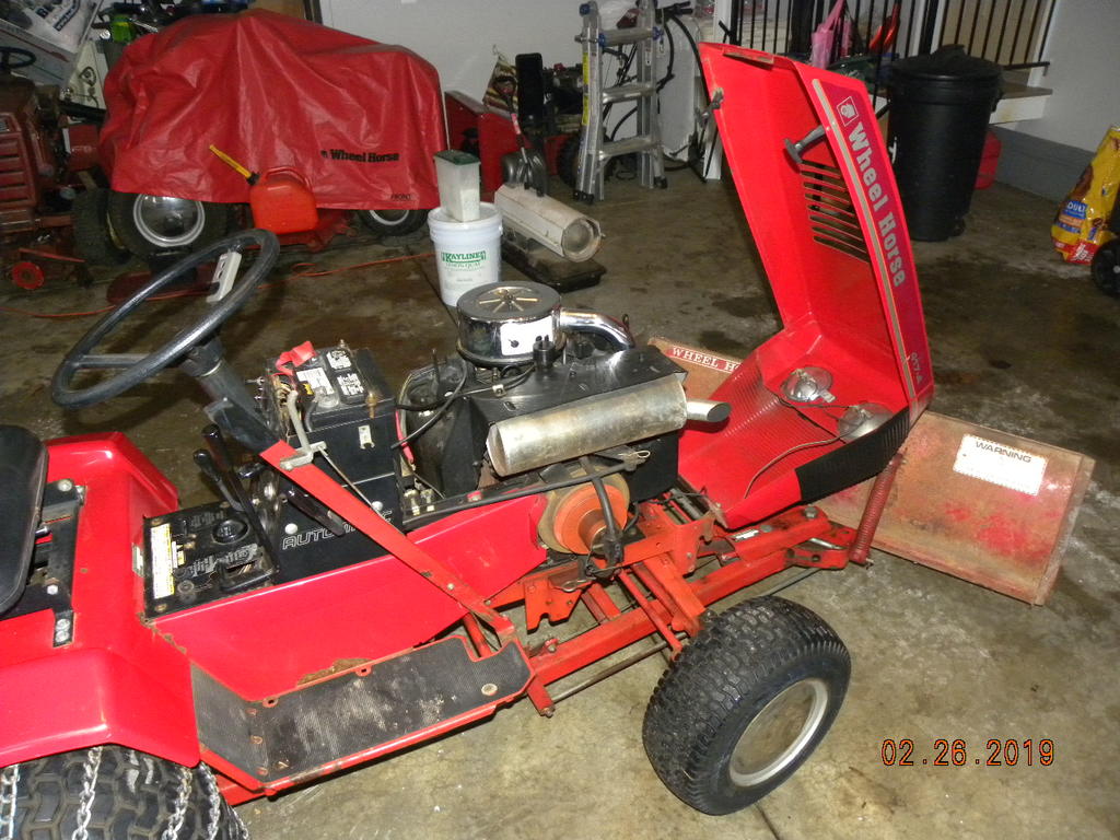

702 timmy 25 #1922 Posted February 27, 2019 new to me. I have asked questions just never posted pics. Picked this up in Macugie Pa from it's original owner. It came with a 42 rear discharge deck, 48" plow and chains. This is how it came very clean. Alway's kept in heated garage at a car wash. Think I got a deal, paid $750. It was 400 hundred m,iles from home, but well worth the trip. 7 8 Share this post Link to post Share on other sites
AMC RULES 37,260 #1923 Posted February 27, 2019 Scored a great deal, on a beast of a machine there. 2 Share this post Link to post Share on other sites

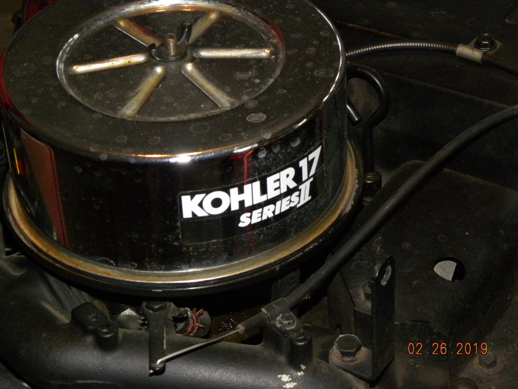

Vinylguy 4,797 #1924 Posted February 27, 2019 (edited) Awesome Horse!! Would you mind posting the hxw of your series 2 kohler air cleaner decal? I had not seen that one before. Edited February 27, 2019 by Vinylguy image update 2 1 Share this post Link to post Share on other sites
Lane Ranger 12,151 #1925 Posted February 27, 2019 10 hours ago, 702 timmy said: new to me. I have asked questions just never posted pics. Picked this up in Macugie Pa from it's original owner. It came with a 42 rear discharge deck, 48" plow and chains. This is how it came very clean. Alway's kept in heated garage at a car wash. Think I got a deal, paid $750. It was 400 hundred m,iles from home, but well worth the trip. Sometimes you have to go a littler further to GET MORE! A Very Nice tractor you bought -take care of it! 1 Share this post Link to post Share on other sites
