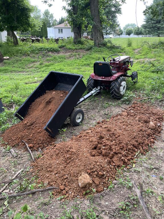

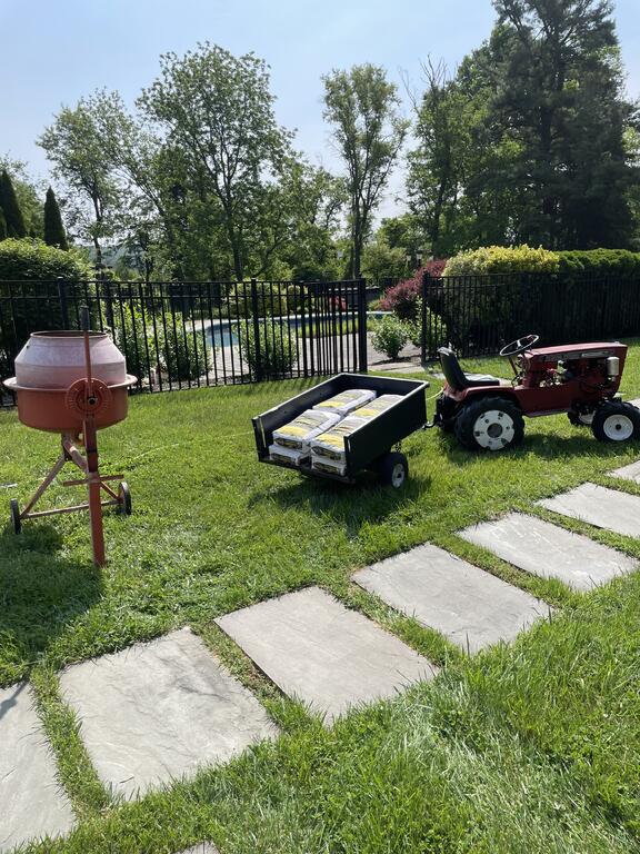

BrianKoch 370 #19027 Posted May 17, 2023 Hitched the cart up and hauled dirt off into the woods 3 3 Share this post Link to post Share on other sites

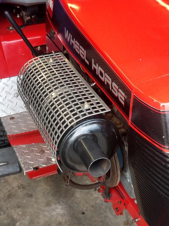

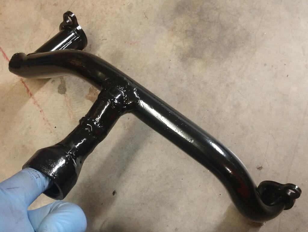

kpinnc 18,771 #19028 Posted May 17, 2023 (edited) On 5/15/2023 at 6:33 PM, kpinnc said: Now I have to finish the new manifold. That'll bring the muffler in another 1.5 inches toward the hood. Got the manifold made up tonight. Had to make a huge adapter to fit the muffler, but this manifold is for this engine. The diameter should be fine. I had to weld a recurve drop in the adapter to get the muffler in the right place, but it will pull the whole thing a little closer to the hood. Ugly, but it will work. Also made a brace to support the whole thing that uses the PTO brake bracket. I always remove them anyway. Edited May 17, 2023 by kpinnc 8 Share this post Link to post Share on other sites

BrianKoch 370 #19030 Posted May 17, 2023 Only 36 more bags to haul! 4 Share this post Link to post Share on other sites

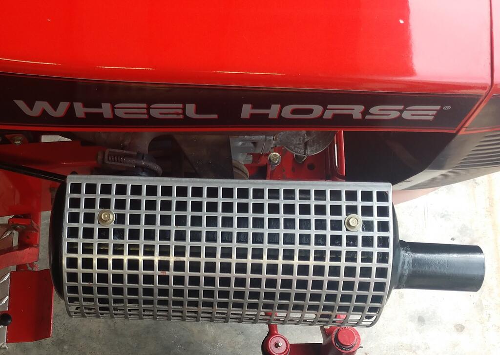

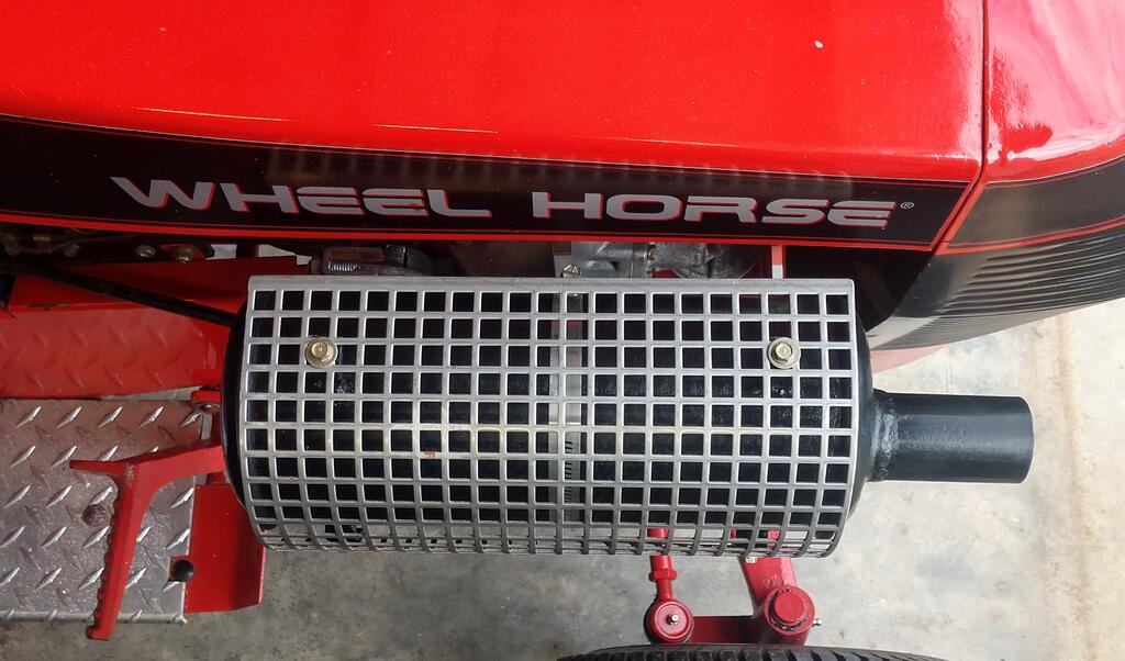

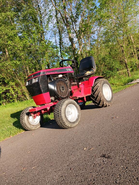

kpinnc 18,771 #19031 Posted May 17, 2023 (edited) Well, my manifold is ugly, but it did the trick. First pic is "before" and second is after. Tucked in nicely, but not so close as to burn the hood paint. Added a diagonal brace to support the weight as well on the brake tab. Edited May 17, 2023 by kpinnc 7 9 Share this post Link to post Share on other sites
Bill D 3,013 #19032 Posted May 17, 2023 Nice. At any point were you temped to install a stack or straight pipes? 1 1 Share this post Link to post Share on other sites
D_Mac 9,337 #19033 Posted May 17, 2023 @kpinncnice work. Did you make the heat shields as well. I would like to try that some day. 1 Share this post Link to post Share on other sites
kpinnc 18,771 #19035 Posted May 17, 2023 1 hour ago, Bill D said: Nice. At any point were you temped to install a stack or straight pipes? No sir. This muffler combined with this engine sounds like a "soft spoken" Harley. That's why I modded so much to make it work. I got nothing against stacks, just not my preference. I'd probably hit it on something... 1 hour ago, D_Mac said: Did you make the heat shields as well. I would like to try that some day. Yep. Go back to the previous page in this thread. It's just perforated stainless from Fleabay, but it works. 1 1 Share this post Link to post Share on other sites

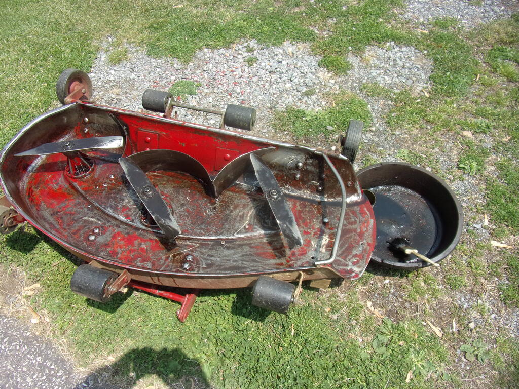

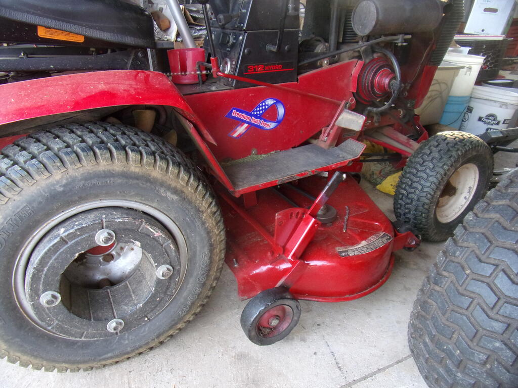

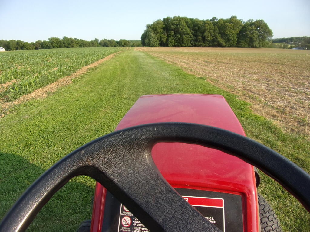

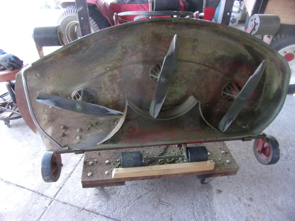

Ed Kennell 46,642 #19036 Posted May 17, 2023 (edited) After three wet mowings, I took the 42SD off for cleaning. Put the 42RD on. Did a little test run. Finished cleaning the 42SD and gave it the Geasy Pete oil bath. Bake it in the sun for a few days than store till next spring. Edited May 18, 2023 by Ed Kennell 9 2 Share this post Link to post Share on other sites
19richie66 17,930 #19037 Posted May 18, 2023 (edited) 7 hours ago, kpinnc said: Tucked in nicely. Edited May 18, 2023 by 19richie66 LOOKS FANTASTIC! 1 1 Share this post Link to post Share on other sites
mrc 1,106 #19038 Posted May 18, 2023 nice work on that muffler guard kpinnc! 1 1 Share this post Link to post Share on other sites

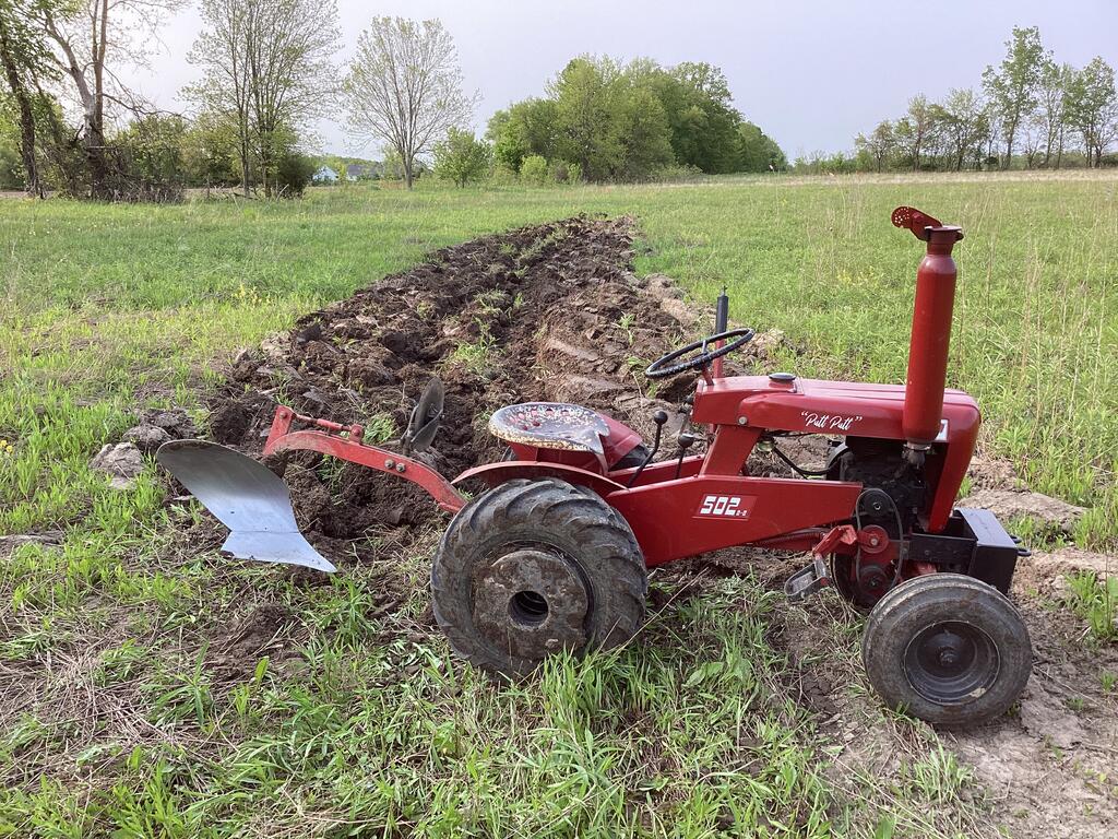

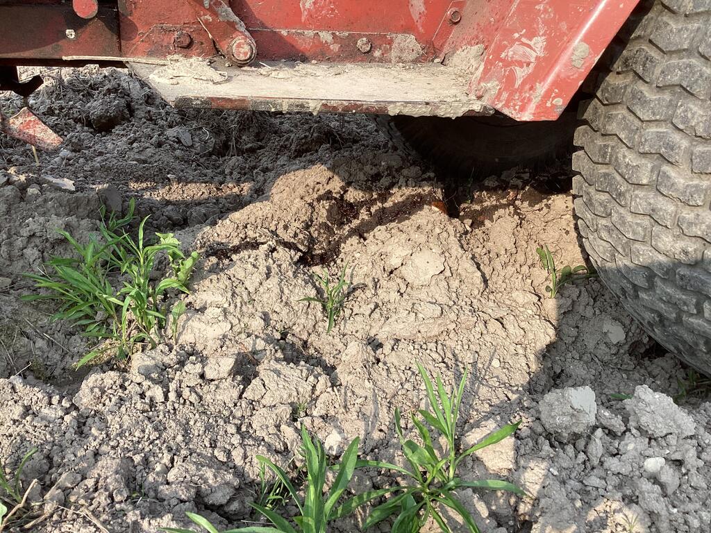

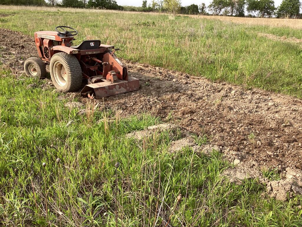

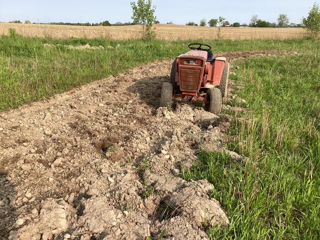

Pullstart 70,847 #19039 Posted May 18, 2023 Did a little food plot work… 2 6 Share this post Link to post Share on other sites
Pullstart 70,847 #19040 Posted May 18, 2023 Did some more food plot work. 2 5 Share this post Link to post Share on other sites

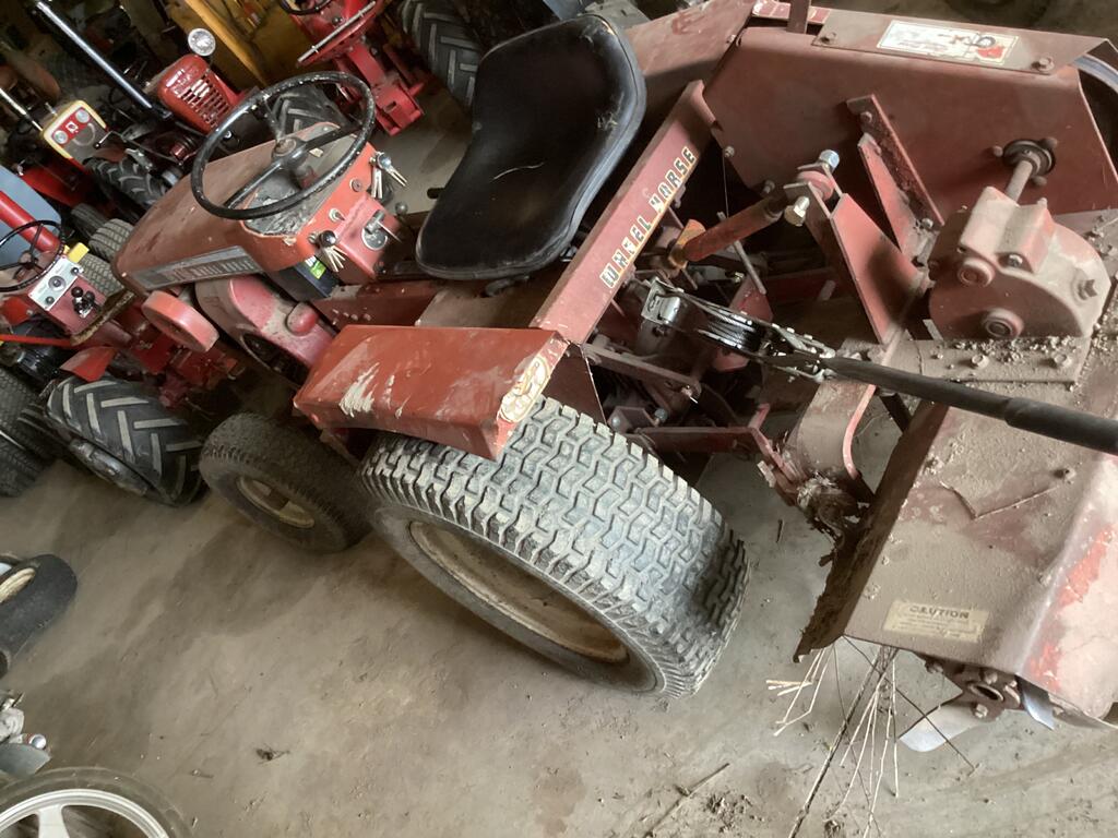

Pullstart 70,847 #19042 Posted May 18, 2023 Safe and sound. Rylee came to my rescue with Putt Putt and we towed Colt back to the barn. No, the seat isn’t bolted down 3 3 1 1 Share this post Link to post Share on other sites

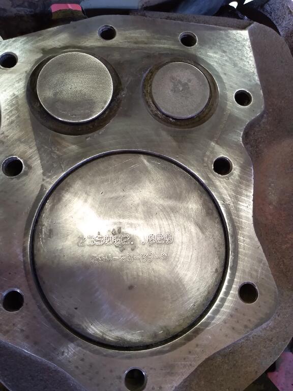

D_Mac 9,337 #19043 Posted May 19, 2023 Spent some time scrapping the dirt and grim off the 310 today. We looked the engine over and no sign of damage. Bore stamp on the piston. Head gasket and carb ordered. Excited to get it started. 2 1 Share this post Link to post Share on other sites

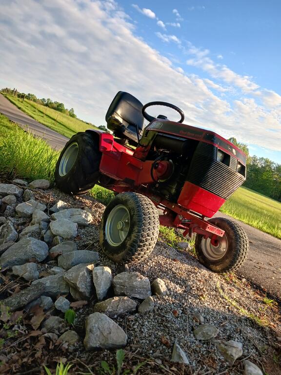

pfrederi 20,924 #19046 Posted May 19, 2023 21 hours ago, Pullstart said: Where are the rocks...NEPA deer eat rocks... 1 3 Share this post Link to post Share on other sites
Pullstart 70,847 #19047 Posted May 19, 2023 @pfrederi I found a handful, the size of a baseball. Not too many bigger than a cabbage around here 1 1 Share this post Link to post Share on other sites
