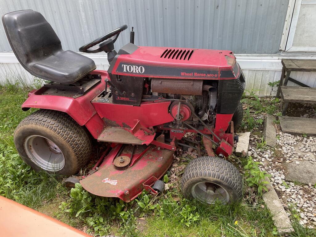

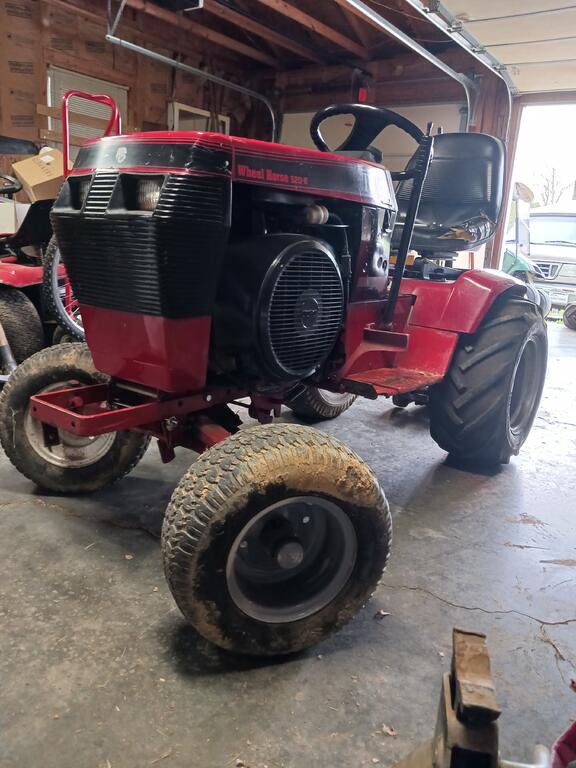

davem1111 2,297 #18976 Posted May 13, 2023 10 hours ago, c-series don said: @davem1111 @ebinmaine I believe there were only around 250 520-8’s produced. Someone here knows the exact number, maybe @cleat he’s a 520 guy. I can’t for the life of me figure out why they didn’t come with electric lift? That would make a really good rototilling tractor. Also think that’s a good tractor to put a loader on, with the gear reduction steering, forward swept front axle and heavy duty spindles. One way or the other we are going to need pictures of this 520-8, mainly because we like pictures!😂 Well, obviously it has the forward swept front axle. Don't know much else at this point except what I can tell from this picture. Sounds like I should probably rescue it... 8 hours ago, Bill D said: Agreed. Worth $400. Probably needs an ignition module. Definitely worth fixing. Did it have the gear reduction steering? I didn't have much time to look it over, and the guy was in a big hurry - he needed to finish mowing and drive 90 minutes up to North Indy for something. I'll probably give him a call to see if I can stop by again soon for a closer look. 5 1 Share this post Link to post Share on other sites
ebinmaine 79,787 #18977 Posted May 13, 2023 1 minute ago, davem1111 said: Well, obviously it has the forward swept front axle. Don't know much else at this point except what I can tell from this picture. Sounds like I should probably rescue it... I didn't have much time to look it over, and the guy was in a big hurry - he needed to finish mowing and drive 90 minutes up to North Indy for something. I'll probably give him a call to see if I can stop by again soon for a closer look. At $400 you CAN'T lose money on that. The front axle is worth most of that. The rear wheels are $100 more. 2 2 Share this post Link to post Share on other sites
Pullstart 70,847 #18978 Posted May 13, 2023 @c-series don I believe the 520-8 production number was 226. 4 Share this post Link to post Share on other sites

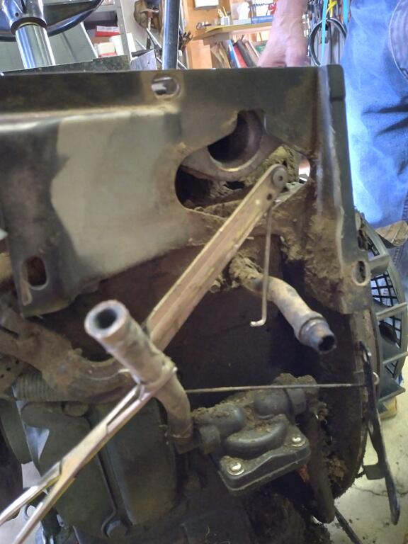

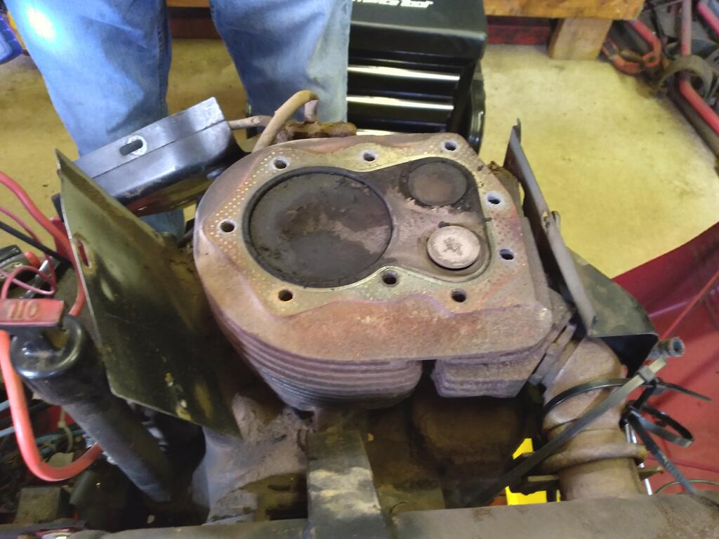

D_Mac 9,337 #18982 Posted May 13, 2023 Carb and head removal on the free 310-8. 5 1 Share this post Link to post Share on other sites

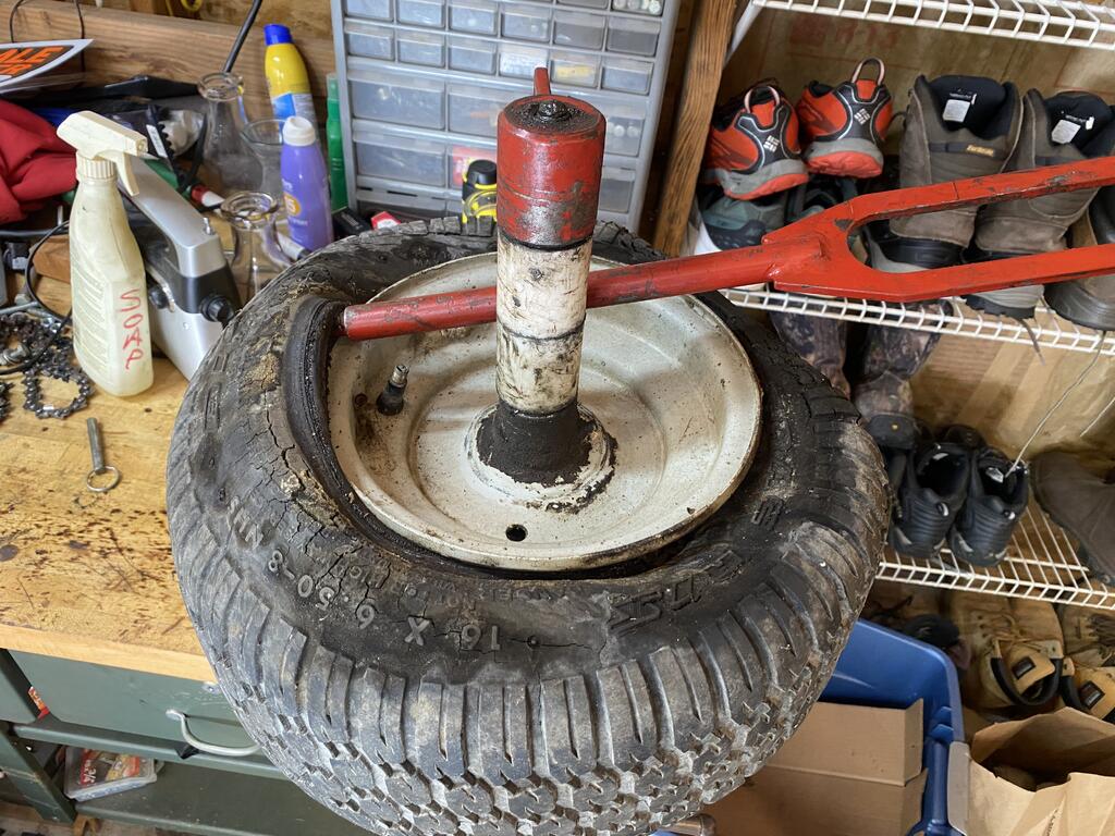

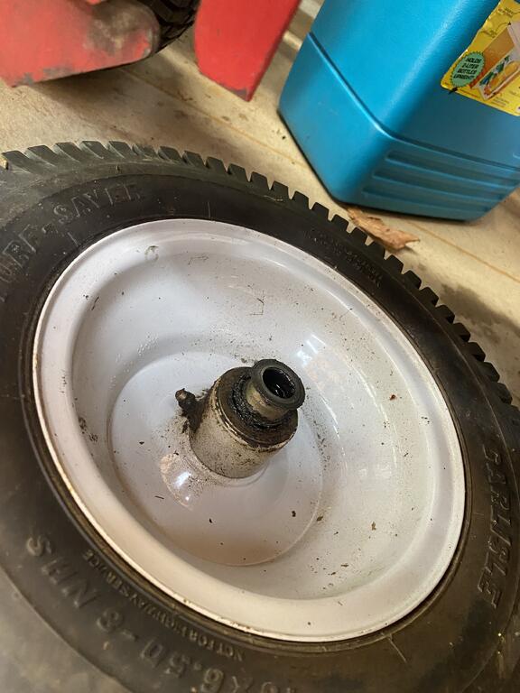

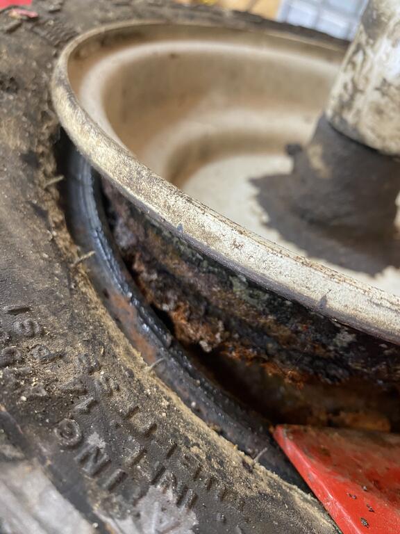

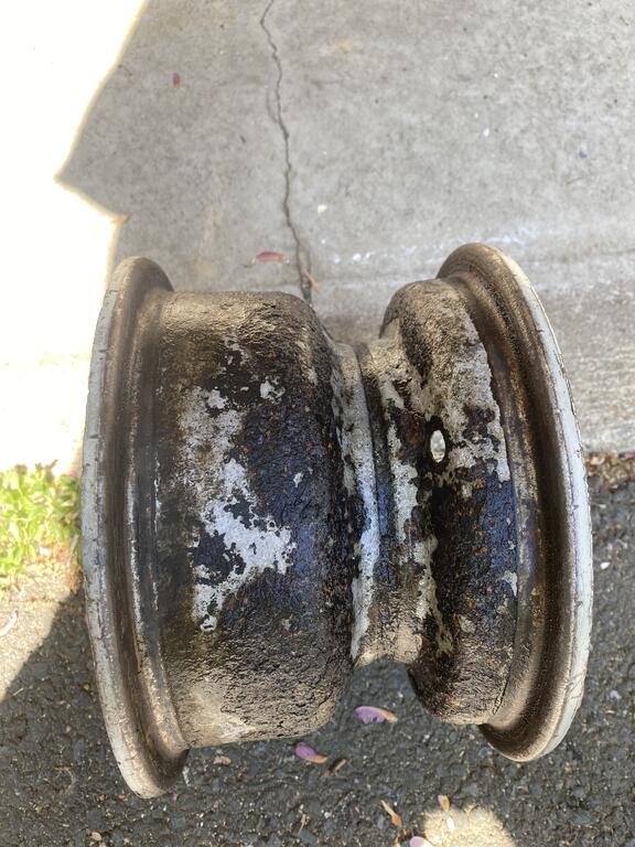

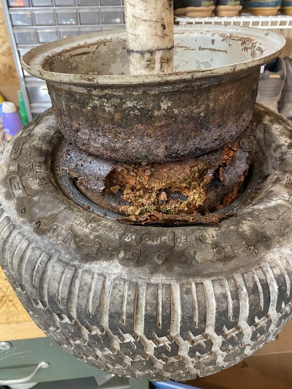

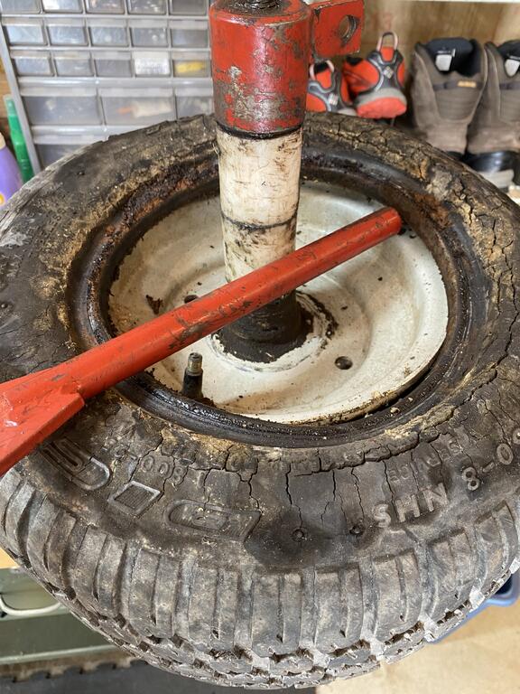

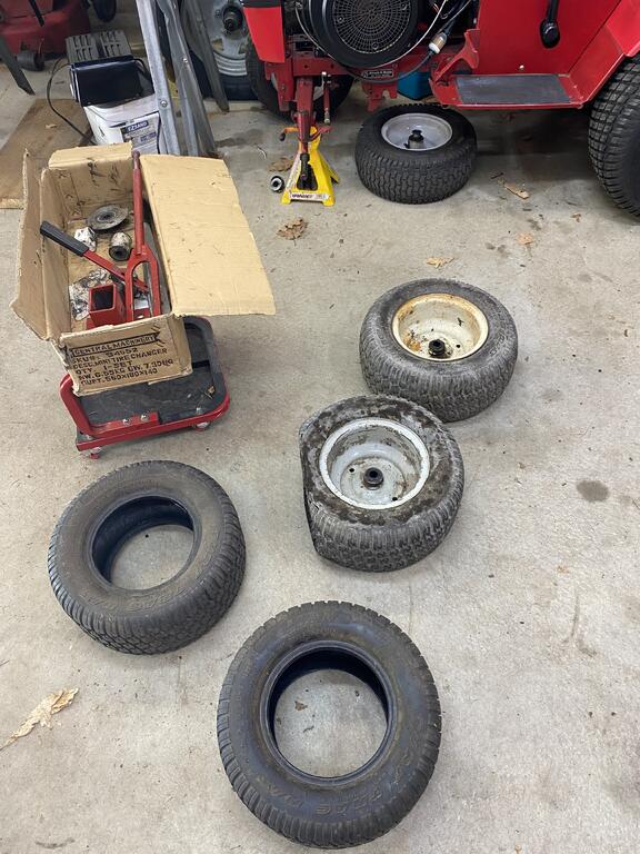

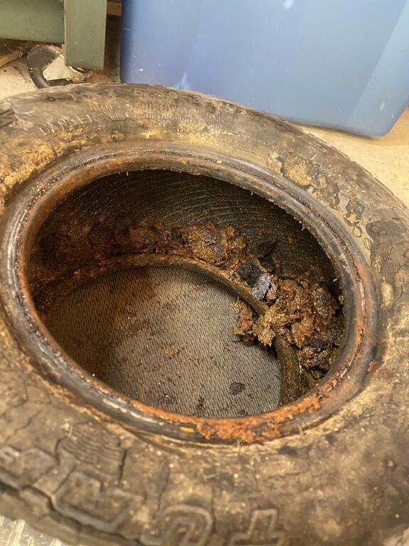

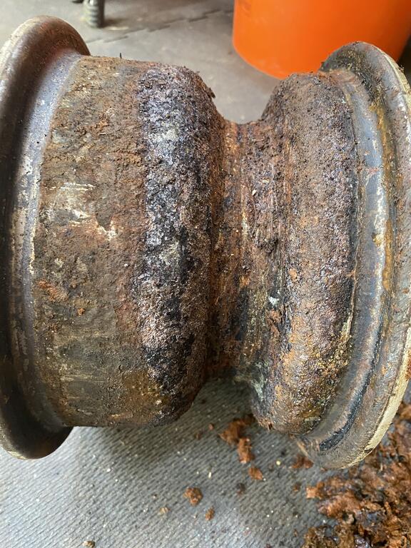

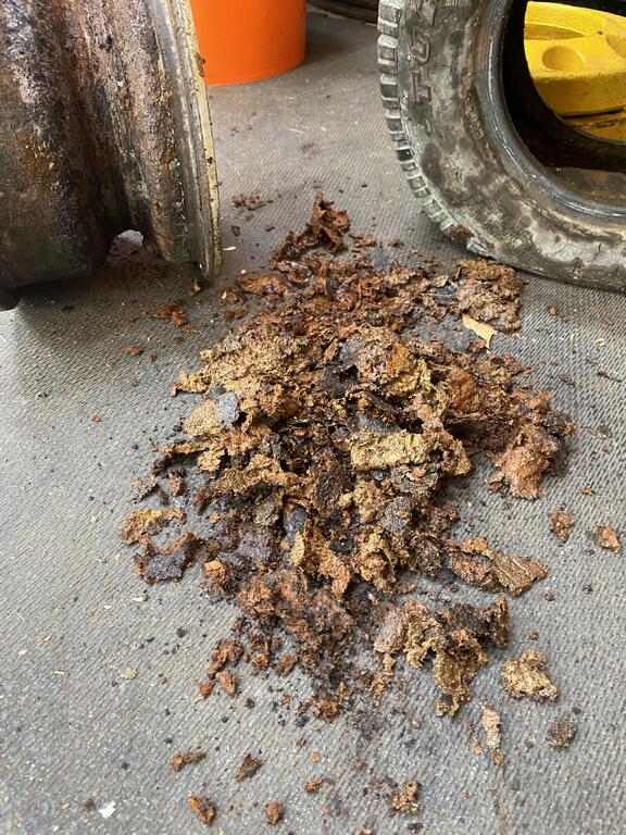

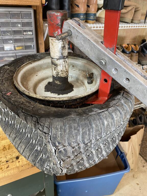

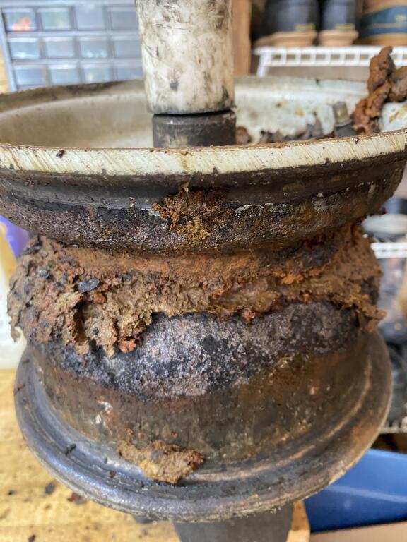

Sparky-(Admin) 26,002 #18985 Posted May 14, 2023 Starting a front tire swap for the 414. The front wheels are not correct and have some sorta spacer to make em fit. So the shot tires on the correct wheels need to come off…out comes the Harbor Freight tire remover/installer. What do you think the crap is that’s in the first tire? Old tire sealant? I scraped out the wheel and it looks like it’ll clean up with some elbow grease. 5 2 1 Share this post Link to post Share on other sites
SylvanLakeWH 31,827 #18986 Posted May 14, 2023 Looks like old fixaflat to me... 1 1 1 Share this post Link to post Share on other sites

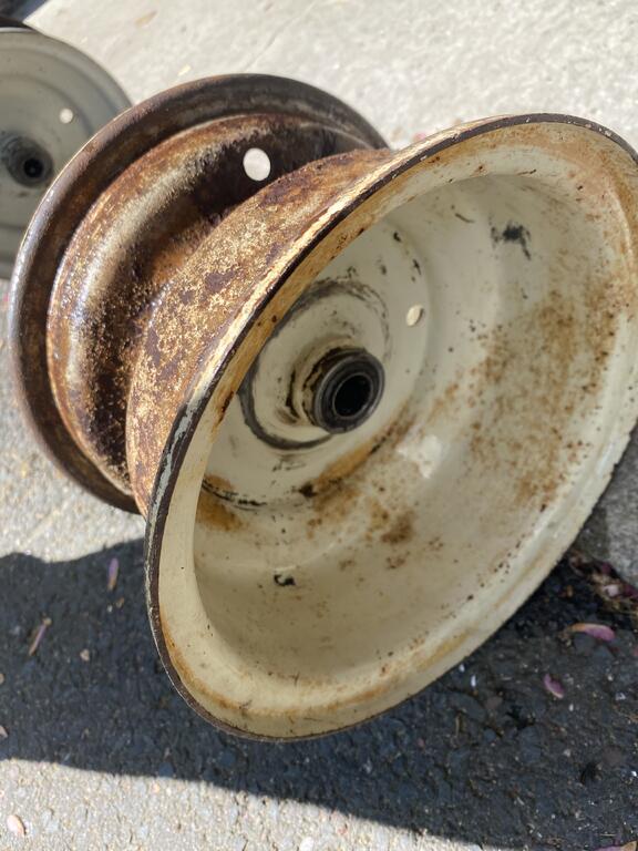

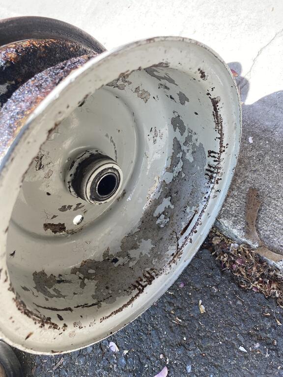

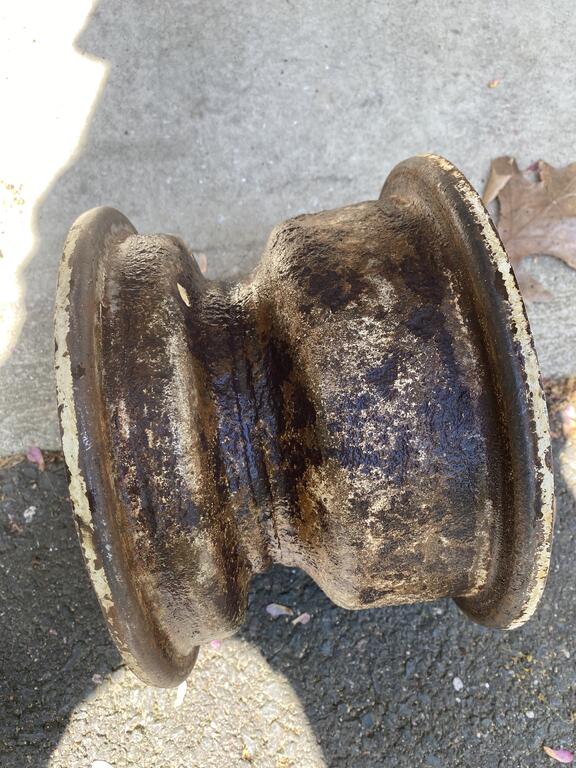

Sparky-(Admin) 26,002 #18987 Posted May 14, 2023 The wheels actually cleaned up pretty well. This is after a good ol’ scrubbing with simple green. Next weekend will be sanding and wire wheel work and then get some paint on em! 6 1 Share this post Link to post Share on other sites
Handy Don 17,039 #18988 Posted May 14, 2023 3 hours ago, Sparky said: Next weekend will be sanding and wire wheel work and then get some paint on em! I'd consider “e-tanking” them first, if you have the setup. 1 Share this post Link to post Share on other sites
squonk 47,476 #18989 Posted May 14, 2023 19 minutes ago, Handy Don said: I'd consider “e-tanking” them first, if you have the setup. All you need is a plastic garbage can, battery charger, wash soda, chunk of steel and some wire! 7 4 Share this post Link to post Share on other sites
kpinnc 18,771 #18990 Posted May 14, 2023 (edited) 2 hours ago, squonk said: All you need is a plastic garbage can, battery charger, wash soda, chunk of steel and some wire! Baking soda works in a pinch as well. Don't put galvanized anything in there! It makes a goopier mess than what you scrubbed off the wheels! Sacrificial metal should be non-plated ferrous only. Absolutely no stainless! Just a rusty old pile of wire or similar. Beat the loose rust off and use it. Edited May 14, 2023 by kpinnc 1 Share this post Link to post Share on other sites

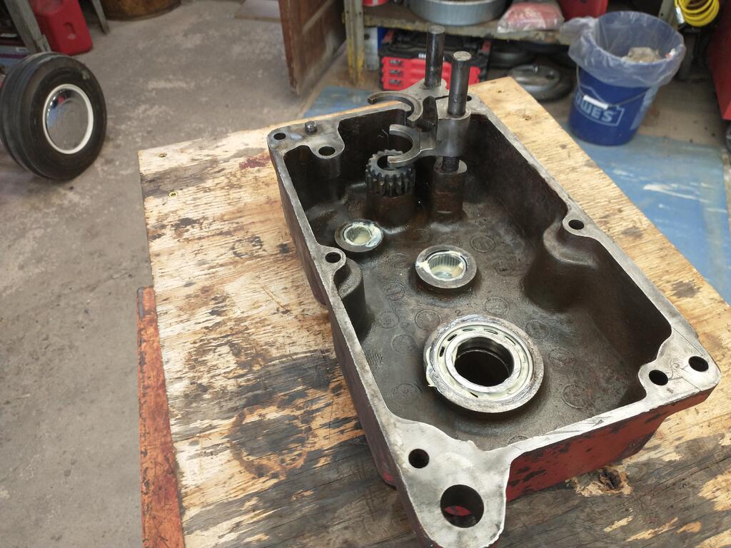

squonk 47,476 #18991 Posted May 14, 2023 Another 5025 going together! 4 4 Share this post Link to post Share on other sites

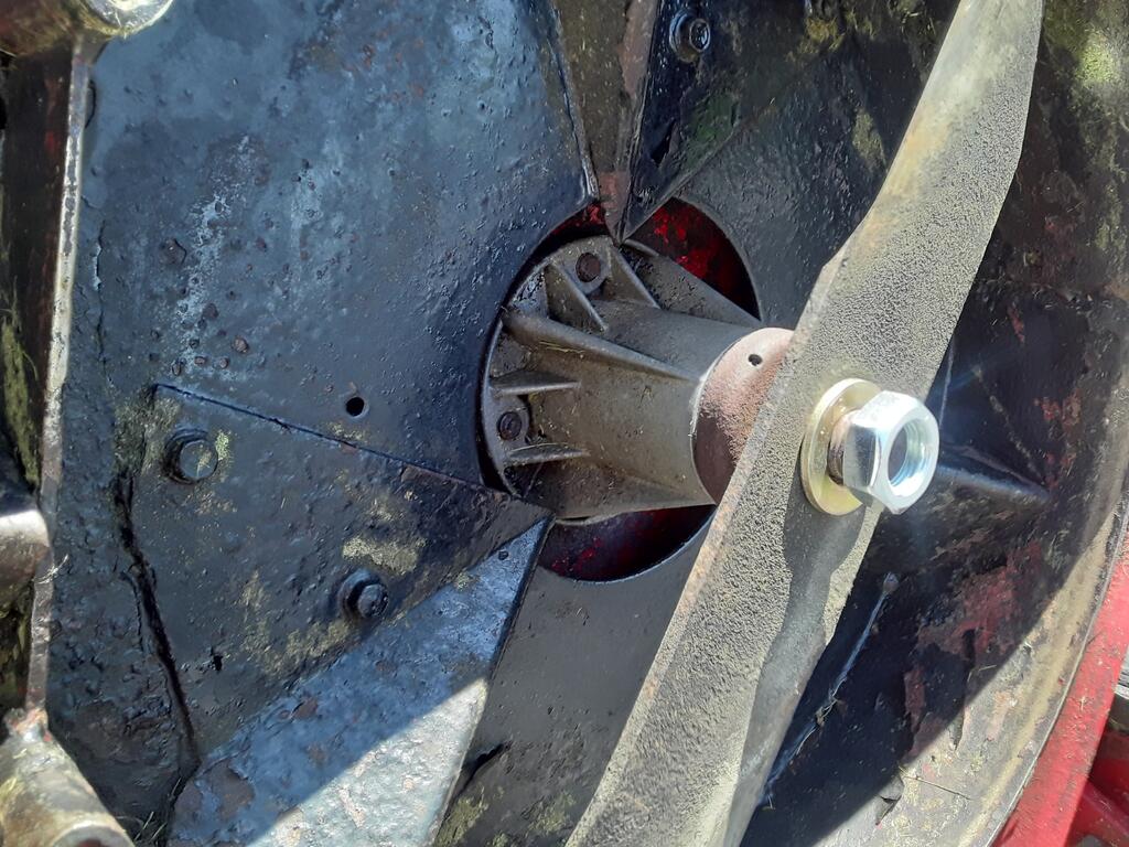

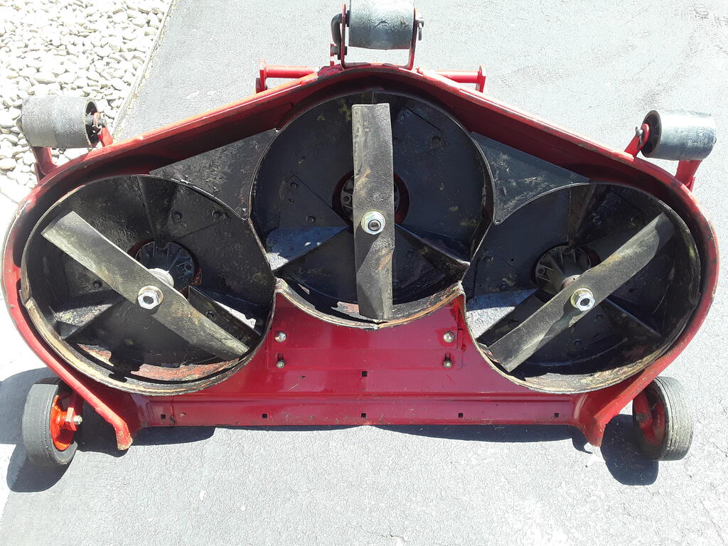

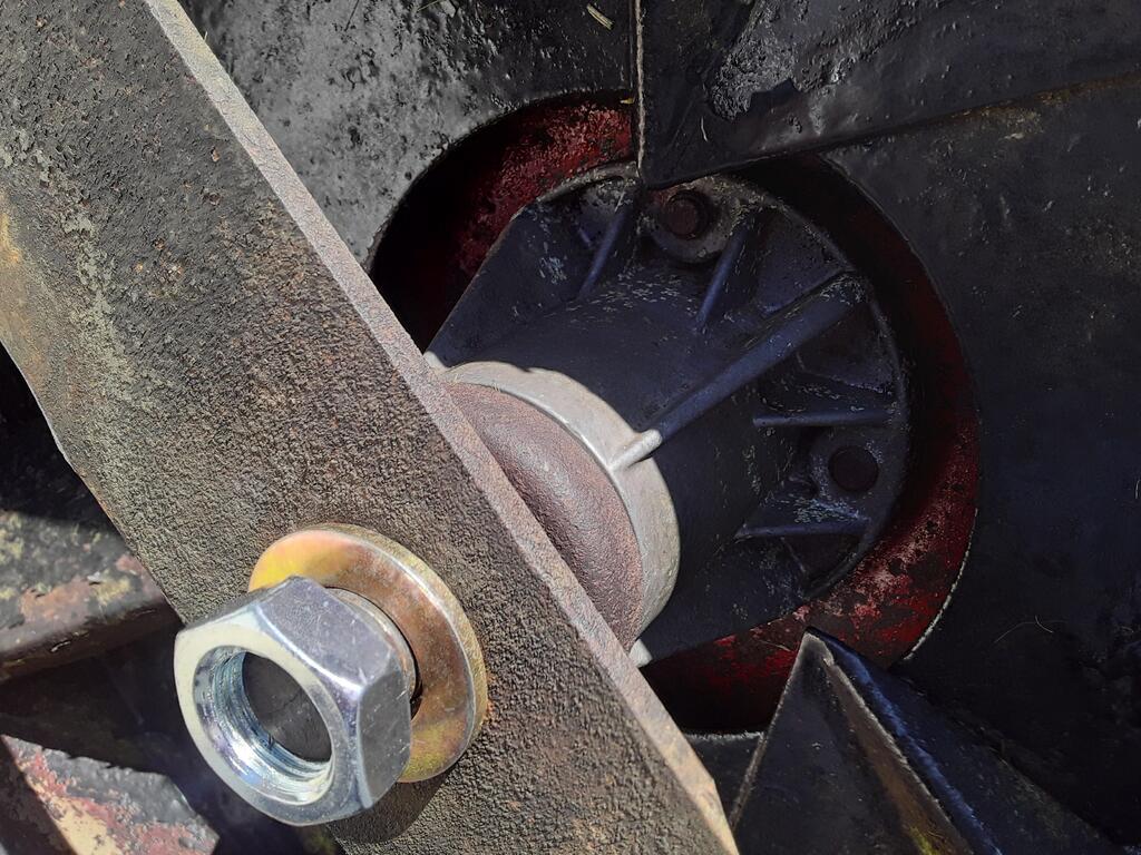

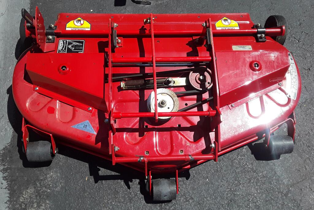

76c12091520h 4,241 #18992 Posted May 15, 2023 Serviced my 42" Recycler deck ; this has been in use since 1996. 27 years of weekly use, just common sense maintenance , no oil soak downs, no fancy coatings ,only cut when its dry (mostly) . I replaced one spindle belt about 8 years ago, the front rollers once, and one set of gauge wheels.....best quality of cut deck Toro / Wheel Horse ever offered. 7 7 1 Share this post Link to post Share on other sites
Handy Don 17,039 #18993 Posted May 15, 2023 40 minutes ago, 76c12091520h said: best quality of cut deck Toro / Wheel Horse ever offered Absolutely agree. I set up one of these on my son’s 312-H and even his neighbors comment on the the smooth cut and not having to handle clippings. They are heavy, though 😉 Share this post Link to post Share on other sites

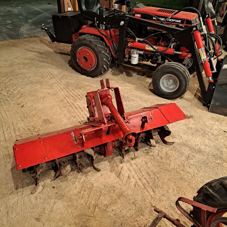

WHX?? 57,493 #18995 Posted May 15, 2023 (edited) Had some wrangling going on here tonite... bunch a dammed horse thieves... Well we run em off and they was so skereed they dropped a D tiller and a Pond bhind and ran... Edited May 15, 2023 by WHX?? 2 9 1 2 Share this post Link to post Share on other sites
squonk 47,476 #18996 Posted May 15, 2023 6 hours ago, WHX?? said: Had some wrangling going on here tonite... bunch a dammed horse thieves... Well we run em off and they was so skereed they dropped a D tiller and a Pond bhind and ran... All he's missing is a pair of spurs! 1 4 Share this post Link to post Share on other sites
76c12091520h 4,241 #18997 Posted May 15, 2023 9 hours ago, WHX?? said: Had some wrangling going on here tonite... bunch a dammed horse thieves... Well we run em off and they was so skereed they dropped a D tiller and a Pond bhind and ran... WHX , what size/ brand of front tires are you running on the 520 loader and how do you like them? Share this post Link to post Share on other sites

TJ5208 1,841 #18999 Posted May 15, 2023 On 5/12/2023 at 9:40 PM, c-series don said: @davem1111 @ebinmaine I believe there were only around 250 520-8’s produced. Someone here knows the exact number, maybe @cleat he’s a 520 guy. I can’t for the life of me figure out why they didn’t come with electric lift? That would make a really good rototilling tractor. Also think that’s a good tractor to put a loader on, with the gear reduction steering, forward swept front axle and heavy duty spindles. One way or the other we are going to need pictures of this 520-8, mainly because we like pictures!😂 225 were made. 1 Share this post Link to post Share on other sites
TJ5208 1,841 #19000 Posted May 15, 2023 On 5/13/2023 at 8:30 AM, davem1111 said: Well, obviously it has the forward swept front axle. Don't know much else at this point except what I can tell from this picture. Sounds like I should probably rescue it... I didn't have much time to look it over, and the guy was in a big hurry - he needed to finish mowing and drive 90 minutes up to North Indy for something. I'll probably give him a call to see if I can stop by again soon for a closer look. Let me know where it's at and it won't be sitting there anymore Share this post Link to post Share on other sites
