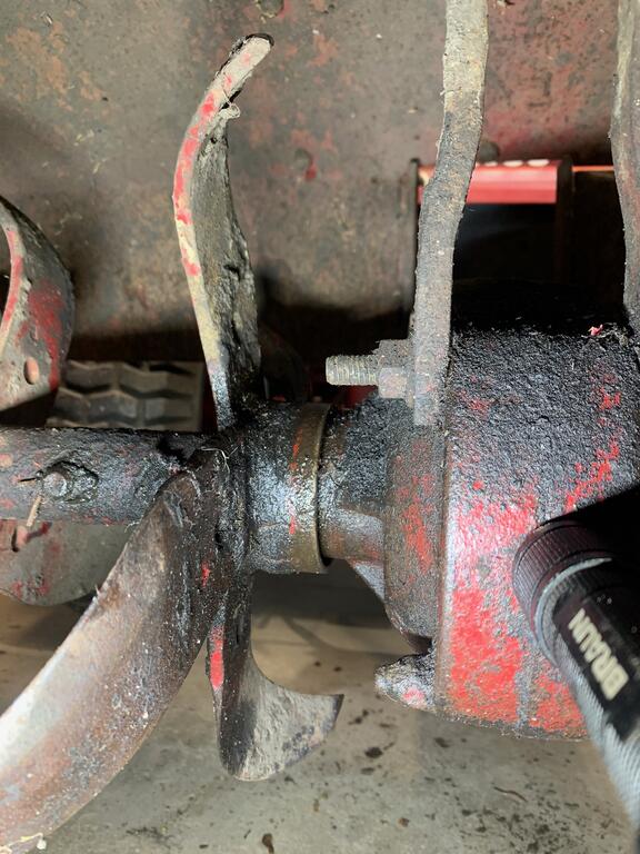

Andy N. 2,806 #18879 Posted April 30, 2023 (edited) I think it's time to reseal the tiller drive axles. Hopefully it will dry out later in the week so I can put it to good use! Edited May 1, 2023 by Andy N. 7 3 Share this post Link to post Share on other sites

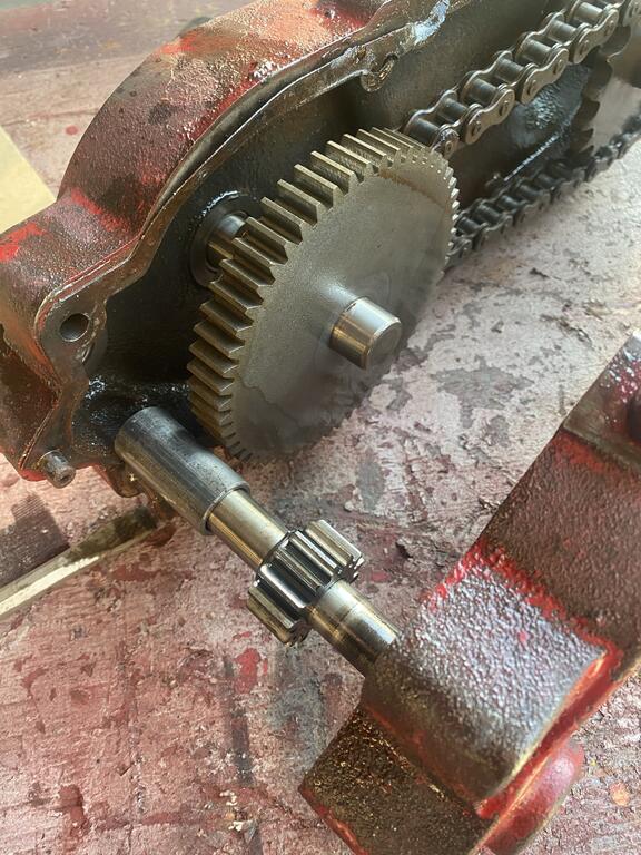

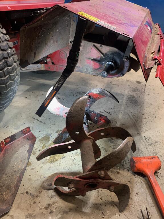

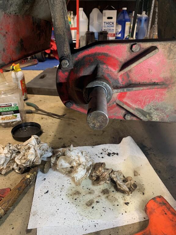

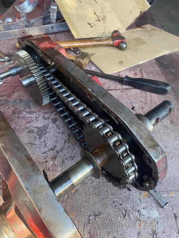

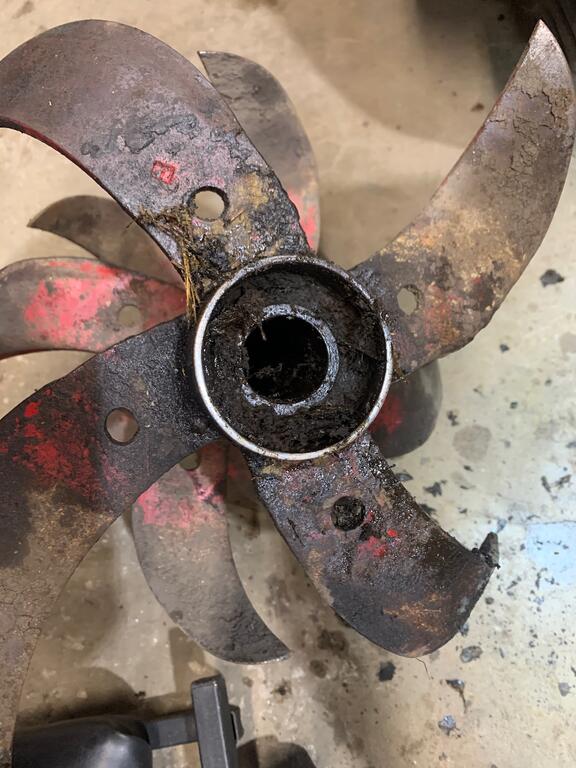

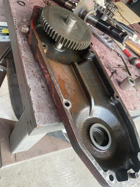

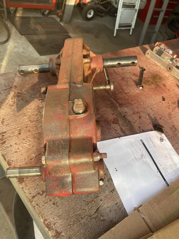

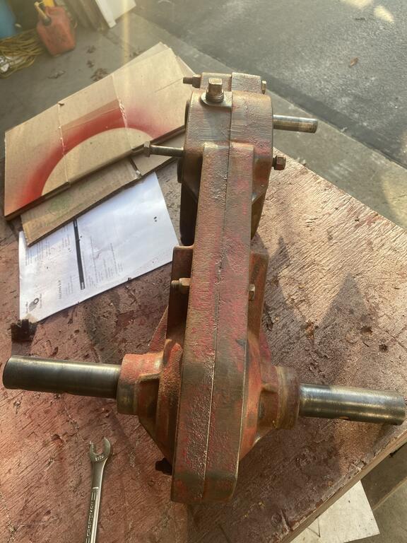

c-series don 12,375 #18883 Posted April 30, 2023 I resealed mine one of mine a few years ago. It was relatively easy, the hardest part was removing the tines. I found that heat and then IMMEDIATELY using it in hard ground with the pins removed worked best. Here’s some pics, I know you guys like pictures! 3 3 1 Share this post Link to post Share on other sites
rick 310 #18884 Posted April 30, 2023 I see the unit has 2 tine shaft seals, does the outer seal go in backwards to help keep debris away from the inner seal? Share this post Link to post Share on other sites

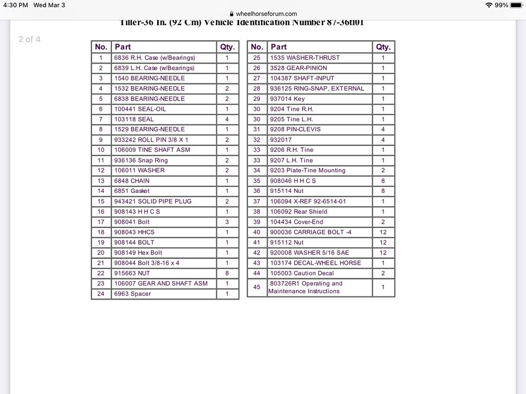

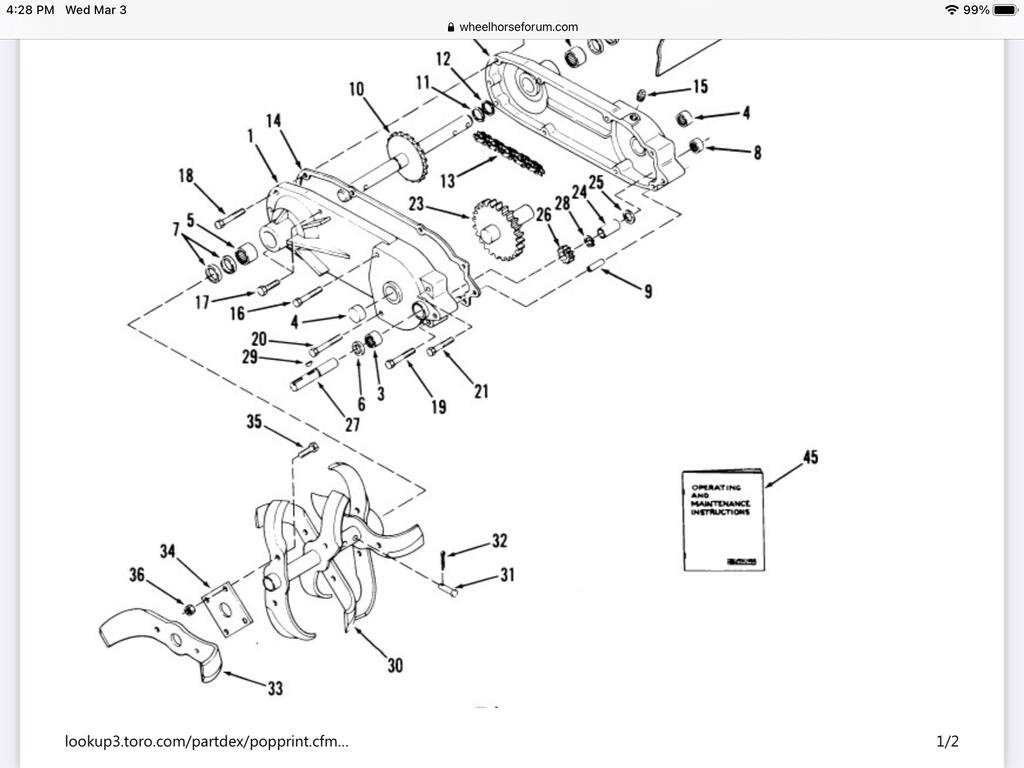

Andy N. 2,806 #18885 Posted April 30, 2023 3 hours ago, TonyToro said: We have to do ours too. Would you by chance still have the part number? I bet everything slid off easily though…lol 103118 https://wheelhorsepartsandmore.com/product/103118-tiller-tine-seal-kit-wheel-horse-qty-4/ It's a 4 pack because the parts book calls out 2 for each side. I could only get 1 to fit so we'll see how that goes. The replacement seals look like a different design than what I removed, but they did stop the active leaking. 2 1 Share this post Link to post Share on other sites
Andy N. 2,806 #18886 Posted April 30, 2023 2 hours ago, pfrederi said: Some of those tines are pretty well worn but replacements are $$$$ That is so true. It's cheaper to buy another tiller. This tiller still turns this midwest soil just fine though. No rocks! I got it from a buddy from my hometown in upstate NY. As you know lots of rocks in the soil there. 3 Share this post Link to post Share on other sites
c-series don 12,375 #18887 Posted April 30, 2023 2 hours ago, rick said: I see the unit has 2 tine shaft seals, does the outer seal go in backwards to help keep debris away from the inner seal? Honestly it’s been over two years since I had it apart and can’t remember! Heck I can’t even remember where I got the seals and gaskets from! I do remember that I was able to source everything I needed from one place. I have everything painted and ready for assembly except the hood or cover or whatever you call it! That I need to sandblast and paint still. Also looking for the leveling piece that hinges on the back. I can’t seem to find one, suppose I could make one though. I also have the older version of this tiller that doesn’t have end plates or the leveling drag but I think this one would work better. One other thing I’d like to have for both of them is the belt guard that goes on the tiller itself. This I believe would stop the dirt from getting underneath the tractor and occasionally on my neck, face and right ear while doing deep tills !! 4 Share this post Link to post Share on other sites

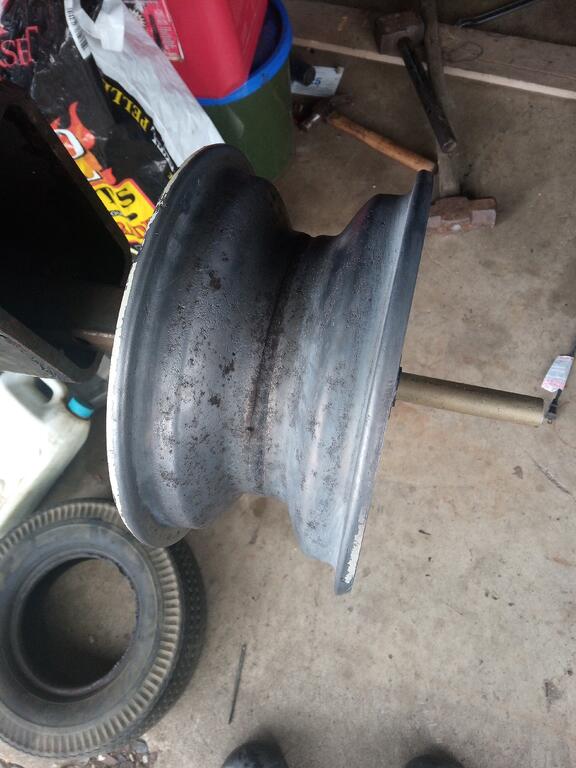

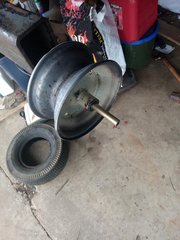

ohiofarmer 3,474 #18898 Posted May 1, 2023 I got tired of too many fifty year old front tires not holding aa flat ir. I did buy a stash of tubes for them a year or two ago. Time for action. This wheel was one with a glued on tire with gobs of dried on fix a flat. It was so bad that the tire had to be cut from the rim. I happened to watch a repair blog about a female owned small engine business and she was having a bad day because she made a customer angry when the hardened fix a flat punched a hole in a tire tube she put in. I thought " hold my beer and y will show you how to clean a rim". That old tire sealant is hard as a rock but is still flammable and melts or burns off pretty easily.nI went the extra mile and used solvent and brake cleaner and it was plenty clean for the inside of a wheel. .After inserting a tube I was able to apply evenly a coat of rust converter sealing the rust pits and etching the rest for Rust-Oleum damp metal primer. Simply the best. It was easy to get it applied over the inside and after the fire was back on it was left uninflated to paint the outside edge of the wheel. I usually spray my wheels, but rotating it on an axle did a nice job 3 3 Share this post Link to post Share on other sites
