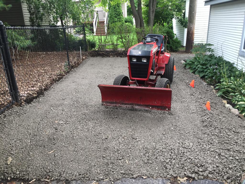

SylvanLakeWH 32,074 #17277 Posted October 4, 2022 (edited) 8 hours ago, ebinmaine said: What is that by size of rock? It’s crushed limestone gravel up to 1.5” with the fines still in it. (Unwashed). The fines work like mortar and lock up the gravel. You want crushed, not rounded or pebbles… they will never lock up. Here’s my trailer storage area. Hard as a rock… Edited October 4, 2022 by SylvanLakeWH 5 1 1 Share this post Link to post Share on other sites
ebinmaine 80,198 #17278 Posted October 4, 2022 24 minutes ago, SylvanLakeWH said: limestone That looks similar to the gray top coat that's in a lot of the pictures. It doesn't quite hammer down and stay put though. Trina's mom suggested combining what's there with some concrete as was said here somewhere. 2 Share this post Link to post Share on other sites
953 nut 68,367 #17279 Posted October 4, 2022 @ebinmaine, runner crush is the best base for a good hard driveway. It is a combination of 1 1/2" crushed granite and stone dust. It has great compaction and won't erode once it has been compacted. 2 Share this post Link to post Share on other sites

SylvanLakeWH 32,074 #17295 Posted October 4, 2022 2 hours ago, ebinmaine said: Renting a walk behind compactor would be a couple hundred bucks for a weekend. Obviously money well spent. I used the . Rolled it back and forth over the 21aa, moving over 3” at a time and locked it right up… compaction achieved with turf tires. No issues 3 years later. 2 Share this post Link to post Share on other sites
