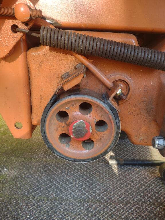

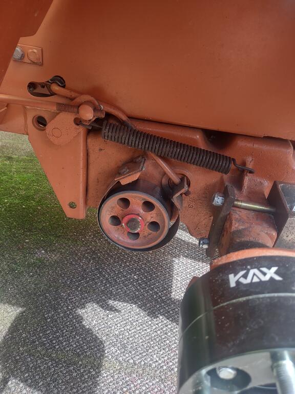

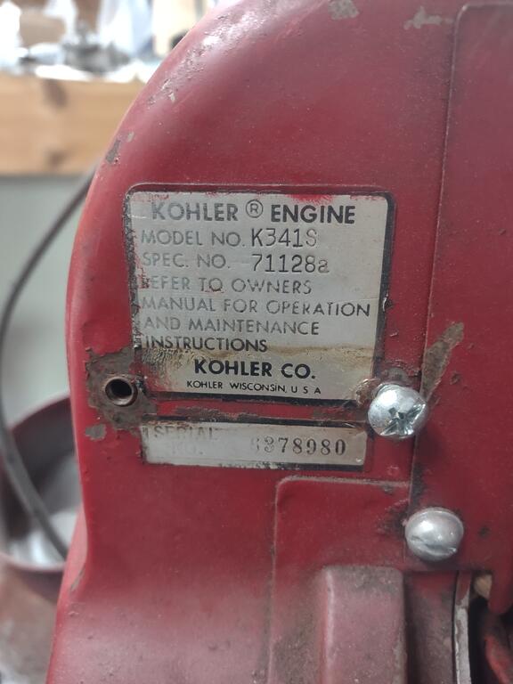

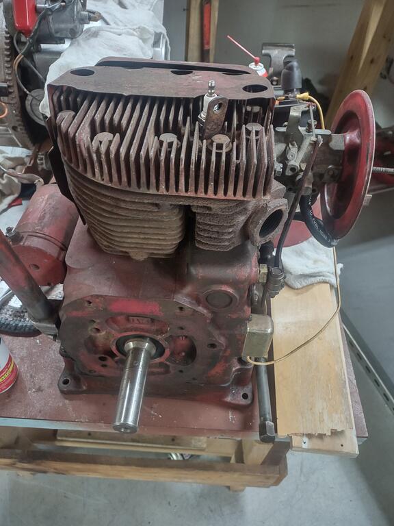

Rob J. 1,942 #17201 Posted September 28, 2022 1 hour ago, ebinmaine said: I puttered around here and there in the yard today. Messed with the wheels and brakes on Cinnamon Horse C160. Took apart the top of a K341. @gwest_ca can you please tell me what year and usage this might be? Trina took her momma shopping and then commenced to her own puttering around here. Did you get that brake pad glued in yet? 2 Share this post Link to post Share on other sites

ebinmaine 79,637 #17203 Posted September 28, 2022 1 hour ago, Rob J. said: Did you get that brake pad glued in yet? Yessir. It's glued in the pics. 1 Share this post Link to post Share on other sites

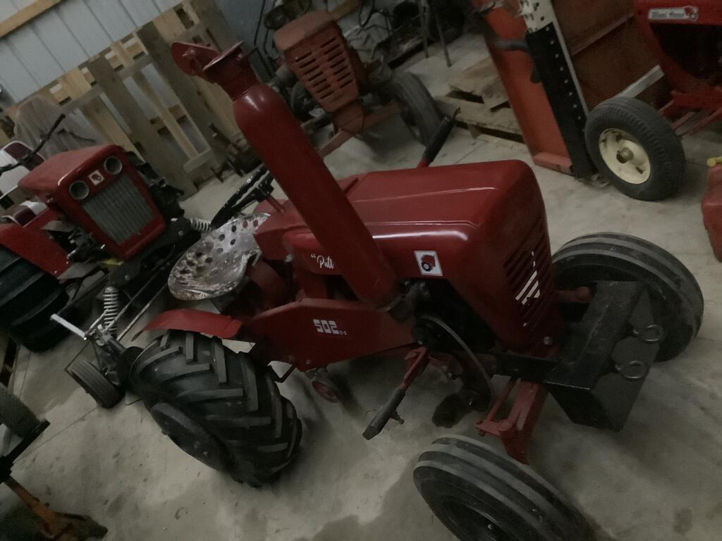

Pullstart 70,656 #17204 Posted September 28, 2022 @ohiofarmer your lift makes me wonder if a guy could make an engine hoist adapted to be a tractor lift… Thanks to Kollin @The Freightliner Guy’s inquiry, Putt Putt (Kollin dubbed Pull Pull because if t wouldn’t start) fired up tonight for the first time since about this time in 2020 when the @PeacemakerJack clan was here visiting! It just needed a good spark plug. I sure do miss that mohawk… 4 Share this post Link to post Share on other sites

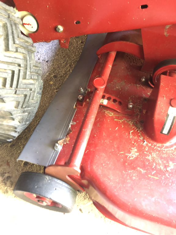

Handy Don 16,937 #17205 Posted September 28, 2022 (edited) This afternoon I was able to button up the RM-366 deck for the third (charmed) time. I'd already replaced the bent cross-shaft and re-re-balanced the blades, but found I had too much face-to-spur gear lash when the face gears were fully seated on the cross shaft. A bunch of fiddling and feeler-gauging showed I needed to move the face gears apart (i.e. toward the spurs) by about .06" to fully remove the gear lash. @ri702bill suggested leaving about .01" or so for grease and thermal expansion. (Note: the cross shaft not being locked in place, the .06" could be added to one end of the shaft.) I was about to buy a ⅝" ID shim washer set from McMaster but thought "heck, give the Ace Hardware Hillman drawers a try", right? Bingo. 50¢ and only needed a notch filed to clear the woodruff key. It's now between the back of one face gear and the step on the shaft that seats the gear. Vastly reduced noise and vibration. Also added a 4" cove base flap to the rear discharge using the four pre-existing holes on the rear skirt of the deck. Get ready, grass, we're coming for you! Edited September 28, 2022 by Handy Don 2 2 Share this post Link to post Share on other sites

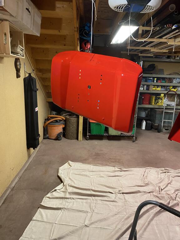

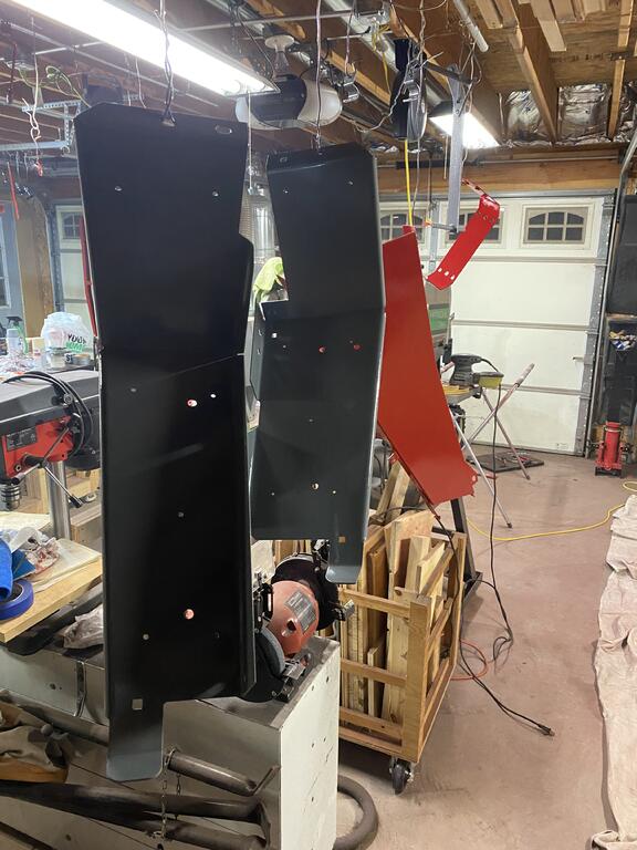

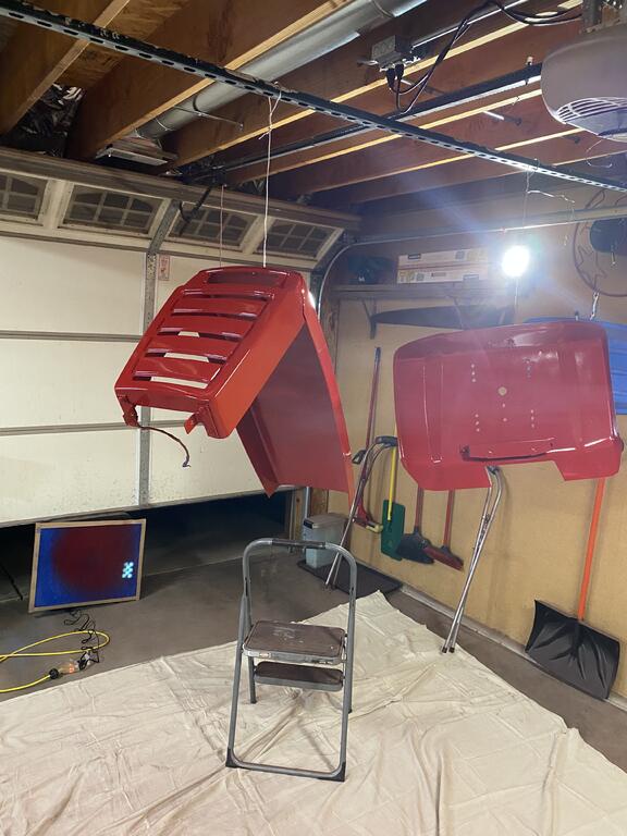

Heatingman 977 #17207 Posted September 28, 2022 Think Im finally done painting the parts. 6 Share this post Link to post Share on other sites

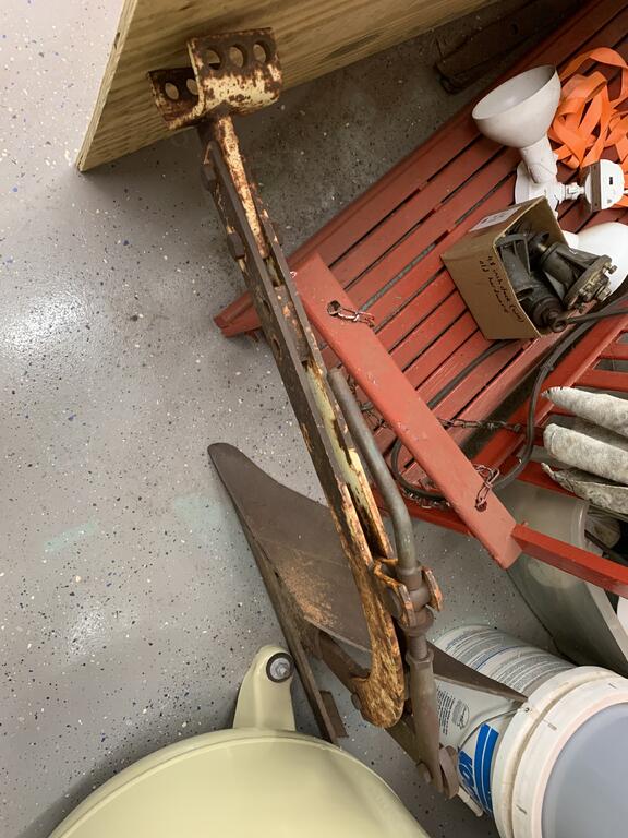

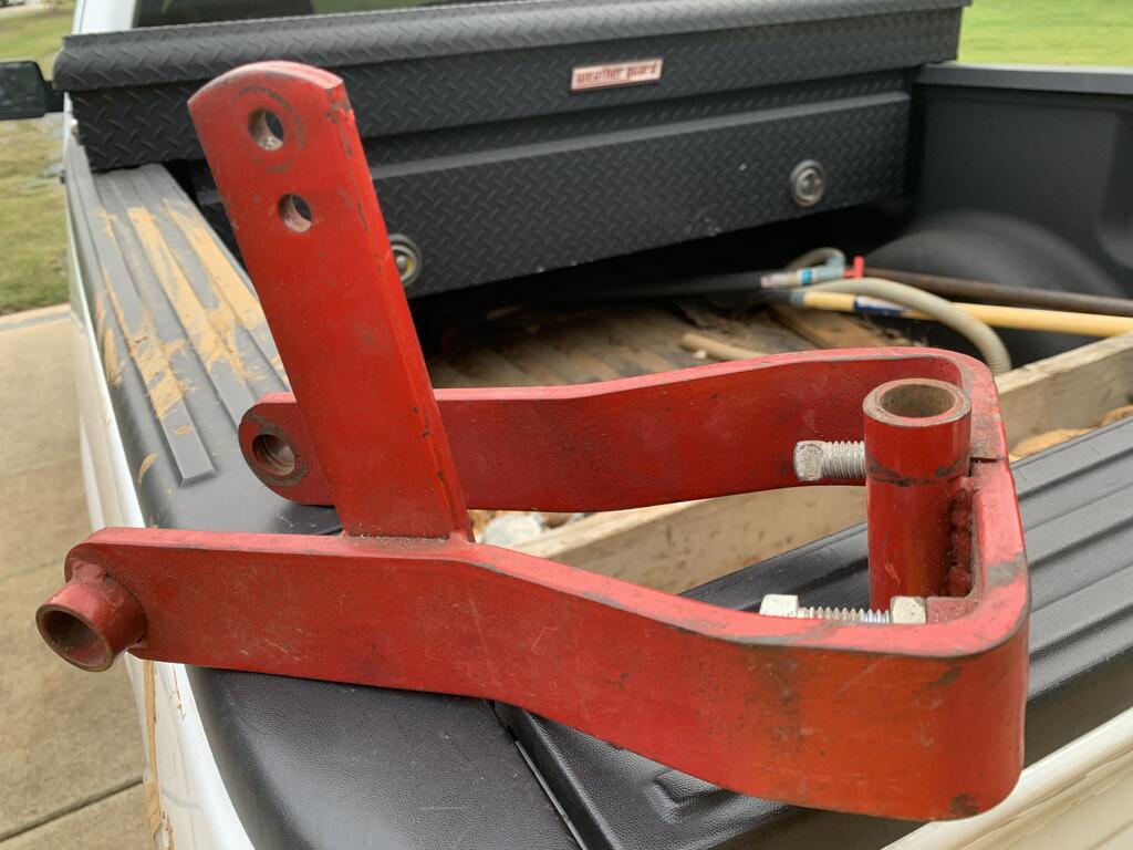

Horse Newbie 7,405 #17211 Posted September 28, 2022 I received my Clevis hitch from @19richie66 today… Over the winter I will restore/ paint my plow so I’ll be ready for spring planting season. Thanks Richie ! 4 4 1 Share this post Link to post Share on other sites

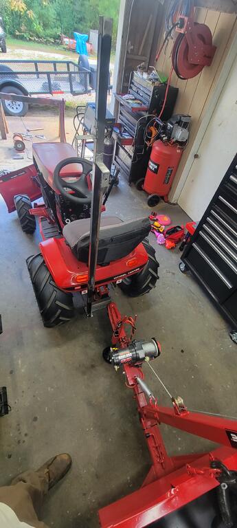

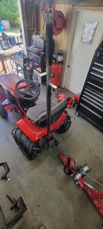

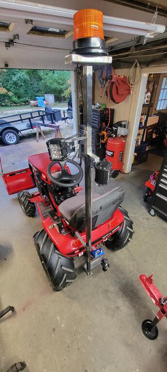

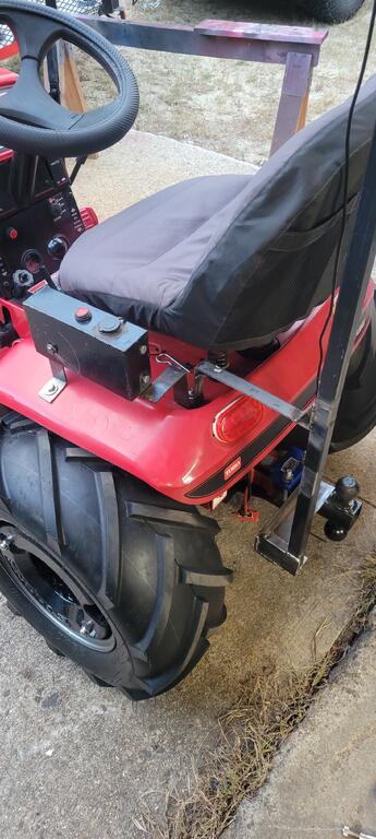

OldWorkHorse 3,153 #17212 Posted September 28, 2022 Welded up a caution light / rear LED light tower for my 314-8. Just need to paint it and finish connecting the wires tomorrow and be good to go. Should definitely help snowblowing / plowing. 3 4 Share this post Link to post Share on other sites
Horse Newbie 7,405 #17213 Posted September 28, 2022 4 minutes ago, OldWorkHorse said: Welded up a caution light / rear LED light tower for my 314-8. Just need to paint it and finish connecting the wires tomorrow and be good to go. Should definitely help snowblowing / plowing. Good gracious man !… are you planning to plow through a blizzard ? 4 Share this post Link to post Share on other sites
OldWorkHorse 3,153 #17214 Posted September 28, 2022 23 minutes ago, Horse Newbie said: Good gracious man !… are you planning to plow through a blizzard ? I mean in maine we get 1 snow storm and before can finish moving that snow another one is already dumping more on us. So yes pretty good odds I'll be in a blizzard and just want to be found and not lost 1 3 Share this post Link to post Share on other sites
Horse Newbie 7,405 #17215 Posted September 28, 2022 I’m just @OldWorkHorse. I know you fellows need all you can get up nawth… Down these parts we are lucky to get 1-2 inches every couple of years. I have a dozer blade and a mid mount scraper blade. They may never touch snow… 4 2 Share this post Link to post Share on other sites
OldWorkHorse 3,153 #17216 Posted September 28, 2022 6 minutes ago, Horse Newbie said: I’m just @OldWorkHorse. Down these parts we are lucky to get 1-2 inches every couple of years. I have a dozer blade and a mid mount scraper blade. They may never touch snow… Lucky, 1 to 2 inches up here people are still out riding their motorcycles haha . Seriously tho there is a guy in my town who rides his year round snow storm or downpour . 5 1 Share this post Link to post Share on other sites
