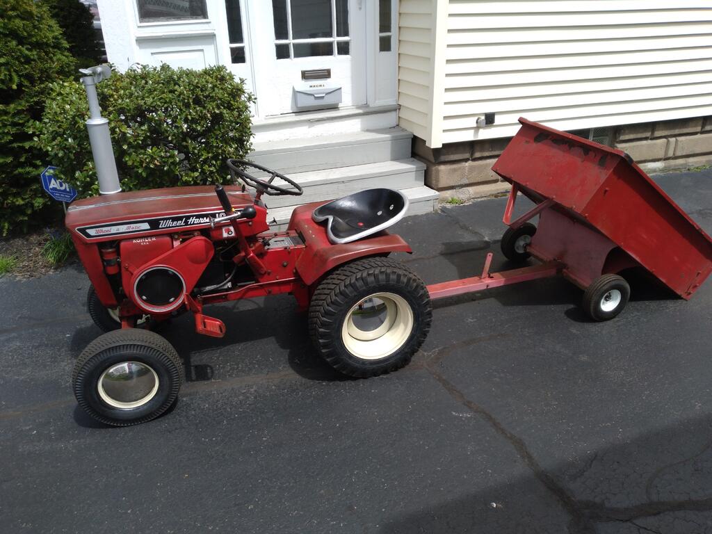

CodyP 51 #15526 Posted April 30, 2022 Put a better carb on it and changed the fuel line to clear and smaller clamp she runs like a champ now I have to get 4 new tires because I got a flat front and back at opposite sides I checked the vendors section but did not see anyone specializing in tires so where do you guys get your tires? 4 Share this post Link to post Share on other sites

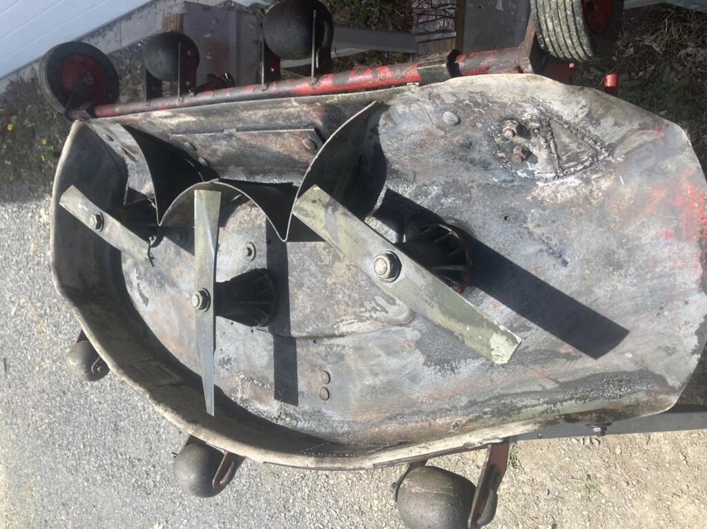

Ifixoldjunk 778 #15530 Posted April 30, 2022 (edited) I recently found some junky 14ga sheet metal at work. still had some good sections so I figured I might as well get some patches made for my rusty 42 side discharge. I had my younger brother who’s going to a welding school do the welding for me. Had to bribe him with food but whatever.🤣 I figure since the deck is 100% solid now, I’ll cut with it a few times just to see if the welds hold up to constant vibration and then I’ll paint the whole thing with POR-15 to ensure this is the last time patching is ever needed. Still have tons of sheet metal left as well. Definitely finding a place to store it cause I doubt this will be the last rusted mower I own. Edited April 30, 2022 by Ifixoldjunk 10 2 Share this post Link to post Share on other sites

Ifixoldjunk 778 #15534 Posted May 1, 2022 @davem1111 Thanks man, and yeah we used a non gas welder as well. Wheel horse decks are made of a hard to find thickness, at least for me. It’s 14ga. I checked out close to 10 different stores looking for it. I ended up using what I think was a hatch from a septic tank. According to my friend it’s been at least sitting outside in the elements for a few years so it was at least clean when I got it.😅 1 1 Share this post Link to post Share on other sites

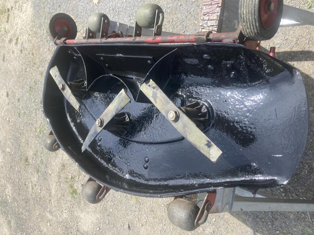

Ifixoldjunk 778 #15537 Posted May 1, 2022 Well, I got it down to bare steel and slapped on some POR-15. I think any issues with rust are all in the past now. Next up I’ll be giving it a top coat with some semi truck frame paint. Pretty much the hardiest paint I could find. 2 4 Share this post Link to post Share on other sites

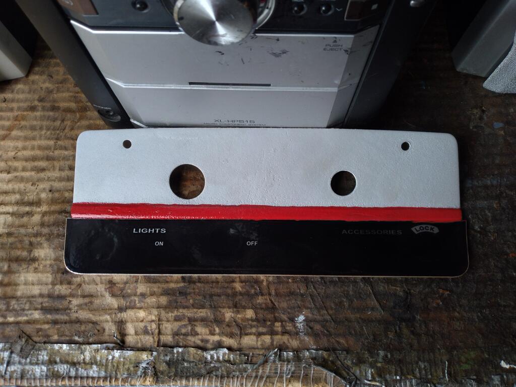

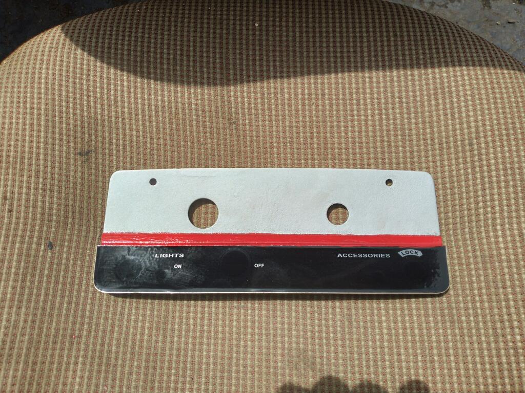

D_Mac 9,337 #15538 Posted May 1, 2022 So I went over to my buddies house this morning to pick up the dash off the 856 project. Leaving his house there was a junker picking up stuff on the curb. His truck was piled up so high I thought he may be related to @Pullstart. Well he was older and and trying to get a washing machine balanced in there. So I pulled over to help him lift it. Well as he was removing stuff in the truck in order to get this washing machine squeezed in, I spot this buried in the back. We pull it out, I told him I give him 10 bucks for it and help him load the washer. Deal. Needs tubes for the tires but it's all there. I put these little wheels on for now cause that's all I have until I get tubes. Works fine, nice and solid but paint peeling off. I painted the dash for the 856. I'm not going to paint the rest of the tractor. Going to leave it ratty looking, but I just wanted to do the dash. 3 14 Share this post Link to post Share on other sites

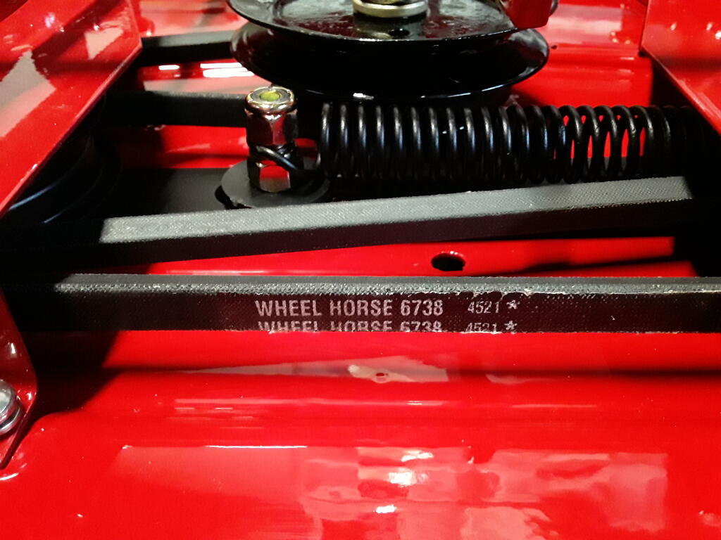

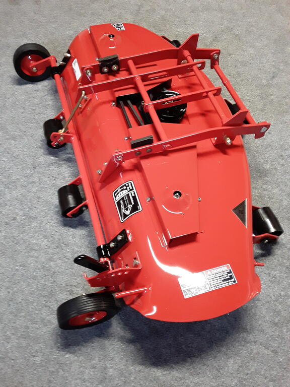

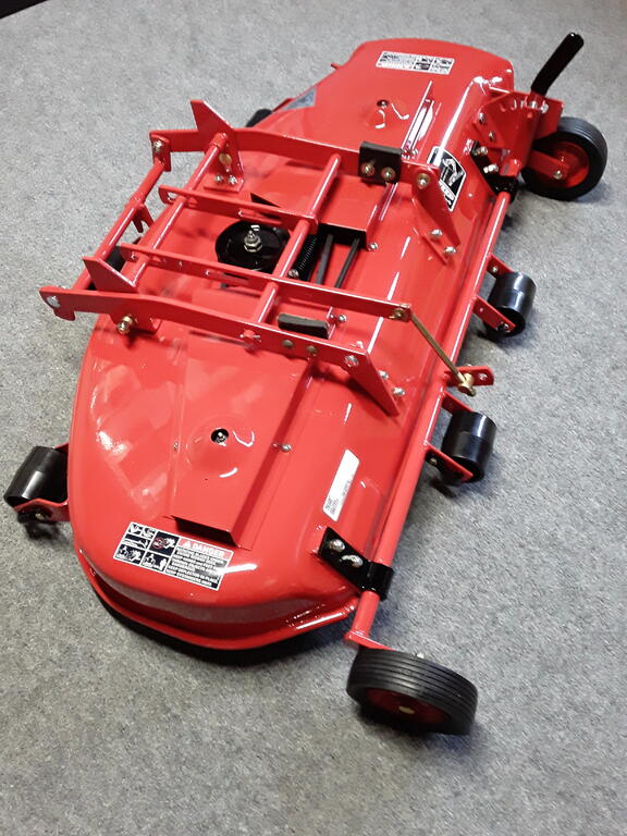

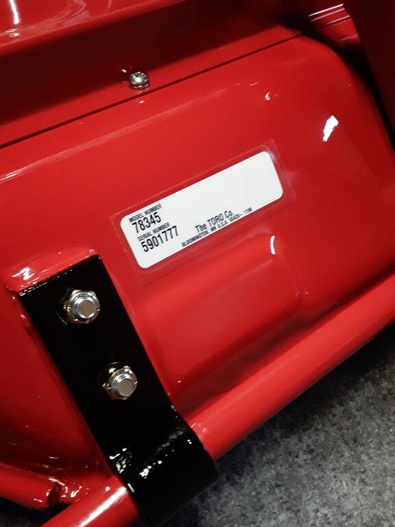

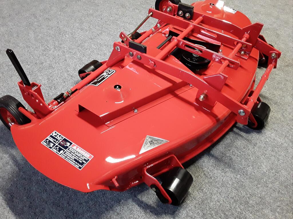

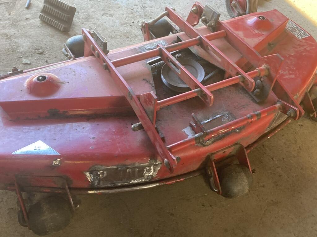

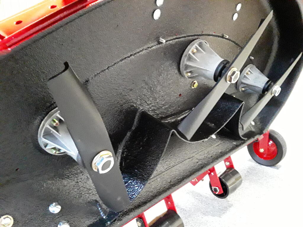

76c12091520h 4,238 #15540 Posted May 1, 2022 Completed the assembly / restoration of a 42" side 3 19 Share this post Link to post Share on other sites

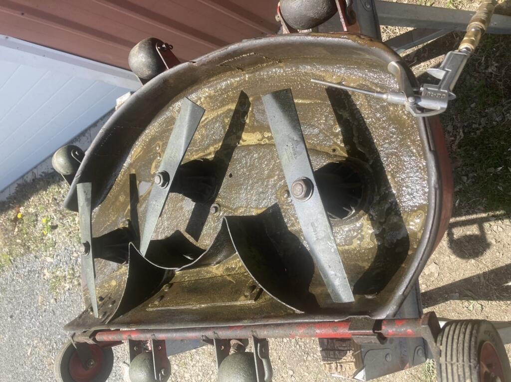

balconio 606 #15541 Posted May 1, 2022 Today was deck maintenance day for my 42" RD and SD decks. I used my new tool file to sharpen all the blades CORRECTLY for the first time in my life... I've always been an angle grinder guy but apparently that's way overkill and you ruin blades a lot faster. I got them nice and sharp with a few dozen passes and I feel a lot better about getting the cut angle correct too doing it by hand. I also added a patch and some filler welds to the 42" SD deck I bought from squonk last year. I find that to be satisfying work, spending an hour to make something a couple decades old last a few more years. Finally I treated all the spindles to some moly grease and hit all pivot points with white lithium grease. We're ready to mow!! AND from what I read, the northeast is predicted to have a wet summer and lots of mowing. 5 Share this post Link to post Share on other sites
Horse Newbie 7,405 #15542 Posted May 1, 2022 2 hours ago, Ifixoldjunk said: Well, I got it down to bare steel and slapped on some POR-15. I think any issues with rust are all in the past now. Next up I’ll be giving it a top coat with some semi truck frame paint. Pretty much the hardiest paint I could find. Did you degrease and etch the metal before applying the POR 15 ? 1 Share this post Link to post Share on other sites

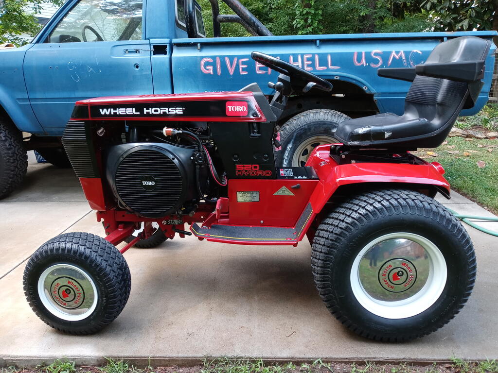

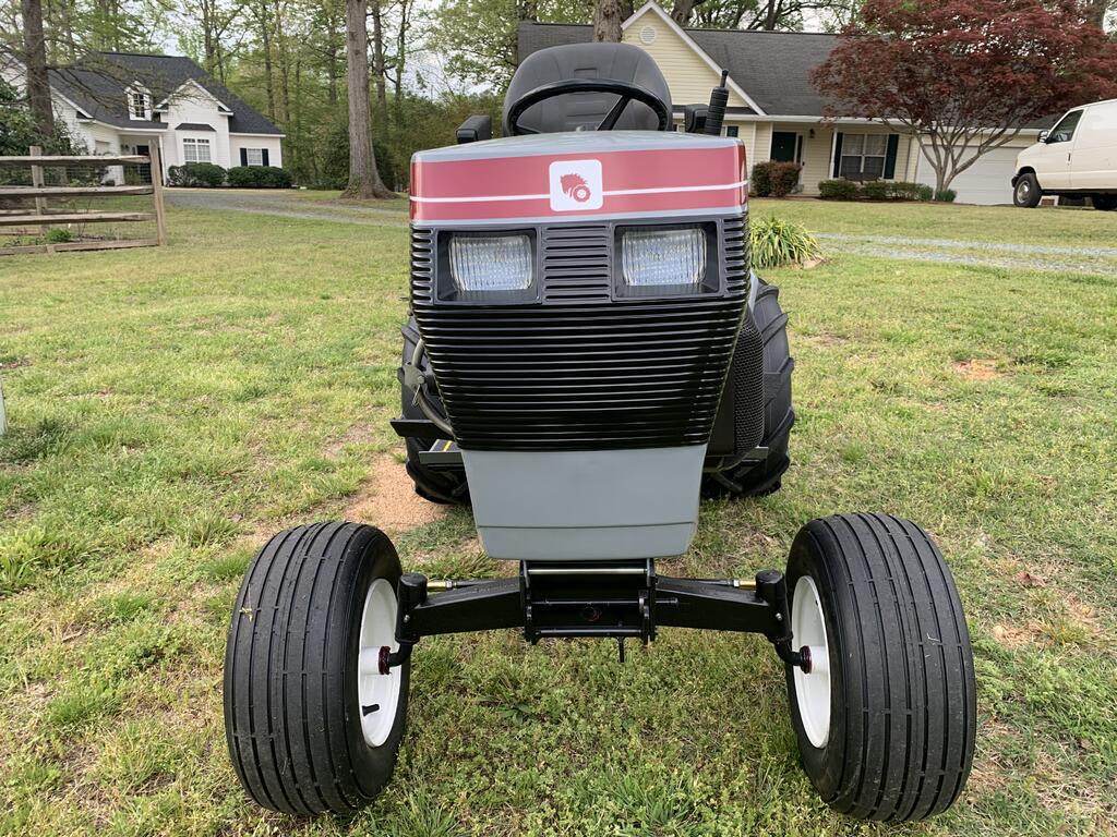

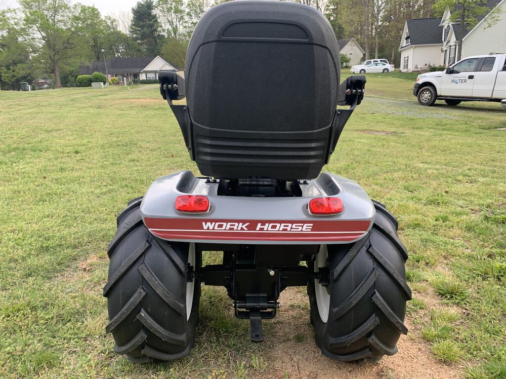

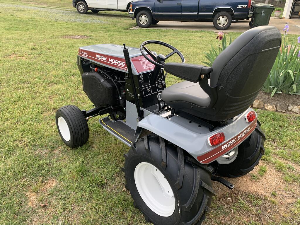

Horse Newbie 7,405 #15543 Posted May 1, 2022 On 4/30/2022 at 2:54 PM, CodyP said: Put a better carb on it and changed the fuel line to clear and smaller clamp she runs like a champ now I have to get 4 new tires because I got a flat front and back at opposite sides I checked the vendors section but did not see anyone specializing in tires so where do you guys get your tires? @CodyP I have Hi-Run brand on my 1994 520, turf tread… on my 1984 Work Horse GT-1600 I have Hi-Run brand Ags on the rear and straight-ribs on the front… Like has been said, you will get many opinions here on Redsquare… check online… The Hi-Runs can be found at Lowes, Home Depot, TSC, and online… TO !!! 1 7 Share this post Link to post Share on other sites

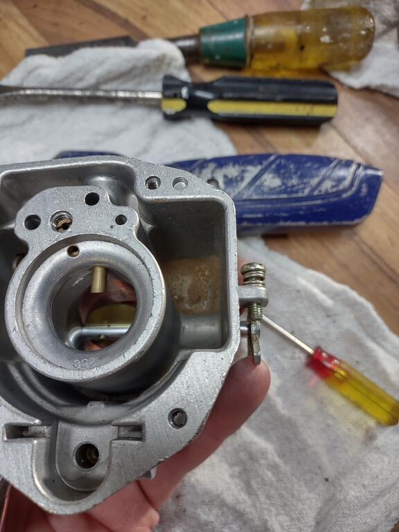

ebinmaine 79,634 #15544 Posted May 1, 2022 (edited) Me n' @JCM had a little shop time today. Disassembled a starter of his off a Kohler Magnum 20. Found it's pretty well chewed up in there. I'll be calling around to see what I can do for Jim. We also cleaned up 2 carbs. One off the same Kohler Magnum 20. Another from a 20 HP Onan engine. Trina and her mom moved 5 loads of wood into the basement storage room. Edited May 1, 2022 by ebinmaine Phixed photo placement phauxpah 11 Share this post Link to post Share on other sites
Ifixoldjunk 778 #15545 Posted May 1, 2022 @Horse Newbie Yes sir! Got a great deal on the all in one POR-15 kit. the kit did a pretty nice job prepping it. 2 Share this post Link to post Share on other sites

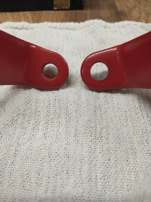

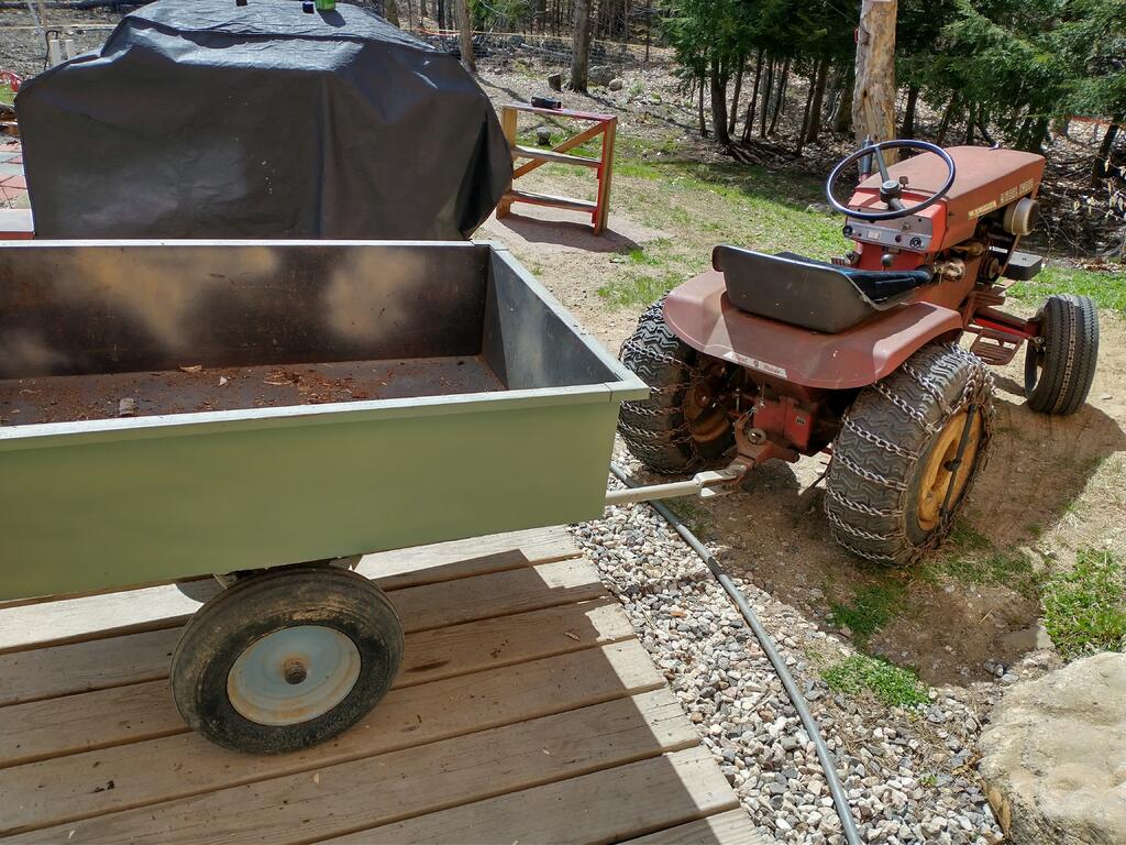

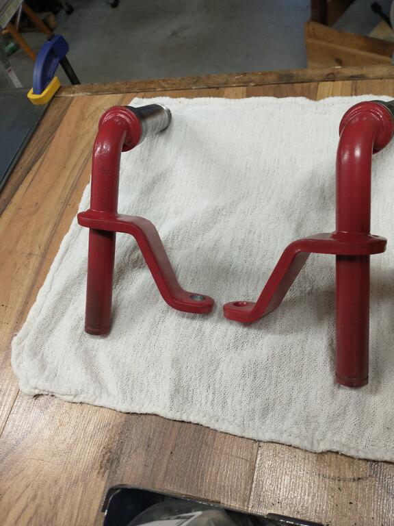

ebinmaine 79,634 #15547 Posted May 1, 2022 1 hour ago, JCM said: Excellent day today at Eric and Trina's. Looking forward to getting the Twin cylinder machines in tip top shape for the Meet & Greet this September. I want to see the look on Eric's face when he takes that 520-H for a trail ride. Thanks again buddy. Glad to have you up Mr Jim. 😀 After @JCM headed for the low ground the BBT went out and spent some time in the new garden area cleaning out rocks and sticks. I did a little more prep on changing the Cinnamon Horse C160-8 over to 5 lug trailer hubs on the front axle. Yesterday Trina and I attached the drilled axle stubs (thank you to the person who did that !) to the N. O. S. Steering knuckles I got from @Sparky last year at @JCM Jim's Meet n Greet. Today I drilled the tie rod holes out to accept the oversized 7/16 hiem joints. 6 3 Share this post Link to post Share on other sites
Dan.gerous 2,696 #15548 Posted May 1, 2022 2 minutes ago, ebinmaine said: Glad to have you up Mr Jim. 😀 After @JCM headed for I did a little more prep on changing the Cinnamon Horse C160-8 over to 5 lug trailer hubs on the front axle. Yesterday Trina and I attached the drilled axle stubs (thank you to the person who did that !) to the N. O. S. Steering knuckles I got from @Sparky last year at @JCM Jim's Meet n Greet. Are they sleeves that go over the original axles? Guess you weld them on? 2 Share this post Link to post Share on other sites
Sparky-(Admin) 25,934 #15549 Posted May 1, 2022 6 minutes ago, ebinmaine said: I did a little more prep on changing the Cinnamon Horse C160-8 over to 5 lug trailer hubs on the front axle. Yesterday Trina and I attached the drilled axle stubs (thank you to the person who did that !) to the N. O. S. Steering knuckles I got from @Sparky last year at @JCM Jim's Meet n Greet. Today I drilled the tie rod holes out to accept the oversized 7/16 hiem joints. Really glad to see someone using them! 2 1 Share this post Link to post Share on other sites
JPWH 6,544 #15550 Posted May 1, 2022 (edited) thank you to the person who did that ! Your welcome. I hope they fit as you planned. Edited May 1, 2022 by JPWH 1 1 Share this post Link to post Share on other sites
