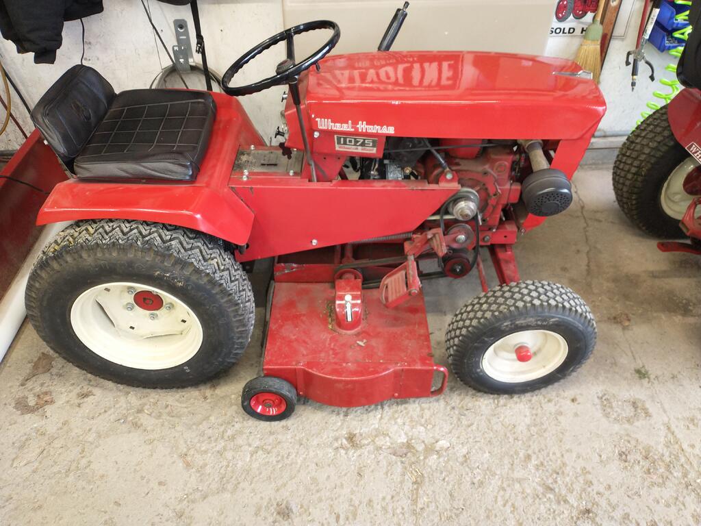

squonk 48,181 #15270 Posted April 13, 2022 Fitted the deck onto the 1075 for some old-school mowing yesterday. First time I can remember having to mow before Easter. 3 Share this post Link to post Share on other sites
