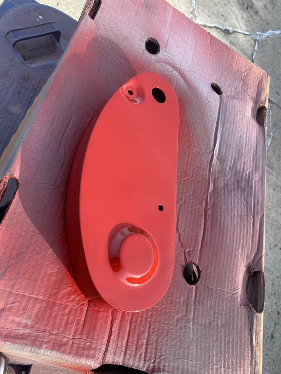

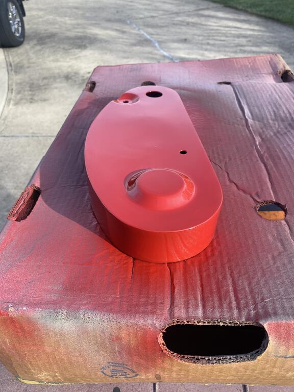

Lane Ranger 12,091 #13858 Posted December 2, 2021 (edited) Painting an RJ repop drive belt from Joe Papke today. I used Rustoleum Etching Primer and regal red gloss! 61 degrees in Greencastle, Indiana this December 2, 2021- perfect for painting! Edited December 2, 2021 by Lane Ranger 8 2 Share this post Link to post Share on other sites

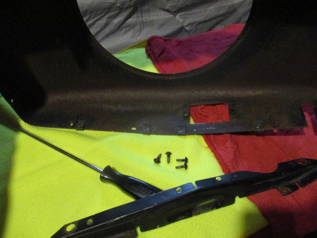

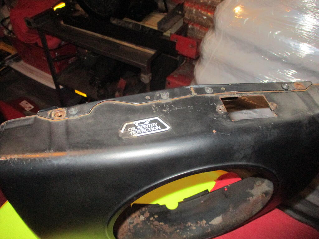

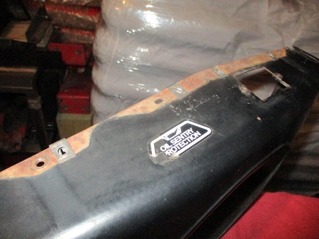

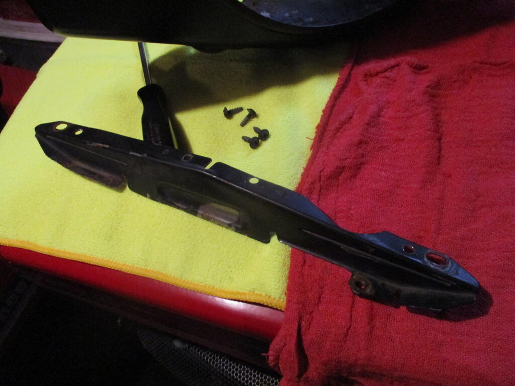

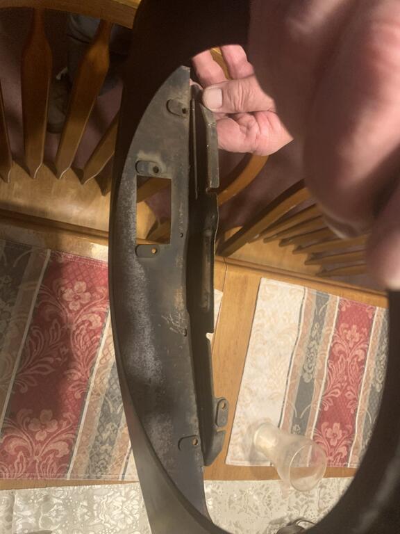

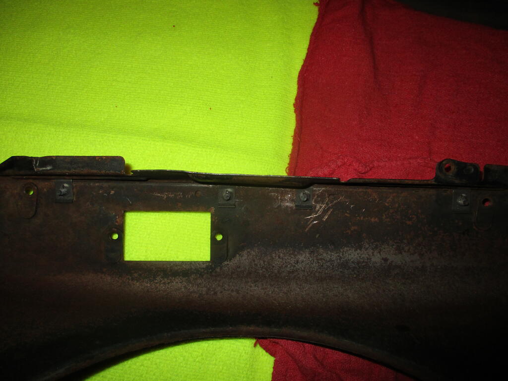

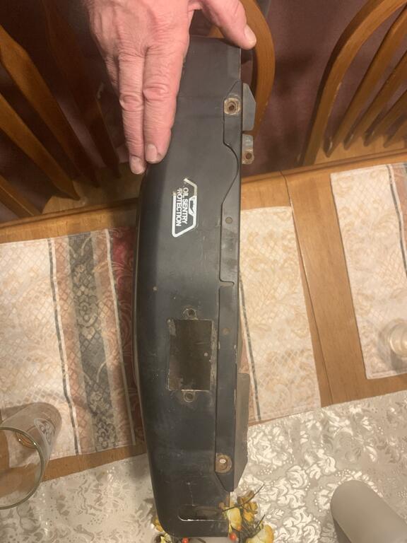

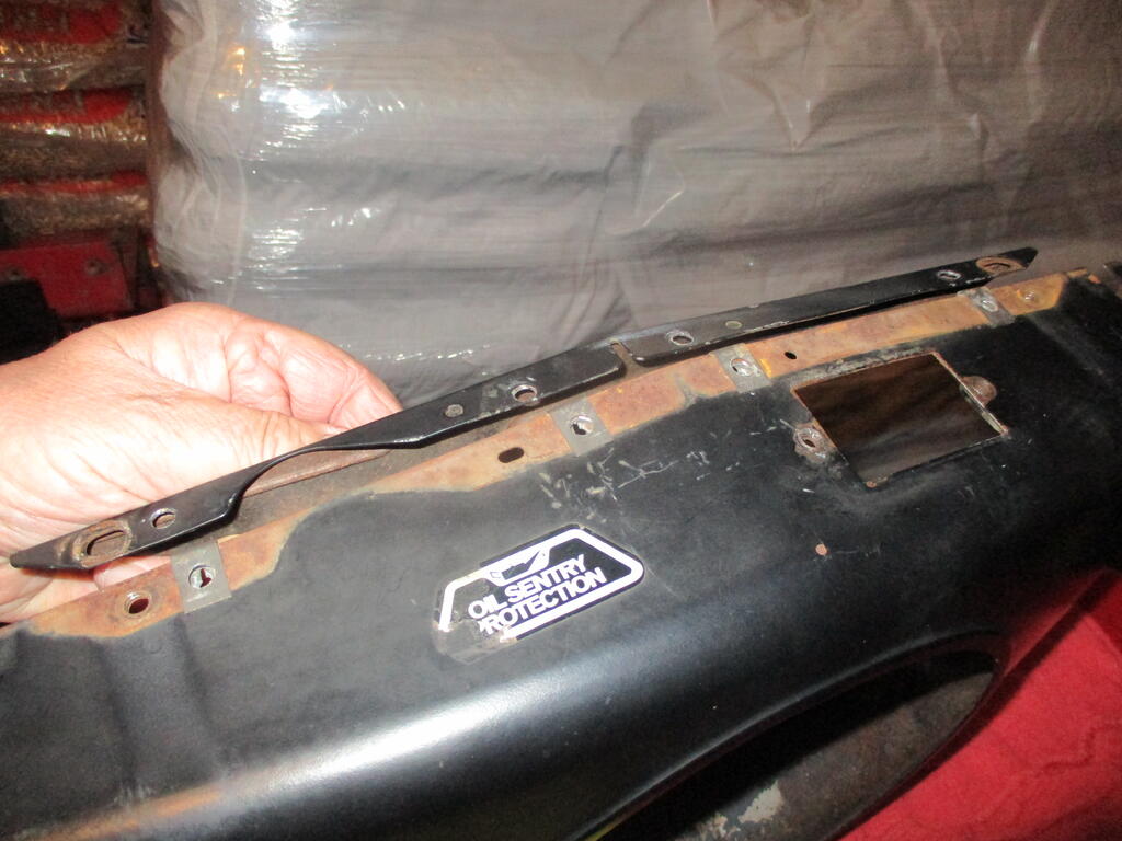

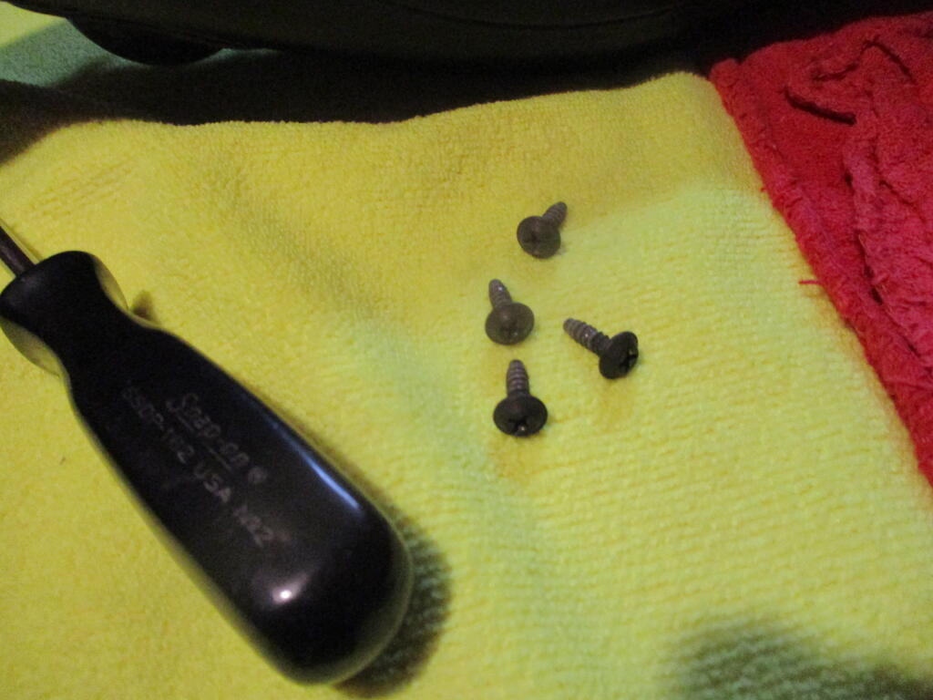

johnnymag3 2,647 #13861 Posted December 2, 2021 So for those wondering about the one piece shroud problem on my 418 A.....and how I was going to deal with it...here it is....I drilled out the silly spot welds...put some nice tinnerman clips on the holes...installed some black screws with self contained washers...and now you dont have to deal with not getting the shroud off !!!! I had to pull the flywheel and the big tin at the same time.What a PITA... So he is the end result....Also I got new magnets from a local dealer who saved everything for 50 years...he had a pile of flywheels from every era. So I scuffed and cleaned the flywheel, also the magnets....checked polarity....they are Tri-polar magnets as you probably already know...NSN AND SNS.....so it goes NSNSNSNSNSNSNSNSNSN and secured them with ORIGINAL JB WELD...they are baking near the pellet stove as I write ....It is now a seviceable 2 piece shroud, not capturing the flywheel anymore !!! 5 1 Share this post Link to post Share on other sites
johnnymag3 2,647 #13862 Posted December 2, 2021 (edited) You can see the witness marks on the shroud where the chaff screen mounts also... Thanks for all of your input also !!!! John Edited December 2, 2021 by johnnymag3 Share this post Link to post Share on other sites
johnnymag3 2,647 #13863 Posted December 2, 2021 On 11/28/2021 at 5:55 PM, johnnymag3 said: 2 bolts only....and its one piece....Dang This debacle is what Im referring to 1 Share this post Link to post Share on other sites

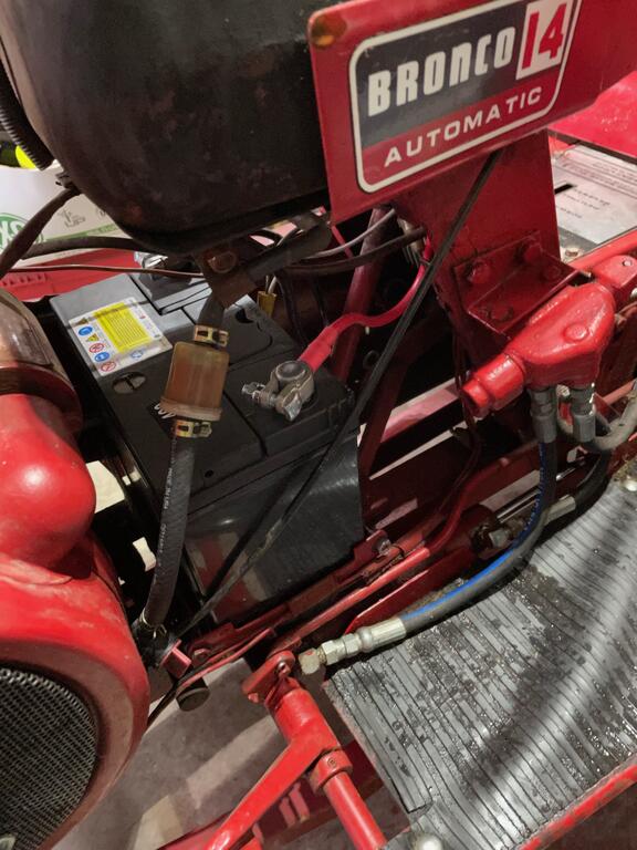

Sodaking27 1,318 #13864 Posted December 2, 2021 New battery and cables installed on the Bronco 14 today. Can someone post me a picture of the throttle cable of how it’s routed in the front by the carburetor. Getting things straightened out one by one. 2 1 Share this post Link to post Share on other sites
kpinnc 18,875 #13865 Posted December 2, 2021 1 hour ago, johnnymag3 said: .I drilled out the silly spot welds...put some nice tinnerman clips on the holes...installed some black screws with self contained washers...and now you dont have to deal with not getting the shroud off !!! Outstanding modification- and one you should have never had to make. So much engineering in a complex and precise high performance piece of equipment. Such a thing should be included from the factory. 1 Share this post Link to post Share on other sites

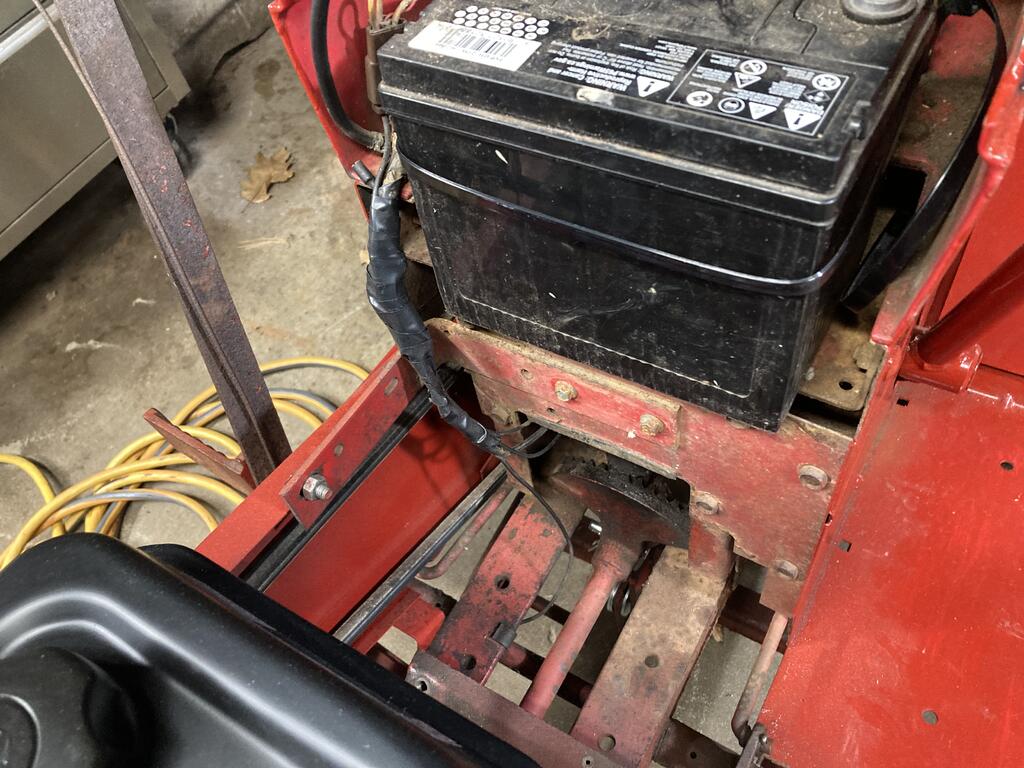

SylvanLakeWH 32,107 #13873 Posted December 4, 2021 Put a battery in the C-6.5 Predator swap so I can have lights for plowing snow at night… I’ll just charge it after plowing… Of course, added the color matching black zip tie battery stay… 4 1 Share this post Link to post Share on other sites
