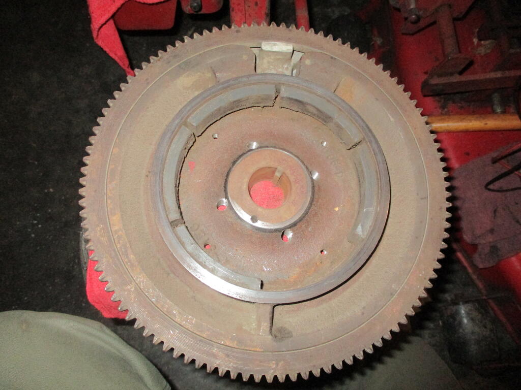

Gregor 4,848 #13776 Posted November 28, 2021 (edited) 37 minutes ago, johnnymag3 said: How do you guys reglue all of the magnets? and one of them is missing a small chunk....bout 1/2 inch I used JB Weld on mine. All of mine were also loose. Can't answer your ? about the broken magnet, but make sure you put them back in the correct orientation. North to South, North to South, North to South, etc. I really don't think the missing 1/2" piece would bother a lot, but I don't really know. Stator magnets Skip to 4:50 in video Not too sure about the impact on the flywheel nut though. Edited November 29, 2021 by Gregor 2 Share this post Link to post Share on other sites
johnnymag3 2,646 #13777 Posted November 29, 2021 (edited) I guess I can compensate for the missing chunk in the spacing between the magnets to keep balance somewhat equal...or glue the piece in with the appropiate magnet? thanks for the video....great teacher !!! Edited November 29, 2021 by johnnymag3 1 Share this post Link to post Share on other sites

Gregor 4,848 #13781 Posted November 29, 2021 (edited) It's just possible mating the 2 pieces back together again,and gluing them in place, might restore polarity to the whole magnet. DON'T glue the 2 pieces to each other. Edited November 29, 2021 by Gregor 1 Share this post Link to post Share on other sites
johnnymag3 2,646 #13782 Posted November 29, 2021 I do have the piece that came off...and it does fit very nicely ?? Share this post Link to post Share on other sites
johnnymag3 2,646 #13783 Posted November 29, 2021 Im leaning towards getting new magnets....may be a better option... Share this post Link to post Share on other sites
Gregor 4,848 #13784 Posted November 29, 2021 2 minutes ago, johnnymag3 said: I do have the piece that came off...and it does fit very nicely ?? Hold the 2 pieces together the best you can, without gluing. Using another magnet, see if the good magnet reacts the same way to both ends of the broken magnet. Attracts? Repels? I would try more than 1 good magnet. 1 Share this post Link to post Share on other sites
Gregor 4,848 #13785 Posted November 29, 2021 (edited) 5 minutes ago, johnnymag3 said: Im leaning towards getting new magnets....may be a better option... Yeah, good luck with that. You buy the flywheel, not just the magnets. Unless someone has some old ones that they KNOW are the correct ones. Edited November 29, 2021 by Gregor 1 Share this post Link to post Share on other sites
johnnymag3 2,646 #13786 Posted November 29, 2021 (edited) I found a set on ebay.......3 reds and 3 greens 50.00 unsure of OEM quality though... Edited November 29, 2021 by johnnymag3 1 Share this post Link to post Share on other sites

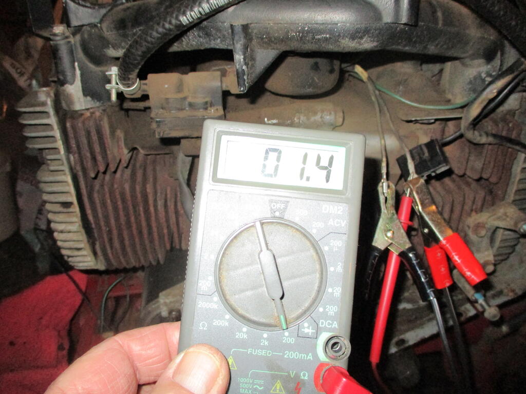

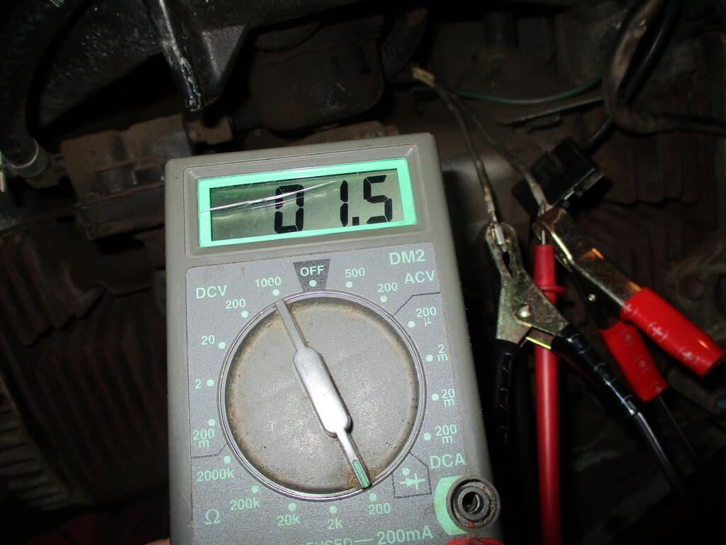

johnnymag3 2,646 #13789 Posted November 29, 2021 Checked the stator...not sure where to set the meter...seems to be good?? Maybe have the ohms of resistance wrong? Share this post Link to post Share on other sites
Gregor 4,848 #13790 Posted November 29, 2021 17 minutes ago, johnnymag3 said: Checked the stator...not sure where to set the meter...seems to be good?? Maybe have the ohms of resistance wrong? post a pic of your meter with it hooked up if you can Share this post Link to post Share on other sites
johnnymag3 2,646 #13791 Posted November 29, 2021 what range??? 20 ohms? Share this post Link to post Share on other sites
Gregor 4,848 #13792 Posted November 29, 2021 yes. Also touch your meter leads together (without stator), and record that reading. Share this post Link to post Share on other sites
Gregor 4,848 #13794 Posted November 30, 2021 My meter set on 200 ohms. Leads together .20 checking stator .30 .30-.20=.10 Within spec Spec is .064 - . 2 You are set on 2 mega ohms? Not sure how you are even getting a reading. But electronics is not my strong suit. AT ALL ! Set your meter on 200 Share this post Link to post Share on other sites
Gregor 4,848 #13796 Posted November 30, 2021 (edited) A difference of .10 That is within spec of .064 - .2 Edited November 30, 2021 by Gregor 1 Share this post Link to post Share on other sites
johnnymag3 2,646 #13797 Posted November 30, 2021 I am missing an entire magnet !!!! Local Dealer has a few he can give me to fill in the gap. I will be sure to use the opoposite polarity 2 Share this post Link to post Share on other sites
Gregor 4,848 #13798 Posted November 30, 2021 Just now, johnnymag3 said: I am missing an entire magnet !!!! Local Dealer has a few he can give me to fill in the gap. I will be sure to use the opoposite polarity One has to wonder where it went? Share this post Link to post Share on other sites
johnnymag3 2,646 #13799 Posted November 30, 2021 I dont know how this Stator survived.... Share this post Link to post Share on other sites
