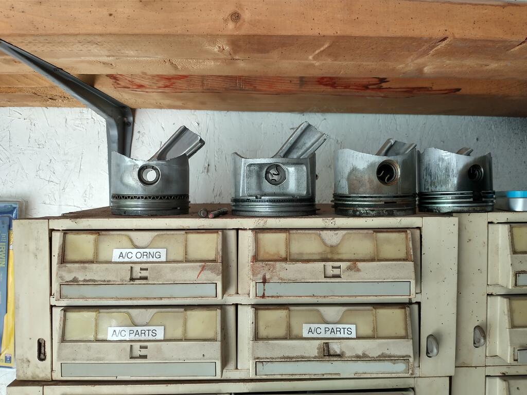

pfrederi 21,150 #12702 Posted September 7, 2021 1 hour ago, squonk said: As they used to say in NASCAR. "She done blowed up Cale!" Tore @D_Mac 's blown 875 engine apart to save anything salvageable. Block not only had a chunk out of the cylinder but it is cracked about 3/4 of the way around! Piston is going in my "Haul of Fame! I know everybody is down on balance gears but doesn't look like they were involved in these failures.. Would be interesting to know how many failures there were in balance gears as opposed to rods etc... 1 Share this post Link to post Share on other sites
squonk 48,119 #12703 Posted September 7, 2021 5 minutes ago, pfrederi said: I know everybody is down on balance gears but doesn't look like they were involved in these failures.. Would be interesting to know how many failures there were in balance gears as opposed to rods etc... 2 pistons including the one from the 875 engine looked like the oil wasn't changed or checked when it was supposed to. The 875 piston had quite a bit of scoring. The one next to it had a little. The oddball 16 piston as allegedly on a new rod and I think it was either installed wrong or shoddy workmanship. 1 Share this post Link to post Share on other sites

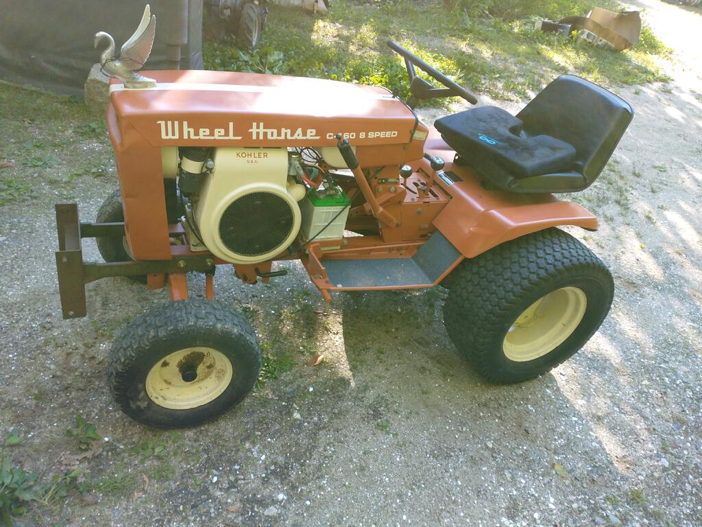

ebinmaine 80,695 #12704 Posted September 7, 2021 I been driving a couple trucks around Southern Maine today while my Tire Changing Department spent some time between 7 million other tasks getting the Cinnamon Horse C160 ready to go to @JCM Jim's this weekend. Had to take the fluid weighted wheels and tires off and swap them for regular air-filled ones. Saves over 250 lb going down the road. She took this to share with you folks. 8 3 Share this post Link to post Share on other sites

D_Mac 9,339 #12707 Posted September 7, 2021 Just to make it clear.... thats the way I got that engine...... I did not blow it up !!! Hope you got some good parts off it @squonk !! 3 Share this post Link to post Share on other sites

Snoopy11 5,731 #12709 Posted September 7, 2021 2 hours ago, squonk said: shoddy workmanship. New rod... broke...? Long time since I heard anything like that @squonk I'd be like... Don 1 Share this post Link to post Share on other sites

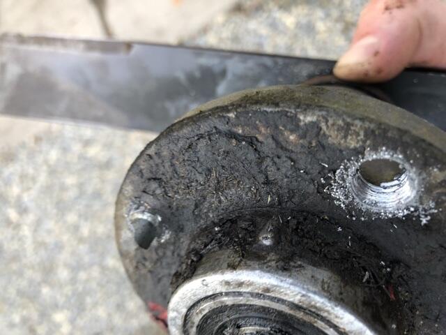

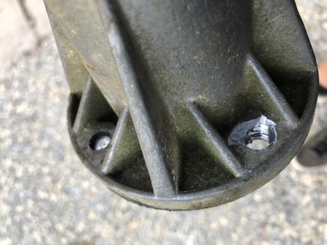

WheelPuke 78 #12721 Posted September 8, 2021 (edited) After a day of classes and homework, I finished cleaning the underside of my 48” deck with some kerosine, preparing it to oil. I sharpened my blades, ensuring they were still balanced. I checked on the loose spindle bolts and found they did not have any threading to engage on the spindle. I retreaded one hole without issue and my die broke inside the second spindle hole I was re-threading. I have to take this to someone to work on. I can’t fix this F-up. I broke a freakin Snap-On. 🤮 plus the first hole blew out some metal. Spindle ruined I think. The deck, wheel weights, plow bracket, mule drive, and tractor have all been washed so the paint can soak up some penetrating oil. I’ll do the oil treatment tomorrow after class and homework. I’d have done the plow but I didn’t have a way to move it my self or any help on hand, so it will have to wait. I found the tractor has a head light out, blade broke at a sodder joint while washing the inside of the hood. Also my right side steering arm falls off the ball that comes off the steering linkage at the union. It was zip-tied and now I know why. I photographed it before I cut them off just in case this was an issue. I’ll tie it up until I can find the parts to repair this. Edited September 8, 2021 by WheelPuke 2 Share this post Link to post Share on other sites

8ntruck 9,296 #12723 Posted September 8, 2021 @WheelPuke I would be tempted to drill those tapped holes in the spindle and go to a through bolt, nut and washer as a fix. Use a button head cap screw with the head on the spindle side with the nut and lock washer on top. Flat washers under the head of the bolt and lock washer would be a good idea too. Good lucl. 1 1 Share this post Link to post Share on other sites

lynnmor 9,040 #12725 Posted September 8, 2021 Yes, a thru bolt is the way to fix it. You were using a tap, not a die and it appears that the size was too large. I have never seen steel that will absorb oil, otherwise they couldn't keep it in the cans. You can apply oil of your choice to the deck underside but it will disappear during the first mowing. 4 1 Share this post Link to post Share on other sites
