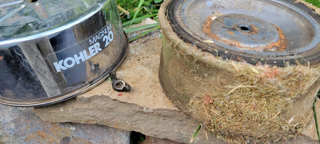

Thor27 892 #12601 Posted August 26, 2021 (edited) On 8/23/2021 at 7:24 PM, 8ntruck said: Poked around on the new Black Hood arrival a bit today. Replaced the air filter, added a little Marvel Mystery Oil to the gas. It runs and drives, but is not ready to go to work. The to do list on it is getting longer. Since it smokes a little on start up, I was thinking maybe the rings might be struck - especially since it has not run for almost two decades. I pulled the plugs and put a little MMO in each cylinder, then rolled the engine over a few times. I'll let that set over night. I went to add some MMO to the oil, but found the oil level to be over filled per the dip stick. I drained about a cup and a half out to bring it to the full mark. Put about an ounce of MMO in the crankcase. This makes me wonder if the fuel pump is adding gas to the oil... The plan tomorrow is to chase around the electrical system to get it closer to working as it should. Will probably check the fuel pump, too. Got the laptop back today. I'll load pictures and start a new thread on this beast. Anybody out there build a new wire harness for their Horse? I'be found a source for wire, and maybe connectors - assuming Wheel Horse used Packard connectors. Oh, for our records, here is the model and serial number for the new to me horse: Model 01-19KE01 - 24003, serial 2091. I love the super Cs, please post some pics as you work on it. Sorry, that was the next thread I saw. Great tractor, I am jealous.. Edited August 26, 2021 by Thor27 Share this post Link to post Share on other sites

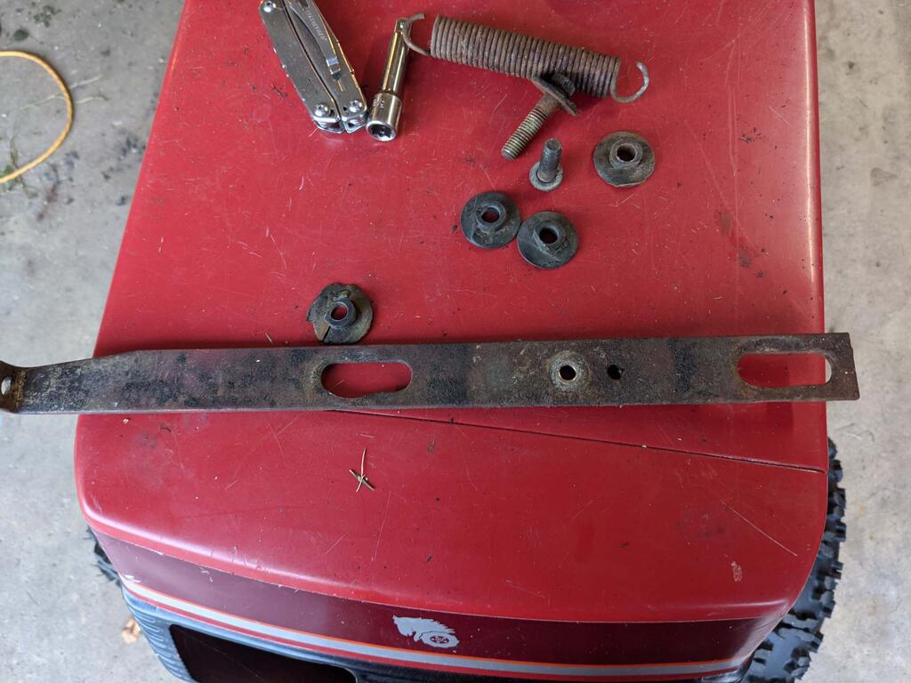

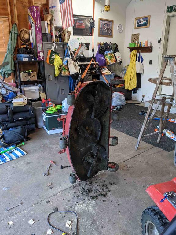

balconio 606 #12602 Posted August 27, 2021 Deck triage day. Turns out the spindle bearings are fine, a little noisy but they spin freely and have no play so I'm leaving them alone. IDK if it's possible to over grease these spindles, but when I see a grease zerk and a weep hole I fill till it comes out. The deck tensioner bar was pretty loose and beat up. The slots were a bit egged out and the bolts were worn but the idler was ok. Luckily I had a spare bar, bolts, and those plastic washers and it all went in without issue and is much tighter. So glad my tractors came with multiple boxes of spare parts! I can't wait to mow with it again and see if this smooths it out. 3 4 Share this post Link to post Share on other sites
Horse Newbie 7,405 #12603 Posted August 27, 2021 46 minutes ago, balconio said: those plastic washers I am in the process of restoring my 48 inch SD deck...wonder how it would work if a guy was to make those plastic washers out of hard nylon like material (on a lathe) Share this post Link to post Share on other sites
tom2p 2,396 #12604 Posted August 27, 2021 42 minutes ago, Horse Newbie said: I am in the process of restoring my 48 inch SD deck...wonder how it would work if a guy was to make those plastic washers out of hard nylon like material (on a lathe) I might be mistaken - but I believe the washers are made of a fairly tough plastic ... could be nylon or some nylon in the material (?) 2 Share this post Link to post Share on other sites
balconio 606 #12605 Posted August 27, 2021 I never looked at their site before but Toro seems to have pretty incredible parts support for these old decks. At $1.13 apiece plus shipping I might need to buy a couple new bushings... https://www.torodealer.com/en-US/Pages/parts.aspx?Model=78345&Serial=4900001&MybeId=5514&PageId=312662&IllustrationId=303214&CallOut=11&_ga=2.268016398.1017641825.1630023965-1215839170.1630023965#11 2 1 Share this post Link to post Share on other sites

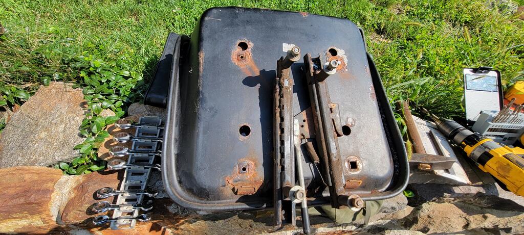

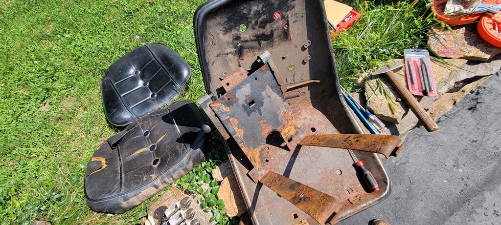

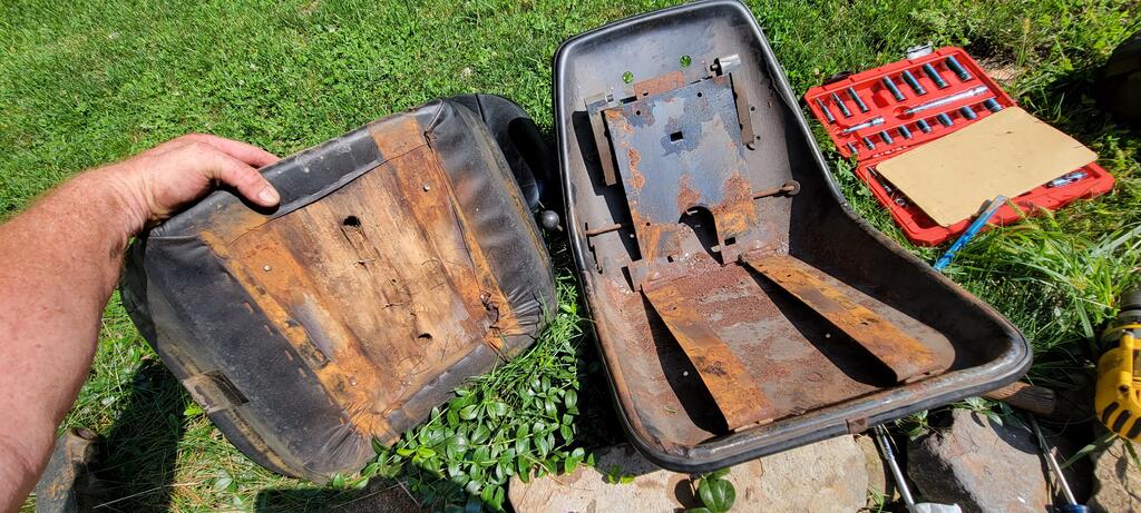

AMC RULES 37,260 #12609 Posted August 27, 2021 This morning I blew apart the most complicated W-H seat known to mankind. Better bring your A-game because these things come ready to fight. 5 6 Share this post Link to post Share on other sites
ebinmaine 80,990 #12610 Posted August 27, 2021 42 minutes ago, AMC RULES said: W-H seat What's the plan for this one Craig? Rebuild? Share this post Link to post Share on other sites
WHX?? 58,307 #12611 Posted August 27, 2021 Best get yer main man a baseball bat @TonyToro. Gonna need it to keep them girls off him they see that folder! Ah the days of back to school shopping for my boy! 2 minutes ago, ebinmaine said: What's the plan for this one Craig? Rebuild? Entry in the ungly seat contest is my guess.... 2 1 Share this post Link to post Share on other sites
Lane Ranger 12,151 #12612 Posted August 27, 2021 50 minutes ago, AMC RULES said: This morning I blew apart the most complicated W-H seat known to mankind. Better bring your A-game because these things come ready to fight. I knew you could do it! You are on the road to a great rebuild experience! 1 Share this post Link to post Share on other sites

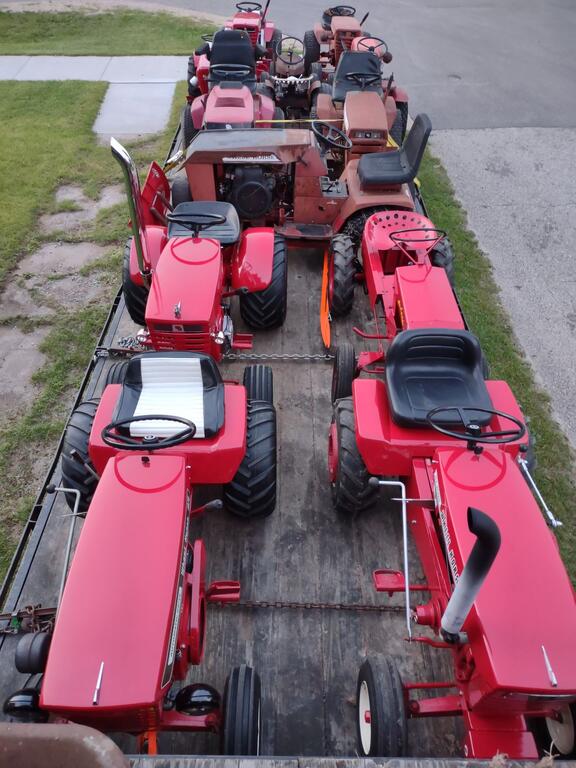

Achto 32,845 #12613 Posted August 27, 2021 (edited) Loaded the whole family up (those that run and drive any way) for a weekend vacation at the first Pickett garden tractor show. Edited August 27, 2021 by Achto 1 16 4 Share this post Link to post Share on other sites
8ntruck 9,355 #12614 Posted August 27, 2021 1 hour ago, AMC RULES said: This morning I blew apart the most complicated W-H seat known to mankind. Better bring your A-game because these things come ready to fight. What tractor was that on? The seat on the C 195 I got last weekend is really crusty. I am mentally working through the repair or replace decision. 2 Share this post Link to post Share on other sites

peter lena 10,091 #12616 Posted August 27, 2021 @balconio, two things on your slider issues , you can probably get a harder more durable , nylon / Teflon slide make up in the hardware store pull out drawer section , also use a SUPER LUBE AEROSOL LUBRICANT on those sliders , makes them slide without effort . pete 1 1 Share this post Link to post Share on other sites
Maxwell-8 4,371 #12617 Posted August 27, 2021 1 hour ago, Achto said: Loaded the whole family up (those that run and drive any way) for a weekend vacation at the first Pickett garden tractor show. Seing that passing by on the highway... looks mighty No work an the horses today.. Got to watch a movie our local tv is broadcasting tonight: "The Strait Story" (it's the wrong brand ik know). 2 1 Share this post Link to post Share on other sites

Lee1977 7,805 #12619 Posted August 27, 2021 18 hours ago, Horse Newbie said: I am in the process of restoring my 48 inch SD deck...wonder how it would work if a guy was to make those plastic washers out of hard nylon like material (on a lathe) Nylon will work great we made the old double d slides out of nylon had to mill a slot out with them. 2 Share this post Link to post Share on other sites
Thor27 892 #12620 Posted August 27, 2021 5 hours ago, AMC RULES said: This morning I blew apart the most complicated W-H seat Craig, Thanks sharing for the pics, having never seen a lse in person it is very cool to see the details of what sets them apart! 2 Share this post Link to post Share on other sites

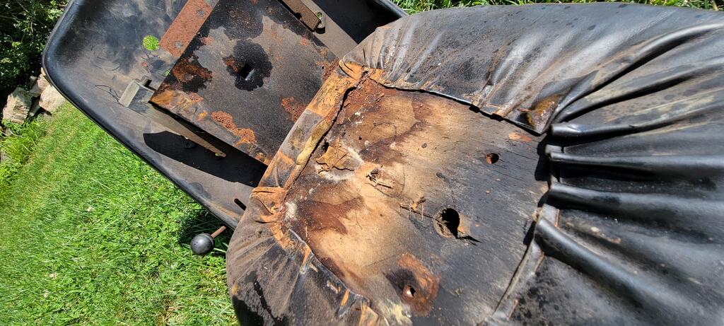

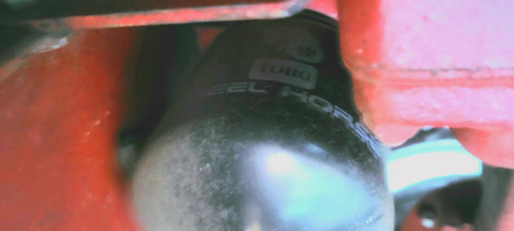

AMC RULES 37,260 #12621 Posted August 27, 2021 (edited) I discovered more proof here today... this poor thing really needs me. 🙈 A fluids change and the removal of the engine tins is scheduled for tomorrow. Edited August 27, 2021 by AMC RULES 5 3 Share this post Link to post Share on other sites
Pullstart 71,401 #12622 Posted August 27, 2021 6 hours ago, Achto said: Loaded the whole family up (those that run and drive any way) for a weekend vacation at the first Pickett garden tractor show. right there is a thing of beauty! Have fun Dan! 3 1 1 Share this post Link to post Share on other sites

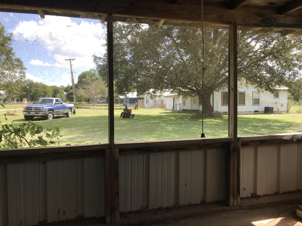

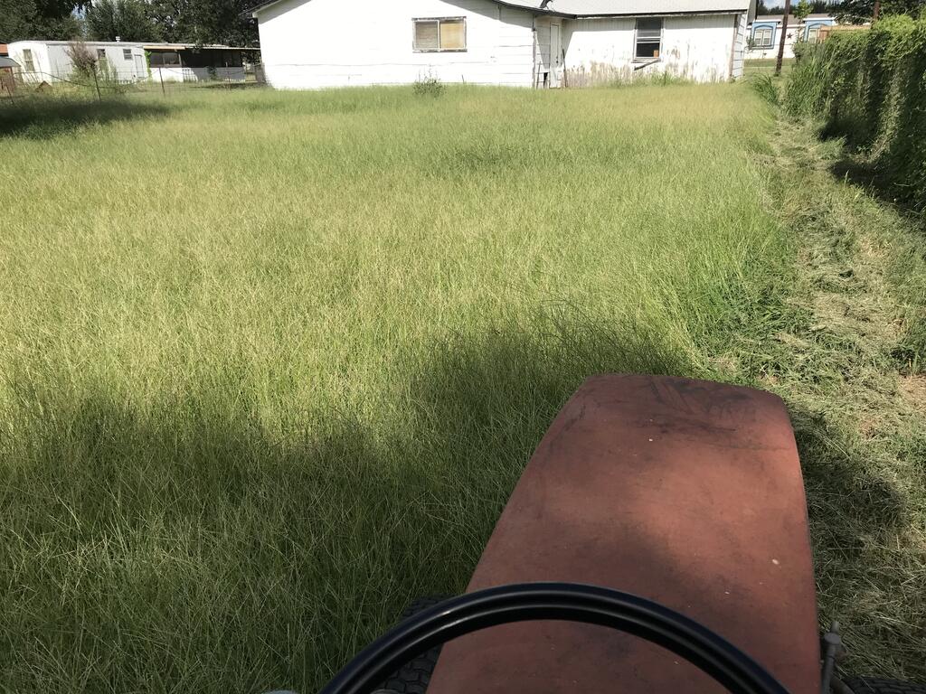

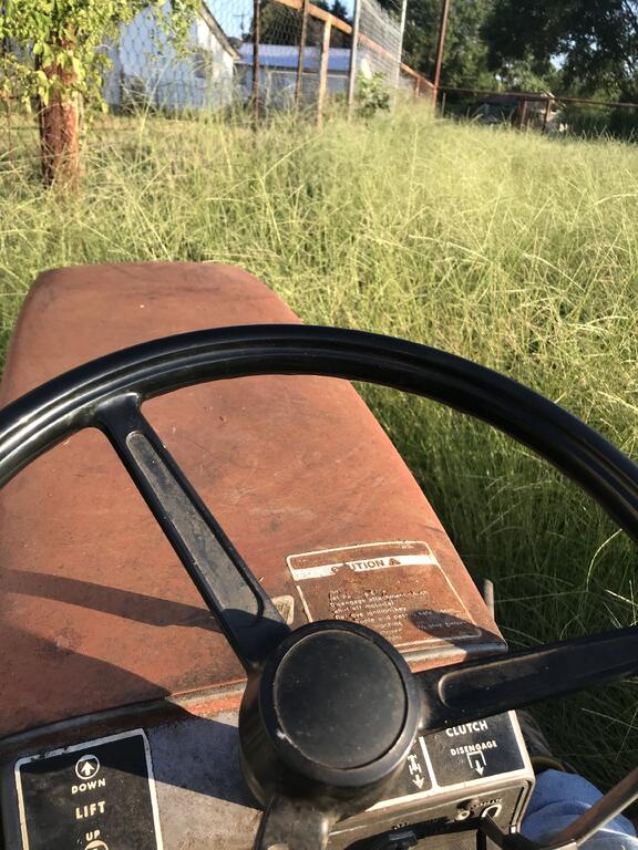

ZXT 2,402 #12624 Posted August 28, 2021 Did some "light" mowing at the new place with the C-160. Front half of the property wasn't too bad at roughly 14" tall, but most of the back half was at least even with the top of the hood. Didn't come out looking great, nor did I expect it to. It'll take a couple more trimmings before it starts to look right again. I'm thinking that a RD deck would've been great for this. My initial pass is always going the wrong way so that I can get close to fences. That's typically fine, but when the grass is 3' tall, you wind up essentially having to mow that row again in addition to the row beside it once you turn around. A RD deck doesn't care which direction you go; it just throws it behind you. 4 6 1 1 Share this post Link to post Share on other sites
peter lena 10,091 #12625 Posted August 28, 2021 @ZXT , just curious ,did you use low range / hi gear for that cutting ? getting the most efficient pto drive speed and deck speed for that field ? have r/d decks on my 3 horses , , always get good cut , if your deck is clean and your blades are sharp it always looks good . pete 1 1 Share this post Link to post Share on other sites
