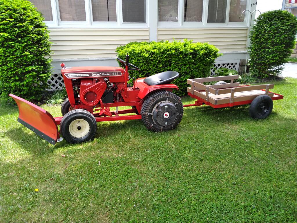

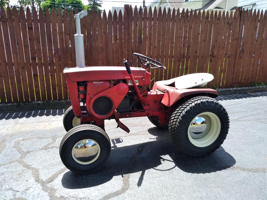

D_Mac 9,337 #11627 Posted May 27, 2021 Well I did a little painting again. Took my nice BLACK trailer and made it a nicer Regal Red trailer. I really like how the custom wood grain decals made by @Vinylguy, for the 857, go with the nice wood look of the trailer. Also after @squonk installed the stack on the 1075, I painted the muffler with some High Heat paint and put the Baby Moons back on. Add the Hot Rod Trailer on the back of that one and you got one " Big Block, Short Frame, Tall Stack, Baby Moon ", coooool looking tractor. 3 5 4 Share this post Link to post Share on other sites

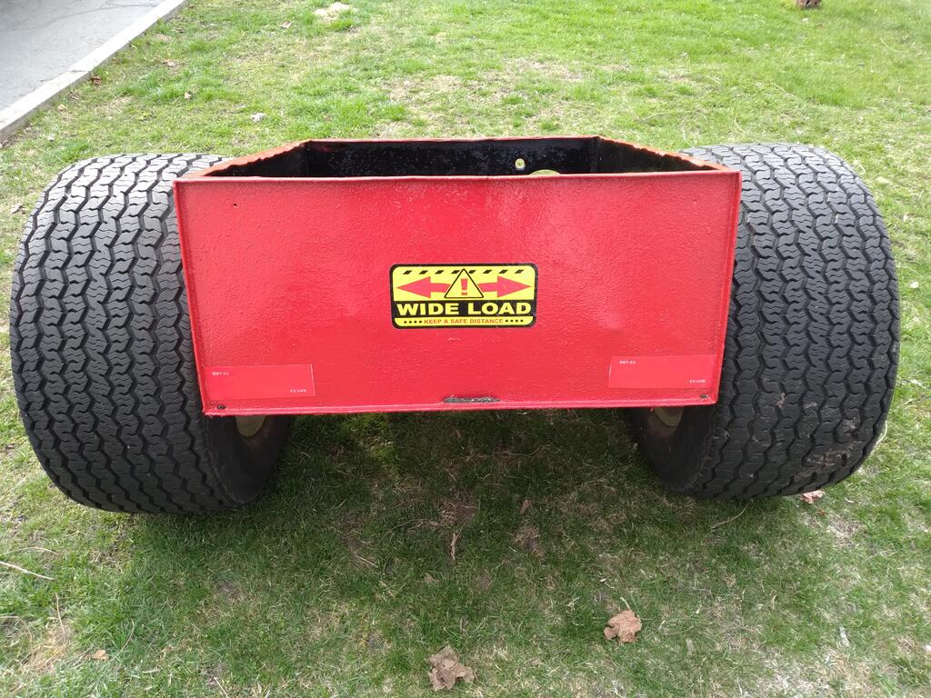

squonk 46,887 #11628 Posted May 27, 2021 That trailer will barely make it out of your driveway with those utility trucks there! Share this post Link to post Share on other sites
D_Mac 9,337 #11629 Posted May 27, 2021 It is almost as wide as the driveway !!! 6 Share this post Link to post Share on other sites

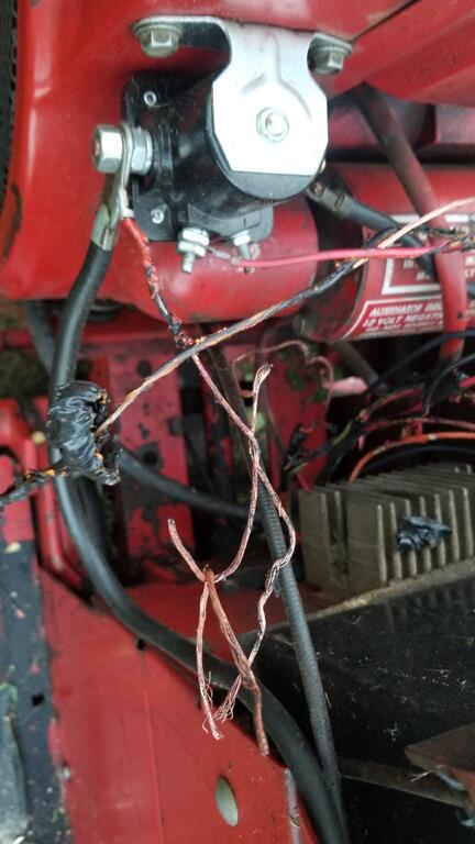

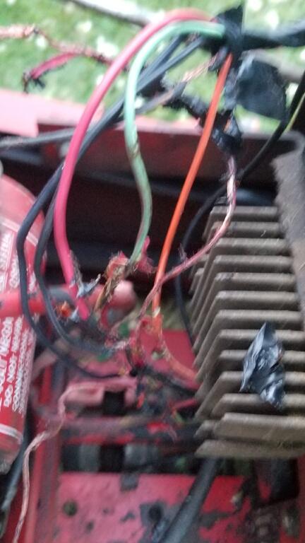

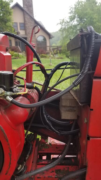

Wheel Horse 3D 3,825 #11630 Posted May 28, 2021 Well, hate to say it...i let the smoke out. And anyone who deals w/ voltage and amps can tell ya, keepin the smoke in is a MUST for correct operation of electrical systems! Looks like the original harness had the coil wire wrapped tight around a ground, and over time.....sooooo, got me some wiring to do! 1 8 Share this post Link to post Share on other sites
kpinnc 18,469 #11631 Posted May 28, 2021 Yep, keeping the magic blue smoke in DC electrical stuff is an operational requirement. But you can always put it back in with a few new parts! 3 Share this post Link to post Share on other sites
Wheel Horse 3D 3,825 #11632 Posted May 28, 2021 Yep! Fortunately i managed to sort out everything and can see where everything goes, i yanked the coil wire loose from the eyelet, but it, the start relay wire, main hot coming back from the start relay supply side, and a couple others got good and glowing before I got er shut down, and the battery cable off. 3 1 Share this post Link to post Share on other sites
Roger R 473 #11633 Posted May 28, 2021 Had a similar issue recently on my charger 12. Now everything but the starter is fused. Better to change a fuse than the wiring. 3 Share this post Link to post Share on other sites

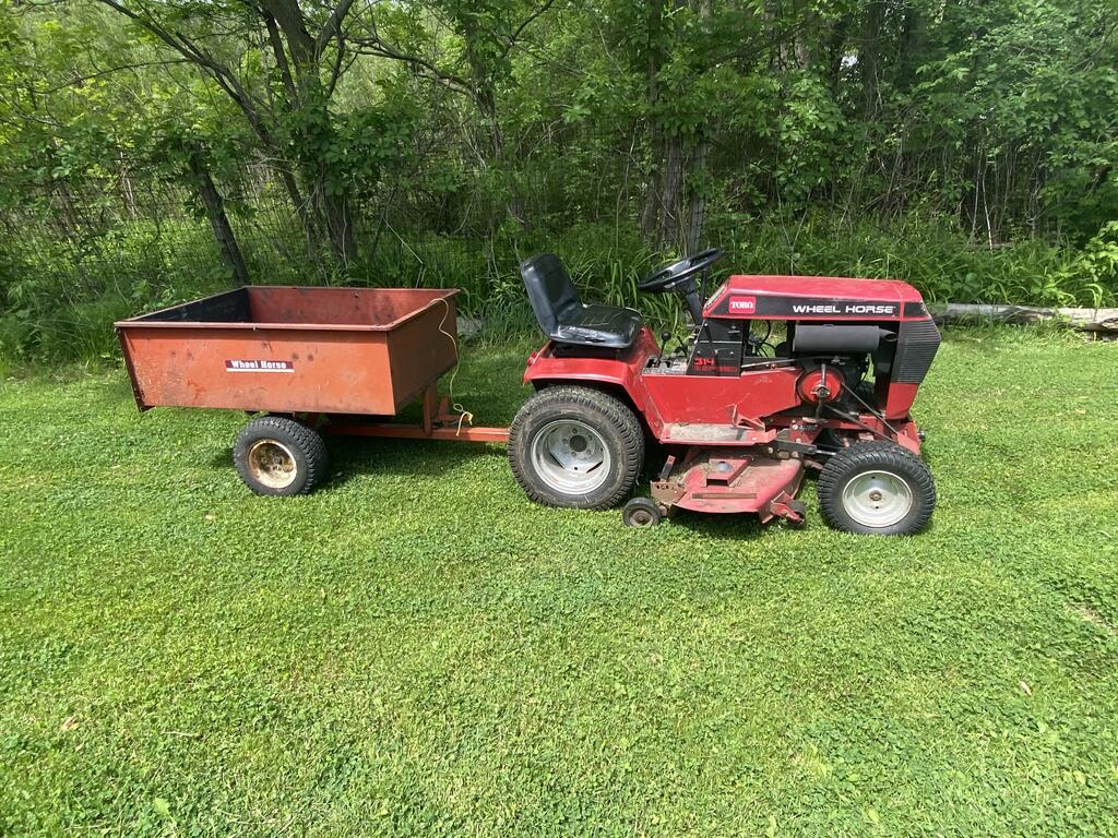

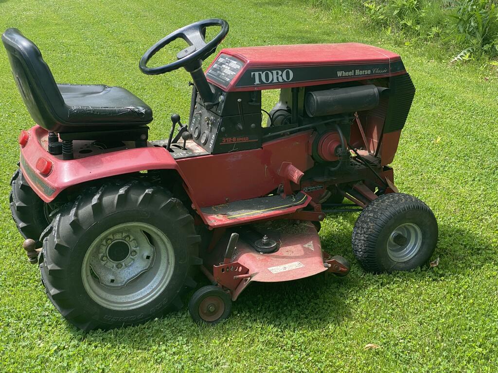

Lane Ranger 11,980 #11634 Posted May 28, 2021 (edited) Did some mowing, dirt hauling and other maintenance jobs at my mother’s place this week. Used a couple tractors for the various jobs. A 312-8 and a 314-8 ! Edited May 28, 2021 by Lane Ranger 8 8 Share this post Link to post Share on other sites
Wheel Horse 3D 3,825 #11635 Posted May 28, 2021 14 minutes ago, Roger R said: Had a similar issue recently on my charger 12. Now everything but the starter is fused. Better to change a fuse than the wiring. Yup, if thered been even a main fuse, woulda had much less to fix. 2 Share this post Link to post Share on other sites

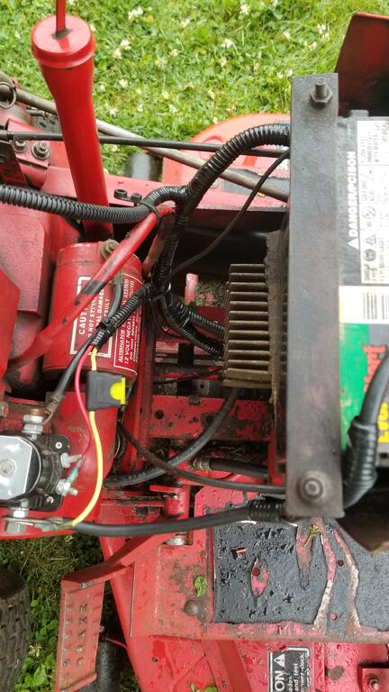

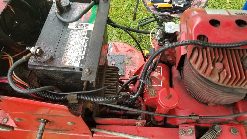

Wheel Horse 3D 3,825 #11644 Posted May 29, 2021 Well I managed to get the smoke back in! I had to rig an impromptu hadron collider to release the smoke particles back from the surrounding atmosphere, capture the smoke molecules in a magnetic field , and then use my rail gun to fire the molecules back into the wiring, now bear in mind this all has to be done in a near perfect vaccum! 3 2 4 Share this post Link to post Share on other sites

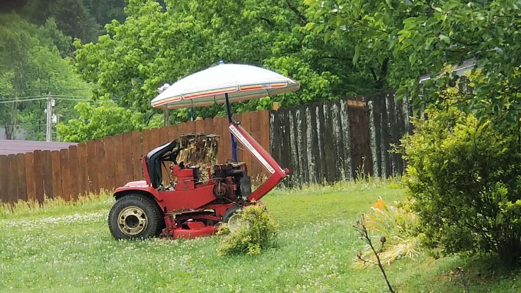

Wheel Horse 3D 3,825 #11646 Posted May 29, 2021 (edited) Ohh and all while it was drizzling rain ... Edited May 29, 2021 by Wheel Horse 3D 4 1 Share this post Link to post Share on other sites
