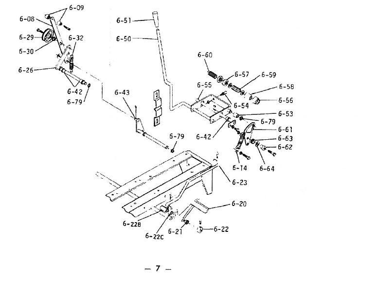

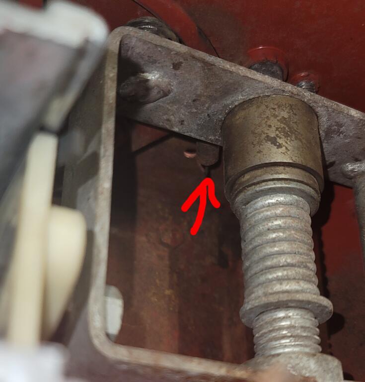

haydendavid380 759 #10651 Posted April 20, 2021 3 minutes ago, Gregor said: I think you are on the wrong side of the tractor for the PTO pedal. What model tractor again? That's the left side of the tractor. C-160 Auto Share this post Link to post Share on other sites
Gregor 4,848 #10652 Posted April 20, 2021 5 minutes ago, haydendavid380 said: That's the left side of the tractor. C-160 Auto I'm not very familiar with the C-160, but I really don't think there is suppose to be a spring there at all. Someone more familiar with it is going to have to chime in. 1 Share this post Link to post Share on other sites

haydendavid380 759 #10657 Posted April 20, 2021 I'm having a hard time seeing the area in the manual, but I don't see a spring. I'll have to see if there is spring missing in the back Share this post Link to post Share on other sites
Ed Kennell 46,639 #10658 Posted April 20, 2021 2 minutes ago, haydendavid380 said: I'm having a hard time seeing the area in the manual, but I don't see a spring. I'll have to see if there is spring missing in the back The brake pedal return spring should be in the back and connects the brake lever to a hole in the left axle housing gusset. 2 Share this post Link to post Share on other sites

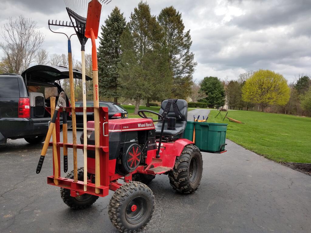

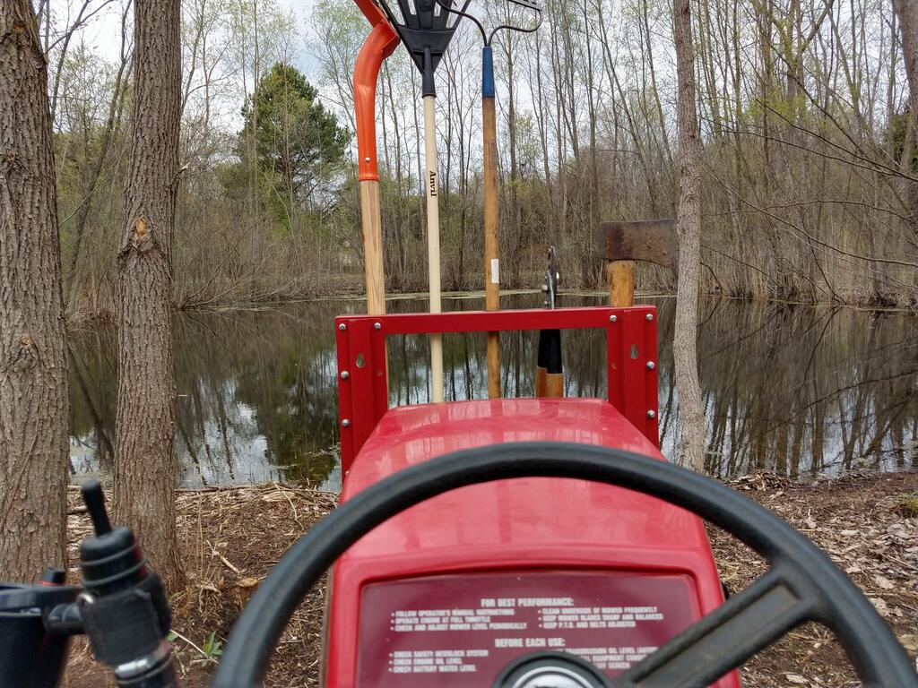

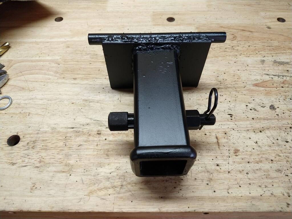

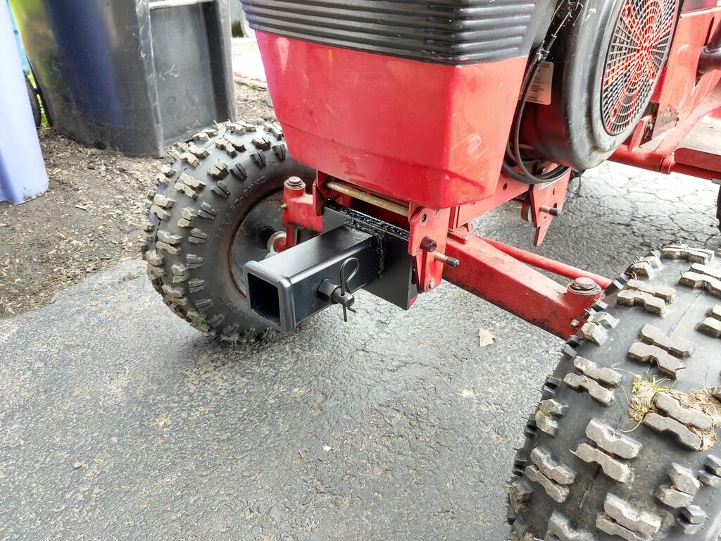

balconio 606 #10663 Posted April 20, 2021 Front receiver mount is complete. It came together real nice and now my vision for carrying all the yard tools for trail clearing is complete. With the MoJack tool rack mounted Ready for work Scope of work. All that overgrowth needs to be cut out, and this is just one of many projects. Gonna be busy this summer. 5 14 Share this post Link to post Share on other sites
haydendavid380 759 #10664 Posted April 20, 2021 38 minutes ago, balconio said: That looks like an excuse to buy another tractor. "Honey, I'm going to go pick up a rack to organize the garage like you always are saying I should do. Be back in a couple hours" 1 6 Share this post Link to post Share on other sites

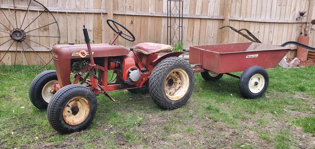

Shynon 7,604 #10665 Posted April 20, 2021 Got my new to me original 401 out for a spin and a few pictures. Put a new fuel bowl on,diamond treads and fairbanks recoil. Runs like a top no smoke or unusual noise. 9 9 Share this post Link to post Share on other sites
balconio 606 #10666 Posted April 20, 2021 6 minutes ago, haydendavid380 said: That looks like an excuse to buy another tractor. "Honey, I'm going to go pick up a rack to organize the garage like you always are saying I should do. Be back in a couple hours" LOL. To be honest it was semi-inspired by "The Big Tool Rack" which is made for a 3 point hitch. If money was no object I'd have a 25hp diesel subcompact and one of those racks, but the tractor is $18k and the rack is $1800. I get along pretty well with my pair of 312-8's 😁 3 4 Share this post Link to post Share on other sites
ebinmaine 79,754 #10667 Posted April 20, 2021 @balconio VERY nicely executed. 1 Share this post Link to post Share on other sites

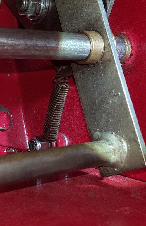

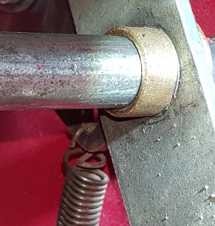

pfrederi 20,915 #10668 Posted April 20, 2021 5 hours ago, haydendavid380 said: I'm having a hard time seeing the area in the manual, but I don't see a spring. I'll have to see if there is spring missing in the back The pedal on the left of Auto tractors is pulled back by the little spring 6-14. It is a BIT***ch to install. Daveoman has posted an external spring hook up to replace it. Share this post Link to post Share on other sites
haydendavid380 759 #10669 Posted April 20, 2021 33 minutes ago, pfrederi said: The pedal on the left of Auto tractors is pulled back by the little spring 6-14. It is a BIT***ch to install. Daveoman has posted an external spring hook up to replace it. I assume that's that little spring that's not hooked to anything? 3 Share this post Link to post Share on other sites
Gregor 4,848 #10670 Posted April 20, 2021 (edited) The spring on my 876 connects to a bolt on one end, and the triangle shaped piece on the other end. If someone removed the bolt, there is nothing to connect it to.I added the locknut BTW. Edited April 20, 2021 by Gregor 4 Share this post Link to post Share on other sites
haydendavid380 759 #10671 Posted April 20, 2021 Is that the one you said was a pain? 1 Share this post Link to post Share on other sites
Gregor 4,848 #10672 Posted April 21, 2021 35 minutes ago, haydendavid380 said: Is that the one you said was a pain? I didn't, no. Share this post Link to post Share on other sites

pfrederi 20,915 #10674 Posted April 21, 2021 14 hours ago, haydendavid380 said: Is that the one you said was a pain? I said it. You will note that Gregors 876 has a different motion control no big tension spring on the cross shaft. You have less room to work. It is doable with some very long needle nose pliers plenty of cursing and swearing..good luck 1 1 Share this post Link to post Share on other sites
