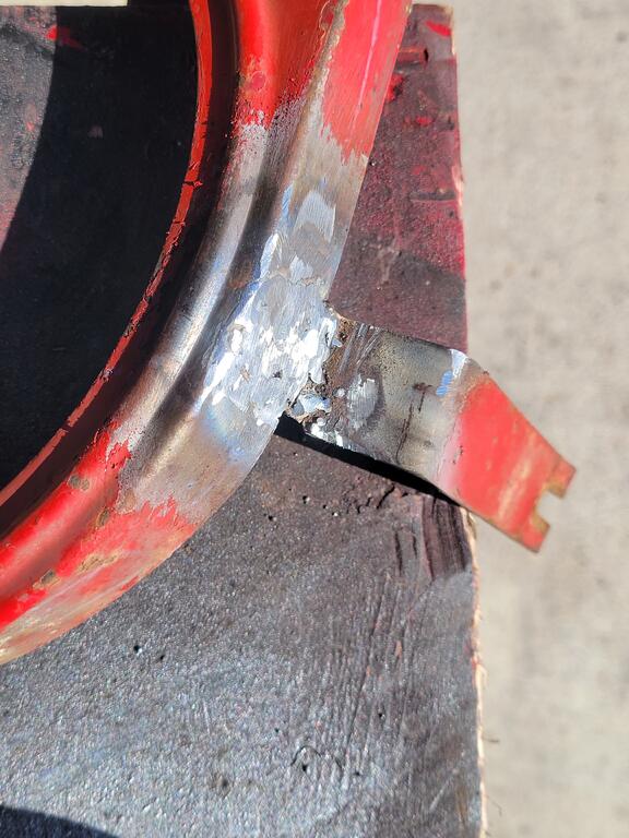

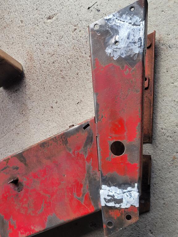

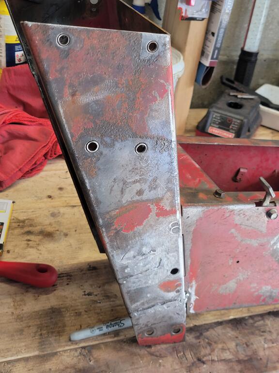

OldWorkHorse 3,156 #9676 Posted March 11, 2021 Made use of this nice warm Maine day to do some metal work on the 1257Heavy project. Some cracks and welds from the PO needed to be fixed or re done and filled some holes where lights were mounted and filled in the lift handle slot since won't be using that. Not bad better if my gas welder wasn't down but not bad for gasless 🤷♂️ 7 2 Share this post Link to post Share on other sites
ebinmaine 80,115 #9677 Posted March 11, 2021 @OldWorkHorse Looks good Steve. Grind and reweld as needed. That'll certainly get the structure back for you. 1 Share this post Link to post Share on other sites
OldWorkHorse 3,156 #9678 Posted March 11, 2021 (edited) 44 minutes ago, ebinmaine said: @OldWorkHorse Looks good Steve. Grind and reweld as needed. That'll certainly get the structure back for you. Yeah that's what I did. One of the OG welds was like 7 layers thick stuck out about .5 inch took 30min to grind it sum what flat hahaha once the paints on shell be completely solid lol Edited March 11, 2021 by OldWorkHorse 1 1 Share this post Link to post Share on other sites
ebinmaine 80,115 #9679 Posted March 11, 2021 Just now, OldWorkHorse said: Yeah that's what I did. One of the OG welds was like 7 layers thick stuck out about .5 inch took 30min to grind it sum what flat hahaha Yeah I remember that. Look like popcorn and boogers mixed together. 1 2 Share this post Link to post Share on other sites

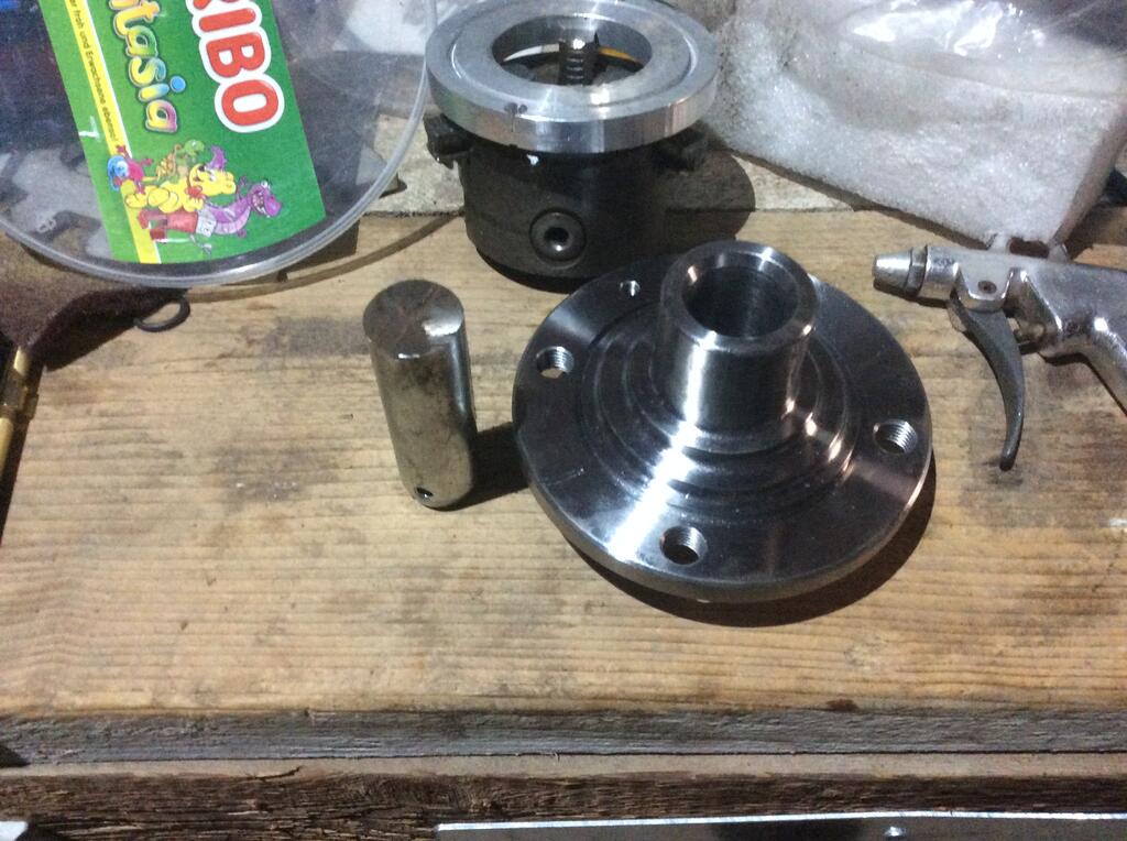

Tractorhead 9,217 #9680 Posted March 11, 2021 Did a try today. because i must Wait that long last time for my Rear Rim‘s i decide to make me 2 4-Bolt Wheelhubs. Simply bought 2 VW Golf III front Wheelhubs for 15$ both and rework them today on the Mini Lathe. found a fitting Bolt what i can use as testobject to verify if it fits. Tadaa - two new 4Bolt Wheelhubs. they just need 2 threads for Setscrews to be ready to use. 801613DE-BC90-40E9-94FD-0A82EB751007.MOV 2 8 2 Share this post Link to post Share on other sites

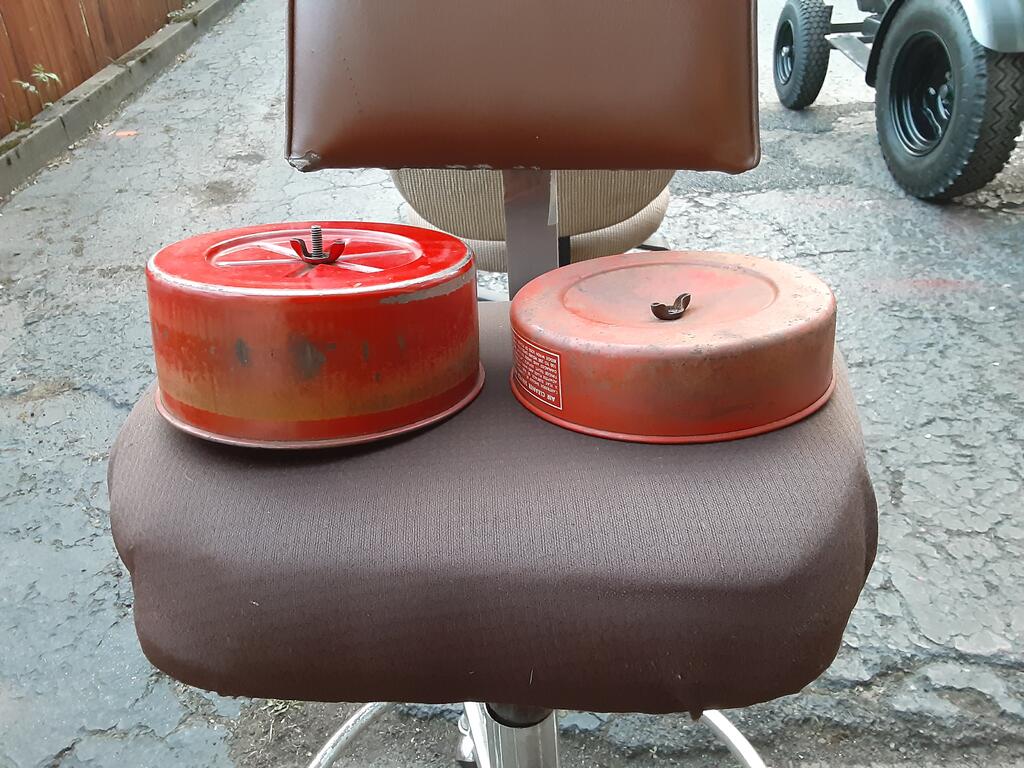

krystolo 504 #9683 Posted March 11, 2021 7 minutes ago, pullstart said: @krystolo we’re gonna wanna find you an air filter soon too, so no poo poo dust turns your fun into a poo poo day. I’ve been doing a quick search and it seems it’s discontinued. Any universal covers that would fit? Share this post Link to post Share on other sites
Pullstart 71,016 #9684 Posted March 11, 2021 3 minutes ago, krystolo said: I’ve been doing a quick search and it seems it’s discontinued. Any universal covers that would fit? a wanted ad here in the classifieds might help. Maybe @richmondred01 or @Ed Kennell might have some spares, among others? 2 Share this post Link to post Share on other sites
ebinmaine 80,115 #9685 Posted March 11, 2021 40 minutes ago, krystolo said: I’ve been doing a quick search and it seems it’s discontinued. Any universal covers that would fit? Never sweat parts availability on a horse. They's a ton o' stuff out there. One of us might have it. Or A to Z Tractor in Pennsylvania. What size engine? 1 Share this post Link to post Share on other sites
krystolo 504 #9686 Posted March 11, 2021 1 minute ago, ebinmaine said: Never sweat parts availability on a horse. They's a ton o' stuff out there. One of us might have it. Or A to Z Tractor in Pennsylvania. What size engine? 16 hp Kohler thanks! 1 Share this post Link to post Share on other sites
ebinmaine 80,115 #9687 Posted March 11, 2021 6 minutes ago, krystolo said: 16 hp Kohler thanks! A 16 takes a bigger air filter. Others from some of the big twins will work as well. Pop an ad on our own want ads and if no results within a day or 3 call Lincoln at A to Z. Share this post Link to post Share on other sites
Gregor 4,848 #9688 Posted March 11, 2021 2 hours ago, Tractorhead said: Did a try today. because i must Wait that long last time for my Rear Rim‘s i decide to make me 2 4-Bolt Wheelhubs. Simply bought 2 VW Golf III front Wheelhubs for 15$ both and rework them today on the Mini Lathe 801613DE-BC90-40E9-94FD-0A82EB751007.MOV 22.27 MB · Sure wish I had all your toys, and someplace to put them. 1 Share this post Link to post Share on other sites
Oldskool 6,678 #9689 Posted March 11, 2021 3 hours ago, Tractorhead said: Did a try today. because i must Wait that long last time for my Rear Rim‘s i decide to make me 2 4-Bolt Wheelhubs. Simply bought 2 VW Golf III front Wheelhubs for 15$ both and rework them today on the Mini Lathe. found a fitting Bolt what i can use as testobject to verify if it fits. Tadaa - two new 4Bolt Wheelhubs. they just need 2 threads for Setscrews to be ready to use. 801613DE-BC90-40E9-94FD-0A82EB751007.MOV 22.27 MB · 1 download Those hubs are looking good 1 Share this post Link to post Share on other sites

D_Mac 9,338 #9692 Posted March 12, 2021 What are you looking for ? Just the air filter cover? On my C-161, because of the bad engine mounts, the plate that holds the cover and filter to the carb cracked. I got the smaller cover from k&b horse parts. I might still have other cover, but not the plate. Share this post Link to post Share on other sites
krystolo 504 #9693 Posted March 12, 2021 @D_Mac I need the base plate and the cover. Thanks, though! Share this post Link to post Share on other sites
Gregor 4,848 #9694 Posted March 12, 2021 I got my replacement from A to Z. Mine was broke like the one above. 1 Share this post Link to post Share on other sites
Tractorhead 9,217 #9695 Posted March 12, 2021 5 hours ago, Gregor said: Sure wish I had all your toys, and someplace to put them. I have to wait over 50years to get this great opportunity. Now i can enjoy every fract of second, what i do. 2 1 3 Share this post Link to post Share on other sites
