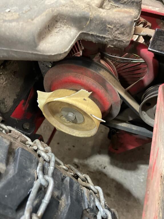

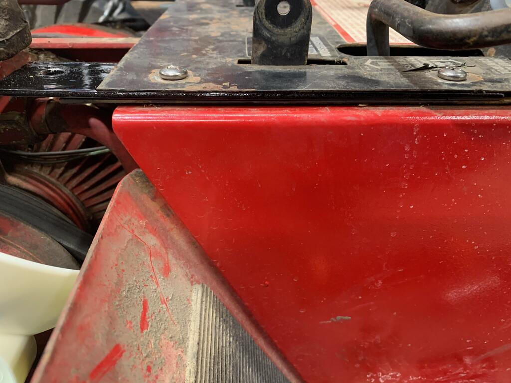

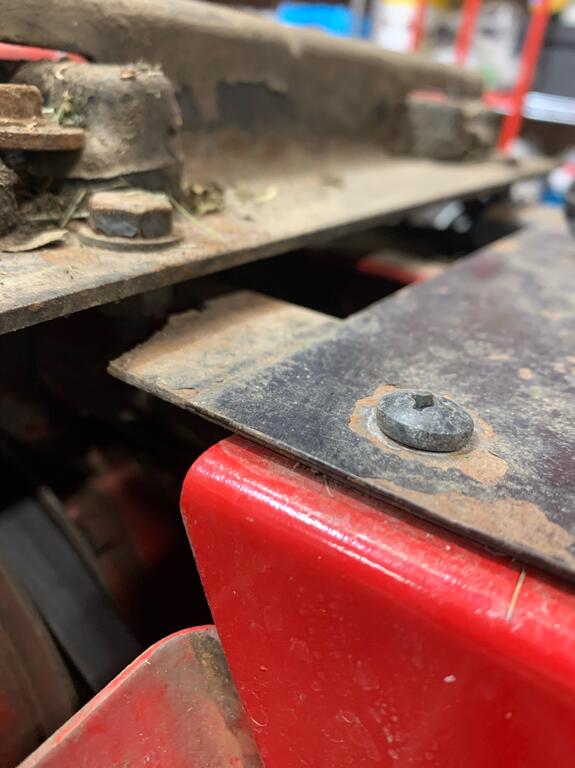

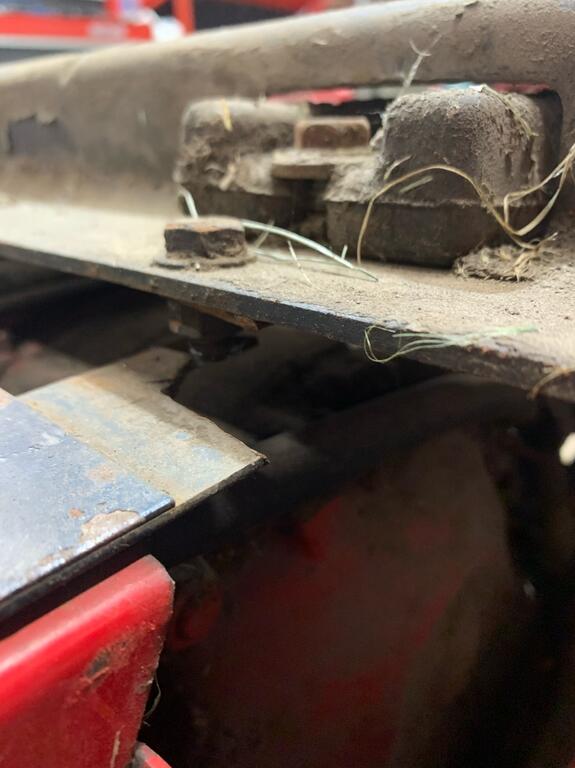

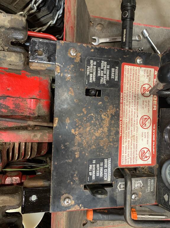

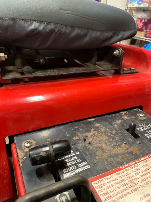

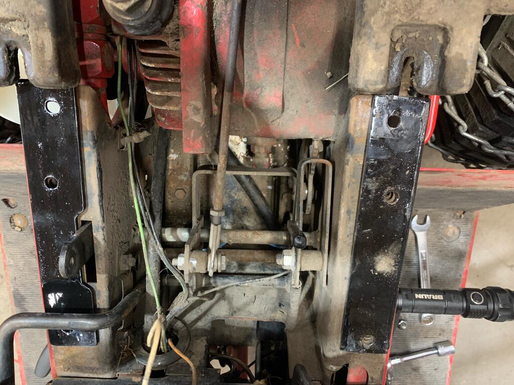

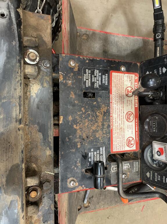

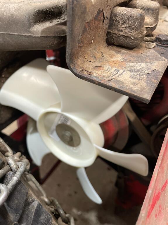

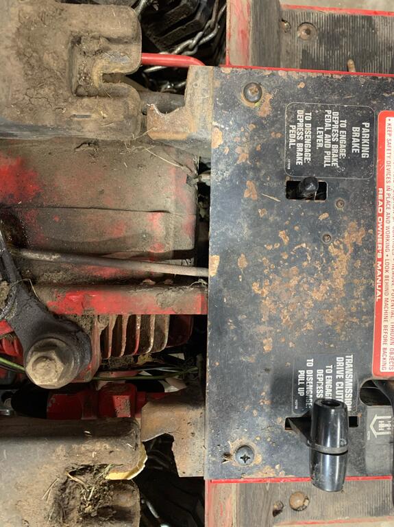

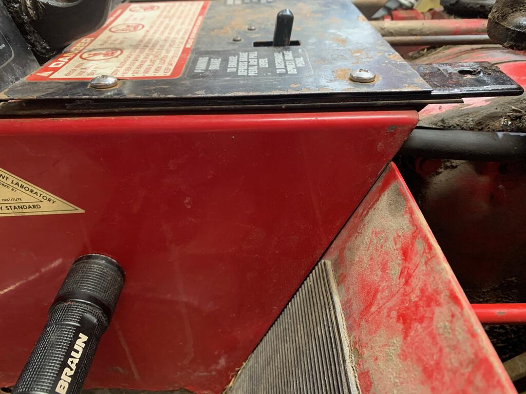

Andy N. 2,845 #9456 Posted February 27, 2021 Installed a quick fix to the seat bracket connection on the rear part of the hoodstand that is always cracked or in this case missing on my 418-A. 1/8" thick metal primed and painted. Did have to add longer 1/4"-20 screws to the shift plate. This requires very little disassembly and no welding. Also replaced the hydraulic fan. Not exactly sure what happened when I was snow blowing a couple weeks ago. The snow is currently melting and I found all the tips of the blades in different places in my driveway. I did find the inside tail (3 chain links worth) of my tire chains loose and wonder if that just enough length to reach the fan. 8 4 Share this post Link to post Share on other sites

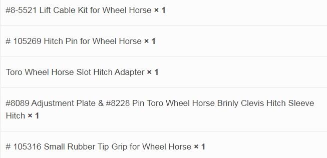

haydendavid380 759 #9457 Posted February 27, 2021 I'm on my way to some ground engaging work this spring. Ordered up everything I'll need to run my cultivator or any implement I can find in the mean time 9 Share this post Link to post Share on other sites

WHX?? 58,280 #9459 Posted February 28, 2021 (edited) Hey @roadapples.... check out Andy''s fan blade....... I wouda offered ya a replacement Andy but 'Apples has got me tapped out! Gonna but both you guys on the chain gang! Edited February 28, 2021 by WHX24 3 Share this post Link to post Share on other sites
roadapples 6,987 #9460 Posted February 28, 2021 I've got one just like that... Share this post Link to post Share on other sites
WHX?? 58,280 #9461 Posted February 28, 2021 7 minutes ago, roadapples said: I've got one just like that... Which one??? Or both???? 1 Share this post Link to post Share on other sites
roadapples 6,987 #9462 Posted February 28, 2021 Both... 2 Share this post Link to post Share on other sites

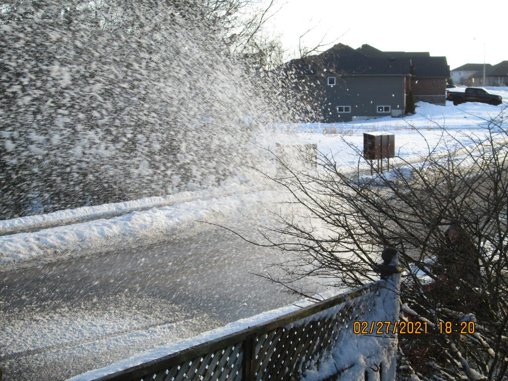

MikMacMike 494 #9463 Posted February 28, 2021 Well I finally blew up th snow blower, right when I needed it. Only got half the snow removed. So now we get all this warm weather and everything is melting fast creating ice everywhere. That was a few days ago so yesterday I went and got a new 10 foot peice of Renolds chain, thankfully its made in England and not china land crap. Well it went together with out a hitch and figured since I had the Ol Beast, now named Aggie. I have Big Red and Aggie hehehe. So I couldnt stop there, I just had to do some tweeking. These darn single stage blowers dont really throw the snow and when in slush or wet snow forget it. So I found some 2 inch wide by 3/16" thick flat bar and made a lower scraper blade, drilled and bolted it into place, then I tweeked the auger. We wake me up and toss me into tomorrow, everything is slush and below that its3 inches of water. Ahhh the hell with it I say so out of the shop I go, reved Aggie up, mind you Aggie is just a 10 horse turning this single stage blower, I didnt take the pics Maw did, but heres the difference, 1st pick was just before blowing it up, the rest are from today. And Rock isnt the word, I dont know where mother nature lives but I know this much, I can send the slush snow ice or water right back to where she came from hahahahah. Ops all I can do is 2 pics sorry guys. The second pic is throwing super heavy wet slushy snow 25+ feet into the air. 8 1 Share this post Link to post Share on other sites

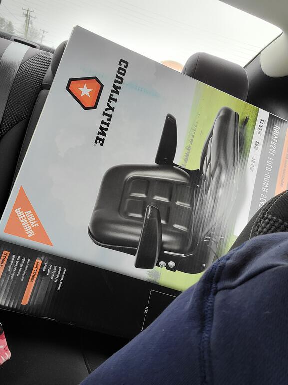

Jhook 849 #9468 Posted February 28, 2021 Just picked up a cheap tractor supply brand 520h style seat for my 315. Will post pics and update on fitment when i get it home and try to install it. Looks pretty nice and less than 200 bucks 4 1 Share this post Link to post Share on other sites

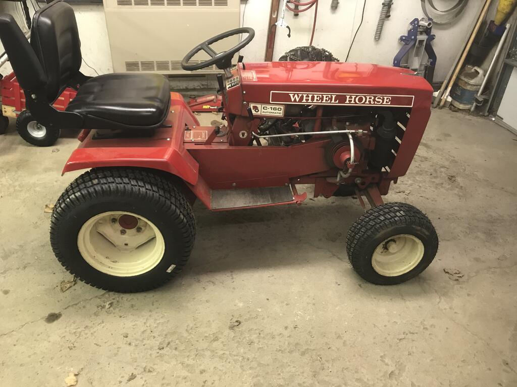

squonk 48,203 #9469 Posted February 28, 2021 (edited) 20 minutes ago, Jhook said: Just picked up a cheap tractor supply brand 520h style seat for my 315. Will post pics and update on fitment when i get it home and try to install it. Looks pretty nice and less than 200 bucks I have that same seat on my C-160 and it's awesome. I've had it prolly at least 10 years . Bolted right on if I recall. I mounted it on springs Best seat on my fleet! Edited February 28, 2021 by squonk 5 Share this post Link to post Share on other sites

Jhook 849 #9472 Posted February 28, 2021 41 minutes ago, pfrederi said: Guess we all have a different definition of reasonable price for seat. My butt isn't worth anything over about $75.... Well considering a new one from toro for my tractor is 400 dollars, less than 200 is very reasonable. If i didnt use the machine a lot i wouldnt care 1 Share this post Link to post Share on other sites

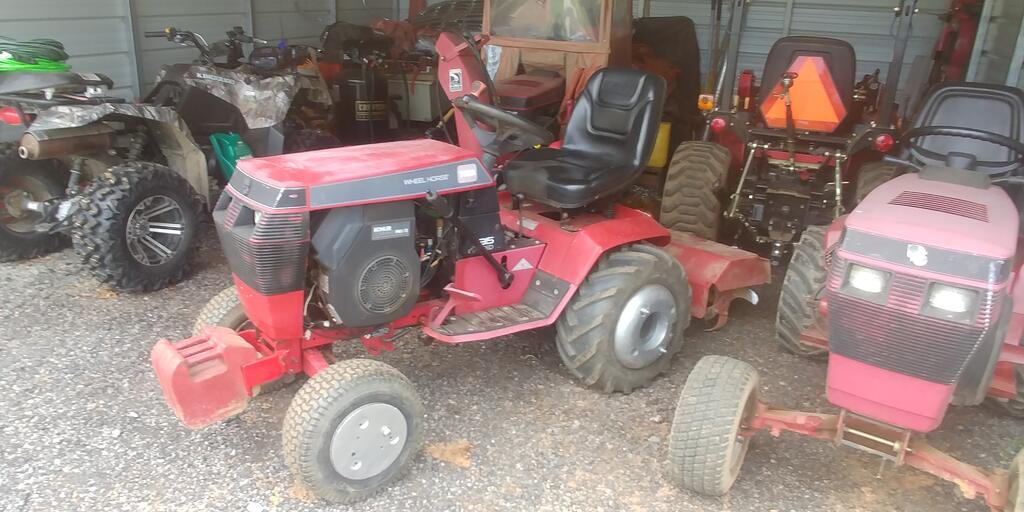

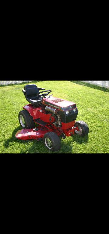

WVHillbilly520H 10,379 #9473 Posted February 28, 2021 1 hour ago, Jhook said: Just picked up a cheap tractor supply brand 520h style seat for my 315. Will post pics and update on fitment when i get it home and try to install it. Looks pretty nice and less than 200 bucks Not knocking your descion, but how is that a 520H style seat? This Kobota seat came on the 315-8 I had for a couple years and the same basic seat can be had from TSC, the seat I put on my 520 came from Northern Tool, Michigan Brand, but basically an exact copy of the TORO version on my bought new Anniversary 520H. https://www.tractorsupply.com/tsc/product/countyline-kubota-seat-530000bk-cnl 1 Share this post Link to post Share on other sites
Jhook 849 #9474 Posted February 28, 2021 11 minutes ago, WVHillbilly520H said: Not knocking your descion, but how is that a 520H style seat? This Kobota seat came on the 315-8 I had for a couple years and the same basic seat can be had from TSC, the seat I put on my 520 came from Northern Tool, Michigan Brand, but basically an exact copy of the TORO version on my bought new Anniversary 520H. https://www.tractorsupply.com/tsc/product/countyline-kubota-seat-530000bk-cnl If you look closely youll notice armrests on a lot of 520s. Most of the ones i see for sale in my area anyways. Other models typically do not have them from what ive seen. Share this post Link to post Share on other sites
WVHillbilly520H 10,379 #9475 Posted February 28, 2021 (edited) 25 minutes ago, Jhook said: If you look closely youll notice armrests on a lot of 520s. Most of the ones i see for sale in my area anyways. Other models typically do not have them from what ive seen. Yes my 95 has them, they were an additional bolt on option not always added, and WH had 2 styles the 2 piece like on mine or the one piece bracket like on older B/C series tractors, I put mine on a year or so after installing the seat, most times IMO/experiences are more in the way than actually useful, more of a "cool" factor, good luck and hope you enjoy yours. Here is the seat I used on my 95 520... https://www.oleegoliq.com/michigan-seat-extra-highback-seat-black-model-v818-p-117829.htm Edited February 28, 2021 by WVHillbilly520H Share this post Link to post Share on other sites
