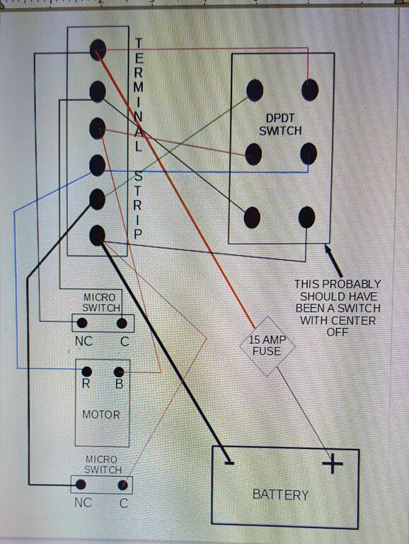

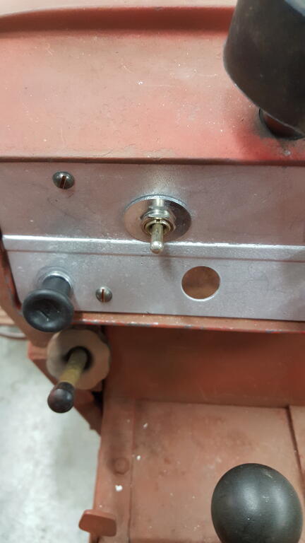

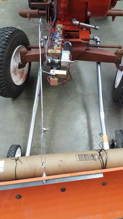

Gregor 4,848 #9203 Posted February 10, 2021 The other day I mentioned that I thought my plow needed a better lift mechanism. So yesterday I commenced to making one. It's not very sophisticated, and it aint purdy, but t works. Switch on the dash raises and lowers plow. Micro switches limit travel up and down. Goes up and down in about a second. If I can ever find the switch I want, I have another plan, but apparently it is a very elusive switch. In line with keeping it Red Green compliant, I cut off the cardboard tube some, filled it with ice melting salt, and taped the caps on with duct tape. When (and if) my new hood ever gets here from Lincoln, this will all have to be revamped. But that might wait a while. Now. I don't have anything to do again. 7 1 2 Share this post Link to post Share on other sites

Gregor 4,848 #9208 Posted February 10, 2021 (edited) SSure. I always put things on paper first. Helps me sort things out. Pay no attention to line color or size. I did that only to make it easier for my old tired eyes to see. Motor This motor is 10 RPM Edited February 10, 2021 by Gregor Share this post Link to post Share on other sites

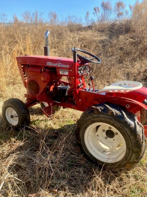

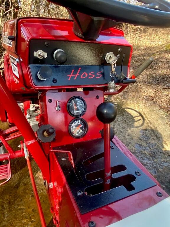

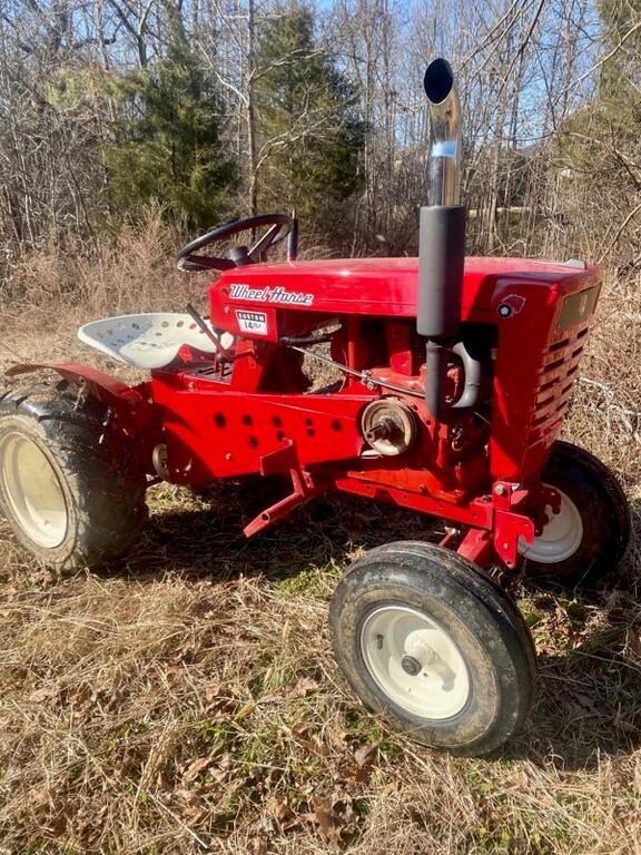

Greentored 3,221 #9214 Posted February 11, 2021 Got the oil temp gauge installed, gas tank sealed and back in place, took Hoss on a little trail ride and snapped a few pics. So close to 'done' I can taste it. Gonna be needing a 5" engine pulley and clutch disc if anyone has those kicking around. 4 12 Share this post Link to post Share on other sites

Maxwell-8 4,371 #9218 Posted February 11, 2021 1 hour ago, Greentored said: Got the oil temp gauge installed, gas tank sealed and back in place, took Hoss on a little trail ride and snapped a few pics. So close to 'done' I can taste it. Gonna be needing a 5" engine pulley and clutch disc if anyone has those kicking around. Nicely done!! What is her oil temp getting up to? 1 Share this post Link to post Share on other sites

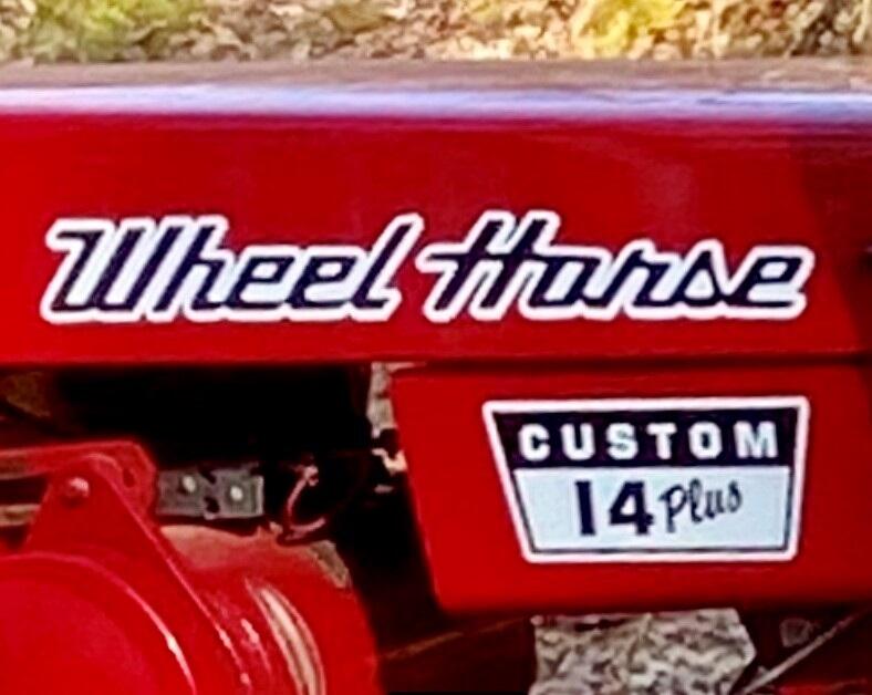

Greentored 3,221 #9220 Posted February 11, 2021 5 hours ago, WHX24 said: The down side of having a key fob Green. Old lady wanted one on her $1000 paint job... I said ney ney unless it's velvet coated! Got tired of folks saying it'll look good in the tractor shows and parades, so I let it get tore up a little HA! 2 1 Share this post Link to post Share on other sites
Greentored 3,221 #9221 Posted February 11, 2021 3 hours ago, Maxwell-8 said: Nicely done!! What is her oil temp getting up to? Haven't seen it over about 120, but 30 minutes of trail putting isn't really working it much. Anxious to see what it'll run when I start dragging stuff around all day in the summer heat 2 Share this post Link to post Share on other sites
ebinmaine 80,855 #9222 Posted February 11, 2021 22 minutes ago, Greentored said: Haven't seen it over about 120, but 30 minutes of trail putting isn't really working it much. Anxious to see what it'll run when I start dragging stuff around all day in the summer heat Keep us posted on that please. I'm curious myself. 2 Share this post Link to post Share on other sites
