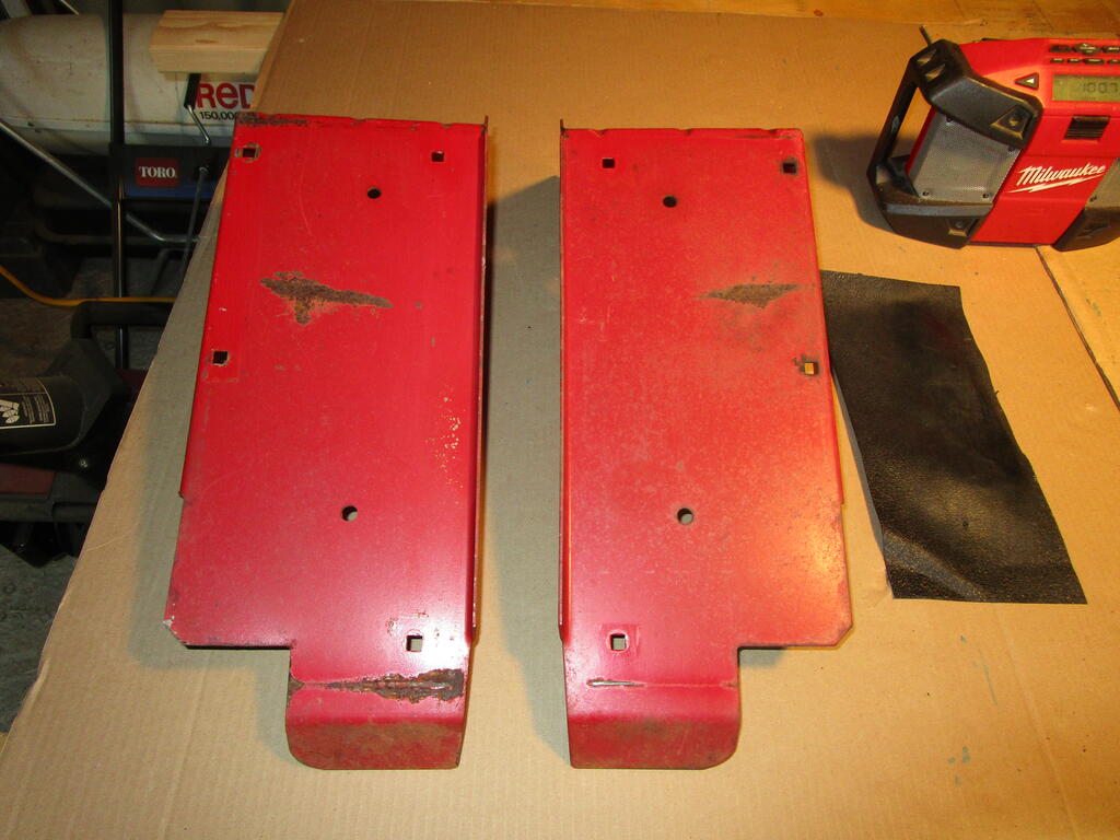

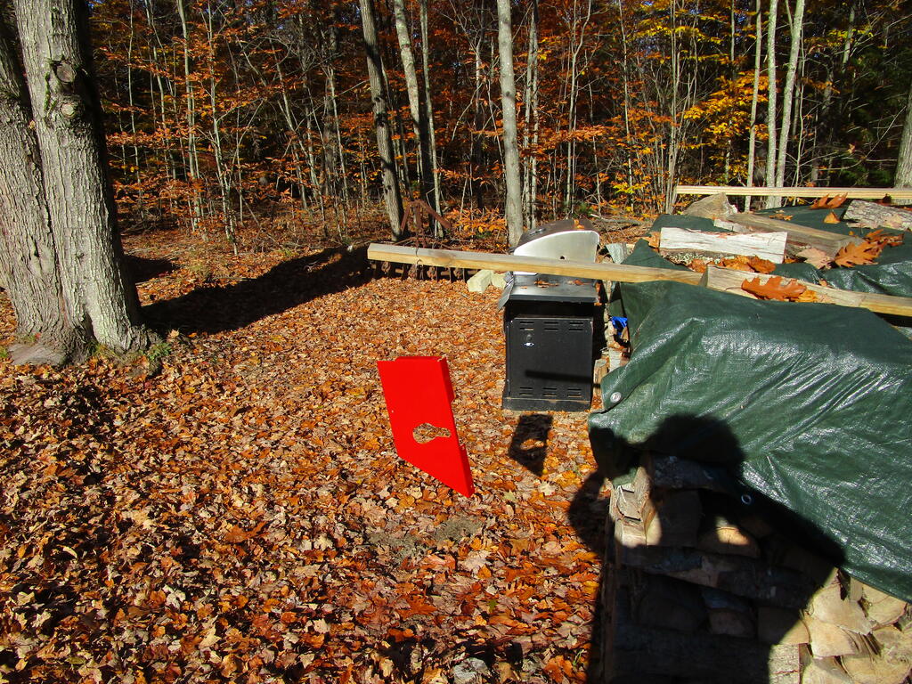

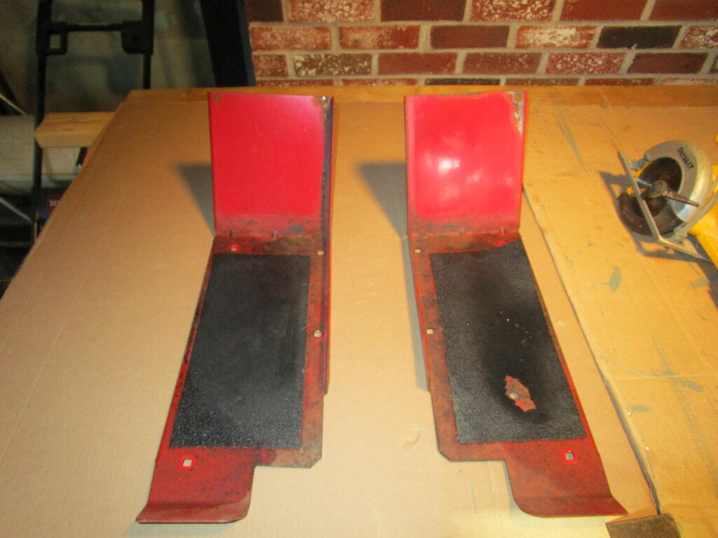

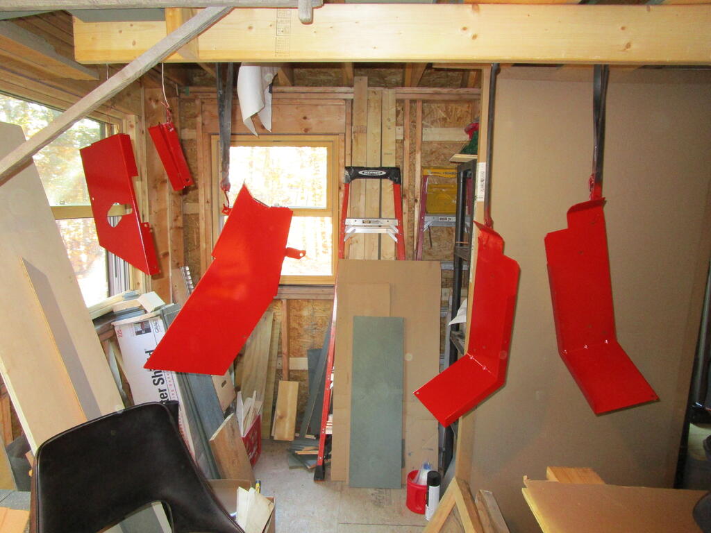

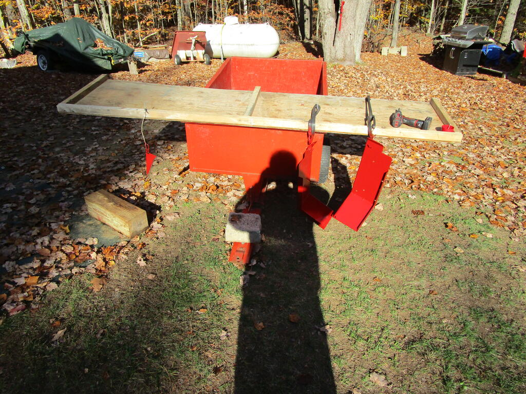

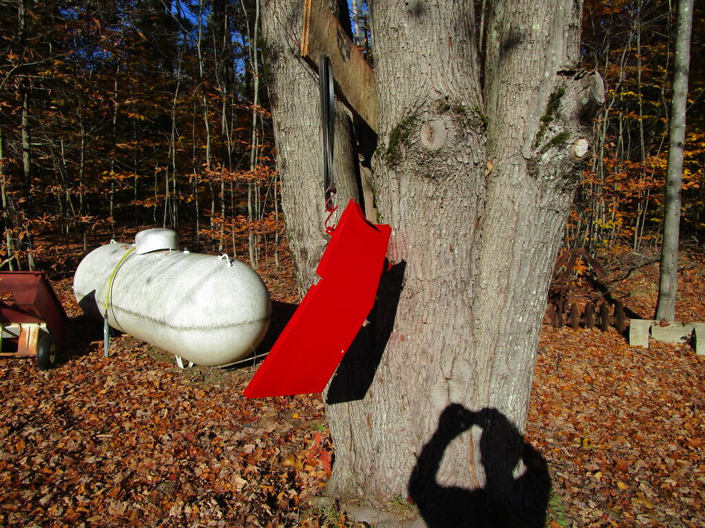

JCM 11,406 #7236 Posted October 22, 2020 Usually this time of year in Maine painting is a little difficult for drying times but today was ideal as was the sun to help out. Resumed work on the 310-8. This is the third set of footrests I have painted this year. These were taken off of the C-85 parts tractor and appear to have been inside most if not all of their years and did not need a lot of rust removal. Also did both side covers and lower belt guide. Before and after pics and outside and inside drying stations. 4 2 1 Share this post Link to post Share on other sites

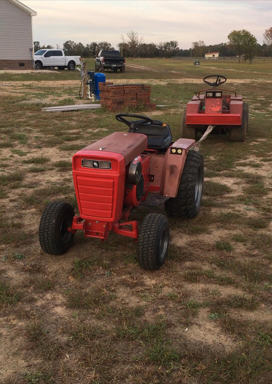

19richie66 17,932 #7237 Posted October 22, 2020 Got Skittles out, charged her up and did some yardwork. Then she played with her newly adopted brother, “Blaze”. 12 1 Share this post Link to post Share on other sites

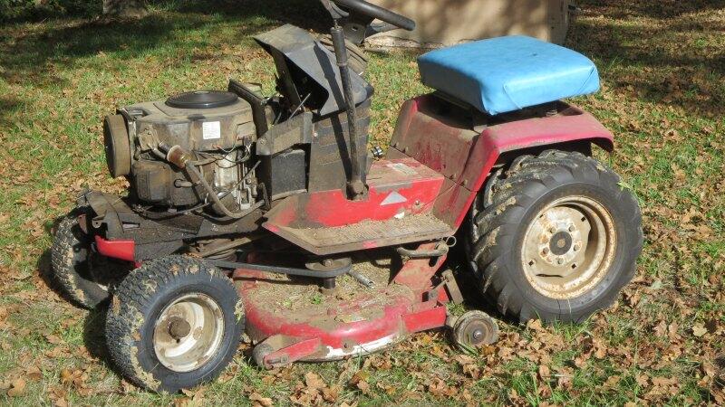

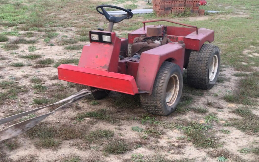

19richie66 17,932 #7241 Posted October 23, 2020 (edited) 1 hour ago, ebinmaine said: ??? Hesston Frontrunner 200. The story I got on it was the original owner’s wife was using it to mow and the fuel line from pump to carb split. Sprayed fuel on the engine and caught on fire. It burned until the wiring harness melted together and shut off the engine. Luckily the fire burnt out and did no more damage other than melting all the wiring. So hence the name “Blaze”. It was sold at a yard sale after the owner passed and bought by the guy I got it from. It has been in a barn since 2002. He has 12 more of them. Hope to get it going again soon. Edited October 23, 2020 by 19richie66 1 3 Share this post Link to post Share on other sites

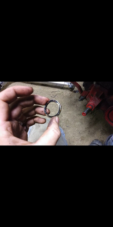

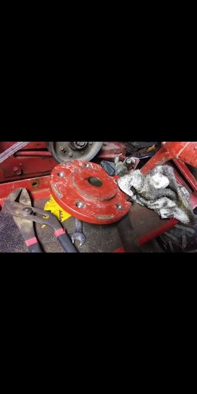

TractorChild97 158 #7244 Posted October 23, 2020 Changed the seal on the other side. It could have waited, but in surprise the hub came off within minutes. The other side took hours. 6 Share this post Link to post Share on other sites
ebinmaine 80,464 #7245 Posted October 23, 2020 Just happened to think. I don't know if anybody mentioned it yet. After you drive that thing around for a bit you want to reach in there and double check the torque on those set screws. I've forgotten to do that and had the hub move a few weeks later. 1 Share this post Link to post Share on other sites
Lee1977 7,756 #7246 Posted October 23, 2020 Always use new keys and set screws when putting the hub back on. Share this post Link to post Share on other sites
TractorChild97 158 #7247 Posted October 23, 2020 1 hour ago, ebinmaine said: Just happened to think. I don't know if anybody mentioned it yet. After you drive that thing around for a bit you want to reach in there and double check the torque on those set screws. I've forgotten to do that and had the hub move a few weeks later. That actually happened yesterday. I had to adjust it ant tighten the set screws. Good call 3 Share this post Link to post Share on other sites

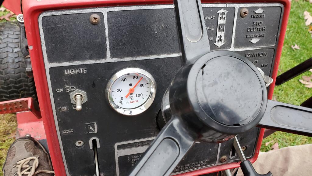

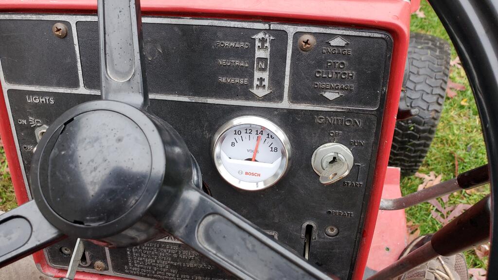

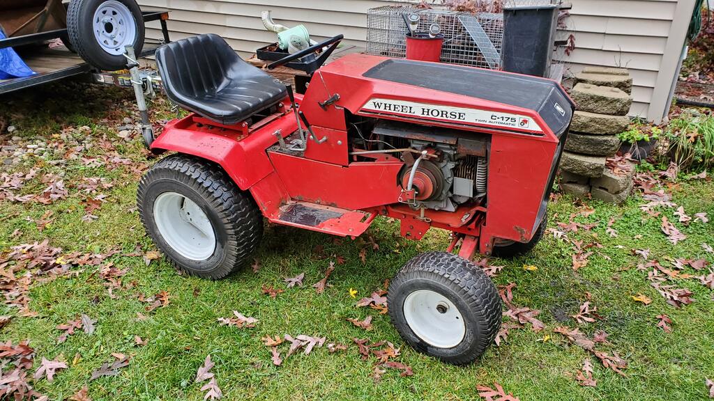

bds1984 1,518 #7248 Posted October 23, 2020 Gone is the ammeter in my C175 and a voltage gauge in its place. I figured this would be a good time to install the matching oil pressure gauge, new fuel line, and service out the engine. 8 5 Share this post Link to post Share on other sites
