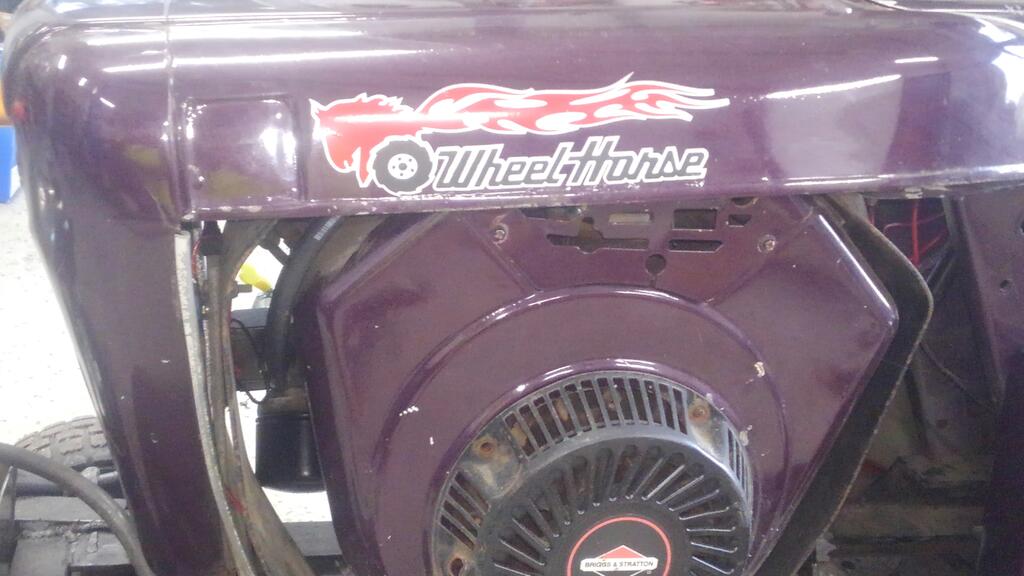

Redneckdavis 308 #6252 Posted August 25, 2020 Decals!!! 6 1 1 1 Share this post Link to post Share on other sites

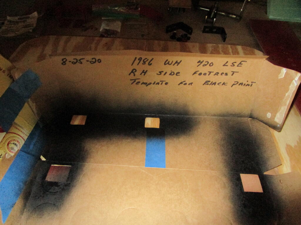

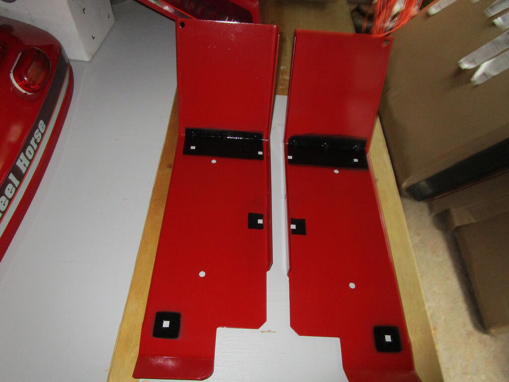

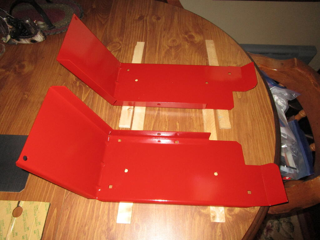

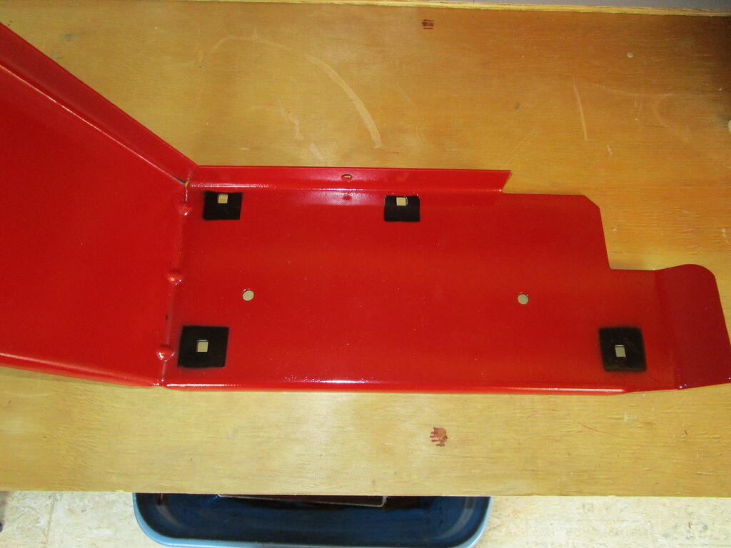

JCM 11,451 #6253 Posted August 26, 2020 Worked on the footrests for the 420 today. It seems on this model they painted the area black for the carriage bolts and the 3 holes where the pad bends up to the rear fender when it was built from what i can gather for info. The heads of the bolts where also painted black. Made a cardboard template to cover the red then sprayed the black. Last step will be to stick the new pads on. 6 2 Share this post Link to post Share on other sites

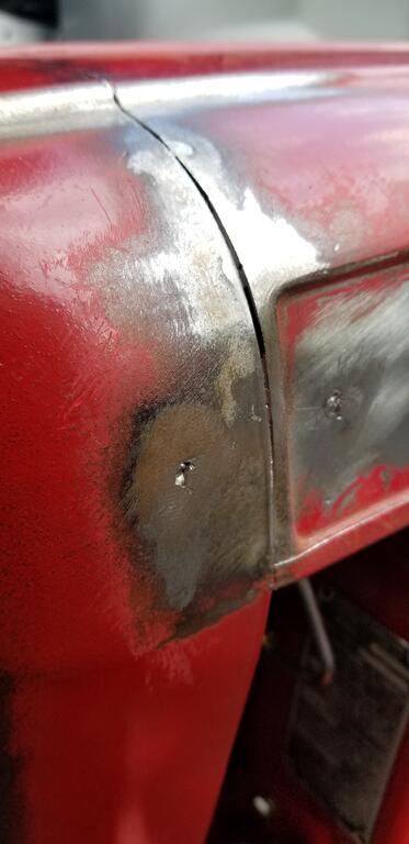

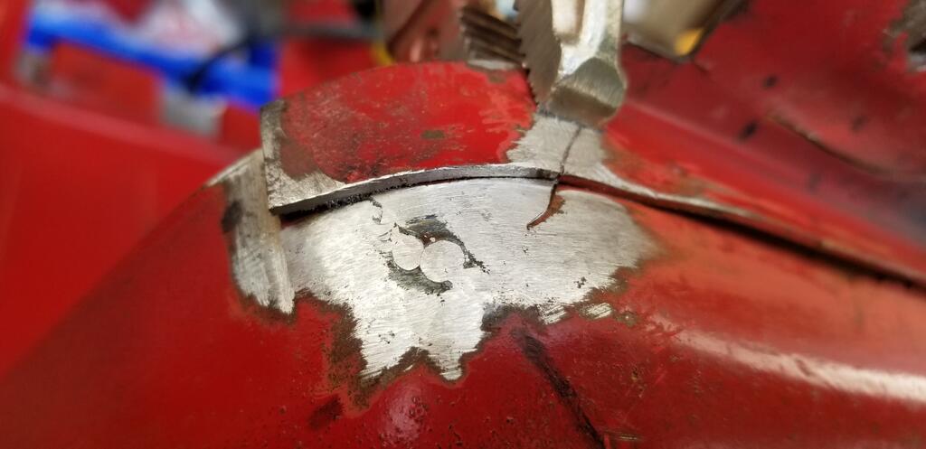

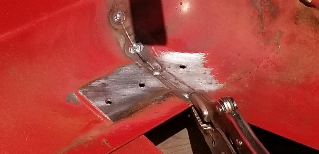

AMC RULES 37,260 #6254 Posted August 26, 2020 (edited) Finished all the hoods metal work today, thing is rock solid now and fitting tighter than OJ's gloves. The usual broken front mounts multiple issues fixed...all holes welded up...and the broken seams (both sides)... tacked back together. Finished up with an application of a paintable automotive seam sealer to the underside to fill the gap which will have it ready to be stripped to bare metal tomorrow and back into fresh paint like glass by C.O.B. Edited August 26, 2020 by AMC RULES 5 3 Share this post Link to post Share on other sites

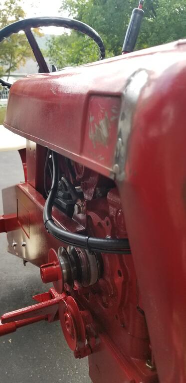

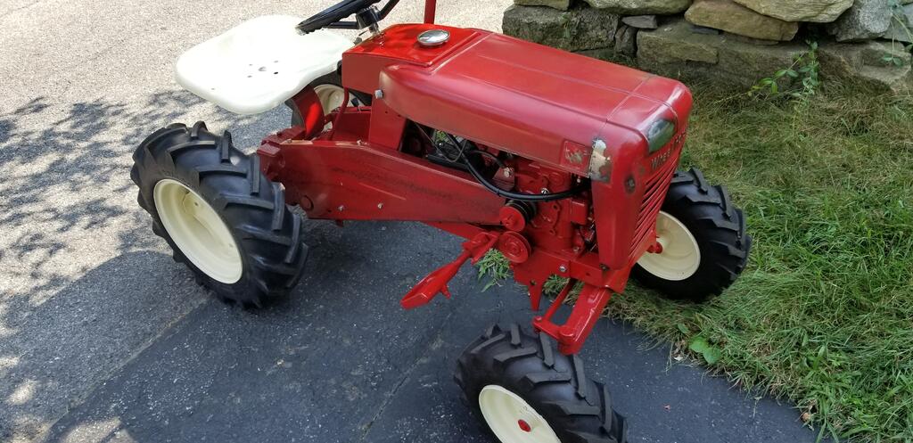

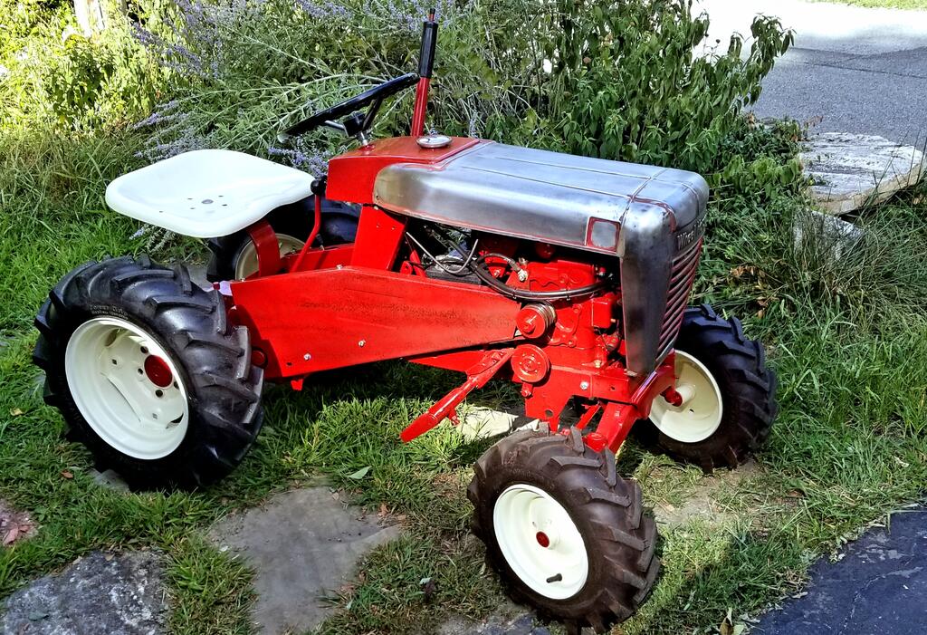

AMC RULES 37,260 #6264 Posted August 26, 2020 In the home stretch now! 6 1 Share this post Link to post Share on other sites

WHX?? 58,347 #6267 Posted August 26, 2020 2 hours ago, AMC RULES said: In the home stretch now! A little trim right on the edge of the hood makes for a nice paint saver too Madge. I got a roll of it you want I send.... 2 2 1 2 Share this post Link to post Share on other sites
