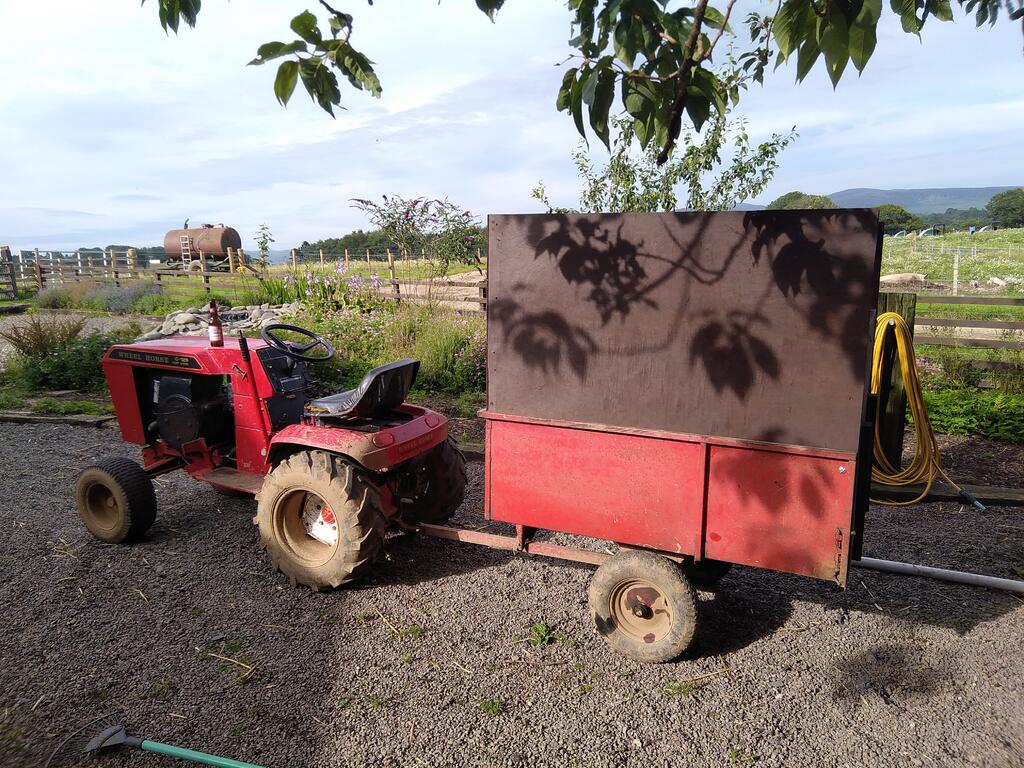

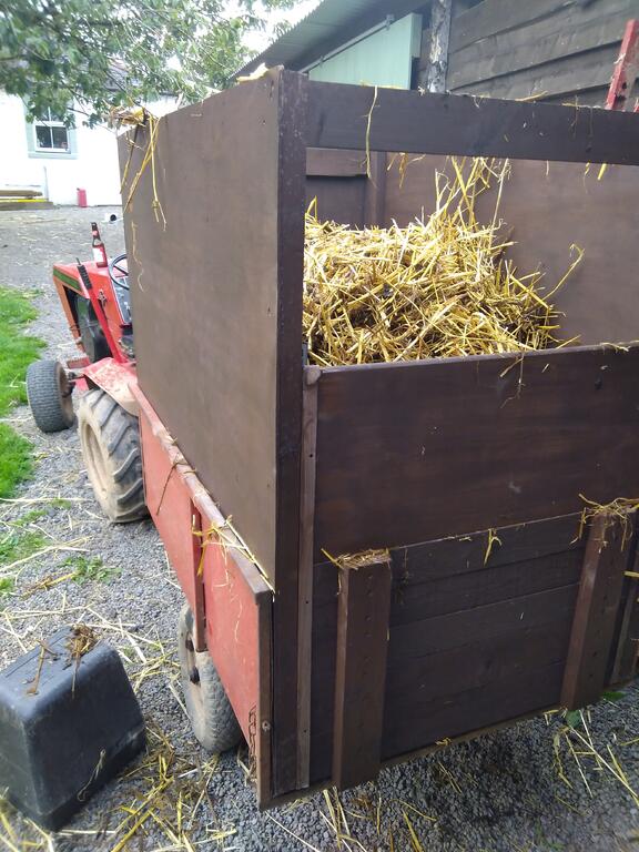

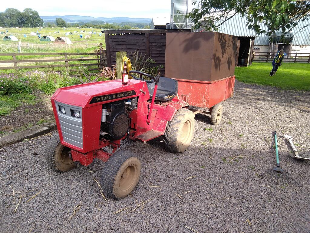

Dan.gerous 2,696 #5927 Posted July 31, 2020 Modified the wheelhorse's trailer today as it couldn't hold enough hay when the girls were mucking out the piglet hospital ( they look after any sick ones). Added high sides so now we can do the clean up in one run to the muck pile rather than three. 7 2 1 Share this post Link to post Share on other sites

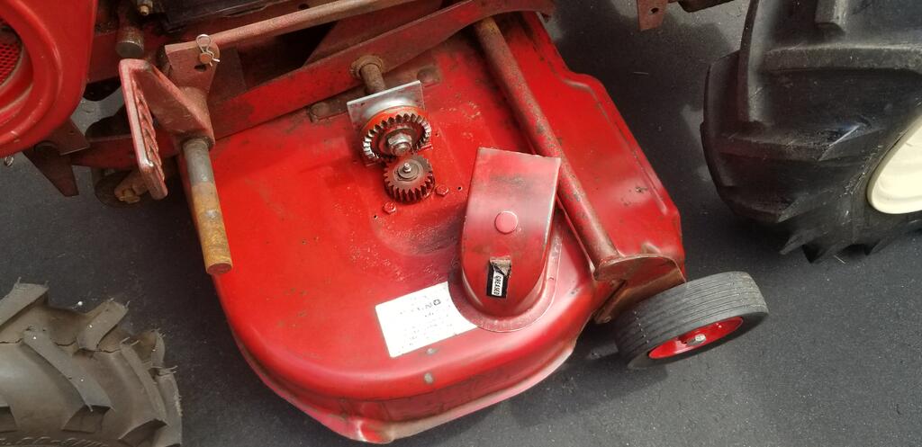

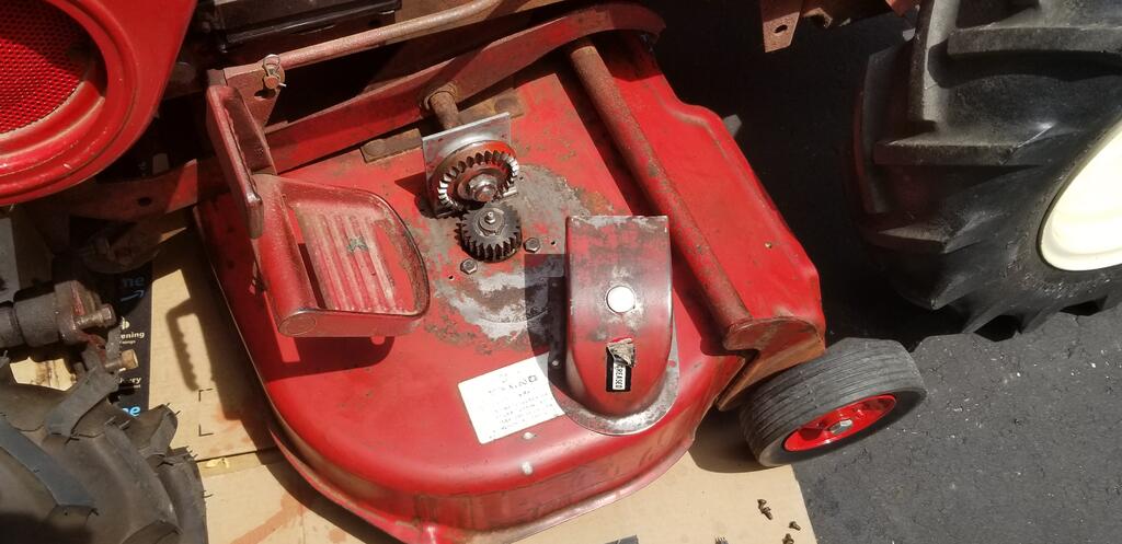

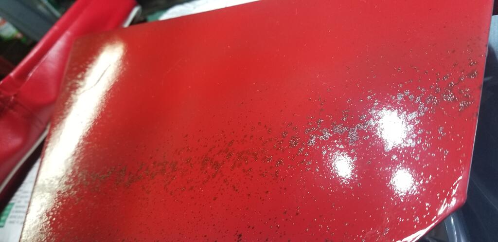

AMC RULES 37,260 #5928 Posted July 31, 2020 (edited) Replaced some of the 854 decks lost patina today. The before... ...and the after. Edited July 31, 2020 by AMC RULES 8 2 1 Share this post Link to post Share on other sites

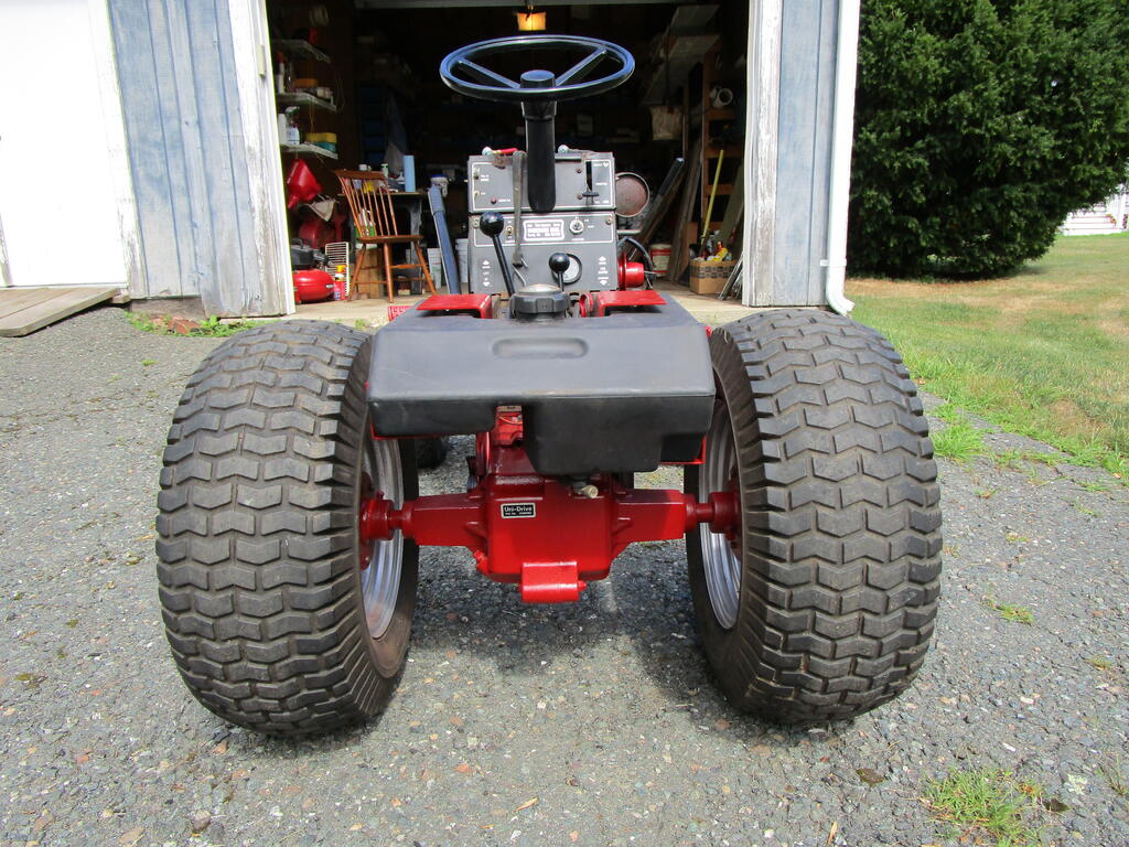

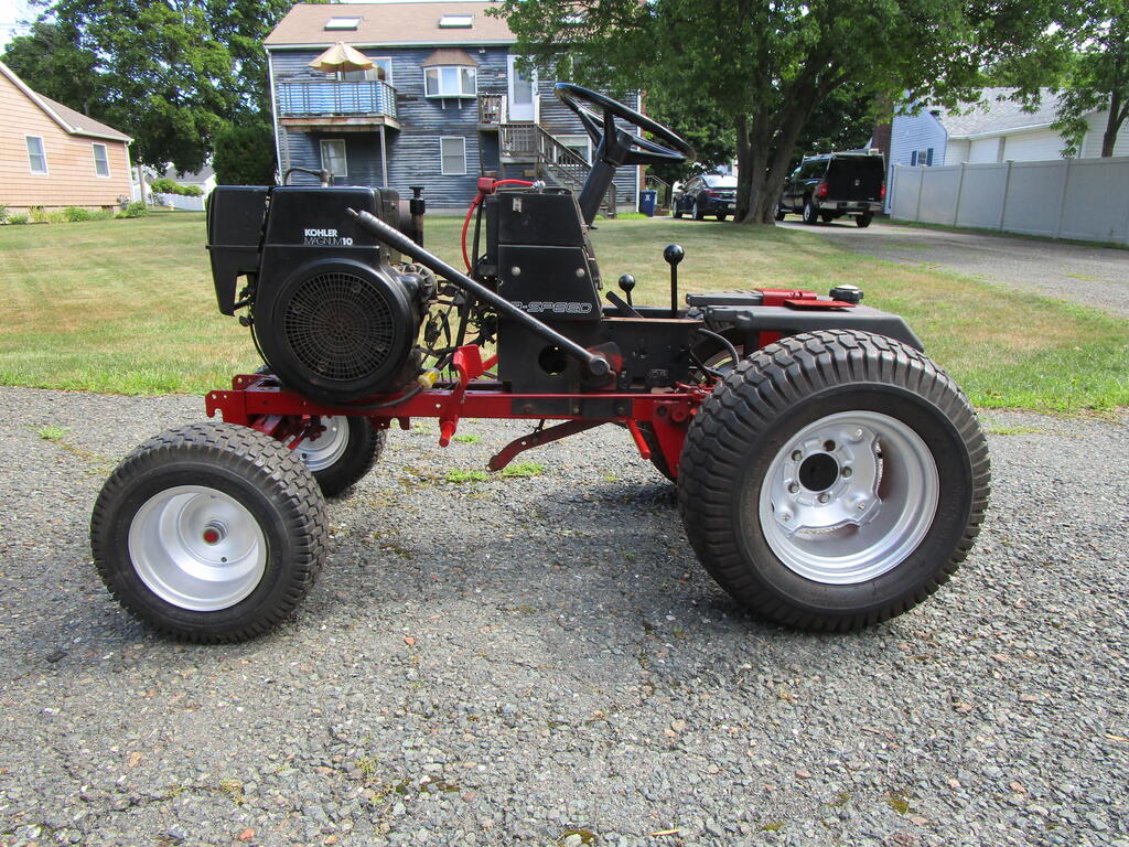

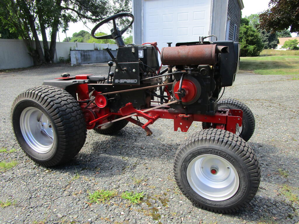

JCM 11,451 #5929 Posted July 31, 2020 Got the 310-8 up and running this morning, brought the side covers and footrests back to Maine from Mass to start on those. Was nice to hear it run and the tranny swap from the C-85 seems like it will do the job. 8 8 Share this post Link to post Share on other sites
ebinmaine 81,160 #5930 Posted August 1, 2020 @JCM you gonna BBQ black that muffler? Good to see the rig coming together. @AMC RULES niiiice.... 1 1 Share this post Link to post Share on other sites

JCM 11,451 #5932 Posted August 1, 2020 @ebinmaine The thought has crossed my mind about painting the muffler. If you look at the 312-8 in my first restoration I painted that one and it turned brown rather quickly, being 20 years ago I can't remember what product I used. The headers on the Chevelle SS always got VHT high temp paint with great results, What would you recommend. Sorry to get off topic guys, Eric made me do it. 1 1 Share this post Link to post Share on other sites
ebinmaine 81,160 #5933 Posted August 1, 2020 50 minutes ago, JCM said: @ebinmaine VHT high temp paint with great results, What would you recommend. I would either use THAT or a Rust-Oleum high heat BBQ/stove paint. That's what Trina used on the little wood stove she restored for the upstairs. Also what she used on the exhaust on Cinnamon Horse. That was a "pre-loved" muffler I got from @squonk and the piping is black iron. All still looks good. Most important thing is to get as much rust off as possible of course. 2 Share this post Link to post Share on other sites
JCM 11,451 #5934 Posted August 1, 2020 No primer needed ? Just high temp paint ? Share this post Link to post Share on other sites
ebinmaine 81,160 #5935 Posted August 1, 2020 4 minutes ago, JCM said: No primer needed ? Just high temp paint ? I'll ask her and get back to you. I don't think any primer is needed. Share this post Link to post Share on other sites
Tractorhead 9,218 #5936 Posted August 1, 2020 Normally no primer is needed. you can prepare it firstly with etank or to make it a bit more longlife brown it, before paint it in a second Step use VHT Paint. The browning and paint combination will last longest. Share this post Link to post Share on other sites
953 nut 70,382 #5937 Posted August 1, 2020 4 minutes ago, Tractorhead said: to make it a bit more longlife brown it Tell us more please, no familiar with the term "brown it". Share this post Link to post Share on other sites
ebinmaine 81,160 #5938 Posted August 1, 2020 1 hour ago, JCM said: primer No primer. Remove rust. Clean with acetone. Spray it. I'd recommend you follow the instructions for curing the paint. (basically you bake it) 1 Share this post Link to post Share on other sites

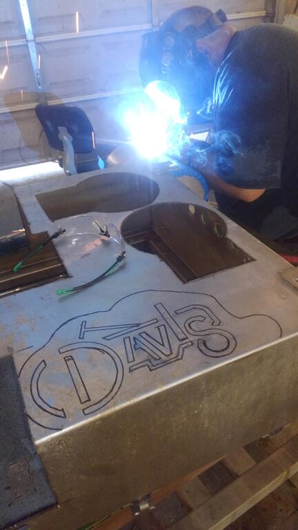

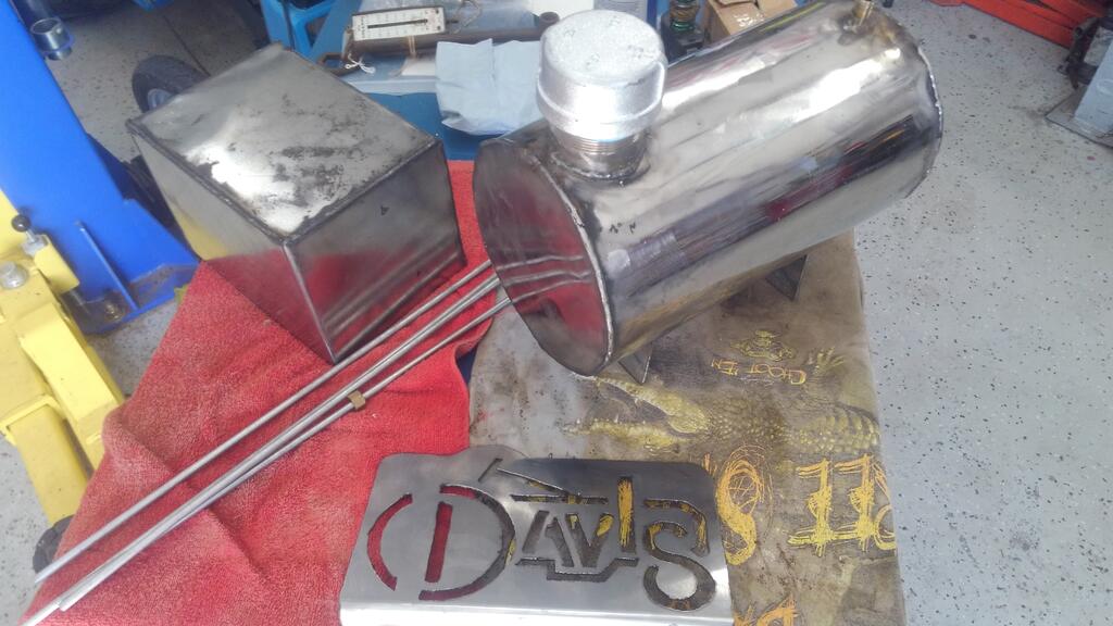

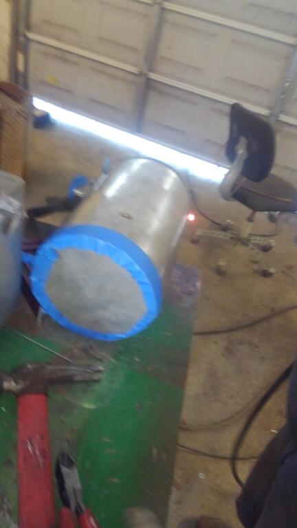

Redneckdavis 308 #5941 Posted August 1, 2020 Built my gas tank. And batt box. Well. I helped. My welder buddy did the welding and he cut the logo. I plasma, drew it out and tacked. Idk about logo, but tank and box going on pulling horse. Yes I know the fuel cap is dog ugly. But it'll work. Also the stainless AC duct he had was a little larger that imagined at 7". Well see what it looks like on the tractor 7 1 Share this post Link to post Share on other sites

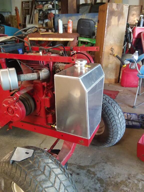

Foley Horses 10 #5942 Posted August 2, 2020 Custom aluminum fuel tank for my Gt 14. He's made a limited run of 3. 3 5 2 Share this post Link to post Share on other sites

AMC RULES 37,260 #5944 Posted August 2, 2020 Started my process of replicating patina on the 854's tins yesterday. Trying to be patient at this point... ...just waiting for them to cure before I start the color sanding process. Pretty pleased with my results so far. 5 1 Share this post Link to post Share on other sites
19richie66 17,950 #5945 Posted August 2, 2020 (edited) 3 hours ago, Foley Horses said: Custom aluminum fuel tank for my Gt 14. He's made a limited run of 3. Actually that is number 8 and we just finished number 9, the last one. Looks good in there! Edited August 2, 2020 by 19richie66 6 2 Share this post Link to post Share on other sites

peter lena 10,111 #5949 Posted August 2, 2020 AMC RULES, just have to ask , what do you use for lubrication on that gear drive spindle ? Share this post Link to post Share on other sites
