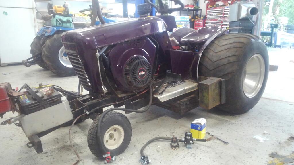

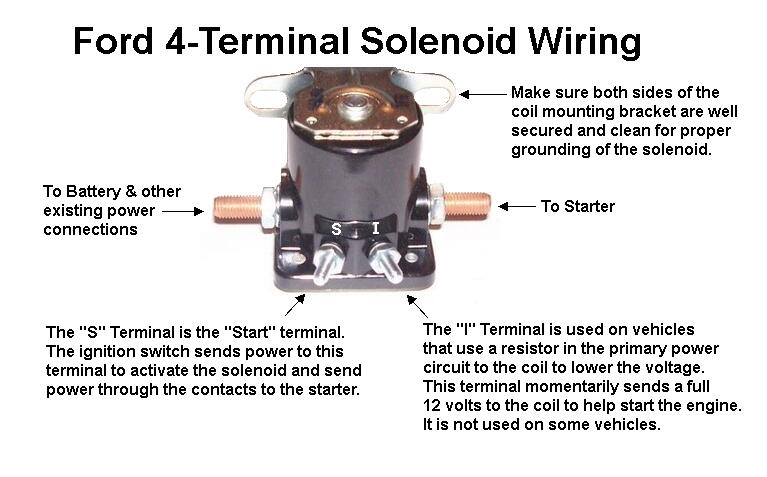

Redneckdavis 308 #5852 Posted July 23, 2020 Changing solenoid again, back to my 8N Ford spare, it works the new one doesn't. And maybe put on my new lifetime ground cable. I had welding lead laying around 4 3 1 Share this post Link to post Share on other sites

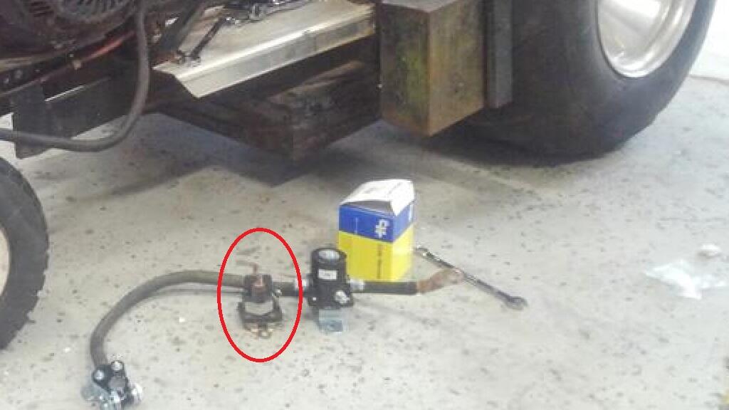

Redneckdavis 308 #5853 Posted July 24, 2020 Nope. There appears to be no way to make a 4 wire solenoid work, and the 8n solenoid is too big to mount conveniently. . Got the battery cable in and brainstormed a new bumper/ batt mount/ fuel tank. Share this post Link to post Share on other sites
ebinmaine 81,160 #5854 Posted July 24, 2020 6 hours ago, Redneckdavis said: There appears to be no way to make a 4 wire solenoid work @pfrederi or @953 nut was it one of you folks that told me a 4 wire can be done? Share this post Link to post Share on other sites
Racinbob 13,286 #5855 Posted July 24, 2020 13 hours ago, ebinmaine said: As far as checking the level if it doesn't have a dipstick... No leaks, no problem. Exactly. I always open them up for inspection when I first get them and they get new seals, boot and a gasket I put the 1.5-2 quarts in and I'm good to go for a long time. It's not going to get used up. 13 hours ago, ebinmaine said: I don't know the technical reason for having the extra half quart in an 8-speed when it does not have LSD but I always figured it was something to do with the high low shifter and as stated above, a little extra oil is certainly not going to hurt anything and a gear drive transmission. I've pondered that too. Technically, the 6 and 8 speeds have more parts inside to displace the oil and raise the level meaning that, given the same amount of oil would sit at a higher level than a 3 or 4 speed. But then again, most of those extra parts don't sit in the oil at a stand still. Given the fact that so many of these tough transmission have survived living in a water sludge mix for years just knowing it's clean inside and it's being lubed properly is good enough for me to basically ignore them after that. 3 Share this post Link to post Share on other sites
19richie66 17,950 #5856 Posted July 24, 2020 Four wire usually is large posts are the battery to starter cables, one small wire from switch to solenoid for “start”, other small post to ground 2 hours ago, ebinmaine said: @pfrederi or @953 nut was it one of you folks that told me a 4 wire can be done? 1 1 Share this post Link to post Share on other sites
Racinbob 13,286 #5857 Posted July 24, 2020 A 4 wire solenoid will work just fine. Just ignore the small terminal tagged 'I' and wire up as Richie said. 2 Share this post Link to post Share on other sites
953 nut 70,382 #5858 Posted July 24, 2020 9 hours ago, Redneckdavis said: Nope. There appears to be no way to make a 4 wire solenoid work, and the 8n solenoid is too big to mount conveniently. . Got the battery cable in and brainstormed a new bumper/ batt mount/ fuel tank. One of the small terminals on the 4 wire solenoid needs to be grounded. 4 2 Share this post Link to post Share on other sites
Racinbob 13,286 #5859 Posted July 24, 2020 Good point Richard but I was under the impression he's trying to use a Ford style solenoid. @Redneckdavis make sure you verify what type you're using. Either will work but the Ford style gets it's ground via the mounting bracket. If you're using the Ford type DO NOT ground the 'I' terminal. Just make sure the bracket is well grounded. If you're using the type 953 nut posted the small terminals feed the coil and one of them WILL need to be grounded. 3 1 Share this post Link to post Share on other sites
Redneckdavis 308 #5860 Posted July 24, 2020 3 hours ago, 19richie66 said: Four wire usually is large posts are the battery to starter cables, one small wire from switch to solenoid for “start”, other small post to ground Thanks guys. I'll try to ground one. As far as markings,it has none. And for what kind, I just hit the Napa and told them I needed a lawnmower solenoid. I did get my ground wire changed out Share this post Link to post Share on other sites
ebinmaine 81,160 #5861 Posted July 24, 2020 6 minutes ago, Redneckdavis said: . And for what kind, I just hit the Napa and told them I needed a lawnmower solenoid I've worked in Auto Parts in the past but mostly at dealerships which is a completely different world from wholesale or retail stores like Napa. @squonk Mike has quite a bit of experience at Napa in his past. He still has a lot of the knowledge and helps us out with numbers of things when we need them. The computer systems in today's parts stores are very close to idiot-proof. Unfortunately, they are also very dependent on putting the correct information in by someone who may or may not have experience in lawn mower repair. For most of these older Wheelhorses you can tell them you want a 3 post solenoid from a 75 f150 straight 6. 2 Share this post Link to post Share on other sites
squonk 48,346 #5862 Posted July 24, 2020 9 minutes ago, ebinmaine said: I've worked in Auto Parts in the past but mostly at dealerships which is a completely different world from wholesale or retail stores like Napa. @squonk Mike has quite a bit of experience at Napa in his past. He still has a lot of the knowledge and helps us out with numbers of things when we need them. The computer systems in today's parts stores are very close to idiot-proof. Unfortunately, they are also very dependent on putting the correct information in by someone who may or may not have experience in lawn mower repair. For most of these older Wheelhorses you can tell them you want a 3 post solenoid from a 75 f150 straight 6. Idiot proof. Until you get an idiot punching the keys. Go back to Napa and ask for a ST82SB 4 Share this post Link to post Share on other sites

pfrederi 21,314 #5864 Posted July 24, 2020 Lowes and HD have Arnold and/or MTD solenoid that will work just fine. 2 Share this post Link to post Share on other sites
Redneckdavis 308 #5865 Posted July 24, 2020 1 hour ago, ebinmaine said: . @squonk tell them you want a 3 post solenoid from a 75 f150 straight 6. Interesting choice. My walk around the yard I only found my 8n with a 3wire. My 960 tractor, 78 f100, 79 bronco, 67 f100 and my 72 firetruck all 4 wire. But as far as ordering correctly, my horse is nowhere near stock. Either way you can't beat putting the old part on the counter. . If you have it. I am going to try grounding that extra terminal. 4 wire solenoid, challenge accepted 3 Share this post Link to post Share on other sites

953 nut 70,382 #5869 Posted July 24, 2020 9 hours ago, Racinbob said: Good point Richard but I was under the impression he's trying to use a Ford style solenoid. I was looking at the one next to the ford tractor solenoid and figured that was the four wire he was talking about. 1 1 Share this post Link to post Share on other sites
ebinmaine 81,160 #5870 Posted July 24, 2020 4 minutes ago, 953 nut said: I was looking at the one next to the ford tractor solenoid and figured that was the four wire he was talking about. I just noticed the fact that there is a Cole Hersee box in that photo. Good to see someone using quality parts. 1 Share this post Link to post Share on other sites

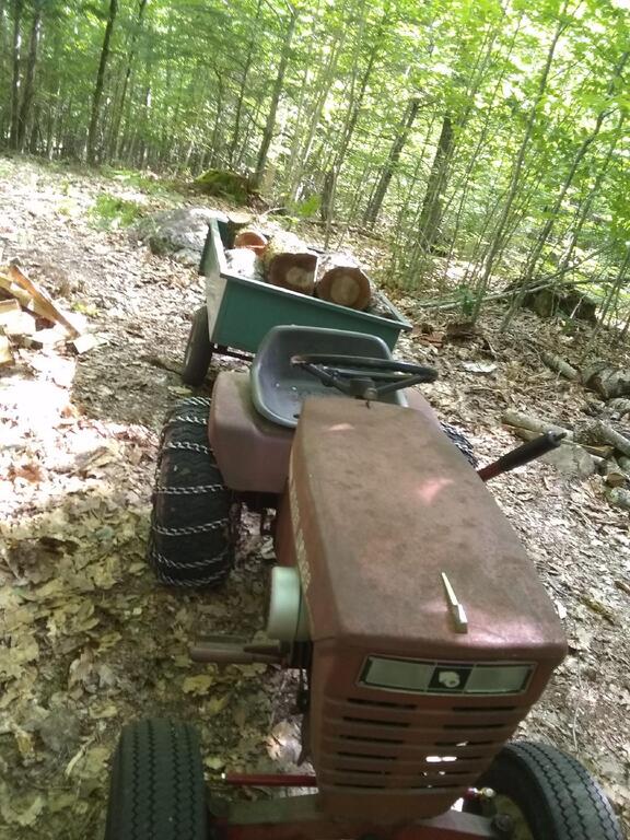

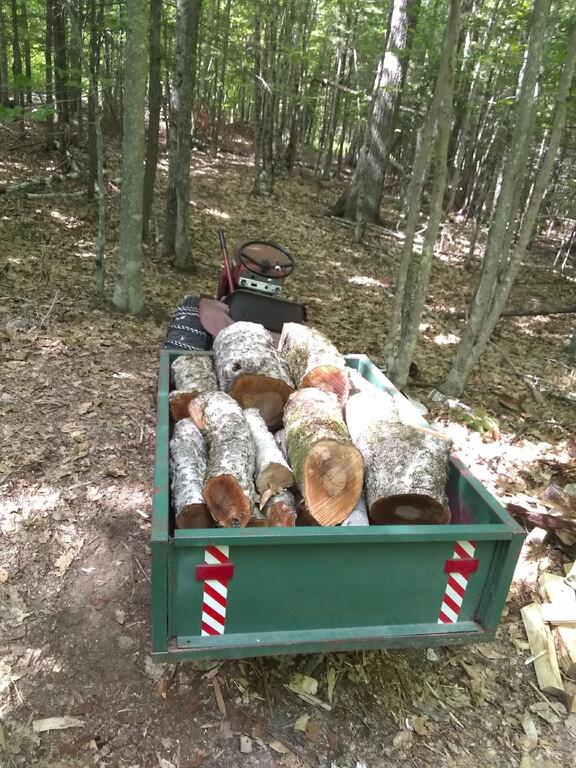

ebinmaine 81,160 #5875 Posted July 25, 2020 Trina and I played car mechanic for a bit this morning then she and her mom played in the forest for awhile. They moved a BUNCH of wood around, split some, brought it up to the yard. I got the Charger Hydro moving on its own power. 4 2 1 Share this post Link to post Share on other sites
