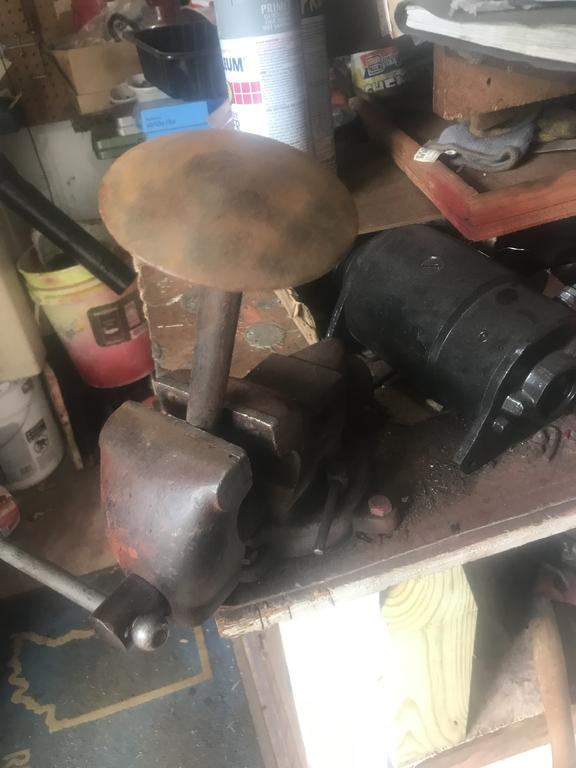

adsm08 4,606 #3301 Posted October 17, 2019 Finally got pictures. My shop is a mess right now. 5 7 Share this post Link to post Share on other sites

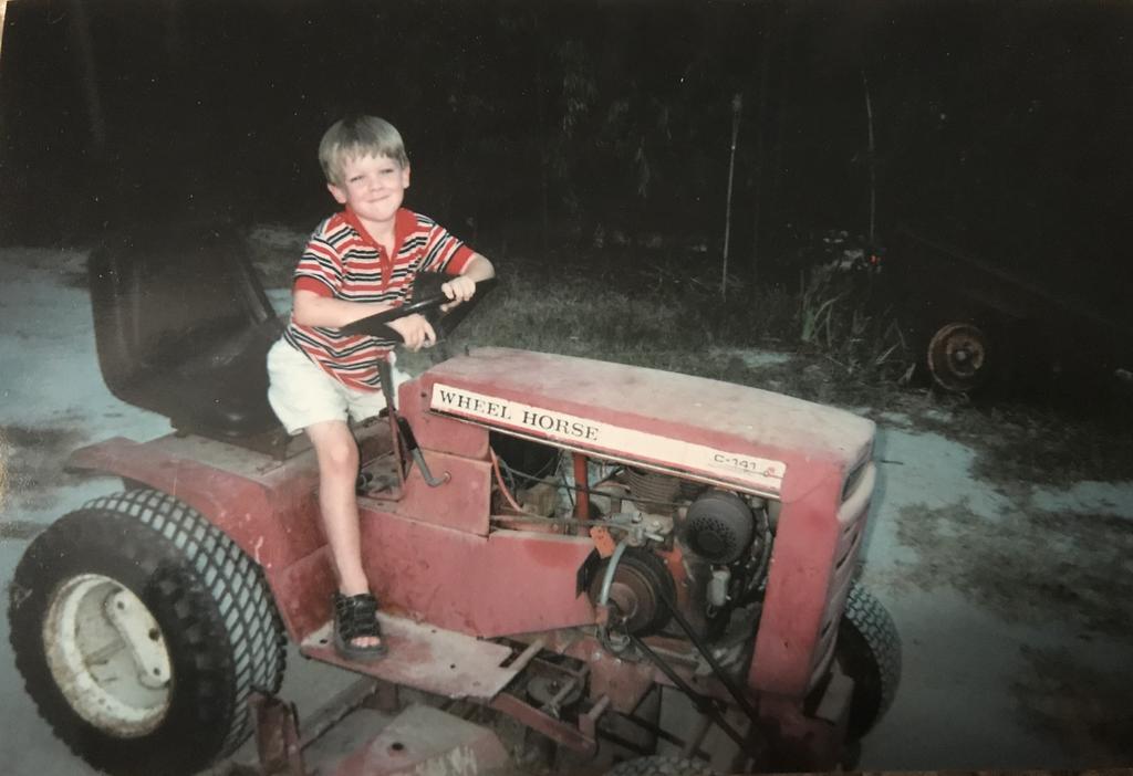

ZXT 2,402 #3302 Posted October 18, 2019 (edited) Finally got around to reworking the wiring harness on my dads C141.. This is something that's been long overdue. As long as I can remember, it's had a jumper from the battery to the coil, and he just jumped across the starter to crank it. Much of the insulation that was exposed was cracking and falling off, and the safety switches were in bad shape from battery acid. Some of it was even melted.. likely due to the fact that the ignition switch had an M on it! Probably a contribution from yours truly when I was around 10 y/o. Starts with the key now, but it doesn't charge. I'll have to see if the stator is putting out voltage. No picture of my wiring handiwork for now, but here's one we found recently of me on it, circa roughly 2004. I would've been around 7 at the time. Edited October 18, 2019 by ZXT 10 1 Share this post Link to post Share on other sites
Achto 31,929 #3303 Posted October 18, 2019 2 hours ago, adsm08 said: My shop is a mess right now. Looking better than mine does right after cleaning day. 1 1 1 1 Share this post Link to post Share on other sites

ebinmaine 79,190 #3305 Posted October 18, 2019 6 hours ago, Achto said: Looking better than mine does right after cleaning day. @adsm08 that's about what I was thinking... 3 hours ago, 8ntruck said: An EJ thread there similar to Pullstart's Hot Wheel thread sounds like a good idea. Yup yup yup yup yup yup yup yup yup yup yup yup yup We just like tractors. I happen to have a soft spot for 8N and similar too. Trina and I will be looking for a FEL in the next few months. That will be near the top of the list as a candidate for sure. It'd be really nice if I found a loader for a Farmall Super A..... 3 hours ago, 8ntruck said: thinking a late 60's or early 70's big wheel tractor is what I want. 953, 1054 or GT14. Or build-your-own like I am with Colossus. 1 1 Share this post Link to post Share on other sites

WHX?? 56,888 #3307 Posted October 18, 2019 13 hours ago, adsm08 said: My shop is a mess right now. Best I come get that 'Stang then... open up some room.... 2 Share this post Link to post Share on other sites
Ed Kennell 46,262 #3308 Posted October 18, 2019 13 hours ago, ZXT said: Finally got around to reworking the wiring harness on my dads C141.. This is something that's been long overdue. As long as I can remember, it's had a jumper from the battery to the coil, and he just jumped across the starter to crank it. Much of the insulation that was exposed was cracking and falling off, and the safety switches were in bad shape from battery acid. Some of it was even melted.. likely due to the fact that the ignition switch had an M on it! Probably a contribution from yours truly when I was around 10 y/o. Starts with the key now, but it doesn't charge. I'll have to see if the stator is putting out voltage. No picture of my wiring handiwork for now, but here's one we found recently of me on it, circa roughly 2004. I would've been around 7 at the time. Cool picture of a 7 yo from 2004. But how does a 22yo become a SENIOR member? 1 2 Share this post Link to post Share on other sites

adsm08 4,606 #3311 Posted October 19, 2019 10 hours ago, WHX24 said: Best I come get that 'Stang then... open up some room.... The day that leaves will be a happy one for me. So much the better if it does it under its own power. We were supposed to move it back to my parents' house where it belongs six months ago. Share this post Link to post Share on other sites

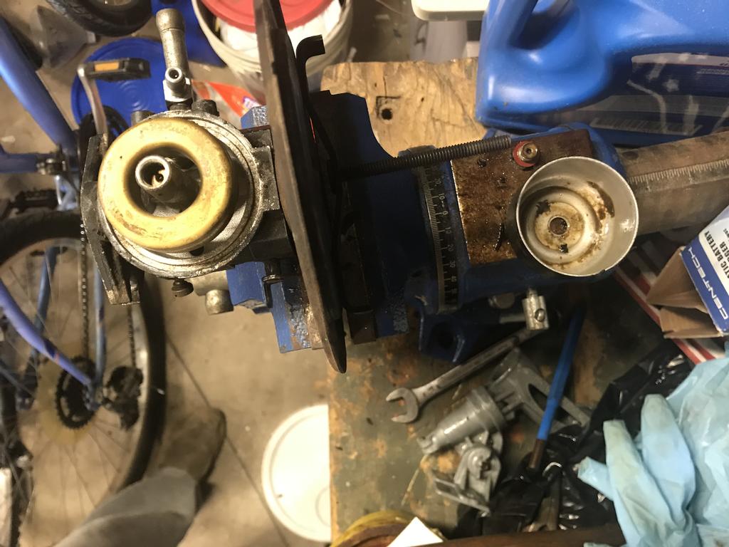

FAST 87 #3313 Posted October 19, 2019 Finally got a few minutes to pull the carb on the c161 hydro I bought last week. New fuel line will be here tomorrow. As you can see the carb is pretty dirty. Going to clean it all up really well and throw the bushings in just to get rid of the small slop in the throttle butterfly rod. 2 Share this post Link to post Share on other sites

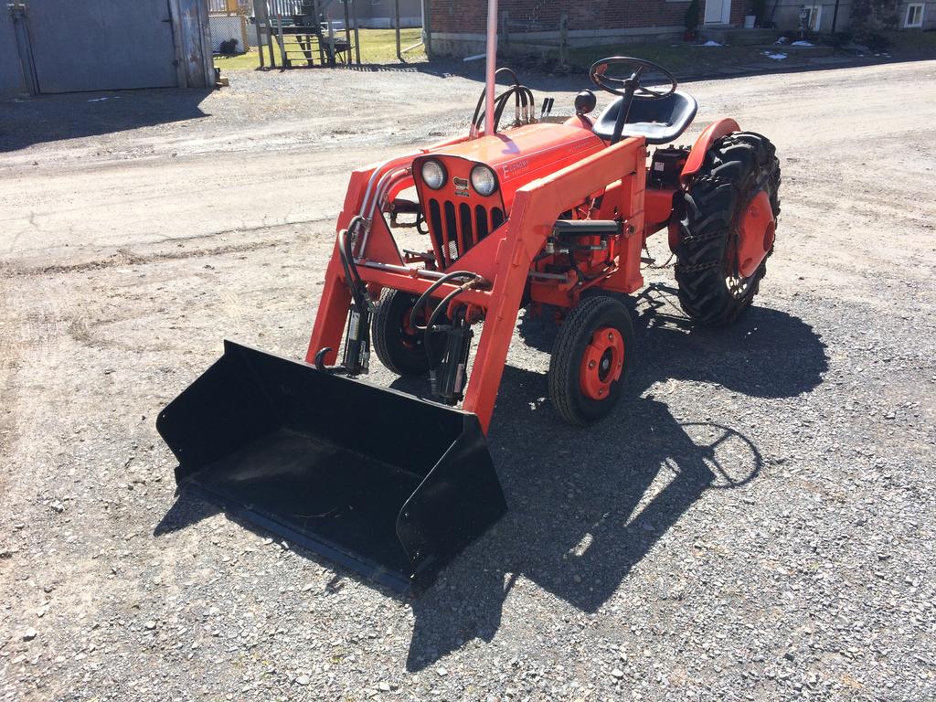

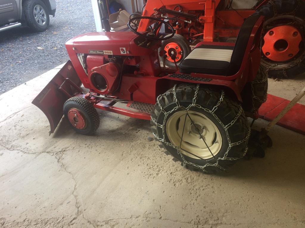

squonk 46,918 #3314 Posted October 19, 2019 @Ed Kennell Got the chains on Big Oly! 3 3 Share this post Link to post Share on other sites
FAST 87 #3315 Posted October 19, 2019 5 minutes ago, squonk said: @Ed Kennell Got the chains on Big Oly! Is that a wheelhorse in the background with the FEL? Nice tractor in the foreground also btw. Never seen one of those before. Share this post Link to post Share on other sites
squonk 46,918 #3316 Posted October 19, 2019 52 minutes ago, FAST said: Is that a wheelhorse in the background with the FEL? Nice tractor in the foreground also btw. Never seen one of those before. 77 Economy Power King 2414 with home made FEL 2 2 1 Share this post Link to post Share on other sites

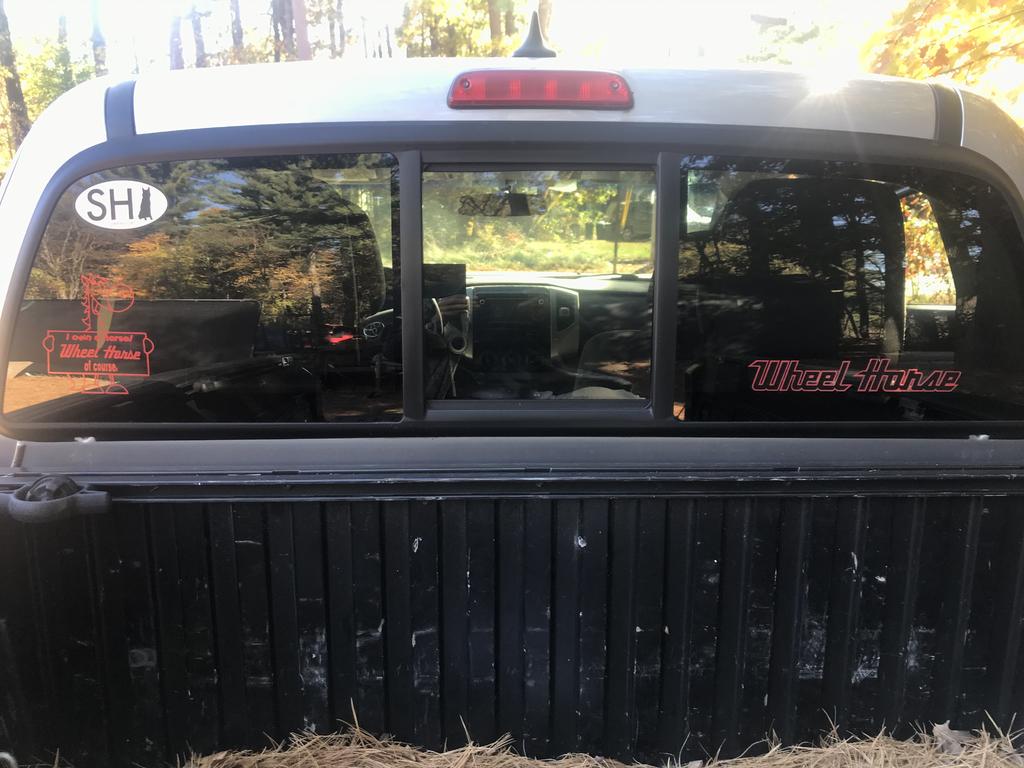

Super-C 4 me 612 #3317 Posted October 19, 2019 I didn’t do anything to my Wheelhorses But I did Wheelhorse my truck again (new back window) 3 2 1 1 Share this post Link to post Share on other sites
19richie66 17,893 #3318 Posted October 19, 2019 I like that. I’ll have to find me one 1 Share this post Link to post Share on other sites

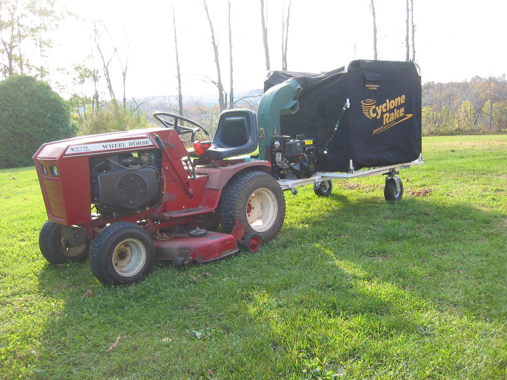

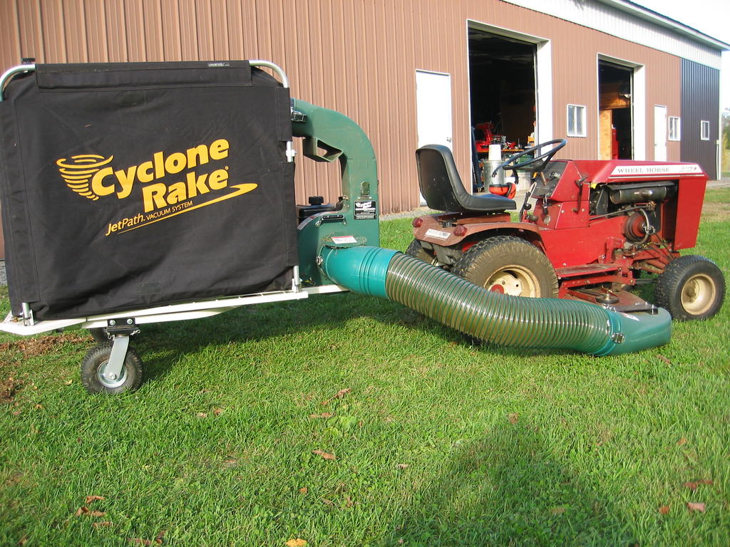

pfrederi 20,698 #3319 Posted October 19, 2019 Hooked up the Cyclone and went leaf hunting with the C175-8. Grass was still tall and green got about 50%grass and leaf mix. It is a heavy thing when full of grass It pushes the 1-75 around a bit. Biggest disadvantage it is a noisy beast. 7 1 Share this post Link to post Share on other sites
Tractorhead 9,217 #3320 Posted October 19, 2019 Oh whow, what a Monster... 😳 Share this post Link to post Share on other sites

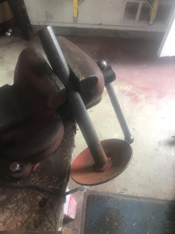

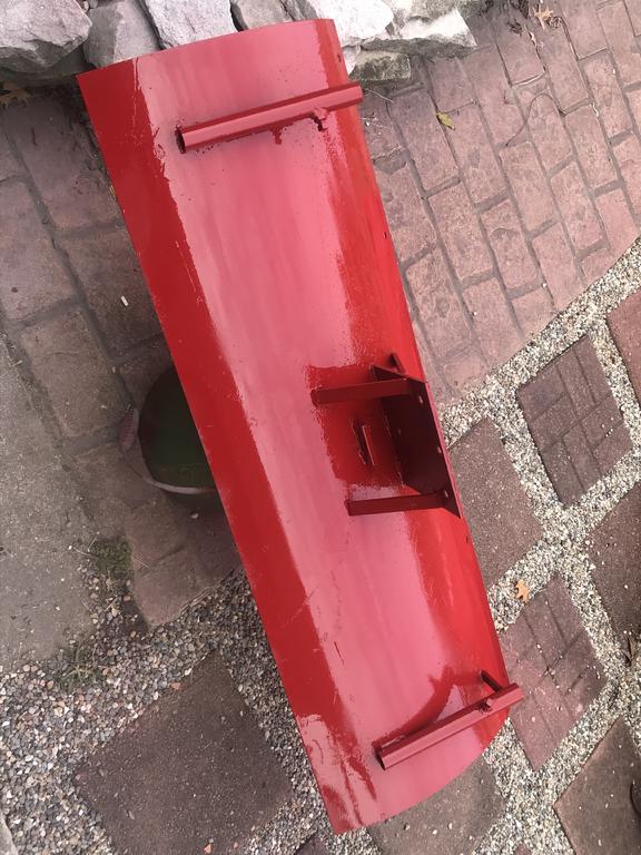

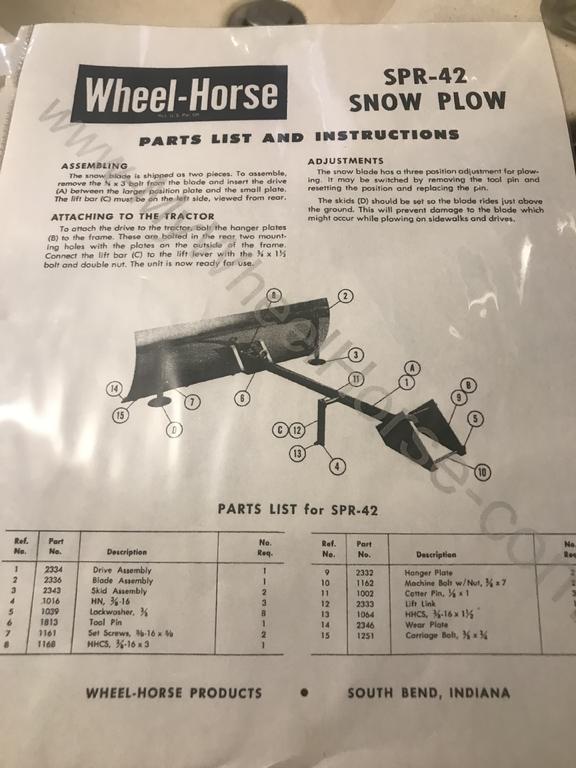

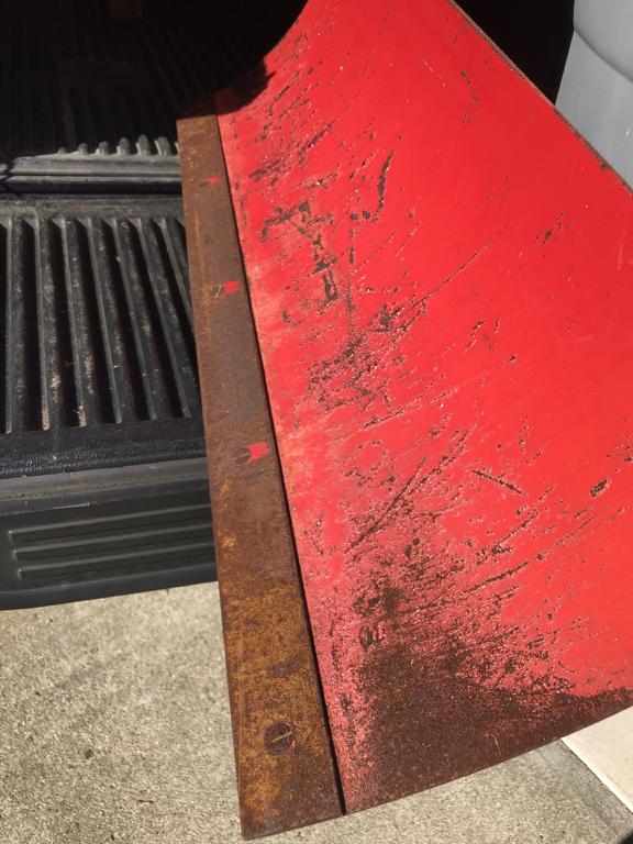

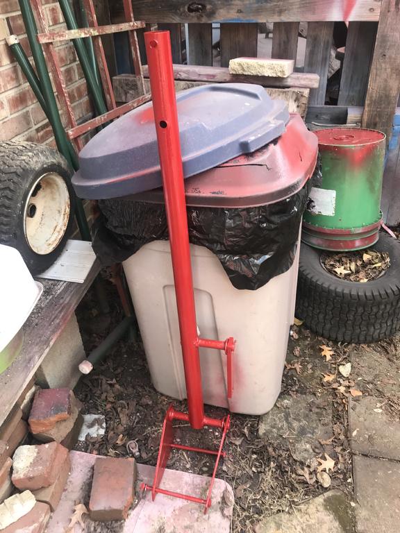

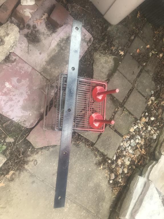

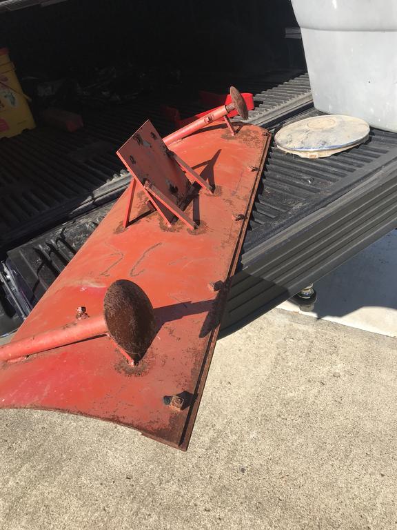

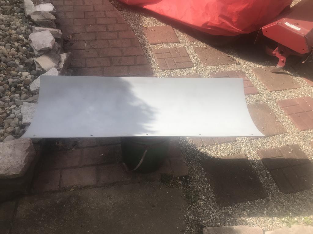

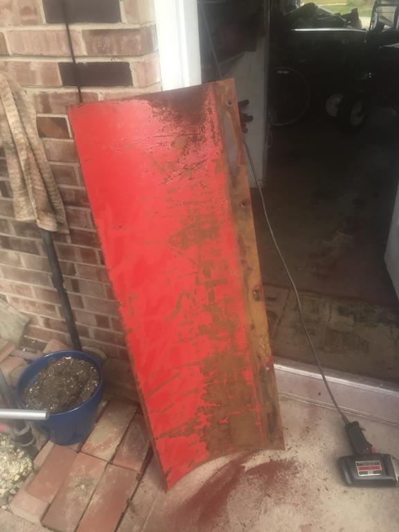

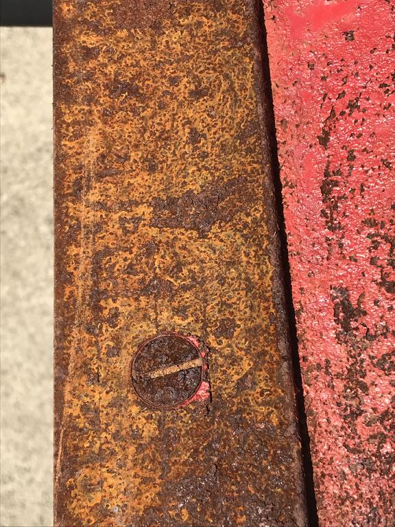

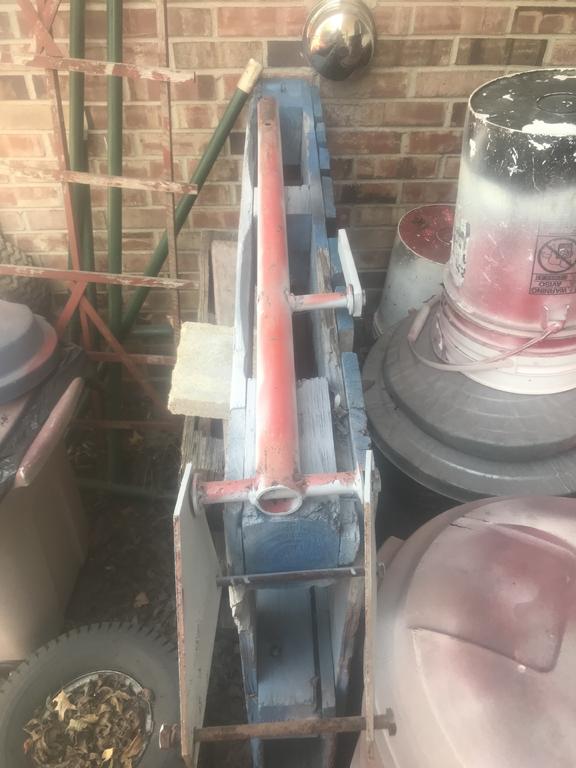

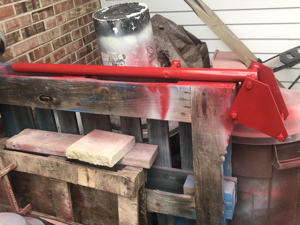

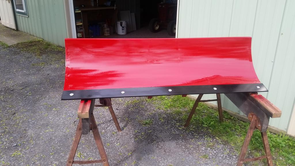

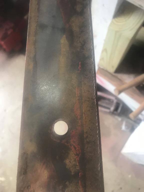

Lane Ranger 11,983 #3321 Posted October 19, 2019 (edited) Picked up an RJ snowplow/ dozer blade yesterday that I was going to keep as it was without redoing! However, this morning when I looked at it again I decided to repaint it an put some new bolts on it! I have another one I use so I decided to put this on one of my other two RJ’s! This Plow had a new wear blade which included plow bolt type machine screws on the wearblade! Easier to make round holes than square ones for carriage bolts. paint is drying now and I will reassemble in the am! Edited October 20, 2019 by Lane Ranger 5 1 1 Share this post Link to post Share on other sites
FAST 87 #3322 Posted October 19, 2019 Looking really nice @Lane Ranger 1 Share this post Link to post Share on other sites

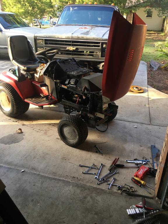

19richie66 17,893 #3323 Posted October 19, 2019 (edited) Pulled the engine in the 522Xi this afternoon. Good thing too. I needed to replace the coils but all four engine mount bolts were loose, oil drain fitting barely in the tube,filthy nasty inside on the front cover/fins. Going to get a good cleaning tomorrow and then start reassembly. While it’s down I’ll disconnect the “not so smart steer”. What a pain backing up something. Edited October 19, 2019 by 19richie66 2 2 1 Share this post Link to post Share on other sites
Herder 2,356 #3324 Posted October 19, 2019 5 hours ago, squonk said: @Ed Kennell Got the chains on Big Oly! I like the rear tires, what make and size are they? Share this post Link to post Share on other sites

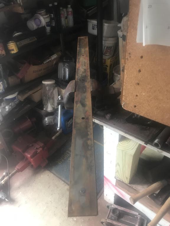

rjg854 13,096 #3325 Posted October 20, 2019 3 hours ago, Lane Ranger said: This Plow had a new wear blade which included plow bolt type machine screws on the wearblade! Easier to make round holes than square ones for carriage bolts. Really not that hard. I replaced the wear bar on a 48" dozer blade, and after drilling the holes I used a small right angle file to square the holes. It doesn't take but a few minutes do all the holes. 2 2 Share this post Link to post Share on other sites
