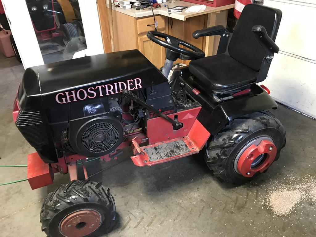

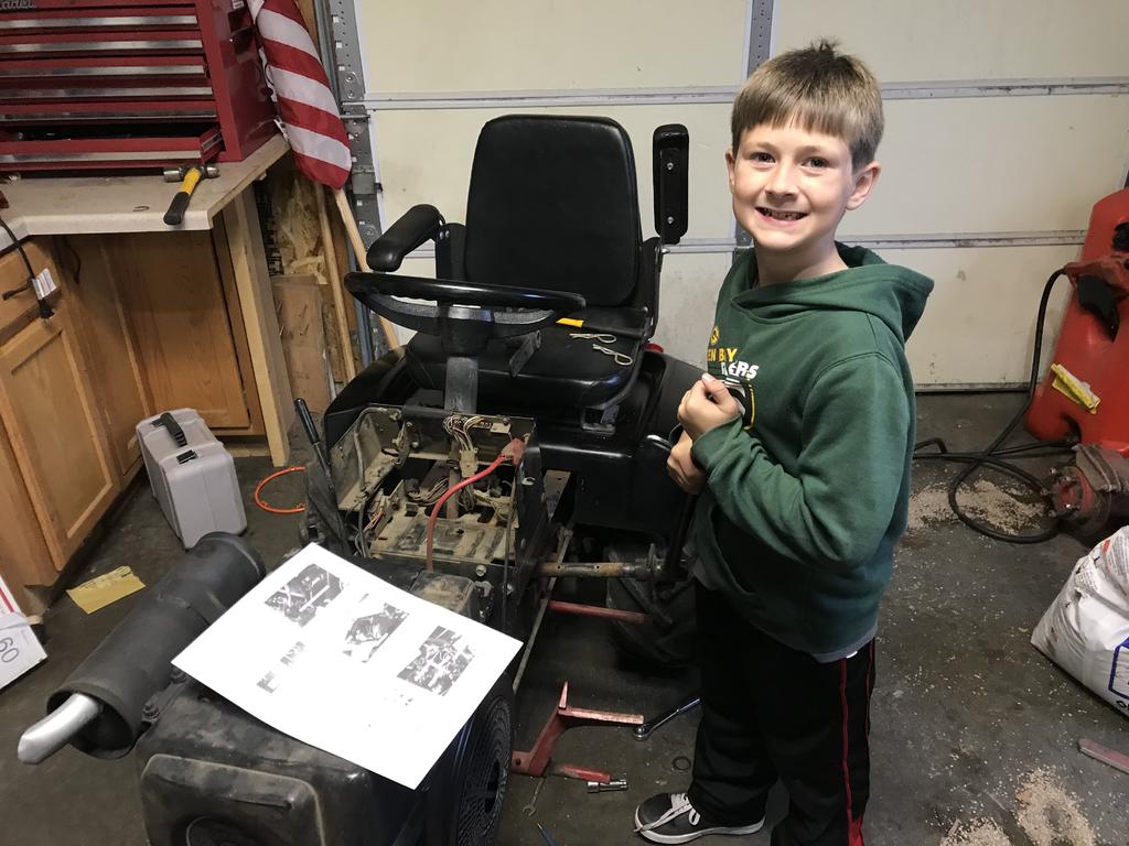

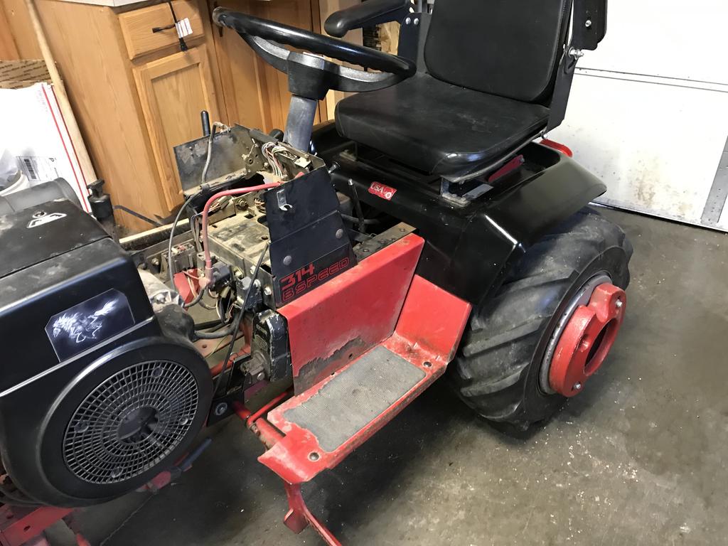

squonk 48,215 #3181 Posted October 6, 2019 2 hours ago, PeacemakerJack said: The day has finally come!!!! GhostRider is getting electric lift for plow duty. We will finally see how tough the Warner brand electric lift units really are. Can they handle the stress of the Punisher? The boys worked with me for a couple of hours to make the change... before... Zach removing the floor boards. @squonk check out the sweatshirts the boys are wearing! Thought of you while posting...)” Judge getting rid of the arm strong lift! not finished yet but coming together. Full write up later in the GhostRider thread for those that care to check it out. Better not get any grease on those shirts. That's what Vikings gear is for. 1 2 Share this post Link to post Share on other sites

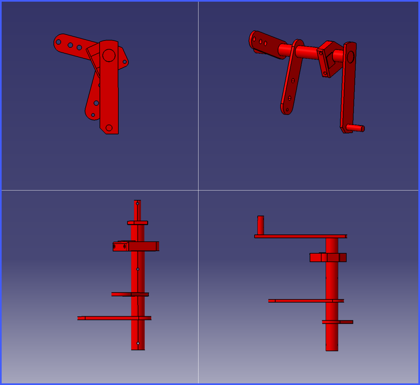

DBlackston 333 #3182 Posted October 6, 2019 Doesn't look like much yet but I went and bought material for the HY-2 Rock Shaft I need to build. Picked up the material for a set of dual wheel adapters at the same time!! 5 Share this post Link to post Share on other sites
953 nut 69,806 #3183 Posted October 6, 2019 2 minutes ago, DBlackston said: bought material for the HY-2 Rock Shaft I need to build. Picked up the material for a set of dual wheel adapters at the same time! Please do threads with pictures on these two projects so others can follow along. 1 2 Share this post Link to post Share on other sites
DBlackston 333 #3184 Posted October 6, 2019 (edited) 19 minutes ago, 953 nut said: Please do threads with pictures on these two projects so others can follow along. 953, I planned on doing just that. I work pretty slow though so I wanted to wait until everything was complete and then post it all at once. When I post the HY-2 Rockshaft build I plan on posting drawings for every part except the pump and cylinder itself. It seems every time I see a post about one someone is missing a bracket or a pulley etc. So since I now have a complete one, minus a rockshaft. ( I have a later model shaft where the cylinder mounts to the foot rest area) I plan om helping everyone else out. Edited October 6, 2019 by DBlackston 3 1 3 Share this post Link to post Share on other sites
TonyToro 1,190 #3185 Posted October 6, 2019 13 hours ago, PeacemakerJack said: The day has finally come!!!! GhostRider is getting electric lift for plow duty. We will finally see how tough the Warner brand electric lift units really are. Can they handle the stress of the Punisher? The boys worked with me for a couple of hours to make the change... before... Zach removing the floor boards. @squonk check out the sweatshirts the boys are wearing! Thought of you while posting...)” Judge getting rid of the arm strong lift! not finished yet but coming together. Full write up later in the GhostRider thread for those that care to check it out. I need to see your progress and finished product. I need to do the same for an old Sears my son wants to use. its great your boys are into the tractors. So awesome to see! 1 Share this post Link to post Share on other sites
adsm08 5,195 #3186 Posted October 6, 2019 10 hours ago, DBlackston said: 953, I planned on doing just that. I work pretty slow though so I wanted to wait until everything was complete and then post it all at once. When I post the HY-2 Rockshaft build I plan on posting drawings for every part except the pump and cylinder itself. It seems every time I see a post about one someone is missing a bracket or a pulley etc. So since I now have a complete one, minus a rockshaft. ( I have a later model shaft where the cylinder mounts to the foot rest area) I plan om helping everyone else out. Too bad you are so far away. I have a complete functioning early assembly of the rockshaft, where the ram mounts to the axle, that I'd let you remove and copy. Unfortunately I'm using it and I don't want to be without it for an extended period of time. Share this post Link to post Share on other sites
DBlackston 333 #3187 Posted October 6, 2019 1 hour ago, adsm08 said: Too bad you are so far away. I have a complete functioning early assembly of the rockshaft, where the ram mounts to the axle, that I'd let you remove and copy. Unfortunately I'm using it and I don't want to be without it for an extended period of time. Zach Edwardson was nice enough to measure one and send a ton of photos. I also have the later style shaft that I was able to measure everything else off of. What I really want someone to have is an SR-64 idler bar to copy. Share this post Link to post Share on other sites

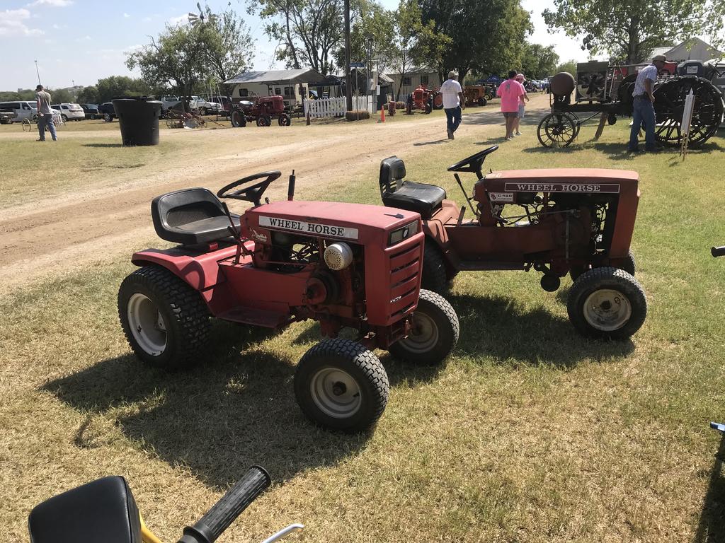

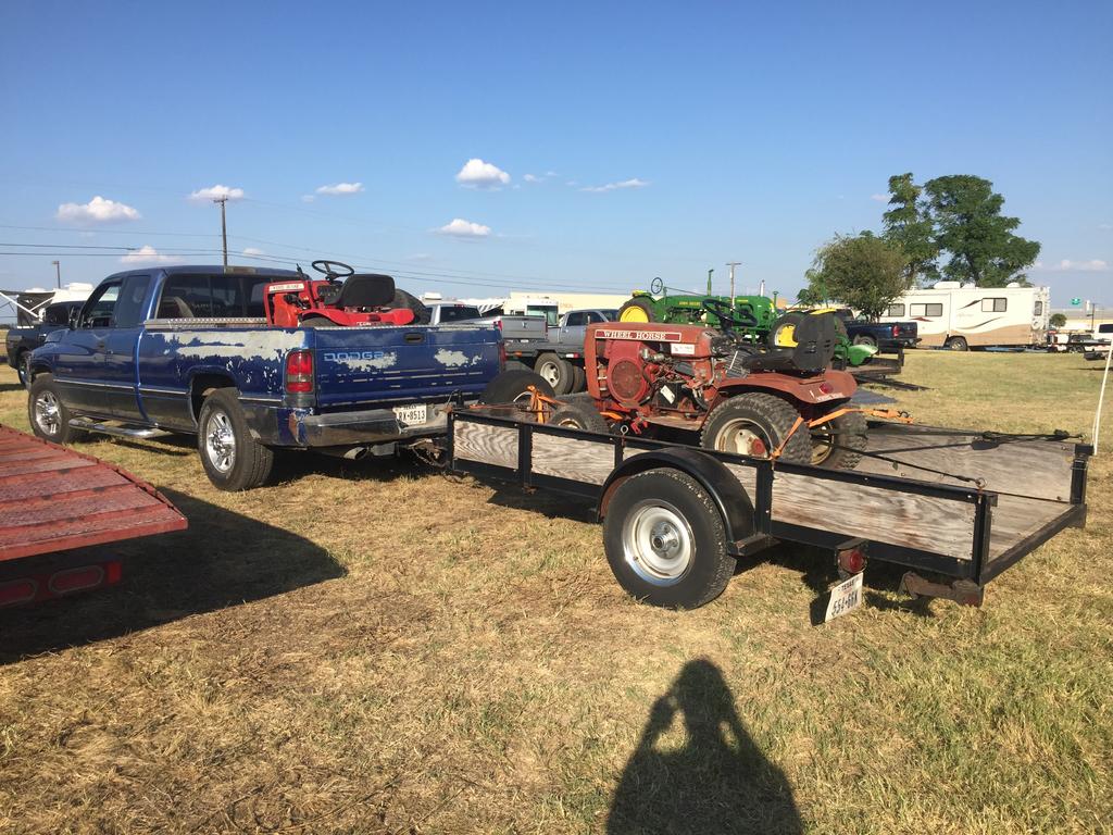

ZXT 2,402 #3191 Posted October 6, 2019 (edited) Took two of my Horses to a tractor show yesterday. I rode around on the C160 and a buddy of mine drove the C120. Got there, unloaded both of them, and the C120 wasn't charging. Cleaned the connections at the regulator and fixed that issue. Gassed them up and hopped on the C160 and it wouldn't start. No power to anything. Looked around and found a taped wire splice under the dash. Rigged it temporarily with a wire nut and we were good to go! Drove around for few hours at least and used less than 1/4 gallon of gas each. Not to shabby! This was the first time I've had any real seat time in the C160 since I bought it. One thing that I came away with from that show was that I hate the muffler on the C120. Noisy thing! You couldn't tell the C160 was running when next to it.. let alone talk to someone! Edited October 6, 2019 by ZXT 5 2 Share this post Link to post Share on other sites
adsm08 5,195 #3192 Posted October 6, 2019 44 minutes ago, ZXT said: Took two of my Horses to a tractor show yesterday. I rode around on the C160 and a buddy of mine drove the C120. Got there, unloaded both of them, and the C120 wasn't charging. Cleaned the connections at the regulator and fixed that issue. Gassed them up and hopped on the C160 and it wouldn't start. No power to anything. Looked around and found a taped wire splice under the dash. Rigged it temporarily with a wire nut and we were good to go! Drove around for few hours at least and used less than 1/4 gallon of gas each. Not to shabby! This was the first time I've had any real seat time in the C160 since I bought it. One thing that I came away with from that show was that I hate the muffler on the C120. Noisy thing! You couldn't tell the C160 was running when next to it.. let alone talk to someone! I don't care for those shower head mufflers. My 855 was super loud too when I bought it. Couple guys here suggested the Cub Cadet muffler, which goes in with minimal modification, and is noticeably quieter. All I had to do was put in a longer piece of pipe out of the head so it cleared the hood. 2 Share this post Link to post Share on other sites
ebinmaine 80,917 #3193 Posted October 6, 2019 @ZXT I'll put in another vote for the Cub muffler. That's what the stacks are on both my B and C. They can easily be turned out n down as suggested by @adsm08. 1 Share this post Link to post Share on other sites
ZXT 2,402 #3194 Posted October 6, 2019 30 minutes ago, adsm08 said: I don't care for those shower head mufflers. My 855 was super loud too when I bought it. Couple guys here suggested the Cub Cadet muffler, which goes in with minimal modification, and is noticeably quieter. All I had to do was put in a longer piece of pipe out of the head so it cleared the hood. Awesome! Thanks for the suggestion. I'll definitely look into it! Share this post Link to post Share on other sites
PeacemakerJack 11,068 #3195 Posted October 6, 2019 24 minutes ago, ebinmaine said: @ZXT I'll put in another vote for the Cub muffler. That's what the stacks are on both my B and C. They can easily be turned out n down as suggested by @adsm08. Me too! That is a Cub muffler on Zach’s tractor. It tones down an otherwise super loud 16hp single. If you must stay Wheel Horse or you have one available to you, I have also found the 300 series mufflers used with the Magnum singles to be quiet yet functional... 774E46CD-9968-48EB-8C23-04FDF8C3D3CE.MOV 3 1 Share this post Link to post Share on other sites
