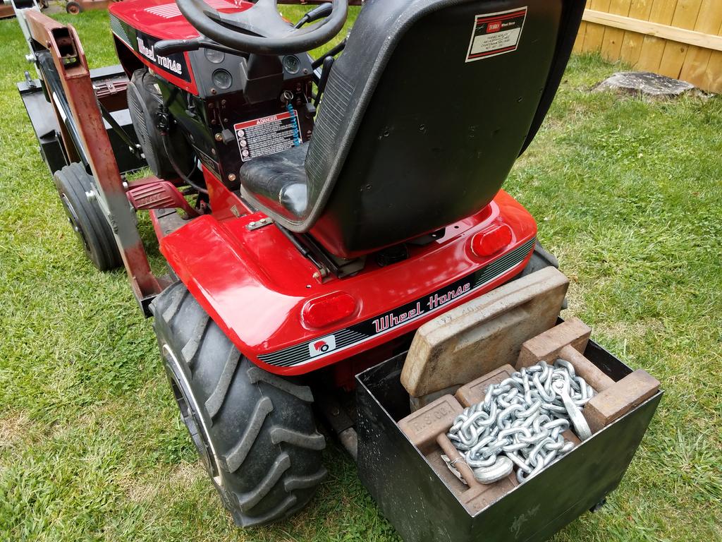

Goldnboy 1,154 #2981 Posted September 2, 2019 Today I finished my B140 project and removed my K181S and installed a K321 that @kitkit sold me in December. Had to have decals from Terry and Jims stack. Now its on to adding hydraulics... 8 1 Share this post Link to post Share on other sites

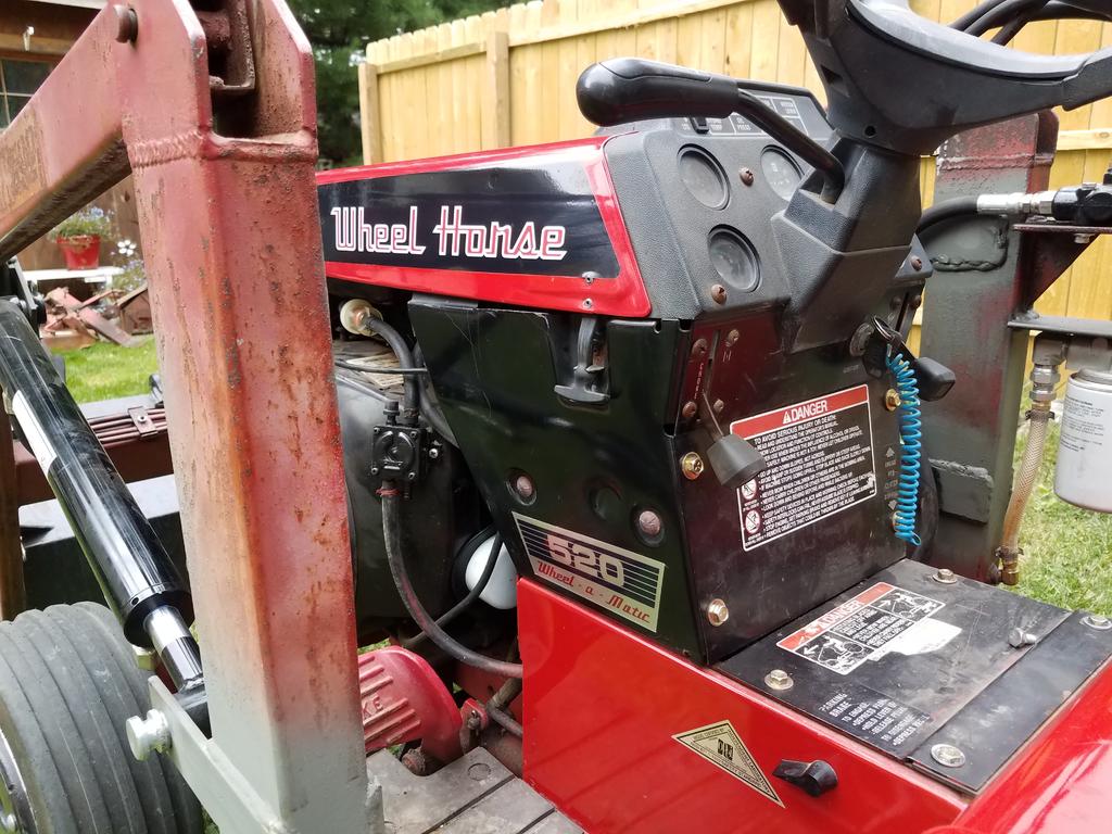

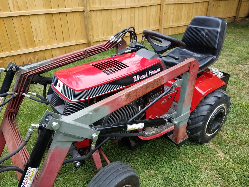

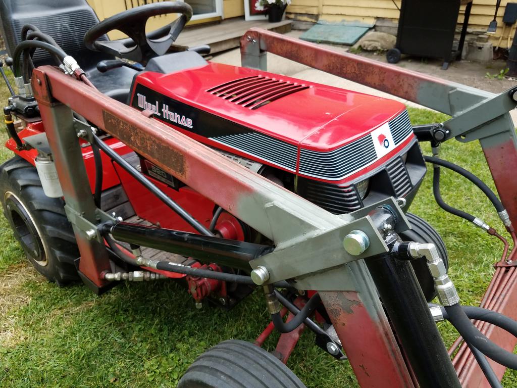

Shynon 7,723 #2984 Posted September 2, 2019 Put on a donor hood and fenders and new decals on the 520 Wheelamatic loader 5 11 Share this post Link to post Share on other sites
Achto 32,842 #2985 Posted September 2, 2019 Looks sweet Tom!! 2 2 Share this post Link to post Share on other sites

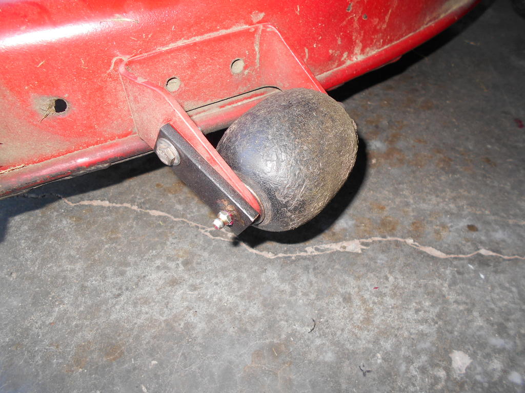

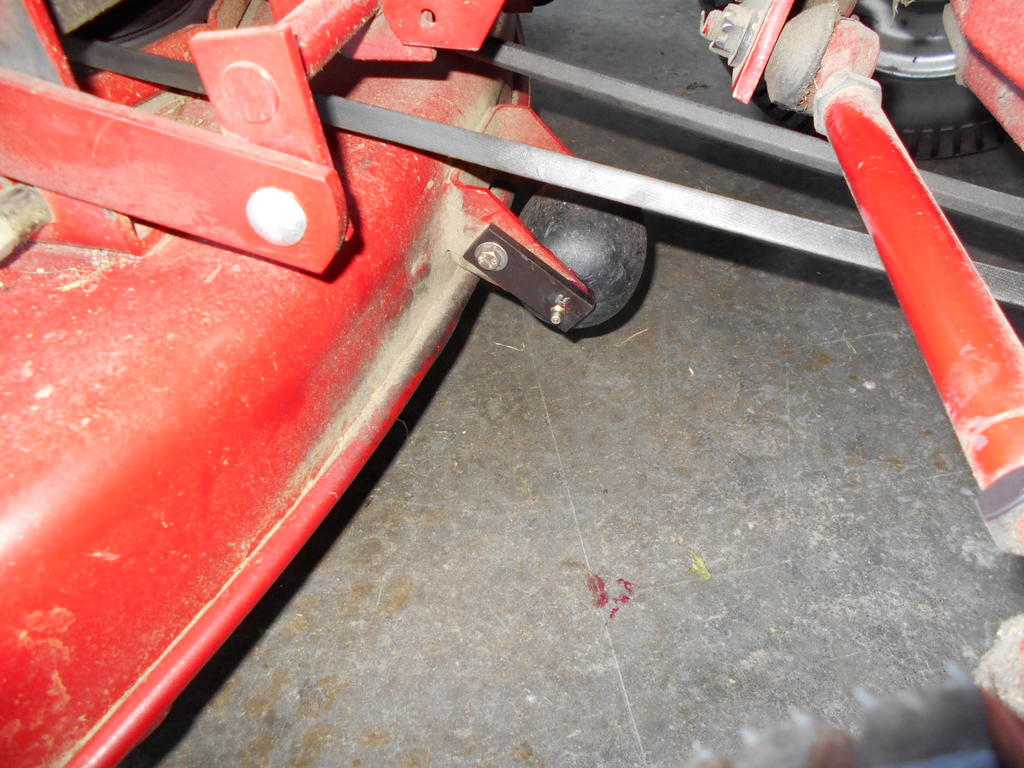

cleat 9,380 #2986 Posted September 2, 2019 On 9/1/2019 at 11:10 AM, cleat said: I pressed brass bushings into the rollers as they were worn. After a few mowings they start to squeak a bit so I drilled and tapped a roller shaft for greasing. I will install this one and see how it works before doing the rest. Cleat Well, I did all 5 and installed them. They are all greased and ready for the next mowing. Cleat 4 1 Share this post Link to post Share on other sites

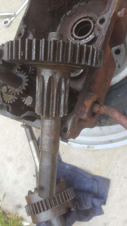

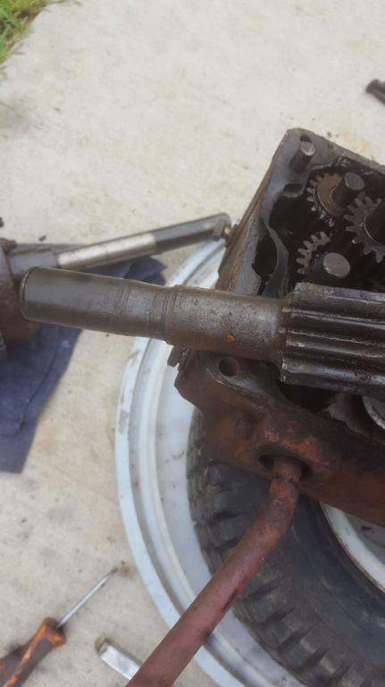

FarmboyFresh 69 #2987 Posted September 2, 2019 Got both home today.. unfortunately the old girl is in need of some serious transmission help. Any ideas for the best way to approach it? New? Rebuild? 3 Share this post Link to post Share on other sites

Tractorhead 9,217 #2989 Posted September 2, 2019 (edited) We had here at my side a company, they weld it up and later mill to original size back on a lathe. they do this for some kind of shafts til 40mm also if they hardened. they offer also to hardened again after for longer lasting. may you find at your side such company or anybody has the ability to do that. price here is less than a new Shaft and would take at this shaft about 60 - 80 US$ Edited September 2, 2019 by Tractorhead 1 1 Share this post Link to post Share on other sites
ebinmaine 80,916 #2990 Posted September 2, 2019 1 hour ago, FarmboyFresh said: @stevasaurus Or several others could chime in here. What's that out of? There's a few of us that sell used parts and like @Tractorhead says that can be fixed if you have access to a shop. 1 Share this post Link to post Share on other sites
Achto 32,842 #2991 Posted September 2, 2019 1 hour ago, FarmboyFresh said: Any ideas for the best way to approach it? New? Rebuild? Looks like you need a new/used mushroom gear for sure. As long as it is apart I would hit @wheelhorseman up for a rebuild kit.https://www.wheelhorsepartsandmore.com/about-us.html 1 Share this post Link to post Share on other sites

FarmboyFresh 69 #2993 Posted September 2, 2019 I had a welder look at it locally, he said he could do the welding. He knows a guy a town away that could machine it down. I'll see what they say too. Apparently the bearings are all pretty much shot too 1 1 Share this post Link to post Share on other sites

FarmboyFresh 69 #2995 Posted September 2, 2019 29 minutes ago, ebinmaine said: @stevasaurus Or several others could chime in here. What's that out of? There's a few of us that sell used parts and like @Tractorhead says that can be fixed if you have access to a shop. 753 Share this post Link to post Share on other sites
ebinmaine 80,916 #2996 Posted September 2, 2019 4 minutes ago, FarmboyFresh said: I had a welder look at it locally, he said he could do the welding. He knows a guy a town away that could machine it down. I'll see what they say too. Apparently the bearings are all pretty much shot too There are sources for the bearings too as well I believe. Might be best to make a full list of needed items and contact Lowell at Wheelhorse parts and more. 1 1 Share this post Link to post Share on other sites
Achto 32,842 #2997 Posted September 2, 2019 6 minutes ago, FarmboyFresh said: I had a welder look at it locally, he said he could do the welding. He knows a guy a town away that could machine it down. Just a heads up, that is a hardened surface where the bearing runs. 1 2 Share this post Link to post Share on other sites
953 nut 69,805 #2998 Posted September 2, 2019 2 hours ago, FarmboyFresh said: in need of some serious transmission help. Any ideas for the best way to approach it? You may be able to find another parts transmission to cannibalize for parts. I've done that a couple times. A low HP "roller" can be a good buy, cost less than buying the parts on . 2 Share this post Link to post Share on other sites
FarmboyFresh 69 #2999 Posted September 3, 2019 1 hour ago, 953 nut said: You may be able to find another parts transmission to cannibalize for parts. I've done that a couple times. A low HP "roller" can be a good buy, cost less than buying the parts on . Lowell is going to get me set up.! 💯 4 1 Share this post Link to post Share on other sites
