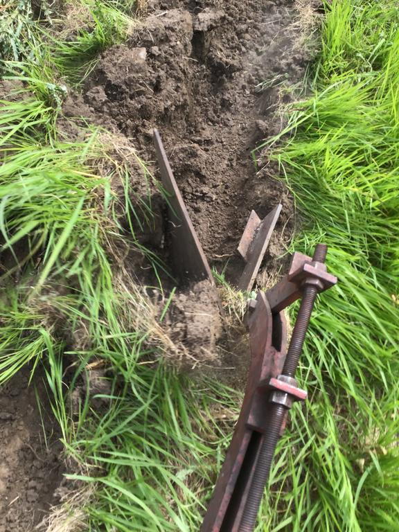

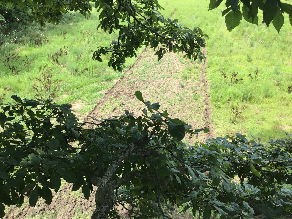

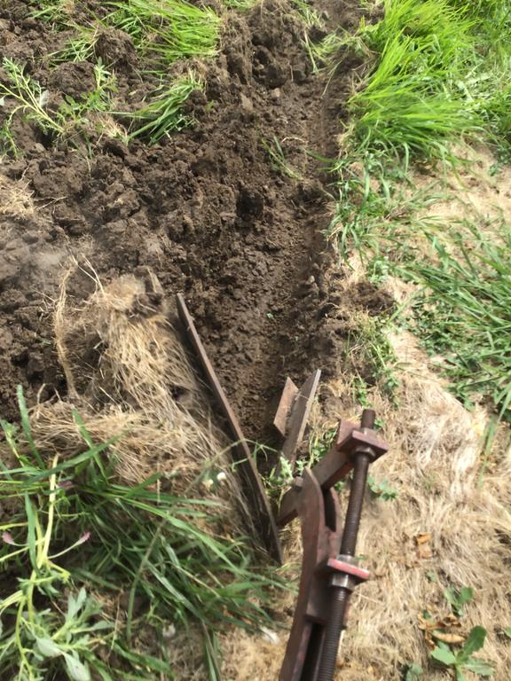

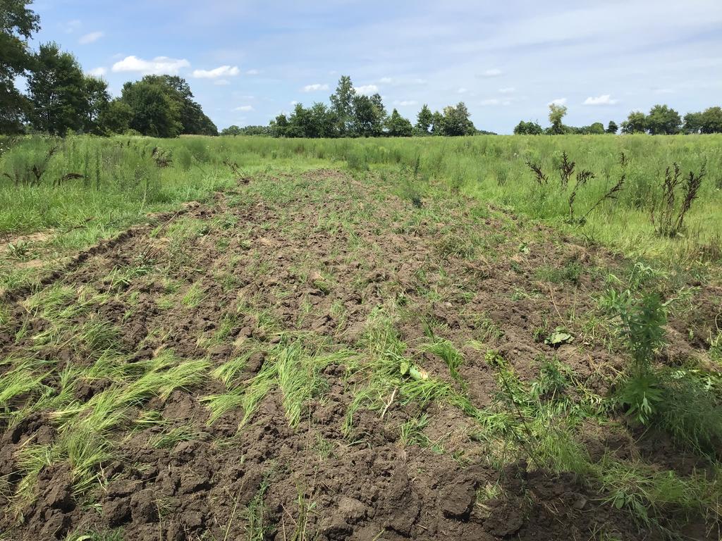

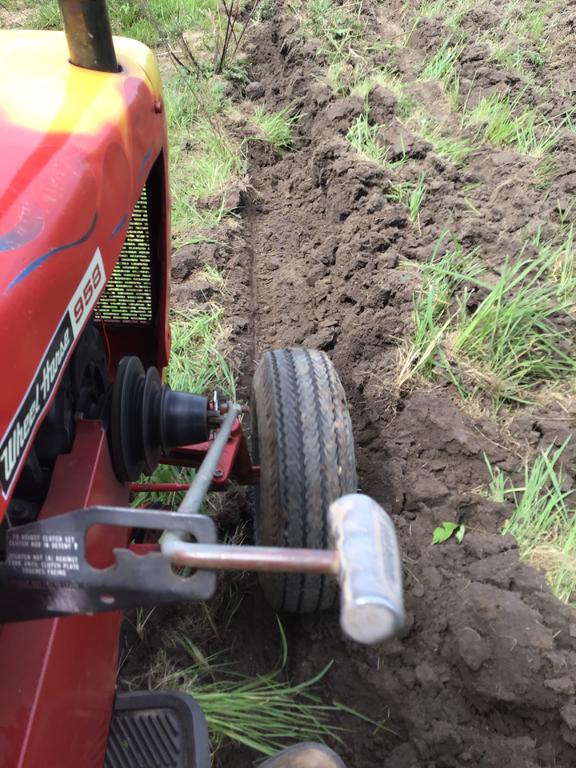

Pullstart 71,360 #2853 Posted August 11, 2019 Working *cough*playing*cough* with Hot Wheels today... trying to see if I can cut a furrow in the field... directly in front of my tree stand? 4 2 Share this post Link to post Share on other sites

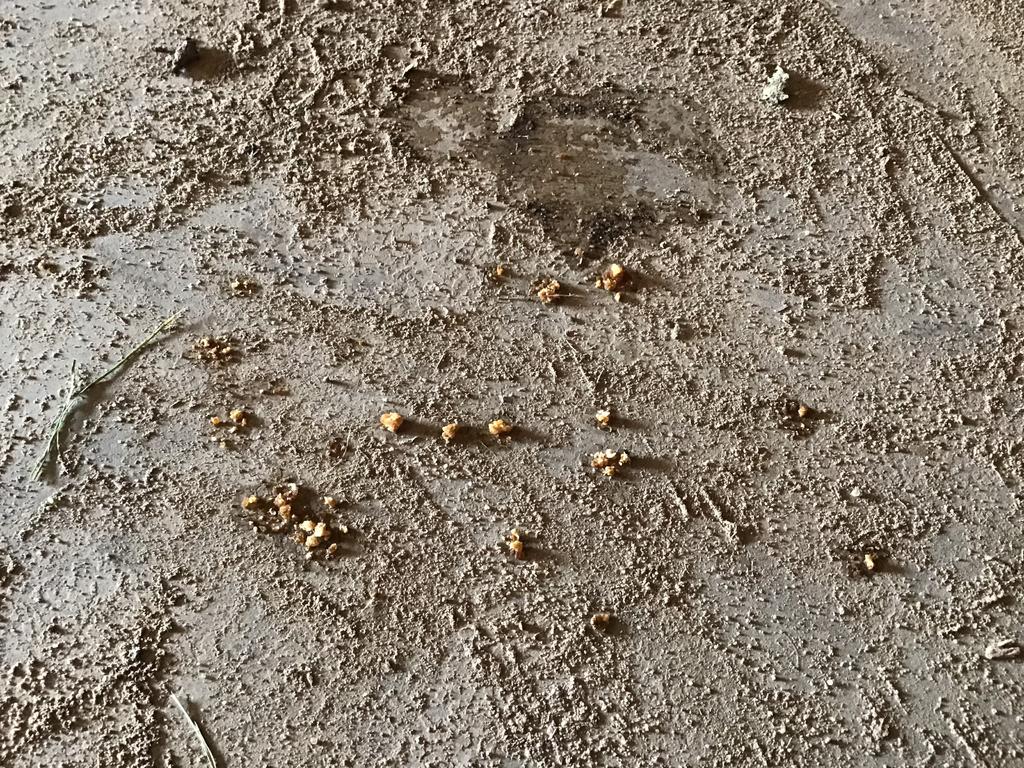

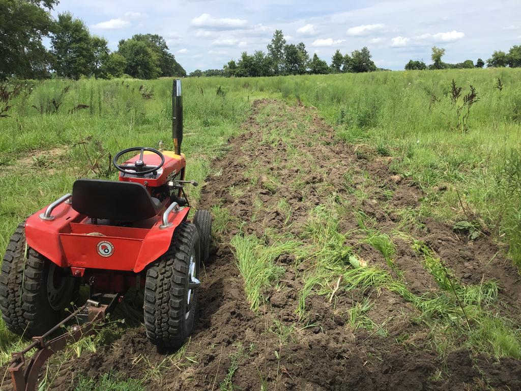

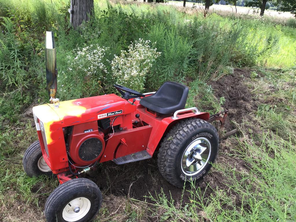

Pullstart 71,360 #2854 Posted August 11, 2019 I think I have a fuel line leak before the pump, it sounds like it’s sucking air and will only run with the choke... so I’ll limp it back to the barn for repairs. I also lost a pin in the lift link so I figured out I can drag the plow into a turn with minimal diggin... as long as I turned right. Left turn? Harder dig! It also seems I’m not the only visitor in my tree stand! 4 1 Share this post Link to post Share on other sites
953 nut 69,793 #2855 Posted August 11, 2019 Bear scat? 4 hours ago, pullstart said: fuel line leak The fuel line is about a dozen years old. 1 Share this post Link to post Share on other sites

Pullstart 71,360 #2857 Posted August 12, 2019 2 hours ago, 953 nut said: Bear scat? The fuel line is about a dozen years old. Raccoon poop I happen to have a new coil of fuel hose, maybe that’s why it needed to crank so long to fire up? 2 Share this post Link to post Share on other sites

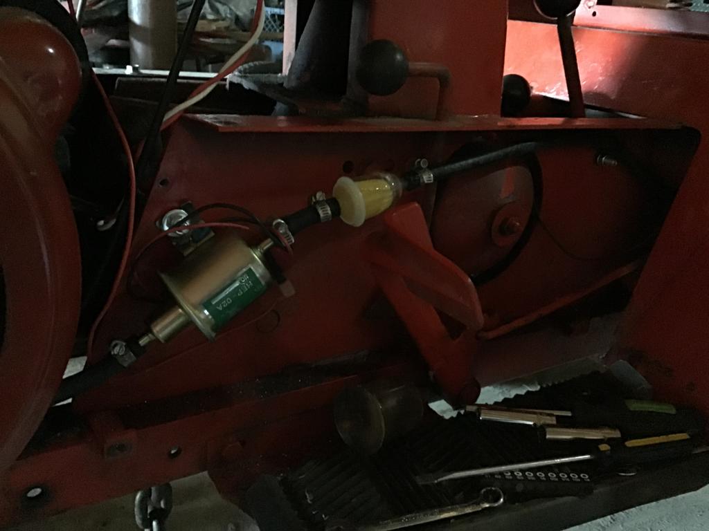

Pullstart 71,360 #2859 Posted August 13, 2019 On 8/11/2019 at 7:46 PM, 953 nut said: Bear scat? The fuel line is about a dozen years old. Well, it seems I couldn’t find fault in the fuel line on Hot Wheels. It sounded in the tunnel like the line was sucking air badly, the only thing I haven’t done was to pressurize the line. I did however find some gel in the fuel bowl, so I’m doing a system overhaul and clean out. If I secure it out of harm’s way, can you think of any reason not to run the fuel line through the brake shaft tunnel? I was thinking I could hide the fuel pump in there to tidy it up? 1 Share this post Link to post Share on other sites
19richie66 17,937 #2860 Posted August 13, 2019 Don’t see why not. Plenty of room in the tunnel. Just secure it away from the linkages. That was my plan on the wife’s. 1 1 Share this post Link to post Share on other sites
ebinmaine 80,910 #2861 Posted August 13, 2019 @pullstart Make sure it can't chafe/rub/touch/grind on anything as well. Even smooth surfaces will eventually eat through the fuel line. Share this post Link to post Share on other sites

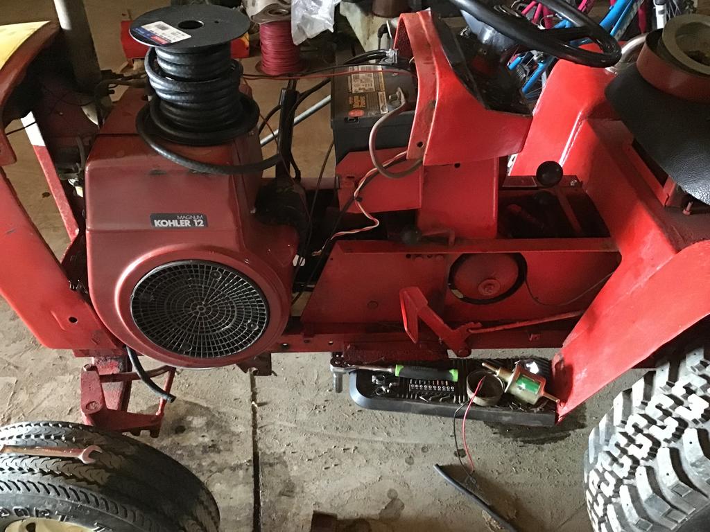

Pullstart 71,360 #2866 Posted August 14, 2019 I ran the new fuel line for Hot Wheels, found no leaks, now to tidy up the wires for the pump a bit and put it all back together! 5 Share this post Link to post Share on other sites

Guest 88vic #2868 Posted August 15, 2019 2 hours ago, pullstart said: I ran the new fuel line for Hot Wheels, found no leaks, now to tidy up the wires for the pump a bit and put it all back together! Where can I find a pump like that ???? Share this post Link to post Share on other sites
WHX?? 58,302 #2869 Posted August 15, 2019 Any auto parts store Fan. Just ask the clerk for a 12vdc low pressure fuel pump. Google the same and you'll find lots of them. Share this post Link to post Share on other sites
953 nut 69,793 #2870 Posted August 15, 2019 4 minutes ago, WHEELHORSEFAN*16 said: Where can I find a pump like that ???? https://www.ebay.com/itm/HEP-02A-New-Gas-Diesel-fuel-pump-Inline-Low-Pressure-electric-fuel-pump-12V/191558570132 1 1 Share this post Link to post Share on other sites
Pullstart 71,360 #2871 Posted August 15, 2019 8 minutes ago, WHEELHORSEFAN*16 said: Where can I find a pump like that ???? 3 minutes ago, WHX24 said: Any auto parts store Fan. Just ask the clerk for a 12vdc low pressure fuel pump. Google the same and you'll find lots of them. This pump was on the tractor when I picked it up from @953 nut at the Big Show. It was mounted under the engine, I just hid it a little bit when I ran new fuel line. 1 Share this post Link to post Share on other sites
ebinmaine 80,910 #2872 Posted August 15, 2019 5 minutes ago, 953 nut said: https://www.ebay.com/itm/HEP-02A-New-Gas-Diesel-fuel-pump-Inline-Low-Pressure-electric-fuel-pump-12V/191558570132 Thanks for that. Ordered one to try it out.... Share this post Link to post Share on other sites
Stormin 9,988 #2873 Posted August 15, 2019 Speaking of fuel lines and chaffing, running the line through a light compression spring where it may chaff helps protect it. 3 1 Share this post Link to post Share on other sites

Pullstart 71,360 #2875 Posted August 15, 2019 Speaking of fuel lines... I think I routed this in a manner that third and reverse aren’t happy.... I think I need to get the line away from the shifter! 1 Share this post Link to post Share on other sites
