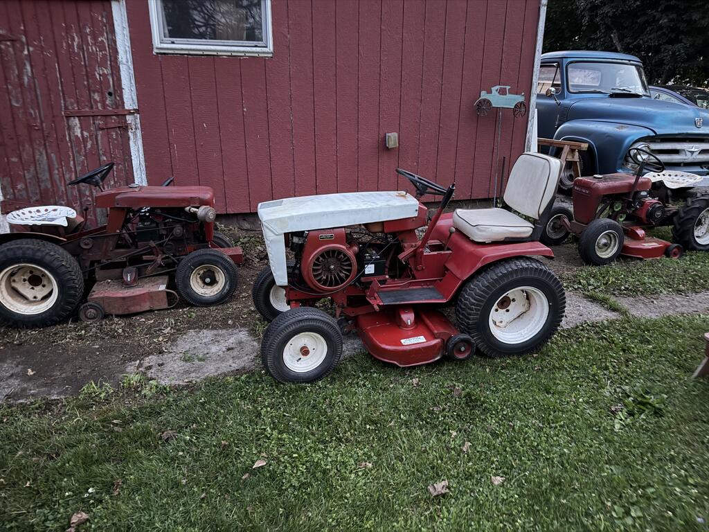

adsm08 5,243 #26304 Posted June 28 So Thursday, while getting ready for the show we found some holes in the boy's mower deck. This afternoon I had him strip it down to repair the shell. I will probably also replace the double belts and re-bearing the whole thing while it is apart. Meanwhile I was futzing with the 1076 I bought from @Ed Kennell at the show. I wanted to get the deck on and try it out as a mowing machine, but first I had to straighten the forks a bit: In the end I got the deck on, but there were other issues, and I ended up using the 855 to mow for the first time this year. The Commando has been dominating lawn care duty so far this year. 2 6 3 Share this post Link to post Share on other sites

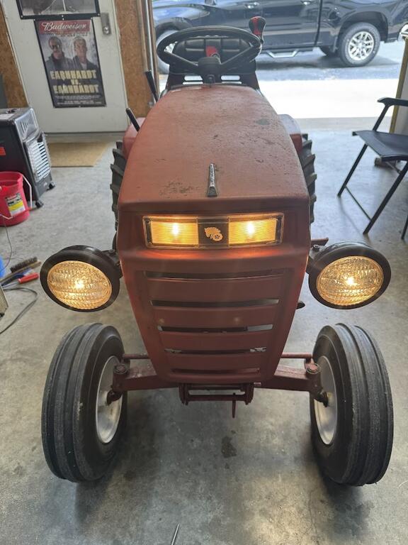

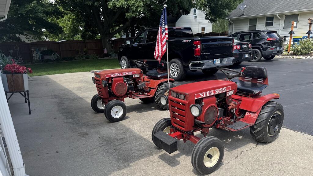

Bar Nuthin 3,545 #26315 Posted June 29 Found some vintage tractor lights I liked and got them installed on the C-160 today. Pretty close to the ones I put on the C-120. Will probably end up getting an LED upgrade before winter. Also mounted a flag on the C-120. My neighbor volunteered me to join a 4th of July parade with him. I think we may have recruited a few more now. IMG_5367.MOV 3 6 Share this post Link to post Share on other sites

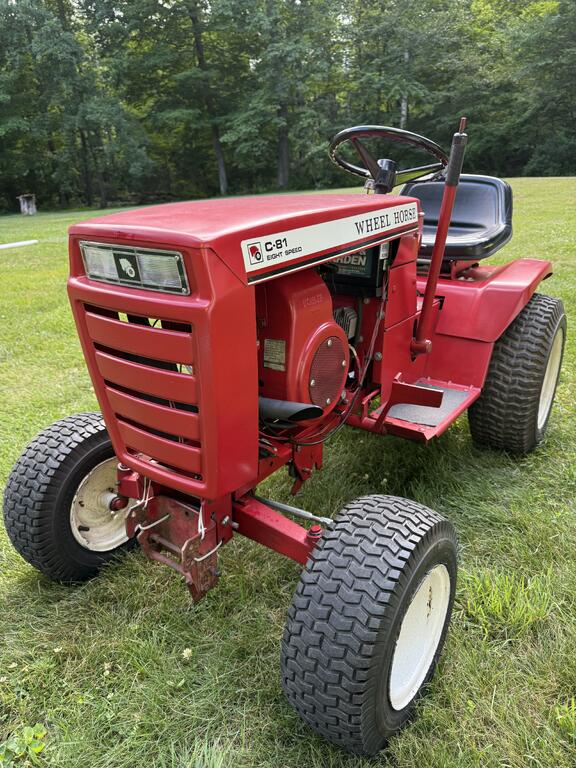

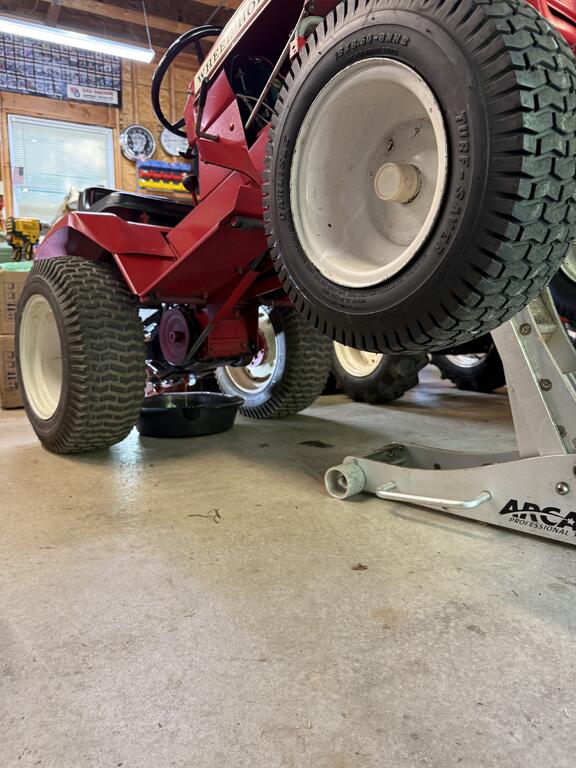

Sparky-(Admin) 26,716 #26323 Posted June 29 The newest addition to my team needed a transmission fluid change pronto! “1978 C-81” 5 6 Share this post Link to post Share on other sites

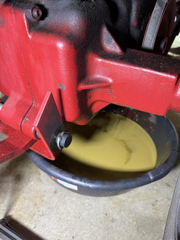

Sparky-(Admin) 26,716 #26325 Posted June 30 Old gear oil out, then a kerosene flush and drain…now the fresh stuff goes in. 1978 C-81 4 3 Share this post Link to post Share on other sites
