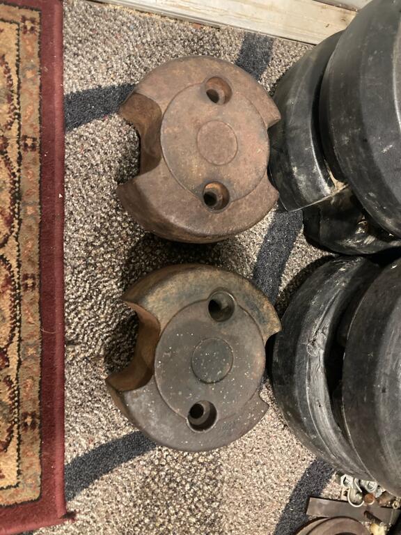

ineedanother 2,885 #25976 Posted May 13 Pressure washed a bunch of stuff after work. Love-hate relationship there for me. 16 Auto, FEL sub-frame, a bunch of parts and these front weights that took two years to pry out of my brother's hand's They'll be Regal red soon. 9 2 Share this post Link to post Share on other sites
ebinmaine 81,183 #25977 Posted May 13 6 hours ago, ineedanother said: these front weights You ever measure or trial fit those? I have a set that appears the same. Mine were BACK weights for a TEN inch rear wheel. I've never set them on/ in an 8" front. Share this post Link to post Share on other sites
ineedanother 2,885 #25978 Posted May 13 3 hours ago, ebinmaine said: You ever measure or trial fit those? I have a set that appears the same. Mine were BACK weights for a TEN inch rear wheel. I've never set them on/ in an 8" front. Yeah, I've had them mounted temporarily. The problem I have is that the gates on my property are 48" and depending on the off-set on the rims these can be too wide. 2 Share this post Link to post Share on other sites

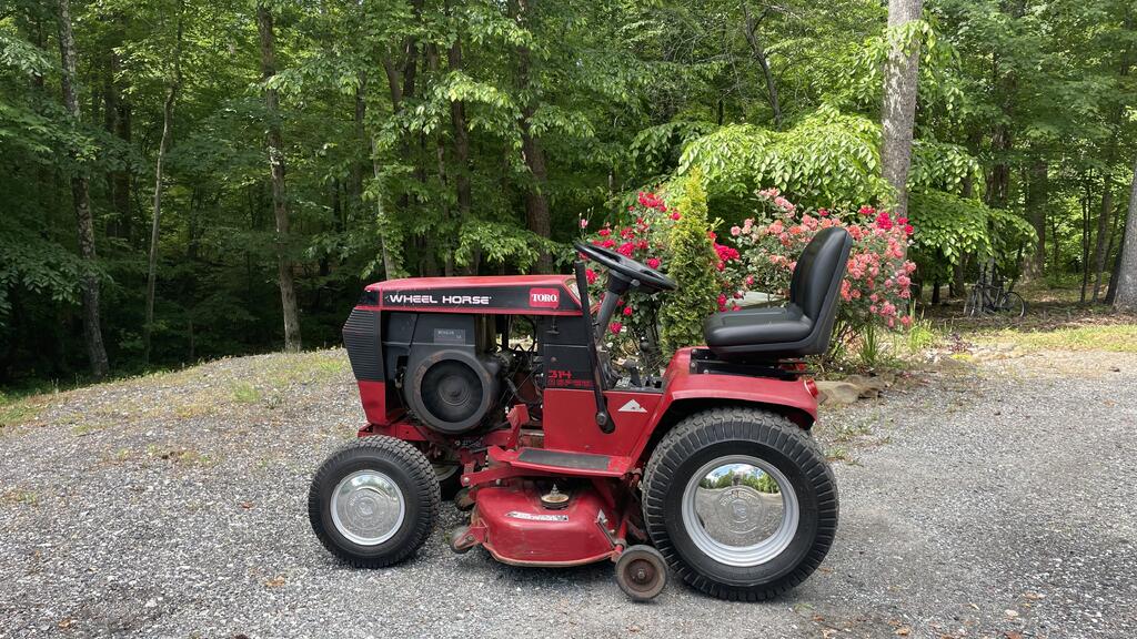

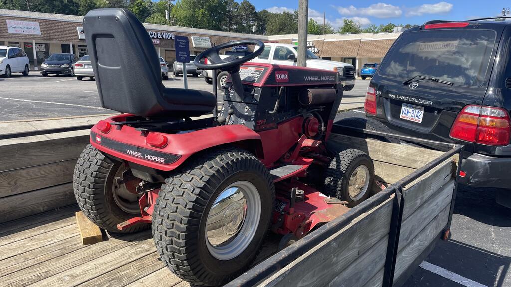

Fj40z 241 #25982 Posted May 15 What have I done to my Wheel Horse today?………I bought it!! Hey guys just joined the forum as I bought my first Wheel Horse today. I had been utilizing the forum to do some research before I pulled the trigger on one. Brought home what I believe is a mid 90’s (could be wrong) 314-8. Seems to be fairly well taken care of, best I can tell so far the only thing not working is the headlights. It’s missing a few pieces like the pulley covers on the deck but overall really excited about it. Look forward to learning here and hopefully many years of good service from the 314. 4 13 4 Share this post Link to post Share on other sites

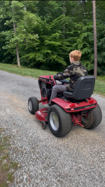

Fj40z 241 #25989 Posted May 15 Thanks for all the welcomes! @C100guy94 thanks for the heads up about the rear diff service and the low range boot. I’m glad to get any pointers like that you guys give out. @953 nut good to meet another North Carolinian on here! Im really excited to get this one, almost excited as my youngest son is LOL 2 5 Share this post Link to post Share on other sites
sqrlgtr 4,192 #25991 Posted May 15 Forgot to mention, looks like the grass screen is missing from motor in pics, if it is I would find a replacement before I used it much (especially mowing). You would be surprised at the air that gets sucked in there. 1 1 Share this post Link to post Share on other sites
Fj40z 241 #25992 Posted May 15 12 minutes ago, sqrlgtr said: Forgot to mention, looks like the grass screen is missing from motor in pics, if it is I would find a replacement before I used it much (especially mowing). You would be surprised at the air that gets sucked in there. Thanks for picking up on that! I kept thinking that there had to have been a screen on there but there are no mounting holes for one. Now that I know there is supposed to be one I’m assuming it’s a press in style screen with a lip on the inside? Share this post Link to post Share on other sites

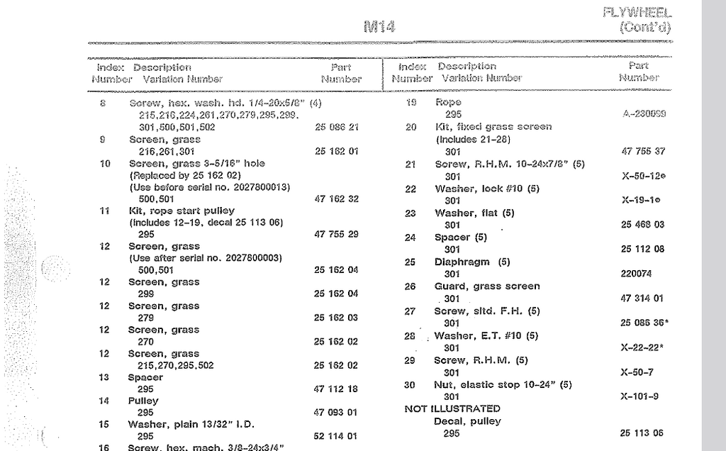

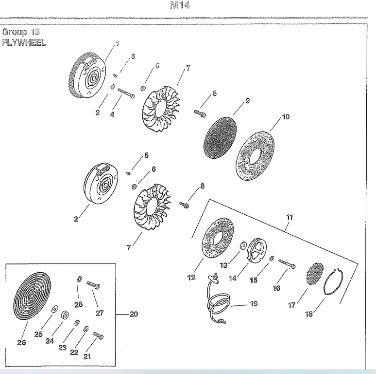

pfrederi 21,314 #25993 Posted May 15 (edited) 7 minutes ago, Fj40z said: Thanks for picking up on that! I kept thinking that there had to have been a screen on there but there are no mounting holes for one. Now that I know there is supposed to be one I’m assuming it’s a press in style screen with a lip on the inside? Pretty sure you need #9 Screen and 4 #8 washer head screws to be sure what is Spec# of you r engine Edited May 15 by pfrederi 2 Share this post Link to post Share on other sites

lynnmor 9,073 #25997 Posted May 15 (edited) I see another safety issue besides the flywheel screen, the mower deck is missing the pulley guards. If you ever let your foot slip while mowing those hills you might have a serious wound, ask me how I know. Edited May 15 by lynnmor 1 3 Share this post Link to post Share on other sites
DLF 74 #25998 Posted May 15 The Magnum had plastic screen it is attach with 4 posts that are on the fan blades. Lee1977 3 Share this post Link to post Share on other sites
