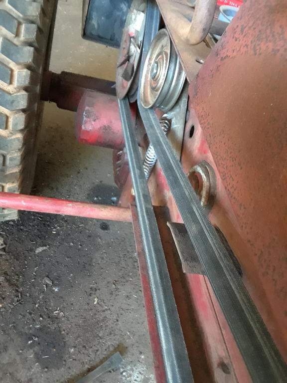

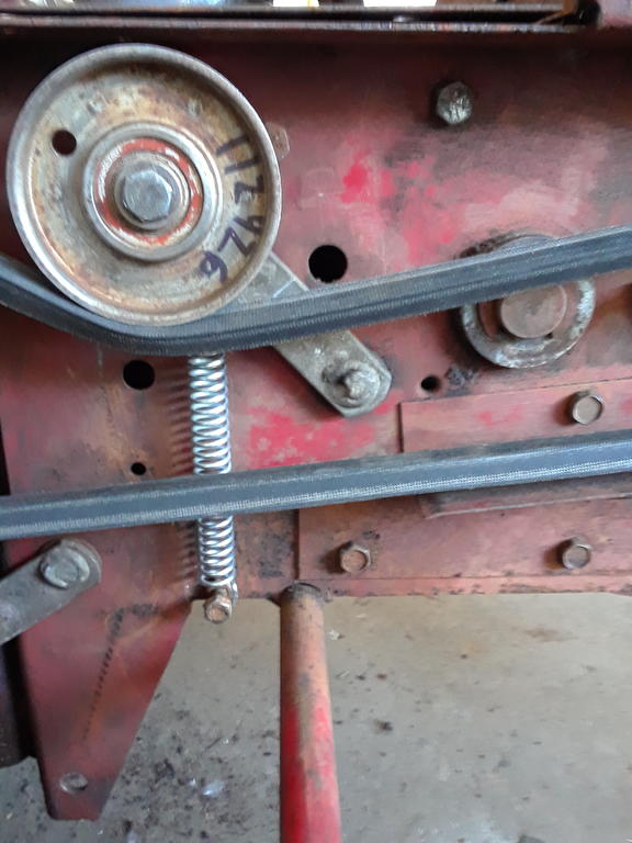

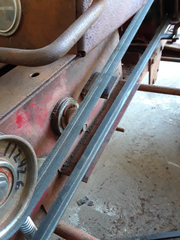

Goldann520 242 #2480 Posted June 11, 2019 (edited) Alright now I'm super aggravated. Got a nice clean sheave on trans, still throwing the belt.has a curve top side high from engine pulley to idler. Is the engine adjustable where blocks bolt to frame? Everything seems square enough ????? Will access to a service manual tell me this? This is why I don't like belt drive tractors. Edited June 11, 2019 by Goldann520 1 Share this post Link to post Share on other sites
pfrederi 21,218 #2481 Posted June 11, 2019 31 minutes ago, Goldann520 said: Alright now I'm super aggravated. Got a nice clean sheave on trans, still throwing the belt.has a curve top side high from engine pulley to idler. Is the engine adjustable where blocks bolt to frame? Everything seems square enough ????? Will access to a service manual tell me this? This is why I don't like belt drive tractors. 31 minutes ago, Goldann520 said: Alright now I'm super aggravated. Got a nice clean sheave on trans, still throwing the belt.has a curve top side high from engine pulley to idler. Is the engine adjustable where blocks bolt to frame? Everything seems square enough ????? Will access to a service manual tell me this? This is why I don't like belt drive tractors. See my response to your other posting. You don't move the engine usually but you can move the pulley in or out as needed. Share this post Link to post Share on other sites
953 nut 69,805 #2482 Posted June 11, 2019 The idler on my hydros has a shoulder on the inboard side that is about 3/8" wide to space the idler out to align with the belt. Share this post Link to post Share on other sites
ebinmaine 80,913 #2483 Posted June 11, 2019 @Goldann520 I'm with @pfrederi Paul and @953 nut Richard on this one. I think you need a spacer behind your idler pulley. Another thing to keep in mind is that I have had several belts in the past that once thrown off develop a pattern and will not ever stay where they're supposed to again... hopefully that belt is still straight even though there is a groove line in it. 2 Share this post Link to post Share on other sites
Goldann520 242 #2484 Posted June 11, 2019 1 hour ago, 953 nut said: The idler on my hydros has a shoulder on the inboard side that is about 3/8" wide to space the idler out to align with the belt. Ya mine has the transmission disconnect that a spacer goes in a slot. Also has a 5/16 valve to hand push. Hmmmmm Share this post Link to post Share on other sites

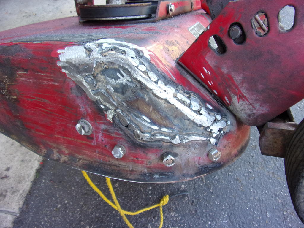

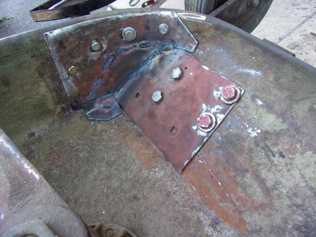

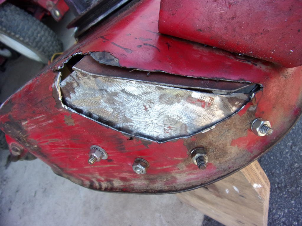

Ed Kennell 47,594 #2485 Posted June 12, 2019 I have this 417 with a 48" SD that I was thinking of listing on the big show sale post. But after charging the battery and mowing with it, the sound of that KT17 grew on me. So I decided to fix the left rear corner of the deck where it rusted thru. This might become my go to mower. Now, what to do with the C-120, 312A, and 312H? All comments on my welding skills will be ignored. This is functional, I use Bondo to make it purty. 3 1 2 Share this post Link to post Share on other sites

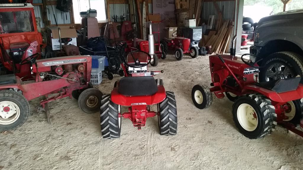

WHX?? 58,302 #2487 Posted June 12, 2019 24 minutes ago, Ed Kennell said: Now, what to do with the C-120, 312A, and 312H? Maybe I just best come get them! Gave some girls a bath and ready to load them for a show this weekend! For a minute I thought they was Cubs with all the pine pollen on them! 3 3 Share this post Link to post Share on other sites
WHX?? 58,302 #2488 Posted June 12, 2019 Problem was they was all havin a pow wow about who gets to go! 1 7 Share this post Link to post Share on other sites
ebinmaine 80,913 #2489 Posted June 12, 2019 6 hours ago, Ed Kennell said: comments on my welding skills Looks good from my house. At least you have the functionality there. You get too awful tired of looking at the C120 just throw it in the truck and bring it right up to Maine. I'll "tractor-sit" it for ya. 1 1 1 Share this post Link to post Share on other sites

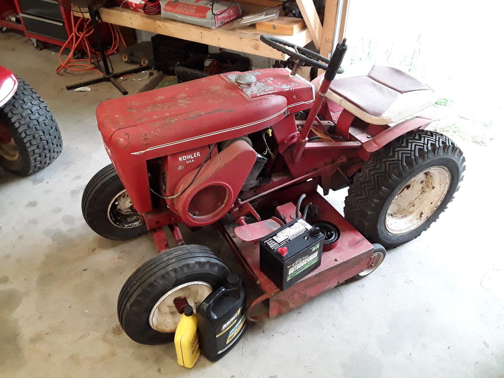

mhlmeader 689 #2490 Posted June 12, 2019 I got a new battery, oil, and ordered a fuel pump repair kit for my 701..... 4 3 Share this post Link to post Share on other sites

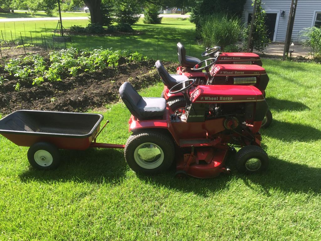

Andy N. 2,863 #2491 Posted June 14, 2019 (edited) Took the tiller off the 312-8, put the deck back on and got the rest of the heard out for some sun! Edited June 14, 2019 by Andy N. 4 Share this post Link to post Share on other sites
ebinmaine 80,913 #2492 Posted June 14, 2019 7 hours ago, Andy N. said: Took the tiller off the 312-8, put the deck back on and got the rest of the heard out for some sun! Nice little garden plot you got goin... 1 Share this post Link to post Share on other sites

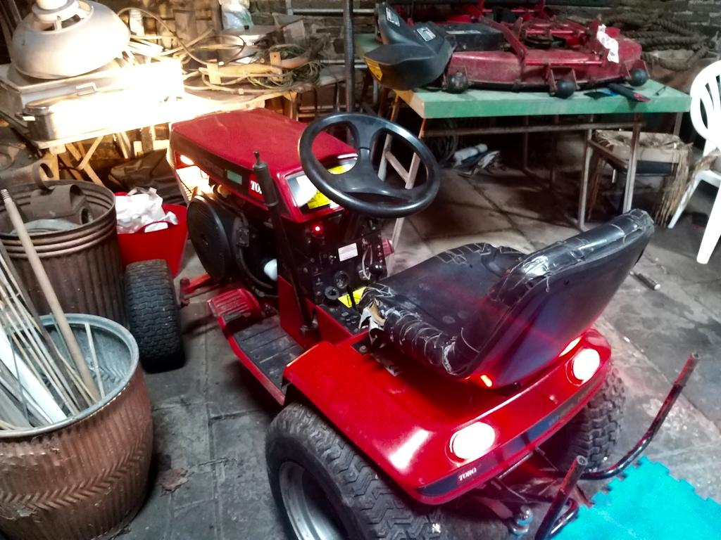

Bertie 314 #2496 Posted June 15, 2019 Small thing but happy with the rear lights working again, tuned out it was just a simple dodgy connection 👍 3 Share this post Link to post Share on other sites

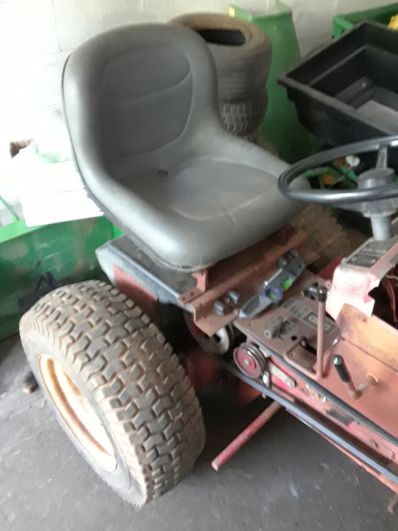

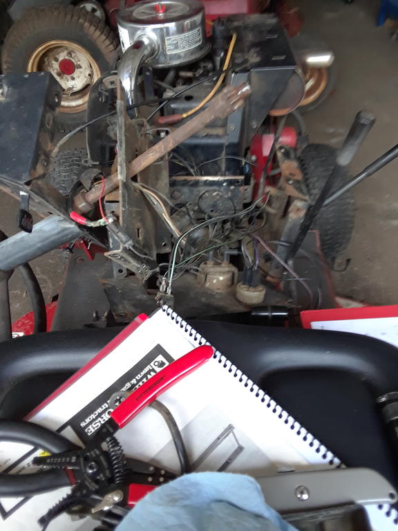

Goldann520 242 #2497 Posted June 15, 2019 Mounted a "new" seat for the bomb today I found in a guys garage while picking up a spiker/seeder, jd. It was so dirty I didn't notice it was dark grey, not black.😁. Priced 4 new engine isolators for this never ending belt throwing issue. WOW 147.50!!!!!. Continued on my dad's 417a wire harness fiasco. Share this post Link to post Share on other sites

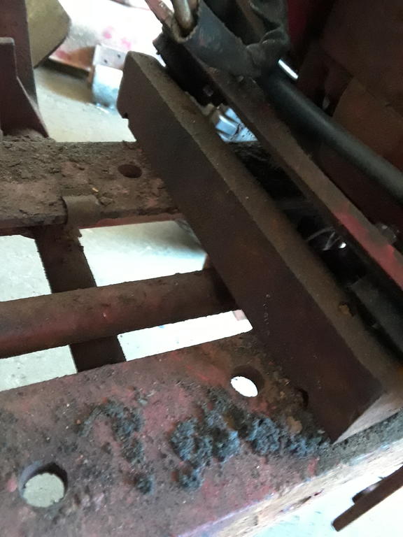

ebinmaine 80,913 #2498 Posted June 15, 2019 40 minutes ago, Goldann520 said: Priced 4 new engine isolators for this never ending belt throwing issue. WOW Something tells me the issue isn't entirely bad isolators but they would be available used from someone. Best bet if possible would be to eliminate the shaker plate. Have you checked the pulleys for alignment yet? 1 Share this post Link to post Share on other sites
Goldann520 242 #2499 Posted June 15, 2019 9 minutes ago, ebinmaine said: Something tells me the issue isn't entirely bad isolators but they would be available used from someone. Best bet if possible would be to eliminate the shaker plate. Have you checked the pulleys for alignment yet? Ya, to the best of my ability. From the engine to the idler since day one it gets a twist in it high side away from me, and off it comes. I have a lot longer thinner belt that rides down in the pulleys a ways, and that will stay on a while. Share this post Link to post Share on other sites
adsm08 5,194 #2500 Posted June 16, 2019 2 hours ago, Goldann520 said: Ya, to the best of my ability. From the engine to the idler since day one it gets a twist in it high side away from me, and off it comes. I have a lot longer thinner belt that rides down in the pulleys a ways, and that will stay on a while. Get a laser level and align it so it crosses right at the edge of a pulley, and touches the whole thing across it's width. Then see if it hits the other pulley that belt runs on. If it doesn't, you are out of alignment. Share this post Link to post Share on other sites
