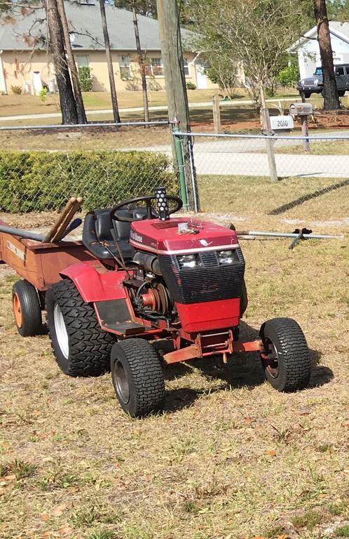

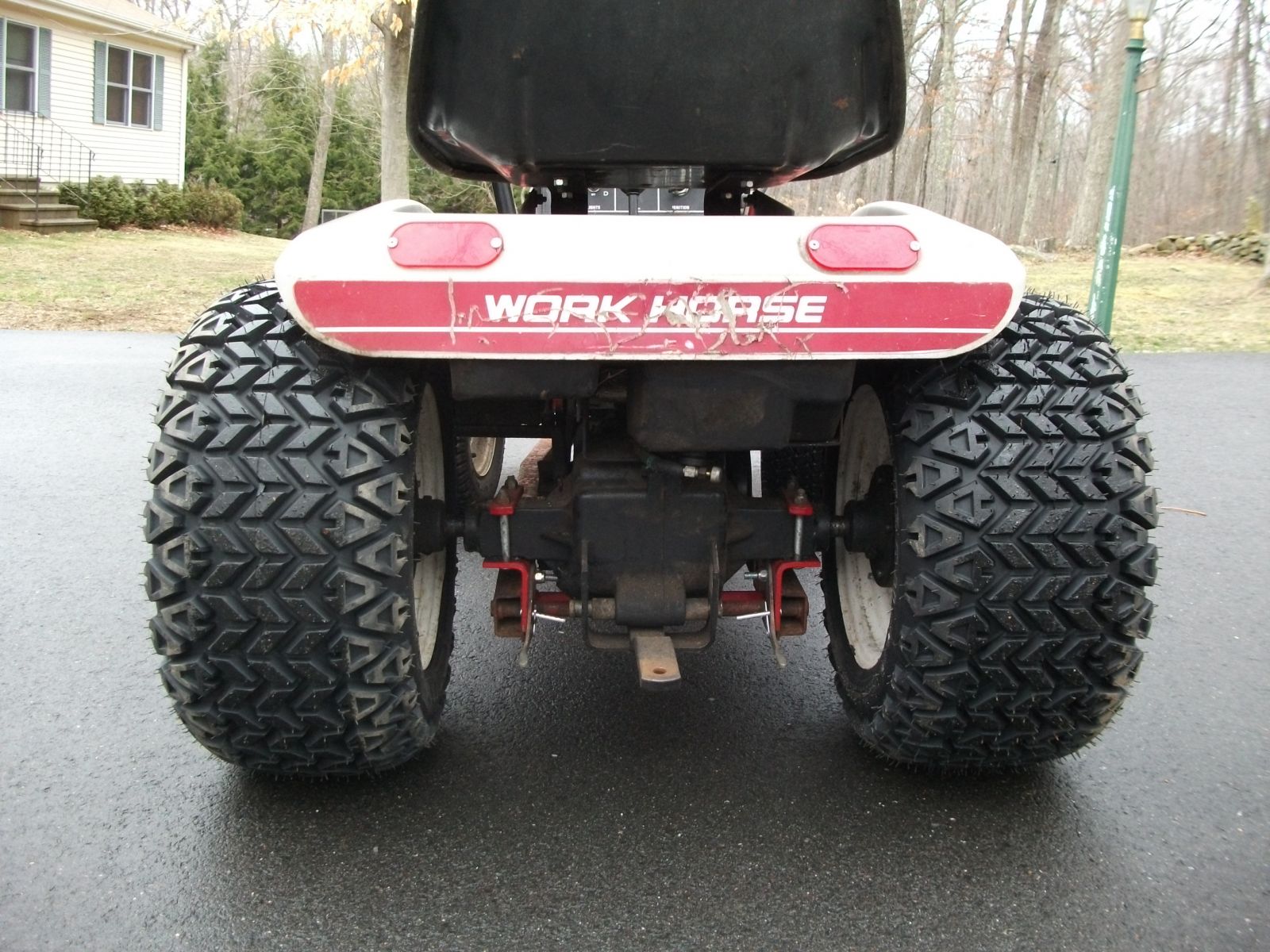

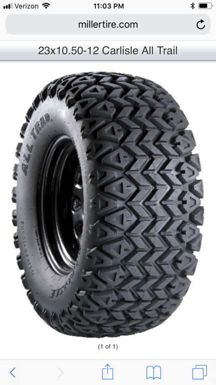

PeacemakerJack 11,096 #158 Posted March 27, 2018 (edited) A couple of Commercial beasts! Is anyone on here running 23x10.50-12 Carlisle all trails on a 3/4/500 series horse? I’m thinking those might be a good look and functional on JR. I’m open to suggestions though... Edited March 27, 2018 by PeacemakerJack 3 Share this post Link to post Share on other sites
19richie66 17,951 #159 Posted March 27, 2018 (edited) I have them on my 417-A. I can get you a better picture later today. Very good tires for all around use. They do good in the sand here. We run them on our 4x4 carts out at work. Edited March 27, 2018 by 19richie66 4 1 Share this post Link to post Share on other sites
AMC RULES 37,261 #160 Posted March 27, 2018 @Sparky...Yeah, Mike's got 'em too. 3 2 Share this post Link to post Share on other sites
PeacemakerJack 11,096 #161 Posted March 27, 2018 2 hours ago, 19richie66 said: I have them on my 417-A. I can get you a better picture later today. Very good tires for all around use. They do good in the sand here. We run them on our 4x4 carts out at work. Those sure look nice on there Richie! Thanks for the I wonder how a set of V61's would look with that combo... 1 Share this post Link to post Share on other sites
ebinmaine 81,278 #162 Posted March 27, 2018 6 minutes ago, PeacemakerJack said: Those sure look nice on there Richie! Thanks for the I wonder how a set of V61's would look with that combo... I. M. H. O. Excellent! 1 1 Share this post Link to post Share on other sites

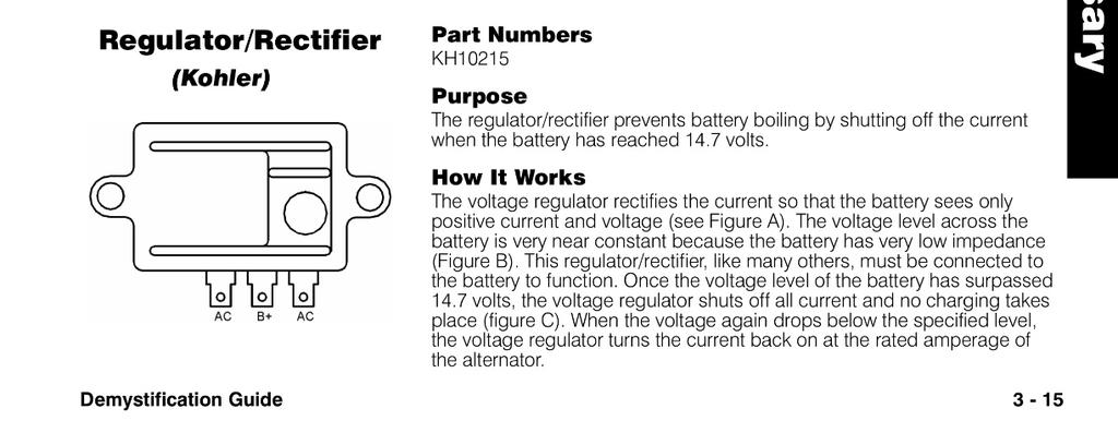

PeacemakerJack 11,096 #163 Posted March 31, 2018 As mentioned in a different thread, we got some seat time on JackRabbit today. I wasn’t happy with how it was idling and so I checked the carb settings. This tractor has a fixed main jet but an adjustable idle jet. The adjustable idle was out of whack by almost two full turns. I also checked the spark plugs and they were about .010 undergapped. That helped some but I’m not happy with the governor operation. When you get the throttle past mid point, the engine seems like it runs up to a really high RPM. I’m not sure what is causing this, but hopefully I can get it pinpointed. I also need to figure out why it’s not charging more than about 12.6 volts. Other than those items and spacing out the idler pulley, it is a fun machine! 3 Share this post Link to post Share on other sites
Sarge 3,473 #164 Posted March 31, 2018 Did you ground the regulator body properly? Sarge 1 Share this post Link to post Share on other sites
PeacemakerJack 11,096 #165 Posted March 31, 2018 @Sarge Please elaborate... Share this post Link to post Share on other sites
19richie66 17,951 #166 Posted March 31, 2018 (edited) Should be two wires coming out of the stator that go on the outside terminals and the middle terminal should be 12 volts. Normally the regulator is grounded through the engine in that since the cooling tin is metal but it wouldn’t hurt to try a ground jumper to the regulator body. Edited March 31, 2018 by 19richie66 2 1 Share this post Link to post Share on other sites
pfrederi 21,342 #167 Posted March 31, 2018 Sand off any paint around the regulator mounting bolts. Use star lock washers and some dielectric grease to make sure the regulator body is well grounded. Use you ohm meter to check resistance between regulator case and batt (-) 2 1 Share this post Link to post Share on other sites
PeacemakerJack 11,096 #168 Posted April 1, 2018 Thanks for the info guys. Do you know what the AC current coming to the regulator from the stator should be while the engine is running. I thought that I had read somewhere that it was like 33volts AC. I set my tester on AC and put the ground on the battery negative and stuck the red lead into the AC terminals. One side had a reading of 11 and the other side was like .2. I want to make sure that I’m testing them correctly. I have a readout on the center lead of 12-12.1volts DC. Same at the battery. GhostRider runs around 14 volts at the battery and in turn the B+ post. I would guess that there is a way to test the regulator independently to see if it is working. Share this post Link to post Share on other sites
Howie 900 #169 Posted April 1, 2018 I think on the Briggs stators you hook one lead to each and run engine to check. Not sure if the same is true with Kohler. 1 Share this post Link to post Share on other sites
Ed Kennell 47,942 #170 Posted April 1, 2018 Measure the ACV across the two leads from the stator. Should be about 30V at WOT and vary directly with RPM. 2 1 1 Share this post Link to post Share on other sites
