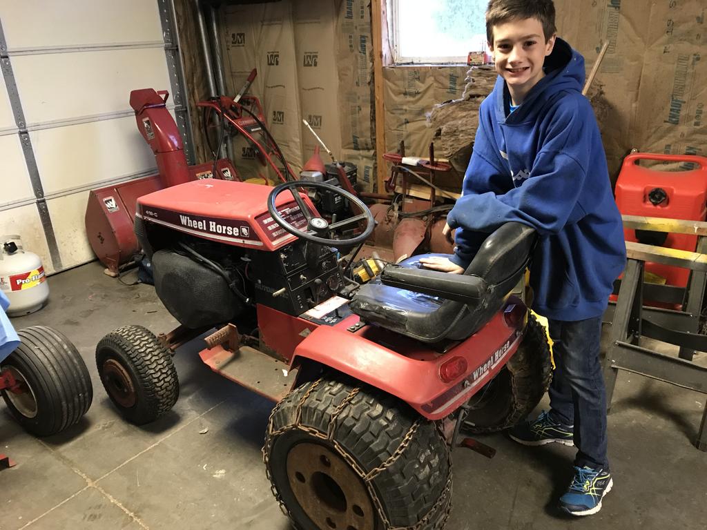

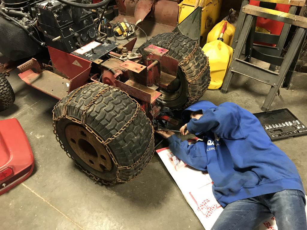

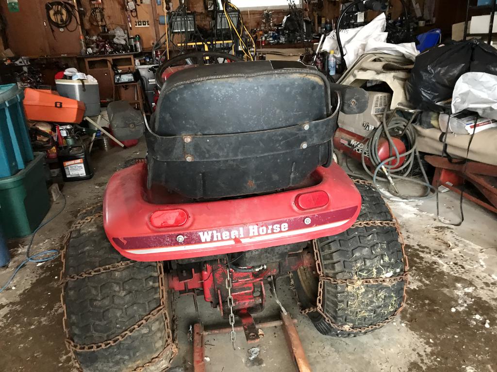

PeacemakerJack 11,061 #1 Posted January 3, 2018 Caleb purchased this package deal about a month ago. We brought it home, cleaned off the road salt and changed the oil. Since then we haven’t had much time to work on it. It is a solid one owner tractor but still has some rough spots here and there. Came with several nice implements including a tiller and 48” blade. The wiring is cobbled and will need some work to get it functioning like it should but I love a challenge and with this one it means time with my son! Caleb was a happy boy and now is ready to roll up his sleeves and get to work! We needed a heated space to work in, especially since this cold snap is keeping high temps in the single digits or less. I finished insulating the shop last week and tonight we started on JackRabbit... The seat was rocking and rolling all over the place. Thanks to you guys, we picked up a 520 seat bracket. Caleb pulled the seat and I began working on there seat slides with Deep Creep to free them up. Then we pulled the filter and drained the rear axle oil. Caleb was excited to get under this thing and get his hands dirty. He was upset with me if I tried to take something apart! I like that—I want him to learn to do it and no better way than hands on under the watchful eye of a tutor. After taking the tank off, we completely drained the old fuel out. Do you guys have any recommendations on cleaning it out other than pouring some fresh fuel in, sloshing it around and dumping it out? As expected, lots of debris in the “trap spots” that will be cleaned out. To be continued... 14 7 Share this post Link to post Share on other sites

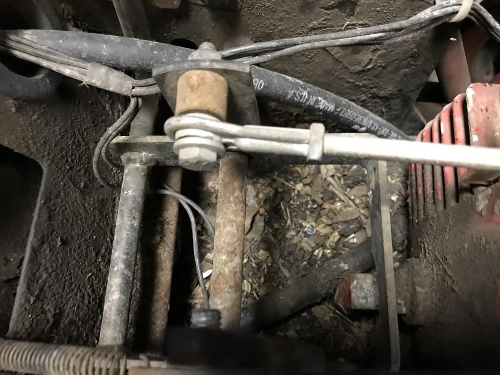

PeacemakerJack 11,061 #8 Posted January 3, 2018 Thanks Richard—especially for the tip on that seat brace. I’ll be sharing soon pics of what we found underneath and why that brace is so important—so typical of something that is taken apart at some point, put back together, and then an exclamation as to why there are extra bolts and screws left... But be assured, we will make it right! 3 1 Share this post Link to post Share on other sites
ohiofarmer 3,481 #9 Posted January 3, 2018 Check out the idler pulley that holds tension on the transmission belt. If the bushing [on the pulley arm] wears out the pulley will start to vibrate and wear an egg shaped hole in the transmission tunnel. I would replace that bushing and put waterproof silicone grease on it. Sort of a weak spot on the newer models 4 1 Share this post Link to post Share on other sites

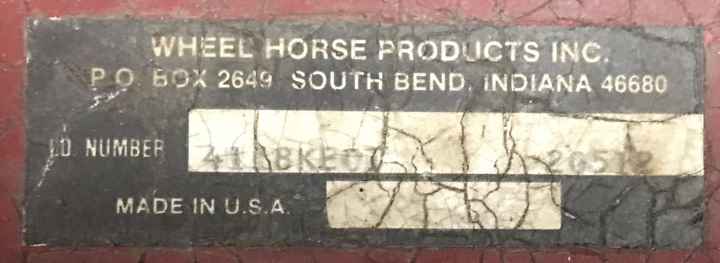

PeacemakerJack 11,061 #25 Posted January 5, 2018 Here is the tag from JackRabbit... A little tricky to read but I’m sure we can have Terry make us up a correct replacement when the time is right! Caleb had a basketball game tonight in which they won, and then had homework and so no work on the tractor tonight but hopefully we can get some meaningful time on it Saturday... 4 Share this post Link to post Share on other sites
