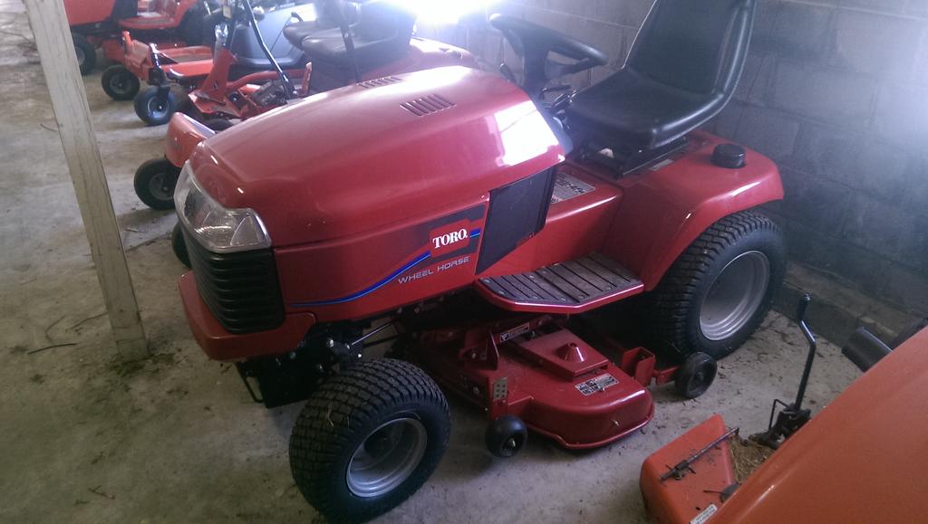

New seat from Northern as suggested by @WVHillbilly520H . I think you’re going to be surprised what these horses can handle. Heck I don’t even count my Kubota BX2230 a true tractor. To me a real tractor is cast iron front to back.

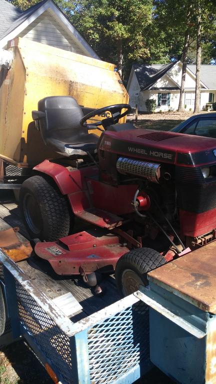

Now THAT is what I dream of my 520h looking like, but first I need to get it mechanically sound. Before I could EVER get it into that condition I will have to put it all back together, take 100's of pics(so I'll know how to put it back), then take it down to the frame. Is that paint from a gun or spray bomb ?

Even though I have a long way to go...I still don't feel too bad about the situation. I picked up the 520h, 36" roto-tiller to drag behind her, and an Easy-Vac leaf vacuuming trailer for less than $150. And technically the tractor was running when I brought it home. Carb was just searching and it would not idle without the choke pulled out slightly. I would like to get the leaf vac trailer restored too. That's the biggest reason I bought the whole set-up...to figure out an easier way to get up leaves. I'm getting too old to blow them into piles, then haul them to the street one load at a time in my 10 cubic foot Agri-Fab pull cart. I live in what I would call White Oak Hundred Acre Woods( not literally ) and those oaks have a few water oaks thrown in just in case the White oaks don't put down enough leaves. I'll probably never have a snowblower, unless I just want one more toy, because we really don't get snow down here.  (A bad snow around here of about 4 inches causes mayhem ) My two biggest obstacles will be time and money. BUT THAT IS A MIGHTY FINE LOOKING 520H YOU HAVE THERE. I WOULD BE PROUD TO HAVE ONE LIKE IT !

@Horse Newbie that’s Rust-Oleum regal red spray bomb with clear coat . You won’t see the thumbs up on your post until someone gives you one :handgestures-thumbupright: .

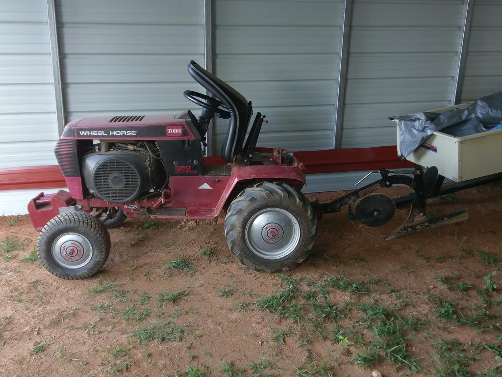

Ok here's some more photos for you non believers. Also touched her off for the first time. WOW! Runs perfect idle to wide open! SMOOTH, and that sound OH YEA. 1st onan, always a Koehler guy. Hour meter works reads 0235 and counting and boy does it run like it. Not a hint of smoke or valve issues.
I do have to say, it's slow and the linkage under the seat does not follow the channel all the way out. Any fixes?Thanks

WVHillbilly520H
Yes that Cam has an eccentric(top nut in the slot) that can help with gaining a little more motion as well as the actual linkages from the motion lever to the Cam have adjustments, if you havent already download the manuals for here free the show you how to do the adjusting, also change the fluid an filter 10w30 motor oil and at least the NAPA equivalent filter I prefer the Toro filter myself, Jeff.
Goldann520
 Thanks @WV Hillbillyfor the info. Did full tune up front and back. The hydro unit took forever to fill and lucky if I got 4 quarts in it. That tube just bubbles up. Did everything else while filling it. Also motion lever won't stay all way forward. Creeps back down to half way or more
WVHillbilly520H
On refilling the hydro 1)leave the filter loose helps 2) as well as removing one of the fender riser bolts in top of the hydro axle to help it burp, the big flat "friction" washer next to the motion Cam can be tightened down incrementally till it holds position while still allowing free range of motion sort of a fine line there but doable, Jeff.

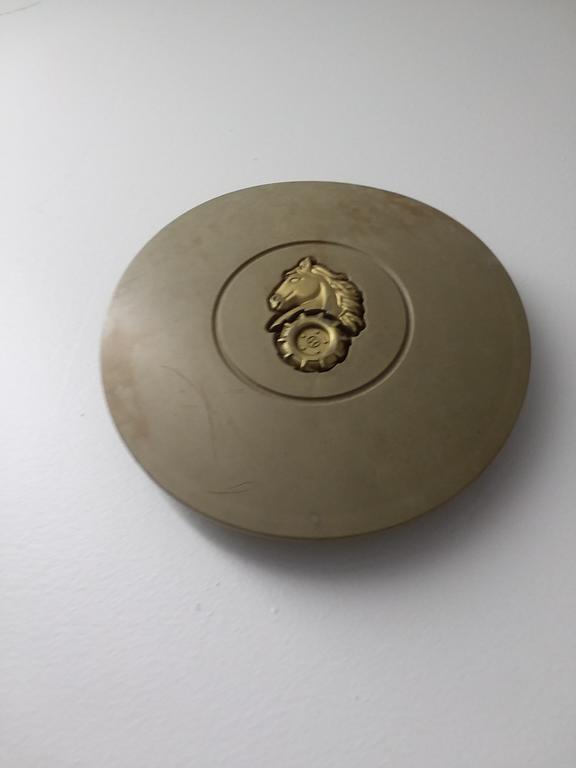

      I recently began pondering what all i could 3d print to dress up a horse. I'm pretty good with deaign sofware and came up with a couple small items to start, and figured i can easily print things like headlight covers, hood ornaments, and badges of all sorts.Then I wondered if maybe rather than a decal if i 3d printed an embossed plate or sorts with the appropriate graphics in 3d. These could be enamel painted, or printed in a silver that would give a brushed nickel type of finish.
      Here's a couple photos of what ive created thus far in some gray test material. Please let me know what ya think.
