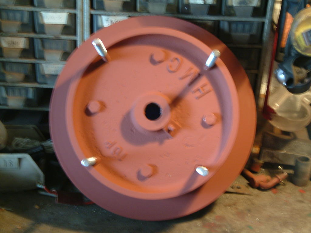

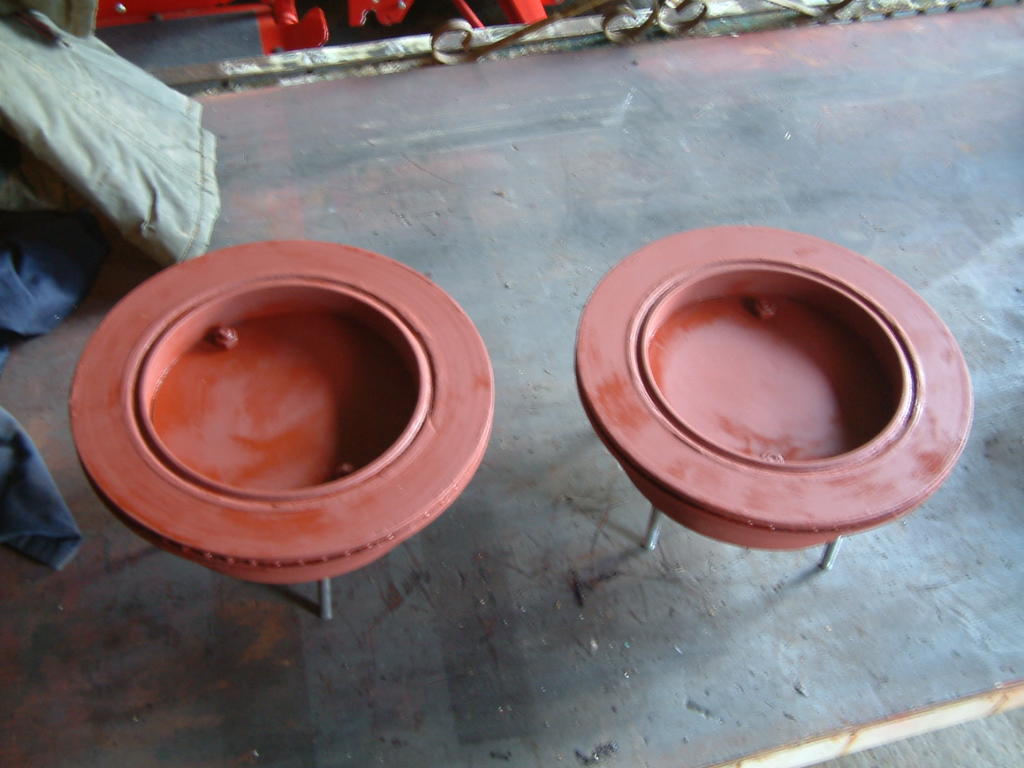

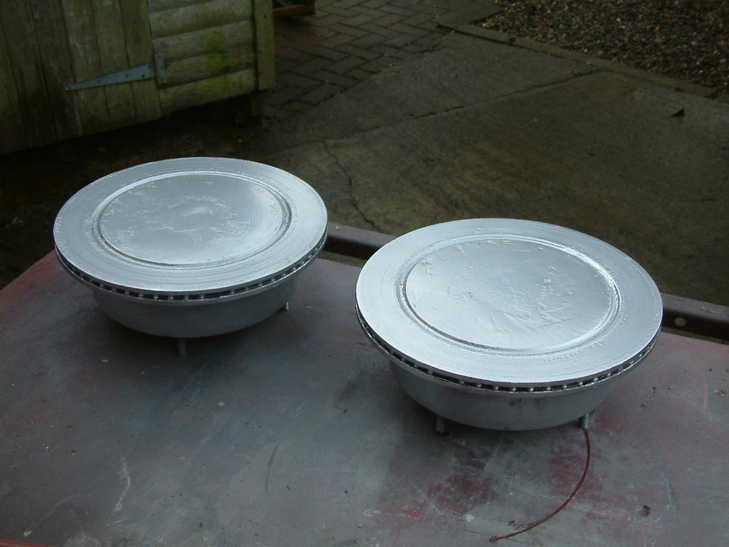

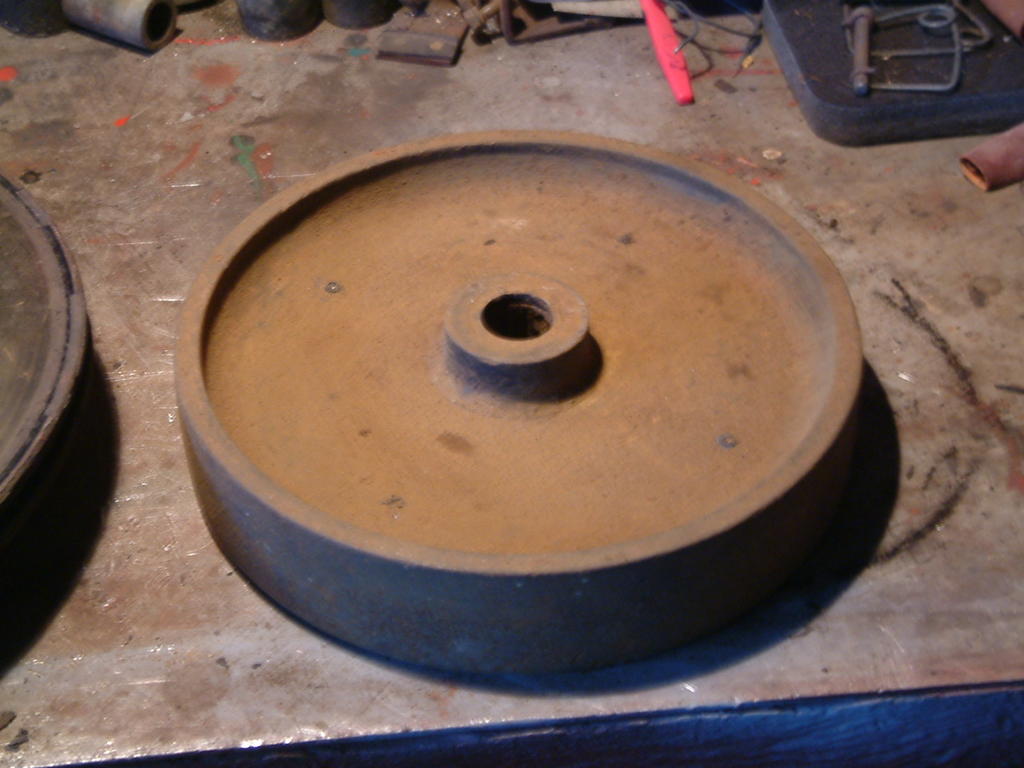

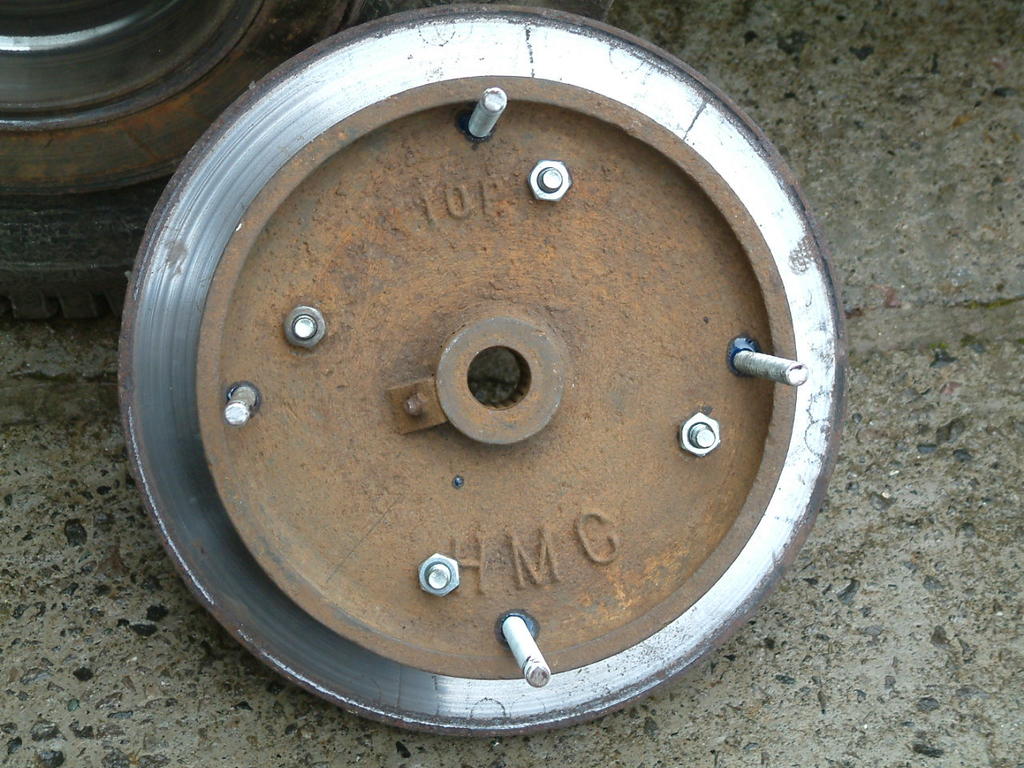

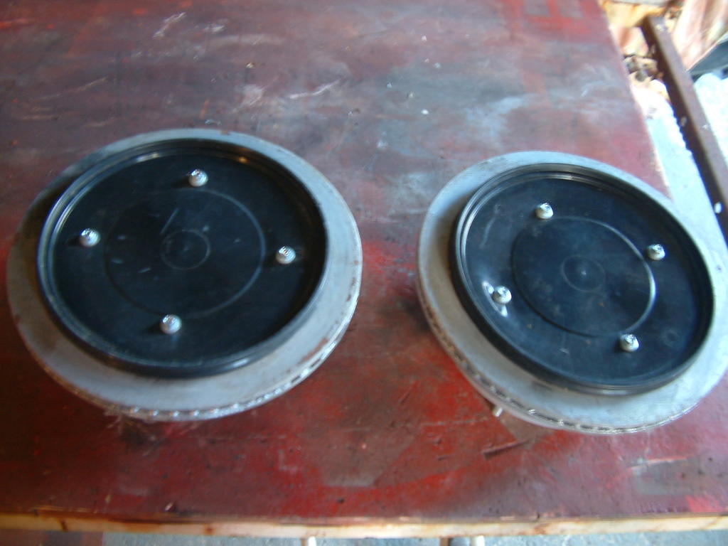

Stormin 9,988 #1 Posted December 17, 2017 Wheel weights for Wheel Horses, are not very easy to get hold of this side of the pond. Also can be silly money if you find some. So I decided to make my own. From my local Land Rover specialist, I rescued the handbrake drums off a Freelander from the scrap bin. I also got a cast iron pulley from another source. The pulley just the right O.D to fit into the wheel. Pulley. Pulley fitted to the back of the brake drum along with studs to fasten to wheel. The opposite side filled with 35lb of lead and a bucket lid as a cover. More lead will be added when I get some. Don't look bad for £10 and a bit of work. 12 5 1 Share this post Link to post Share on other sites

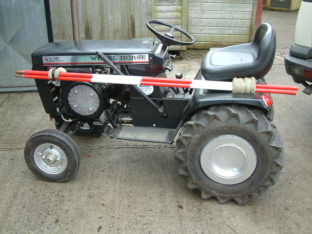

elcamino/wheelhorse 9,363 #3 Posted December 17, 2017 @Stormin I have to ask what a the pointy sticks for jousting ? 2 2 Share this post Link to post Share on other sites

Stormin 9,988 #8 Posted December 18, 2017 The pointy sticks as you call them or sighting poles. Before you start to plough, you set them out in a line along where your first furrow will be. 1st in front of the centre of the intended furrow. 2nd halfway down the plot and 3rd at the far end. You line up the tractor centre with the 1st one then remove the pole. As you plough you keep your eyes on the 2nd pole making sure the 3rd is out of sight behind it. Do not look round when moving. Or you can go off line.When you get to the 2nd pole you remove that and continue down to the 3rd. You should now have a nice straight furrow. Hopefully. 11 Share this post Link to post Share on other sites

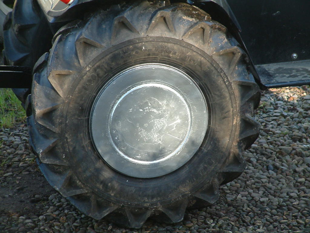

WHX?? 58,325 #14 Posted December 18, 2017 Lol Those rear tires are interesting looking too Norm... what make size? 1 1 Share this post Link to post Share on other sites

Stormin 9,988 #16 Posted December 18, 2017 1 hour ago, WHX12 said: You mean your furrows don't look like this Norm?!?!?! Strewth! 51 minutes ago, WHX12 said: Lol Those rear tires are interesting looking too Norm... what make size? Tyres are 700 x 12. Without going out for a look and it's dark and freezing, don't remember make. I'll have a look tomorrow. 1 Share this post Link to post Share on other sites
C-101plowerpower 1,606 #17 Posted December 18, 2017 3 hours ago, WHX12 said: Lol Those rear tires are interesting looking too Norm... what make size? dunlop, it says on the tire 1 2 Share this post Link to post Share on other sites
Stormin 9,988 #18 Posted December 19, 2017 9 hours ago, C-101plowerpower said: dunlop, it says on the tire Oh to have young eyes. Well spotted Koen. Share this post Link to post Share on other sites

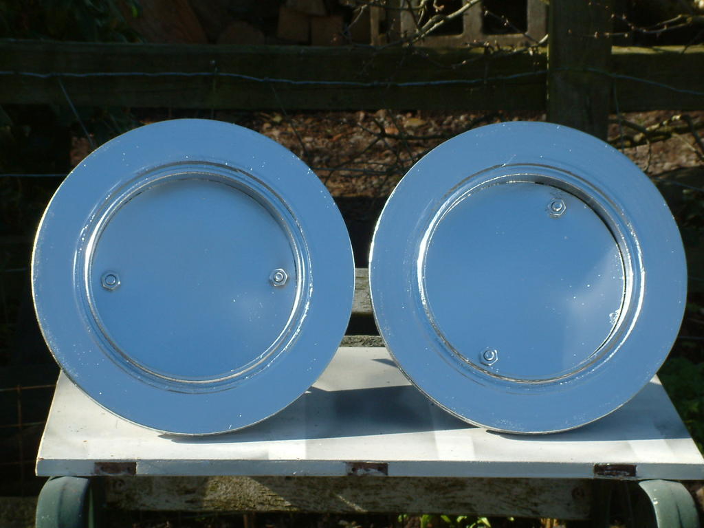

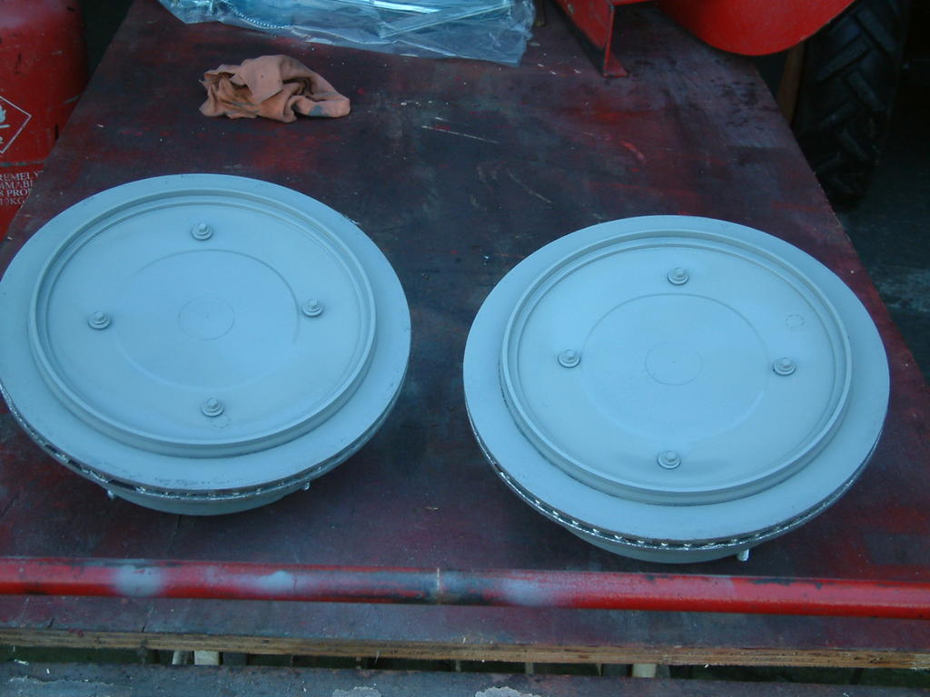

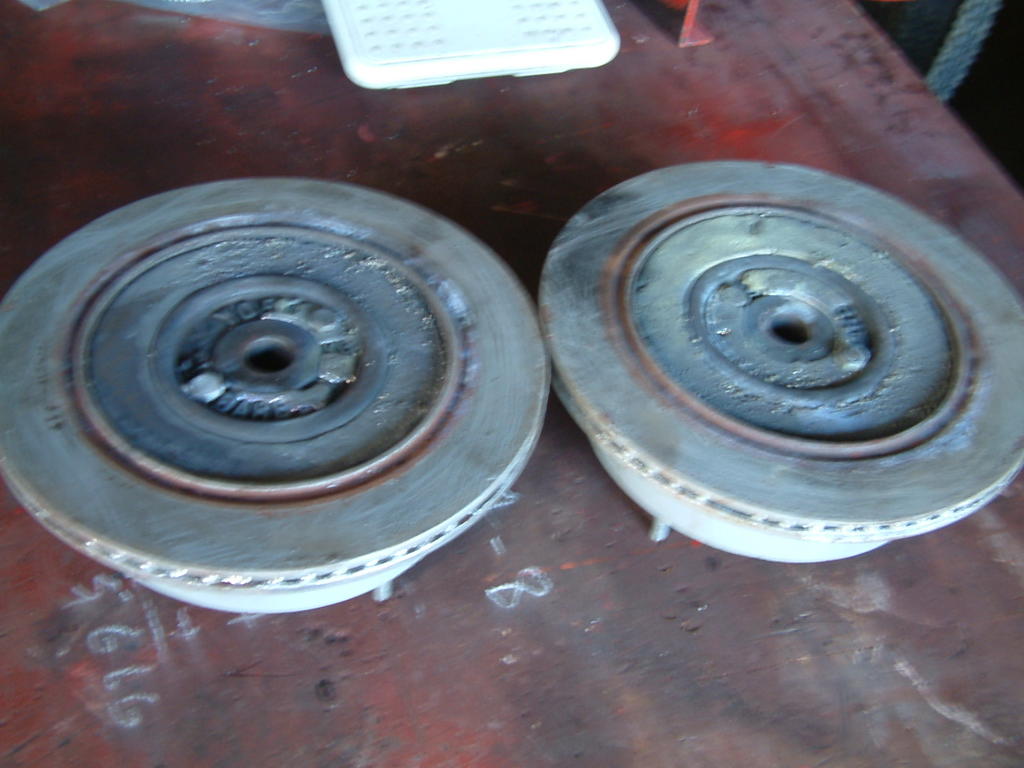

Stormin 9,988 #19 Posted February 2, 2018 (edited) I've been wanting some more lead to finally add a bit more weight. Eldest son-in-law said he had some old lead from roofing work done on his house. So I went over for it last week. I just wanted about 40-50lb but came home with around 400lb. I think some could be getting weighted in. Keep costs down. Up to the farm this morning and out with the oxy/acet and soon had more lead added. More by good luck than judgement, they have ended up the same weight. 56lb. A couple of plastic bucket lids to replace the existing ones and some self drilling/tapping roof screws. Quick spray with primer. They'll get another coat of primer and a couple of top coats before I refit them. Edited February 2, 2018 by Stormin 1 2 Share this post Link to post Share on other sites

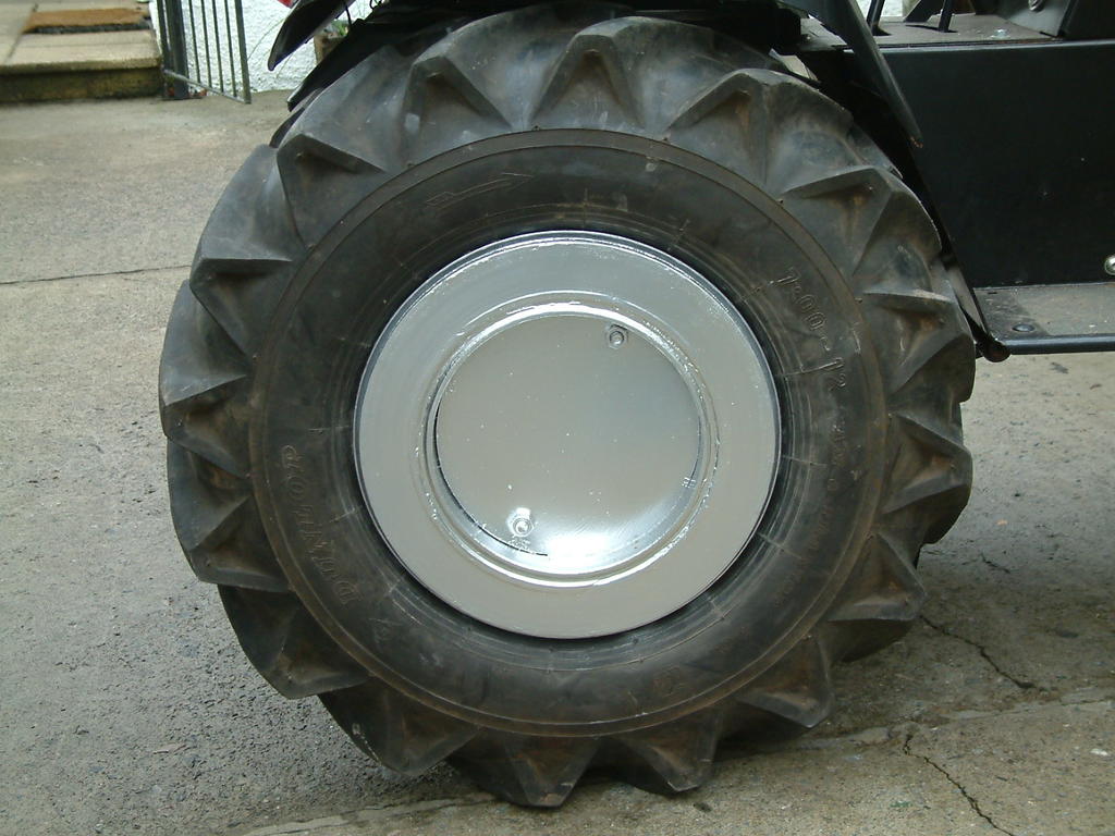

Stormin 9,988 #22 Posted February 8, 2018 Done a bit of a mod. The lid covers stuck out a little from the tyres. Possibly, (most likely), would catch the trailer sides. So off with the lids and after some filler. Not perfect but they'll do the job. Now all I have to do is refit them. 1 Share this post Link to post Share on other sites

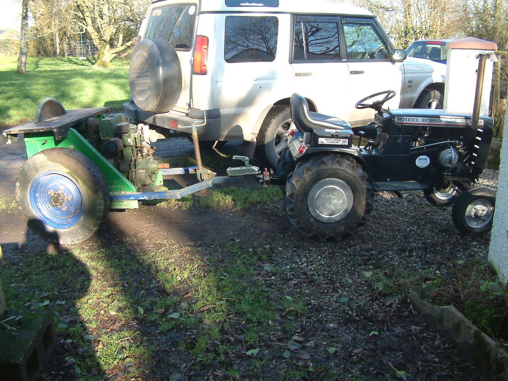

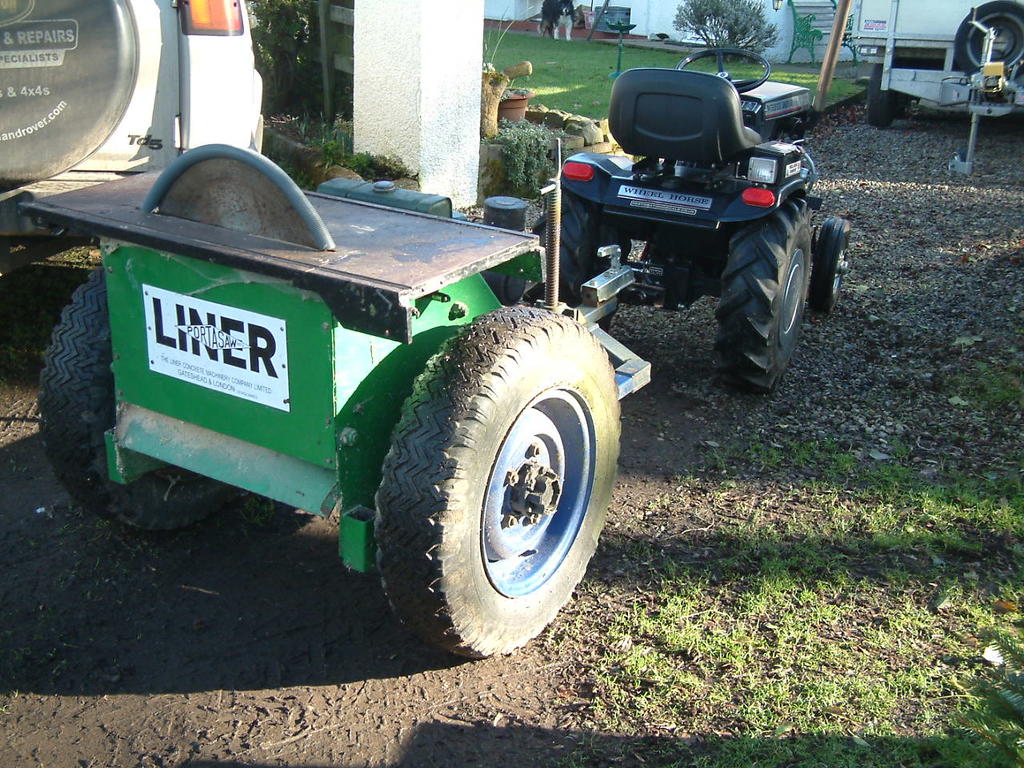

Stormin 9,988 #23 Posted February 9, 2018 Re-fitted them today and also gave them a little test pulling my saw bench. Before, I had to use my Disco to move it, as tractor wheels would just dig holes in the stones. Pulled it up into the yard with no wheel slip whatsoever. 2 Share this post Link to post Share on other sites
