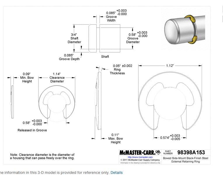

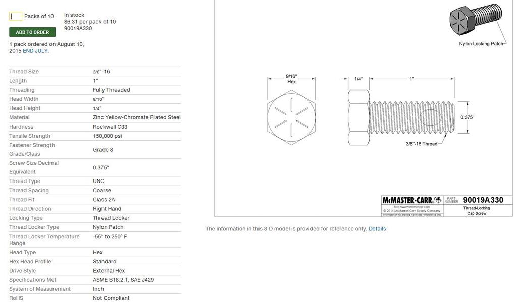

pfrederi 19,925 #20 Posted December 23, 2017 Wheel Horse kept changing the way hubs were secured. Cotter pins and hairpins E Clips External Snap rings 3/8" Bolts with a plastic plug in the bolt to lock the thread They called it Eslock... 1 Share this post Link to post Share on other sites
JERSEYHAWG / Glenn 4,527 #21 Posted December 23, 2017 E clip. I stand corrected. But that's it, how my wheel is secured. Glenn Share this post Link to post Share on other sites
Devin 27 #22 Posted December 23, 2017 Mine uses the external snap ring i should be able to find it at Wal-Mart if the website correct Share this post Link to post Share on other sites
953 nut 64,157 #23 Posted December 23, 2017 1 hour ago, Devin said: Mine uses the external snap ring i should be able to find it at Wal-Mart if the website correct Never have seen them at my Wal-Mart, but ACE Hardware or any good auto parts store will stock them. 1 Share this post Link to post Share on other sites
