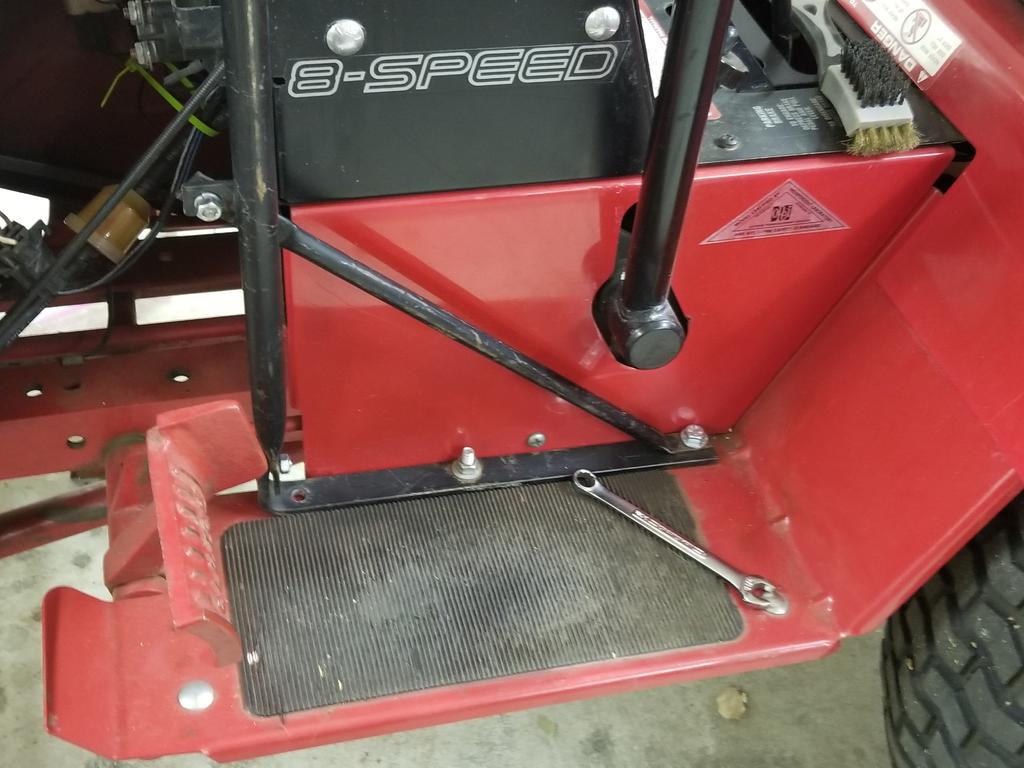

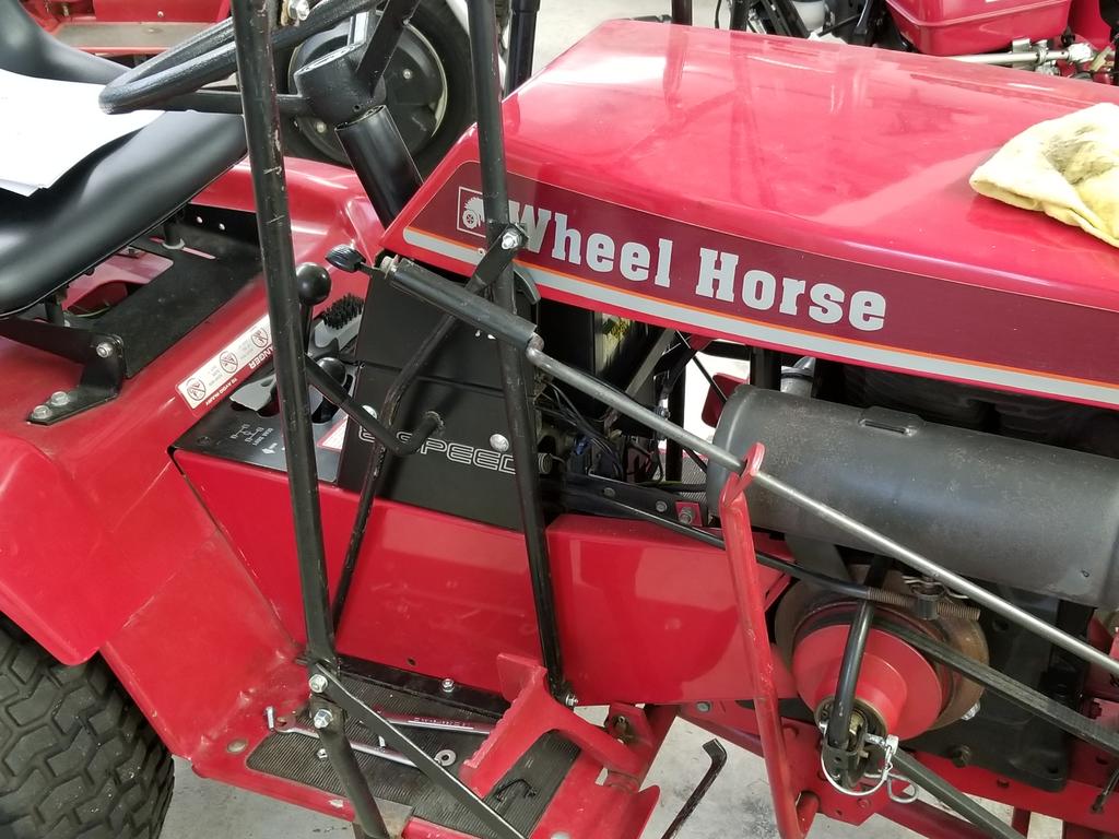

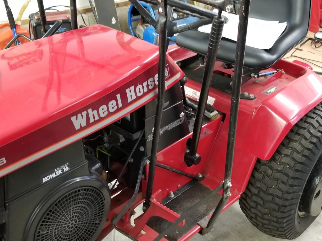

JERSEYHAWG / Glenn 4,573 #1 Posted December 9, 2017 Ok, got my cab from a member for my 416-8. Thought piece of cake. In a jamb already. Figures, Look at the pictures, right side, left side, THEN from the front. NOTICE the severe angle.whats Up? I dont want to force and break, but trying to line up and pull it over, the right side goes deep INTO the hood. STUMPED. Glenn 1 1 Share this post Link to post Share on other sites
lak1965 51 #2 Posted December 9, 2017 Take a look at this picture. Looks like the bar is bent to go around the hood. Hope it helps. 1 Share this post Link to post Share on other sites
JERSEYHAWG / Glenn 4,573 #3 Posted December 9, 2017 Lak, Thanks, but if I gave a frontal shot of that bar, it does have the bend in it. Just like the other side. To go with the curve of the hood. I guess a better picture. I will reinvestigate it in the morning, I never spent 4 hours on a couple pieces like this before. And I dont want to force it and snap something. Thanks again. Glenn Hey guys, anyone reading this, who makes the chute extension piece for the crank handle. I thought I saw recently a few guys talking about that. Dont want to stick my hand out of the cab to turn the chute. Glenn Share this post Link to post Share on other sites

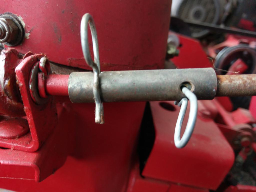

squonk 46,727 #4 Posted December 9, 2017 7 hours ago, JERSEYHAWG / Glenn said: Hey guys, anyone reading this, who makes the chute extension piece for the crank handle. I thought I saw recently a few guys talking about that. Dont want to stick my hand out of the cab to turn the chute. Glenn You can buy a piece of round stock and a coupler with allen set screws. Cut the rod to the right length you need. Drill a hole for the cotter pin and attach it to the blower. then use the coupler to connect to the handle. 1 Share this post Link to post Share on other sites

jsPond 51 #7 Posted December 9, 2017 I'm far from an expert on this but I did just go thru a similar situation with mine. One difference I had was the bend in my side poles is much more severe than what is in any picture posted here. Mine leaned hard tot he left when I first put it on. I simply pushed on it until I got it to where I wanted it to be for the most part. In my opinion, you should be fine to push down on the window frame carefully and bolt it to the other frame, then see where you stand. I wouldn't be afraid to apply some pressure to get closer to where you want to be, after all, these things weren't made yesterday, they can take a little punishment. Look at my thread "Question on cab install" and see what troubles I had. You're in the exact right place to help you thru this. Goos luck and let us know how it turns out. 1 Share this post Link to post Share on other sites

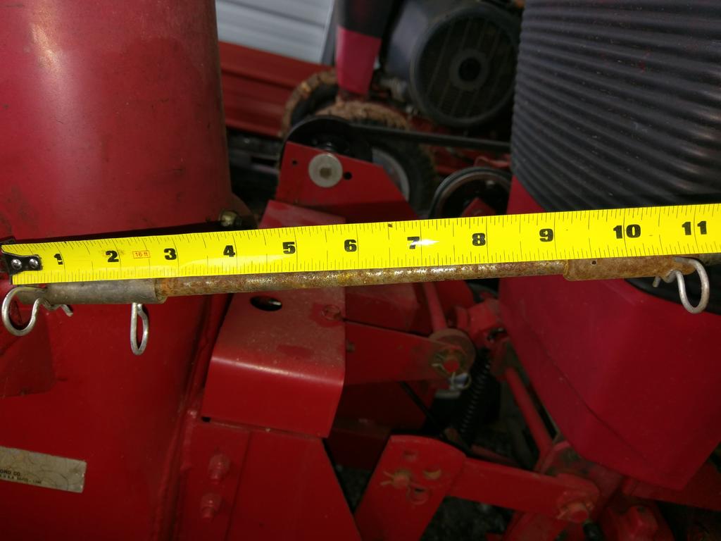

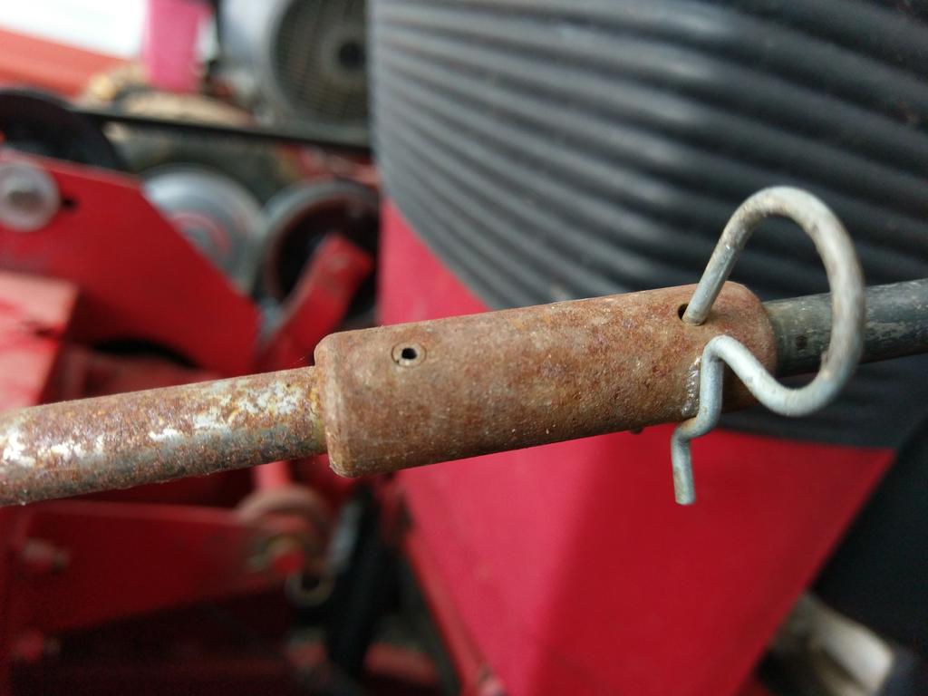

WVHillbilly520H 10,378 #8 Posted December 9, 2017 @JERSEYHAWG / Glenn, just went out and got measurements for you and the gang, for the crank extension, 3/8" diameter rod 10-12" long depends how close you want it to the seat, then the coupler is 5/8" diameter 3-4" long drilled through 3/8"+ for a slip fit, then drill 1/8" holes for the cotter/hair pins, I roll pinned my coupler and on the 2stage it has a thin walled coupler on the worm gear from the factory, that's what I did hope this helps, but you could use 3/8" rubber hose and clamps for the couplers eliminate all the fabrication just to get you up and going for now, Jeff. 2 1 Share this post Link to post Share on other sites
JERSEYHAWG / Glenn 4,573 #9 Posted December 9, 2017 BIG THANK YOU MEMBERS...re bent here and there, it's coming along. Shout out to shallow water sailor.....xtra support. Good thing I am plump, made the bending easier. Btw, snowing here, just in the nick of time. Surprise snowfall, 4 to 6 predicted. Glenn 3 Share this post Link to post Share on other sites

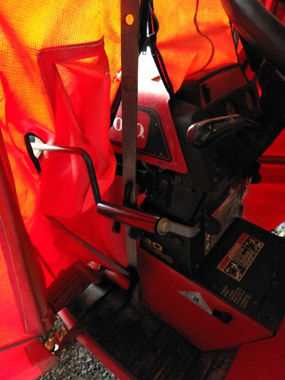

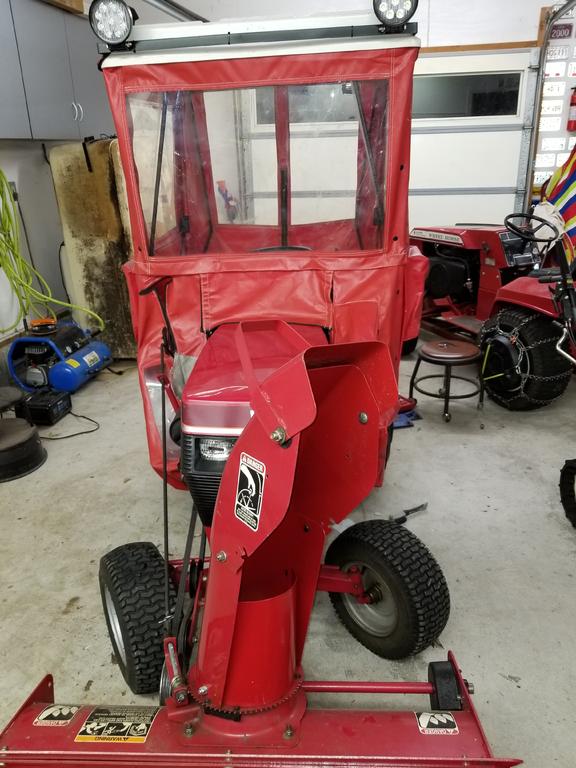

JERSEYHAWG / Glenn 4,573 #12 Posted December 11, 2017 Thank you MEMBERS, here it is, all done. Just gave it an oil change to. Got my snow chains, need to put them on, but ready for winters battle. Nice and dry, in the cab. Glenn 4 1 Share this post Link to post Share on other sites
