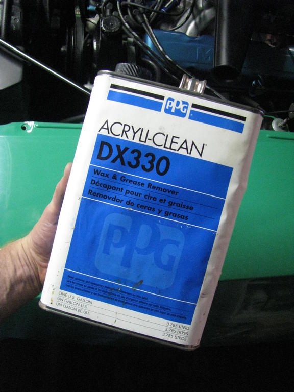

Jerry77 1,218 #4 Posted December 1, 2017 Rags and prep-sol...not sure what they call it now, but I used it on metal to clean off grease etc.before sanding..also the last thing before painting a car- wipe it down one more time..will not harm paint - only removes everything else..get it at an automotive paint shop.. 1 Share this post Link to post Share on other sites
Wheelhorse427 15 #5 Posted December 1, 2017 http://www.axaltacs.com/content/dam/NA/HQ/Public/Cromax/Documents/TDS/CX-TDS-3919S-Eng.pdf this? Share this post Link to post Share on other sites

Jerry77 1,218 #9 Posted December 2, 2017 3 hours ago, Wheelhorse427 said: http://www.axaltacs.com/content/dam/NA/HQ/Public/Cromax/Documents/TDS/CX-TDS-3919S-Eng.pdf this Yes, didn't know if it was still around or not.. Share this post Link to post Share on other sites
