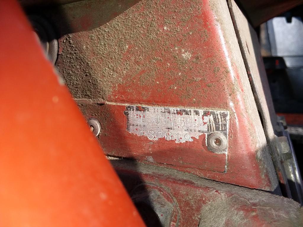

Thank you for the reply. Sounds like someone had re powered at some point in the past. The model number I took right  from the manufacturer plate on the center frame of the machine, Not sure at this point if there other numbers present. I can post some pics of the machine tomorrow afternoon.
I would guess it would be a good starting point aside from finding other numbers is to mic out the output shaft and see what I have?
gwest_ca
The 133619 may be a serial number for the 1975 tractor model 1-0375. See if this number is stamped above the serial number. Click on the fuzzy picture.
There was a HH-160 Tecumseh used in 1974 but the HH was changed to OH to more easily recognize the overhead valve design.

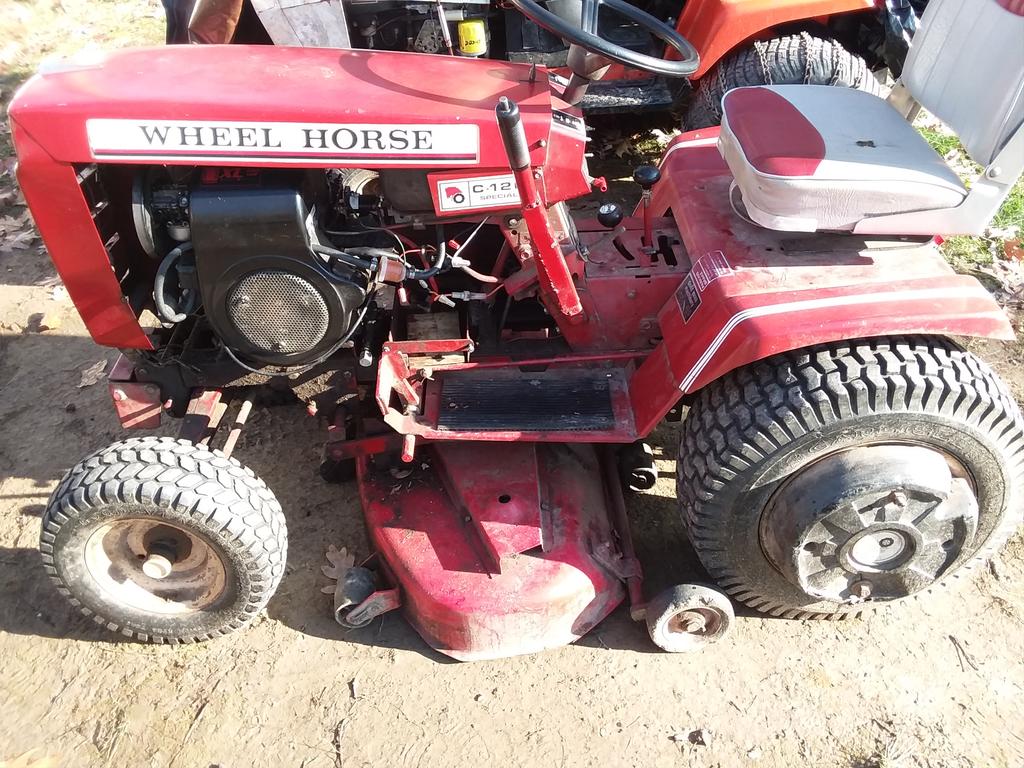

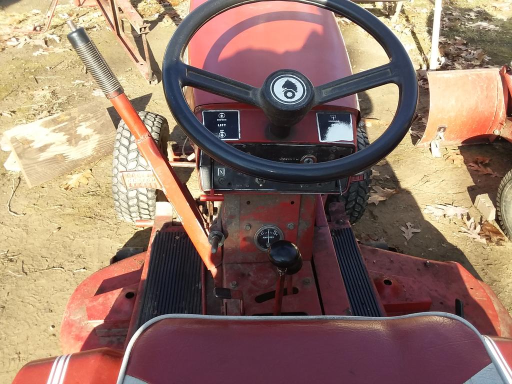

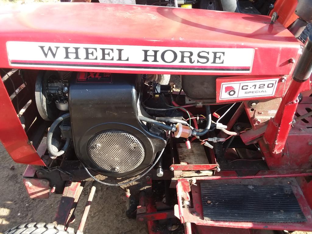

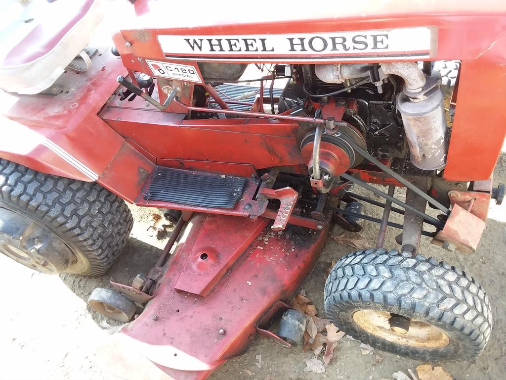

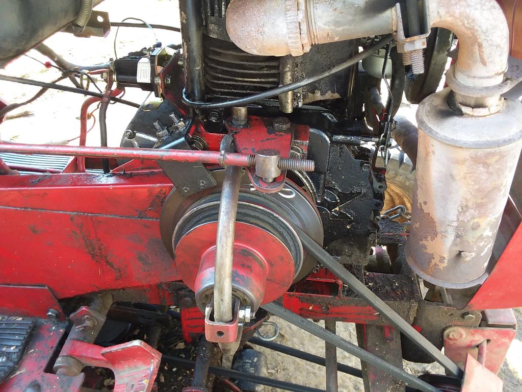

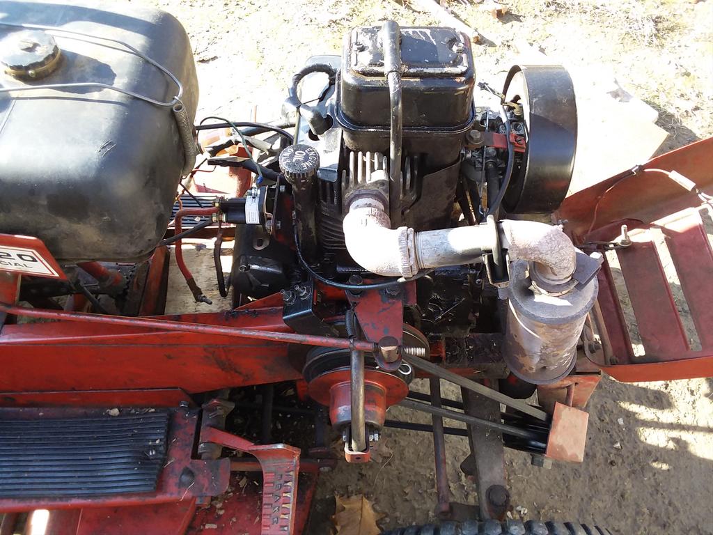

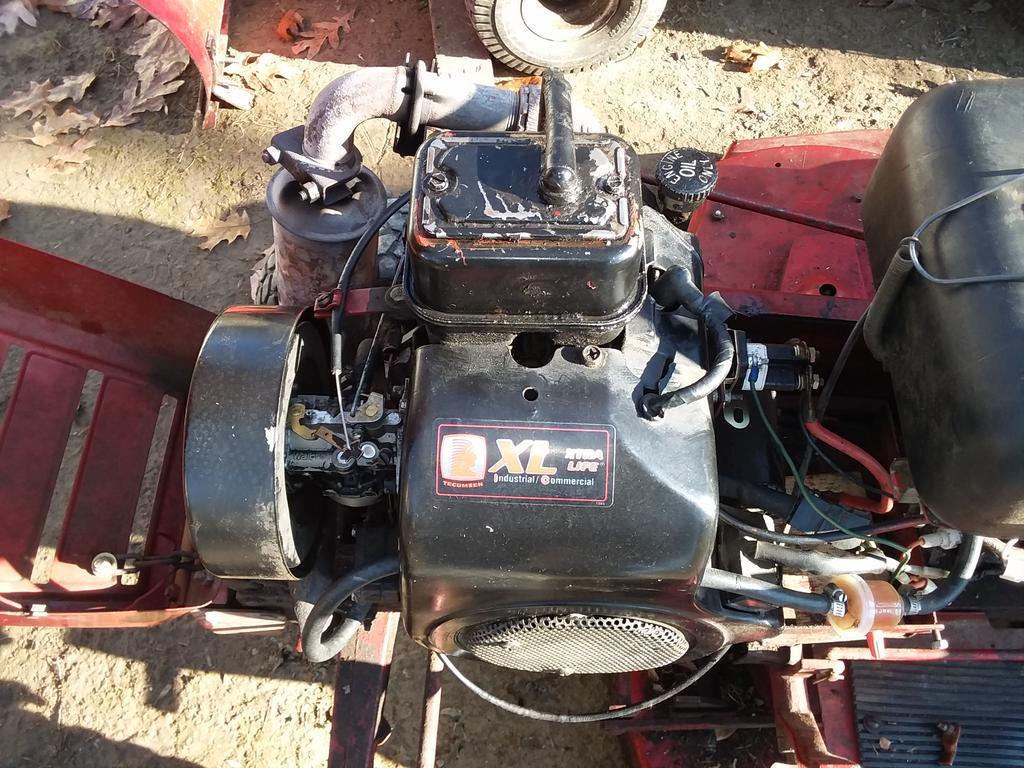

You are correct, I had missed the second set of numbers when I had wrote the information down. So this machine seems to be from 75' with a 16 horse OHV Tecumseh.  Thanks so much for your help. I did manage to get it running, however it is surging bad with fuel blowing out of the carb, could be loading up the engine (dumping)? Also the breather is dumping large amounts of oil onto the motor from the vent pipe, It does appear that someone has had this apart as can be seen from the pic trace amounts of high temp RTV on top. I would love to rebuild the carb as I have found a rebuild kit at my local ACE hardware store, However from reading another post here I had read that if those breathers are not reassembled properly they will blow out large amounts of oil making it appear to be gross blow by. I read the information that
gwest_ca-(File Mod)
Had provided and it would seem that the original motor was a 12 Hp? I am not sure if another branded 16 Hp engine will work with this chassis?
Being that I really need this machine to get some work done on the property I am wondering if there is another motor that will work on this chassis with relatively low modification to the chassis? If there is,  I can take my time with the minor overhaul of the original engine when I have more time. I have attached some pics, Again thanks to all for your assistance, And the warm welcome:)
