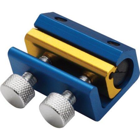

Retired Wrencher 6,858 #12 Posted November 25, 2017 Spareparts These cable lubbers work real well for stuck frozen hard to move cables and they are cheap. I have had one for years. works every time in minutes. 1 Share this post Link to post Share on other sites
c-series don 12,224 #13 Posted November 25, 2017 Spareparts we really need pictures of this tractor. It's killing me that I can't see it!! Those 78-79 C-series are my favorite. Pleeeaaassseee !!!! 1 Share this post Link to post Share on other sites
Spareparts 92 #14 Posted November 25, 2017 Retired you are absolutely correct $10.18 and available at Walmart Thank you so much. I didn't want to try lubing mine because the ledgens on mine is really good, now to Walmart. 1 Share this post Link to post Share on other sites
