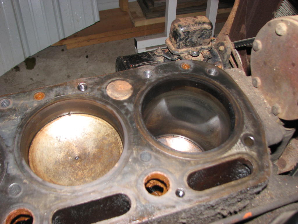

Pullstart 69,875 #13 Posted November 8, 2017 Good news / bad news. Tonight I pulled the head. I couldn't wait, it was bugging me like crazy. The other night I sprayed some penetrating oil on the stuck valves and today we ran it around a while, all one lung in it's glory then parked it after it was warmed up. After the head was off, I used a rubber mallet to pop the stuck valves back shut, then open, then shut, until they would open with a quick smack and shut fully by themselves, then ran the mallet down the row for a while to make sure nothing would stick again. Success on that. Cylinder 4 has some pretty bad pitting on the top of the cylinder (it must have been down when it was full) and all the sleeves have a pretty noticeable step. Not knowing how far these big tractors can go before needing a rebuild, am I best off just getting the head and valvetrain back in working condition, or should I re-sleeve it and do an in-frame overhaul? I have a 3 stone cylinder hone but I'm thinking that wont help to clean up the pitted cylinder. So my for sure list: one pushrod and the rocker cross shaft. I'm sure with a head gasket and the one exhaust stud I broke (yeah, that's all just one!) that'll get it running pretty good. Suggestions? I found this video of pulling sleeves, I think I'll be able to do that in-frame. https://www.youtube.com/watch?v=G2ctd0BYOGQ Share this post Link to post Share on other sites

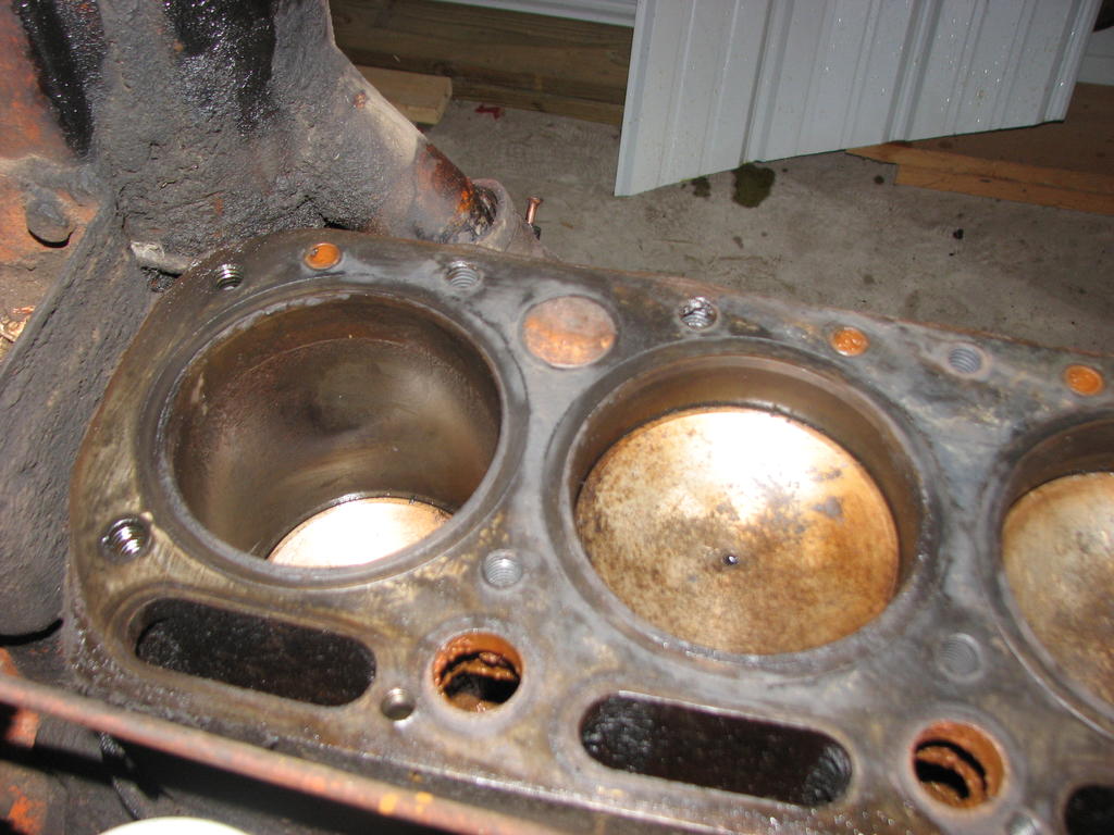

Pullstart 69,875 #14 Posted November 8, 2017 Here's a picture of the cylinders. See #4 has some pretty decent rust damage, far from "cleaning up" with running it. I know this is half-assed and I might as well not waste my time, but I think I'll find a rocker shaft and a pushrod, then pop the head back on and see how it runs. I'm anticipating some blow by from that darned #4. 2 Share this post Link to post Share on other sites
diesel cowboy 263 #15 Posted November 8, 2017 From the looks of the cylinder you should be ok for a while just cleaning it up real good with a light hone or steel wool and putting it back together. If it was mine I'd go with cleaning and put it back together to try. It'll give you an idea of where you need to go next with it. If you're worried about blow by you could pop the piston and check the end gaps on that cylinder first. I've done probably 8-9 of the wet sleeve type engines ranging from the customer saying clean it up and make it work as cheap as possible to a complete overhaul I don't care what it costs. Share this post Link to post Share on other sites
Pullstart 69,875 #16 Posted November 9, 2017 Thanks for the input @diesel cowboy, today I found a rocker assembly and a straight pushrod to boot, along with a wide front end too! Shhh that part's a surprise for later! I'll see how it all comes together, I hone stoned the block surface today and will clean the head with a file and hone stone before re-assembly too. Share this post Link to post Share on other sites
Cvans 1,009 #17 Posted November 9, 2017 It'll run just fine for what your doing if the rings are good. These old low RPM engines are much more forgiving than the newer high speed engines. We had a 1937 JD B that must have set out for years without the exhaust covered before someone got it running again. Discovered when I went to install new rings that the cylinders were badly pitted and you could actually see where the old rings had been setting in the cylinders when it rusted up. After honing the cylinders and installing the new rings it ran fine with no noises. 2 Share this post Link to post Share on other sites
