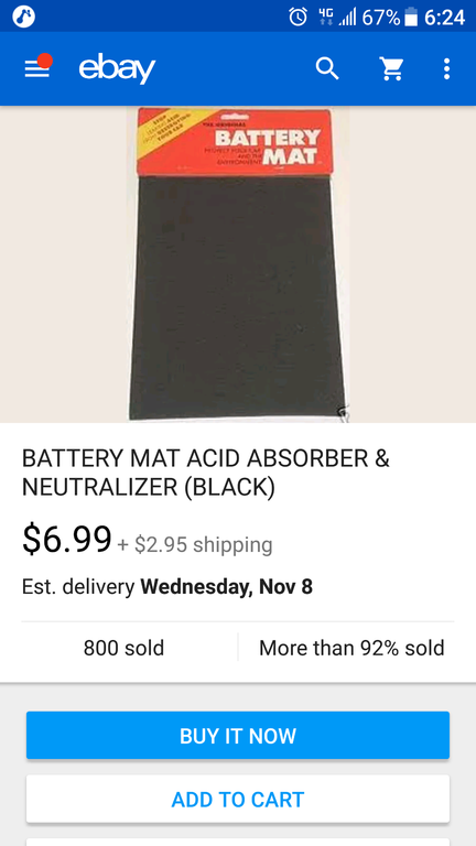

WVHillbilly520H 10,378 #32 Posted November 3, 2017 Try one of these... 1 Share this post Link to post Share on other sites
elcamino/wheelhorse 9,363 #33 Posted November 4, 2017 I tried that mat and all it did was retain moisture . I live so close to the James River and a large creek that runs into it , it is like humidity central here. I don't think the mat works that great. I have measured the tray and battery am going to try to purchase a plastic battery box. Purchased Stain steel bolts , nuts and washers today for the project. Still have one !@#$^&*()__ rusted bolt to remove. Share this post Link to post Share on other sites
